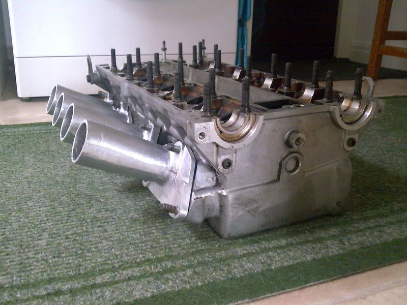

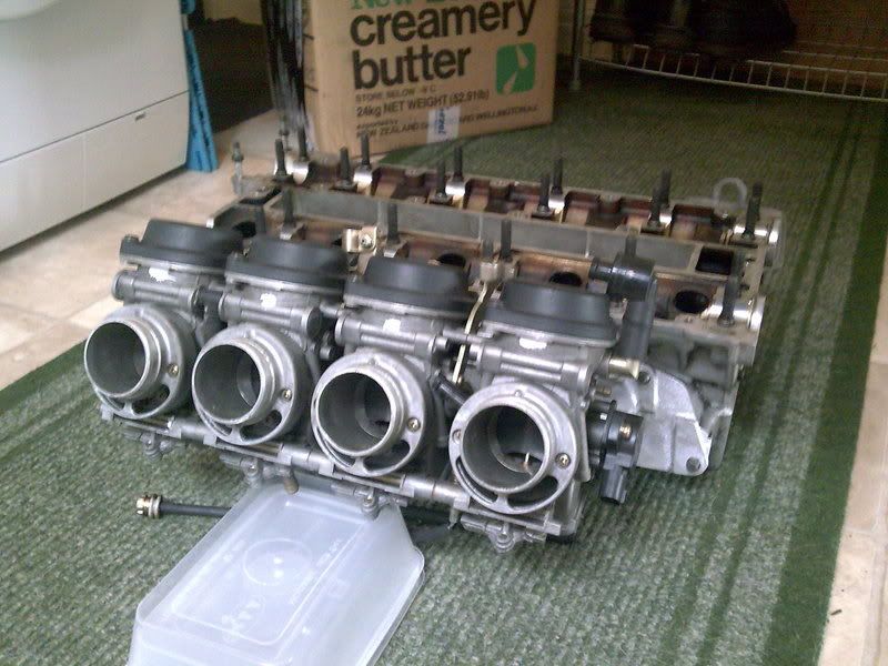

Heres a few more pictures to show the fitting against the head and carbs etc...
I checked the spacing of the holes on the flange against a gasket first and they were cock on. When the manifold is bolted up to the head theres a slight step on two of the inlet ports, but I can just open the ports on the head slightly so as it matches the manifold perfectly, however I am really happy with how well it fits. In regards to the carb end of the manifold the spacing is out by about a mm on one or two of the pipes, which again isn't an issue as they mount with rubbers anyway.
All in all very very happy with it :thumb:
Manifold on the head
http://img.photobucket.com/albums/v3...Image001-1.jpg
You can see here the slight step into the heads inlet port
http://img.photobucket.com/albums/v3...a/Image003.jpg
Carbs offered up
http://img.photobucket.com/albums/v3...Image009-1.jpg
http://img.photobucket.com/albums/v3...a/Image008.jpg
http://img.photobucket.com/albums/v3...a/Image007.jpg
and a random one seeing what it would look like with the air filter!! (Just need to sort a new backing plate that fits the carbs for this)
http://img.photobucket.com/albums/v3...Image010-1.jpg
http://img.photobucket.com/albums/v3...Image012-1.jpg
loos very good mate.
nice job with manifold
looks proper that. take the time to match the ports wont you. would be crazy not to
What are the black plastic pots on the top?
Flote like bits where the fuel gos in?
