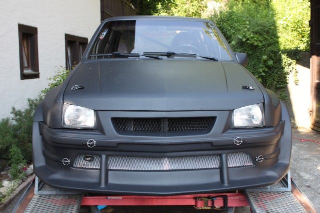

simply amazing.... every mod is f...ing great. i like so much youre car. Congrtz.
I wish my Nova was this wide lol

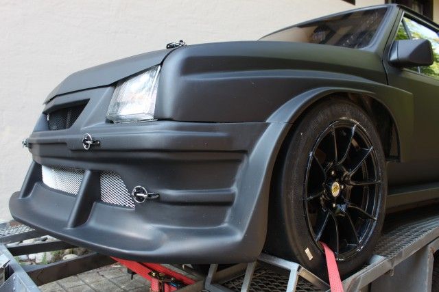

im loving the arches. awsome bit of kit.
That front end looks awesome!
Yes, it looks like a stealth fighter! I can imagine the policeman have no idea what's wrong with the detector lol

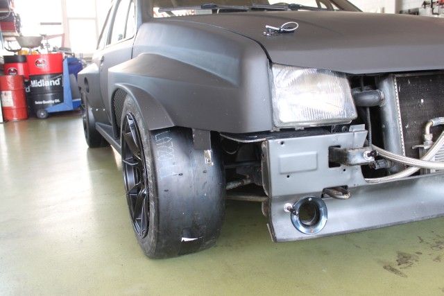

changed the tires
http://i260.photobucket.com/albums/i...ps134dbeb1.jpg
Now with Dunlop 200/580 R15 Medium Compound for circuit use

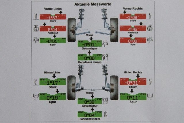

New Suspension Settings
http://i260.photobucket.com/albums/i...psfb760fa4.jpg
Facts:
Front Track: 1508mm
Rear Track: 1465mm
Tracking: 0°
Camber: -2°
Caster: 5°

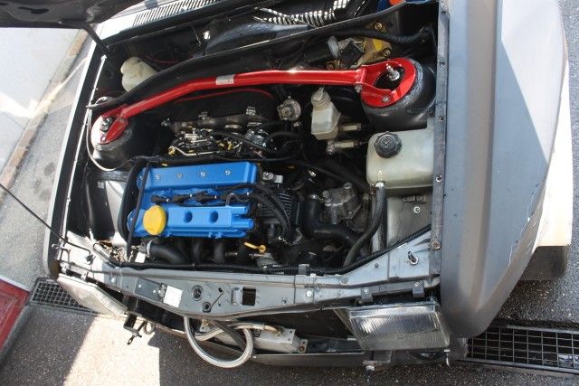

Engine cleaning, nice and shiny :)
http://i260.photobucket.com/albums/i...psf1381970.jpg

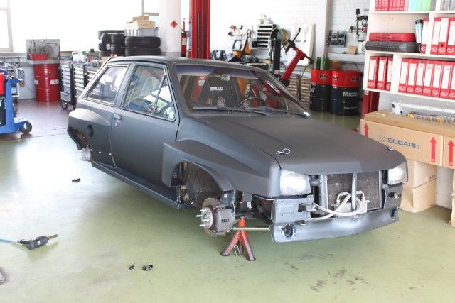

and finished repair on the bumper and wheelarch
http://i260.photobucket.com/albums/i...psa06e0cf9.jpg
