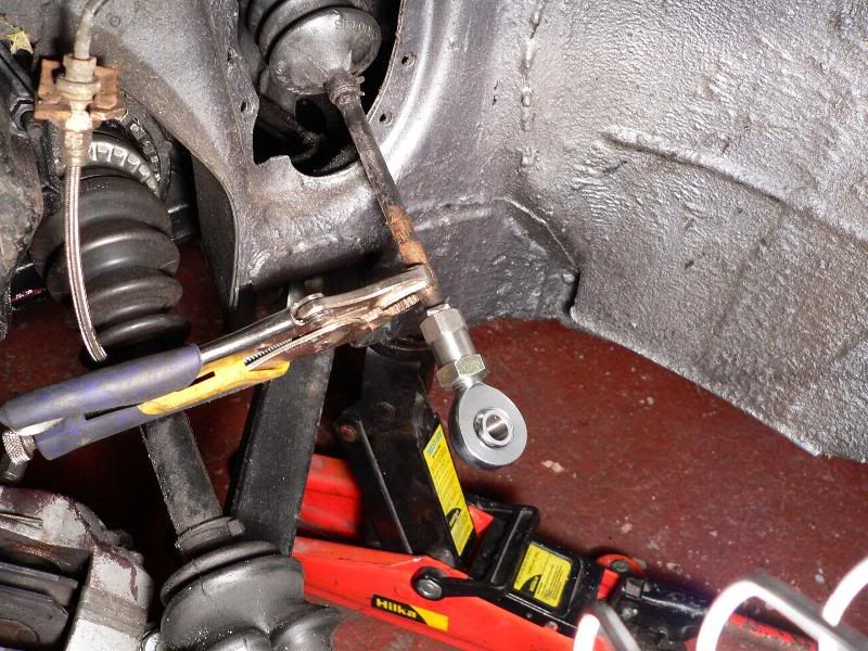

Surely you'll have to run a small spacer between Steering knuckle and rose joint - otherwise you'll have no up/down movement ?:confused:

Dave - totally mate, we cut the spacers in half length ways and fitted them in between the knuckle & RJ :thumb:

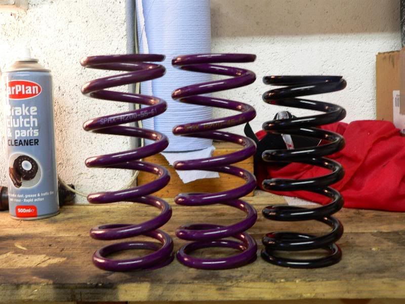

313lbs vs 285lbs vs 350lbs

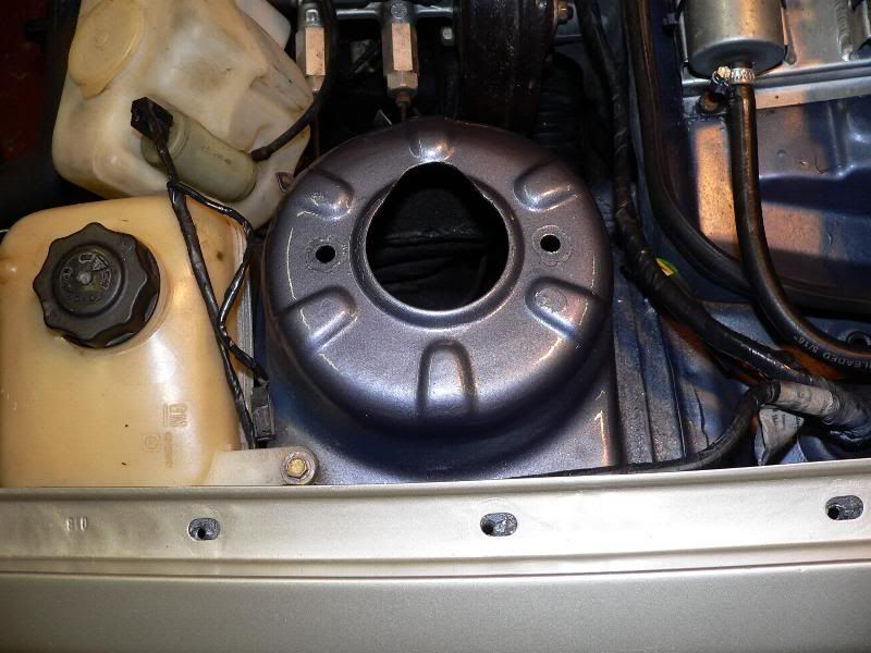

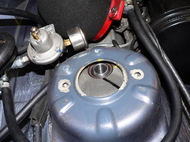

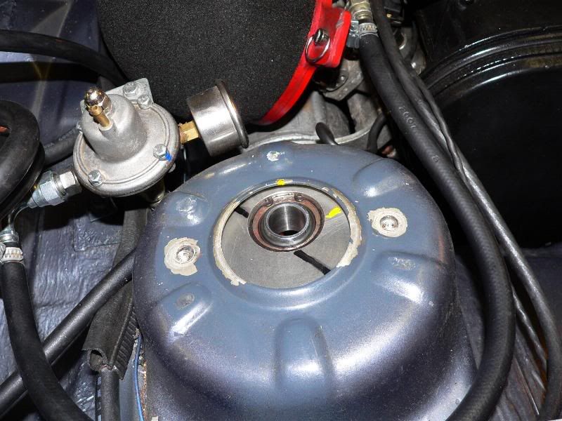

Current topmount positioning
http://i136.photobucket.com/albums/q...ure/nc1128.jpg

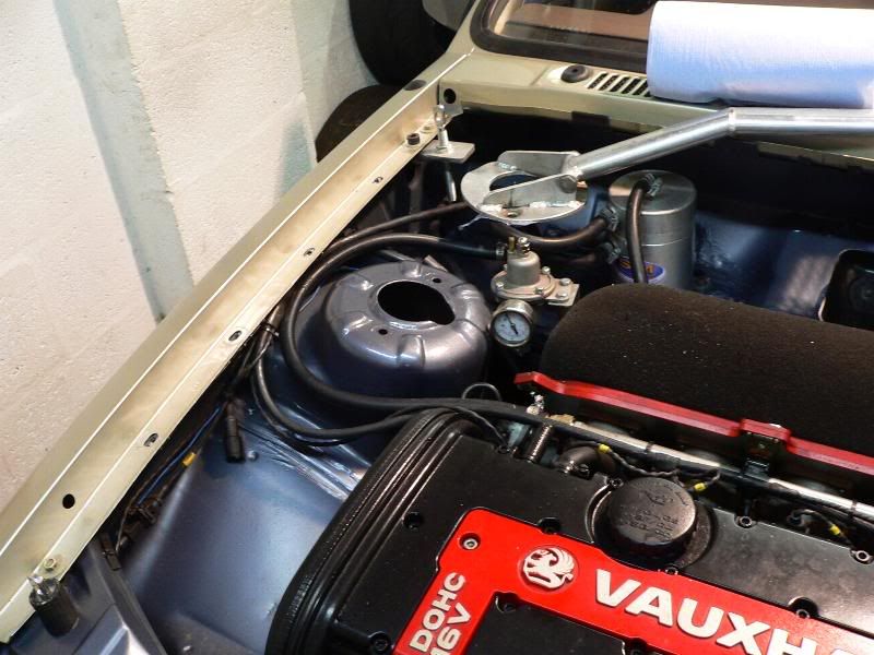

Target topmount positioning
http://i136.photobucket.com/albums/q...ure/nc1129.jpg

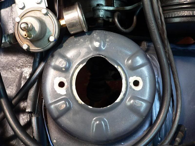

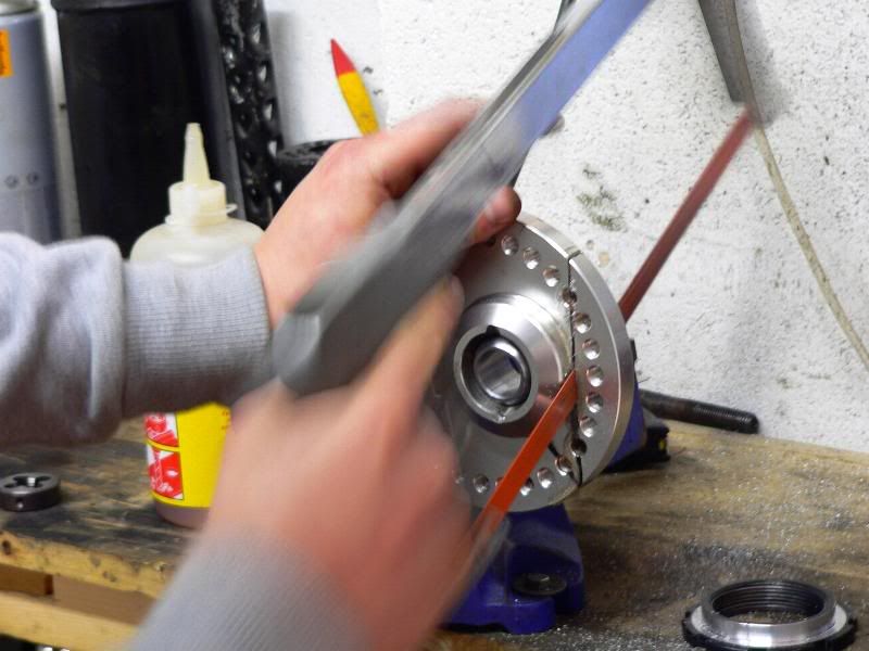

On with the modifications, over to James who can saw like a bastid lol
http://i136.photobucket.com/albums/q...ure/nc1130.jpg
his mahhooooosive 'Snap-On' half round snap on file made short work of my turrets
http://i136.photobucket.com/albums/q...ure/nc1131.jpg
Cleaned up, wipe down, panel wiped, lick o paint
http://i136.photobucket.com/albums/q...ure/nc1132.jpg
Looking good, retaining standard securing bolts holes
http://i136.photobucket.com/albums/q...ure/nc1133.jpg

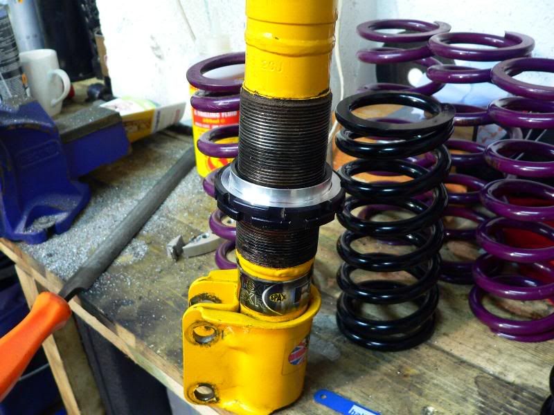

Spring seats on
http://i136.photobucket.com/albums/q...ure/nc1134.jpg

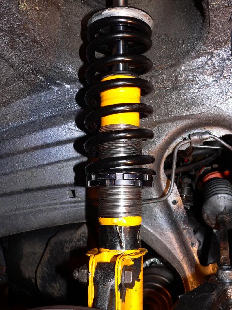

Leg on, with shorter springs
http://i136.photobucket.com/albums/q...ure/nc1135.jpg

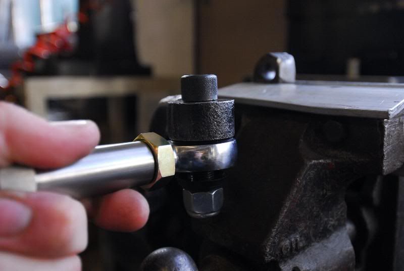

New rosejointed TRE fitted to rack
http://i136.photobucket.com/albums/q...ure/nc1136.jpg
Perfect filing by James meant it was look swish

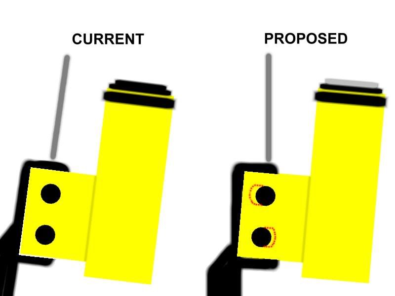

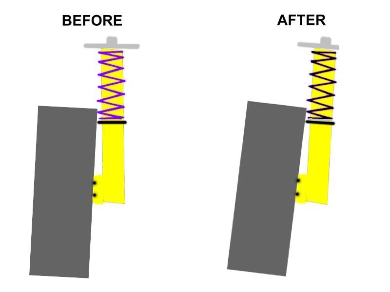

The slight problem that we encountered, which we will overcome, that moving the top of the shocker (ie: topmount) inwards towards the bay wasn't ever going to move the spring away from the tyre wall. Because it the leg is attached to the hub/ wheel/ tyre at the bottom aswell lol
Excuse my crude drawing, but all we've basically done so far by moving the topmount inwards is this:
http://i136.photobucket.com/albums/q...ure/nc1138.jpg
The suspension leg / wheel / tyre distance is obviously still identical, just made me now run -3° negative camber, which isn't so much of a problem, as I can wind in the rosejoints on my TCAs, to bring the bottom of the wheel and bottom ball joint in aswell, which I may do.
But obviously this doesn't cure the clearence problems when running 888s or slicks, Rainsports aren't, and never would be a problem.
So now I intend on getting my suspension leg holes elongated with a diegrinder, so it will enable my leg to lean inwards, but my wheel & hub to remain at -1.5° camber, like so:
http://i136.photobucket.com/albums/q...ure/nc1139.jpg
After they've been elongated, and I've got the full positioning that I want, I would welkd a washer around the new hole, thus changing the bolt holes really :thumb:
I never realised what you were actually doing lol
Moving the top mount position is a fix that people do to reduce/change camber(usually re-drilling the turret holes), which youve now found out
