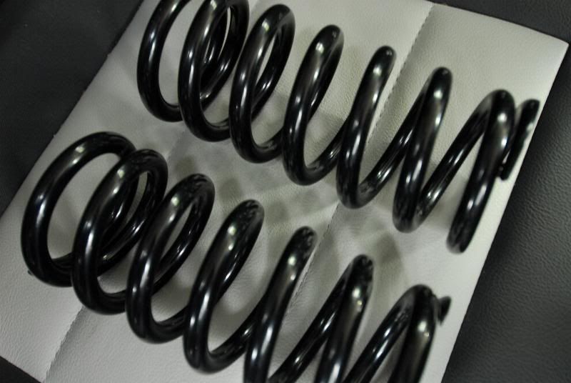

Absolutely flawless service from Dave & Andy once again @ Faulkners, I ordered my springs around 3:40pm yesterday, 8:30am this morning UPS was at my door with my new springs!
http://i136.photobucket.com/albums/q...ure/nc1123.jpg

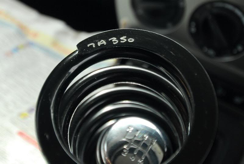

7" open length, 350lb, 2.25" ID
http://i136.photobucket.com/albums/q...ure/nc1124.jpg

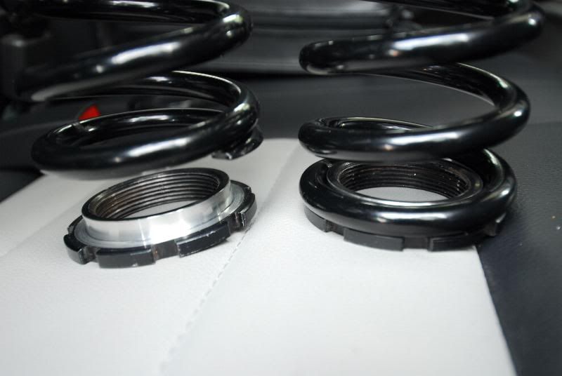

Had my spring platforms turned down to 58.1mm
http://i136.photobucket.com/albums/q...ure/nc1125.jpg
