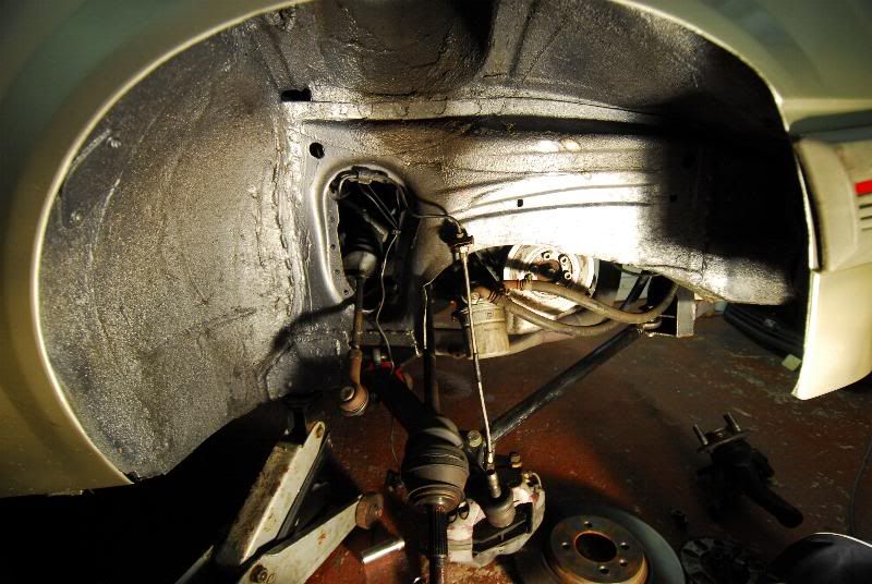

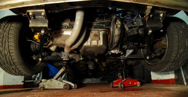

So been out in the garage for a couple of hours tonight, removing all the bits and bobs that Me (and James hopefully) will be doing tomorrow night...
Up in the air, is still a ball ache to do in a single garage with minimal room either side lol, but I manage... can't wait for alloy jack & sill stand ness lol

One leg

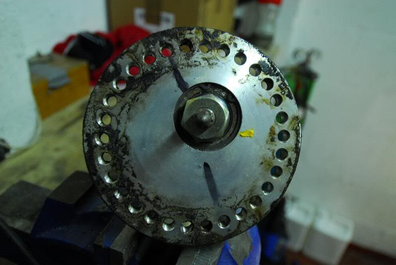

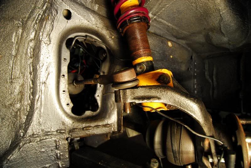

Tried to see if there was enough room to move the topmount inwards, and there seems to be a good 10mm before the angle changes, so we should be able to slice off the inner side of the topmount :thumb:
http://i136.photobucket.com/albums/q...ure/nc1108.jpg

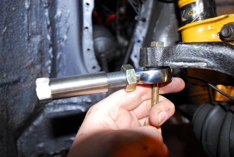

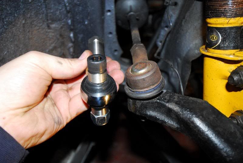

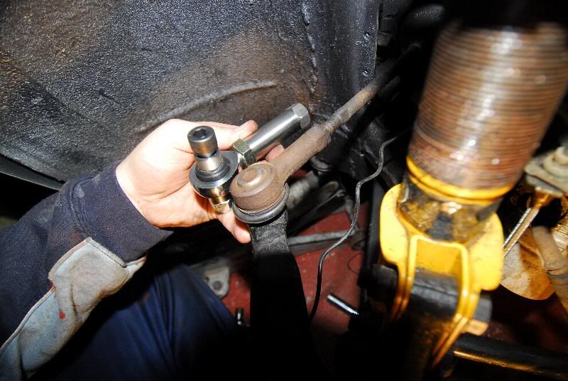

Soon to be replaced standard track rod end
http://i136.photobucket.com/albums/q...ure/nc1109.jpg

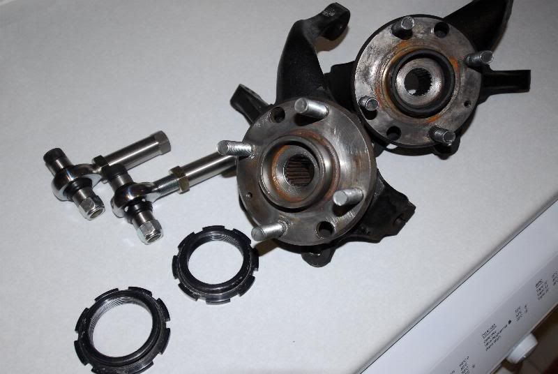

Just for those that were unsure of how the new RJ'd ones will fit
http://i136.photobucket.com/albums/q...ure/nc1110.jpg
http://i136.photobucket.com/albums/q...ure/nc1111.jpg

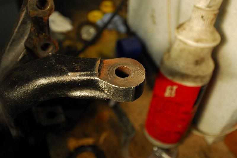

This bolt used it purely for illustrative purposes, it is NOT the bolt supplied with the kits lol, obviously the M12 bolt will not pass through my hub at the moment as it's not been opened out, some are deciding to run them above the hub ala a standard TRE which is fine
Alternatively you can run them below, which I intend on doing, without a spacer like this

http://i136.photobucket.com/albums/q...ure/nc1114.jpg
filthy dirty horrible underseal/ waxoyl crap
http://i136.photobucket.com/albums/q...ure/nc1115.jpg

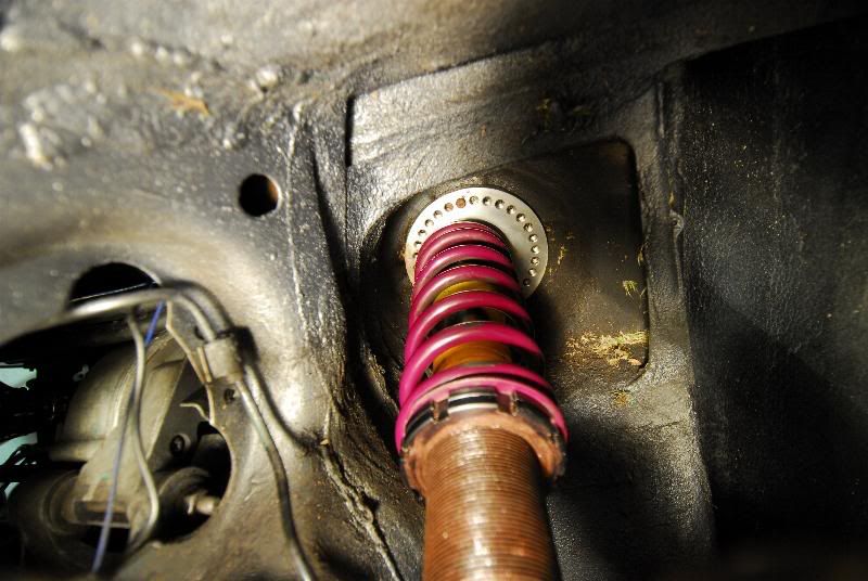

cleaned up and lines marked, however existing bolt holes used are no longer needed, but we know just in case

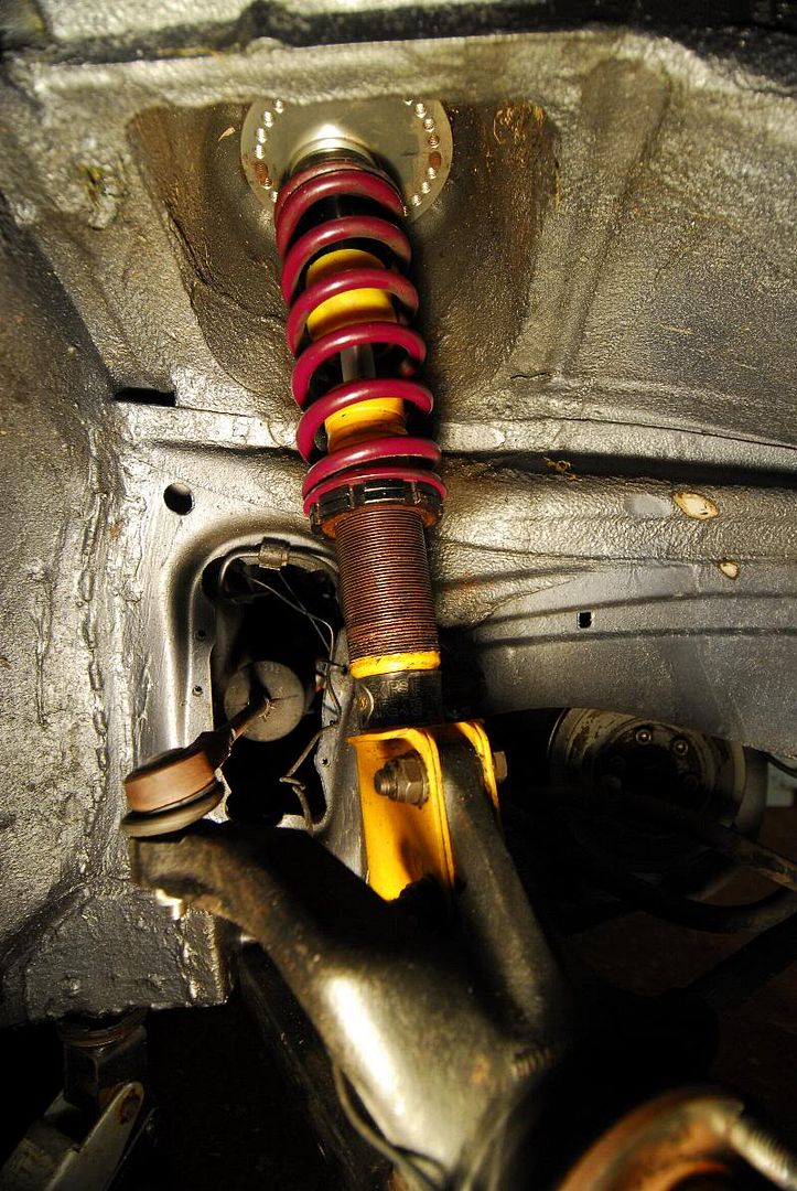

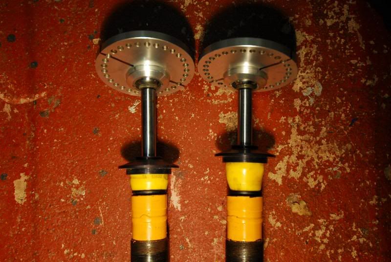

bump stops cut down to an 1", just incase my shocks ever do drop that low, I'd sooner use the last of the shocker, as opposed to hitting a polybush, but I seriously doubt it'll happen anyway
http://i136.photobucket.com/albums/q...ure/nc1117.jpg
All cleaned up ready for tomorrow

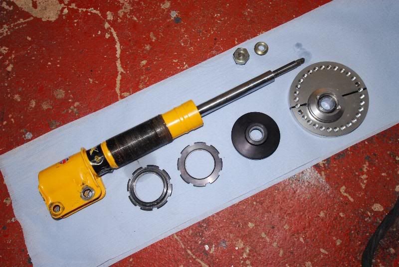

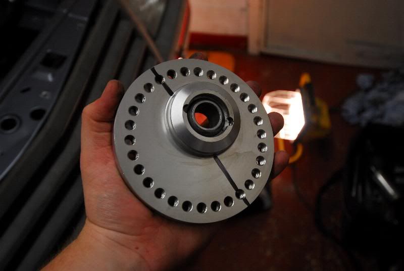

Outer diameter of a standard Spax spring platform is 61mm, this will be put on a lather down to 58.2mm
http://i136.photobucket.com/albums/q...ure/nc1119.jpg
Tapered insert that will be drilled out to 12mm
http://i136.photobucket.com/albums/q...ure/nc1120.jpg
Machine shop bits for the morning
http://i136.photobucket.com/albums/q...ure/nc1121.jpg
