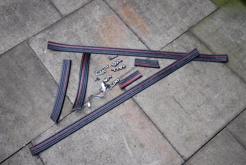

Got bored of the "sleeper" look, so removed the rubstrips ready for my white door squares for my race number, and removed the badges and the "NO INTERIOR LEFT..." sticker

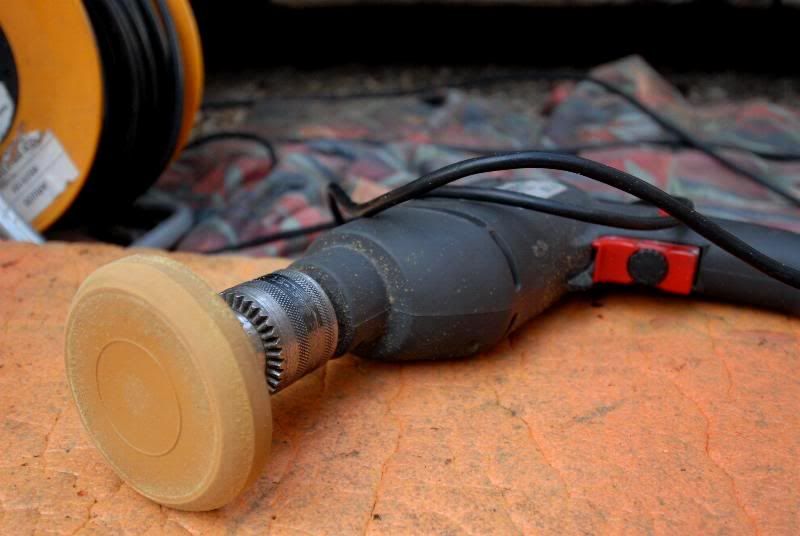

Toffee/ Fudge wheel makes it effortless

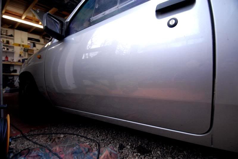

Shiney rubstrip free doors

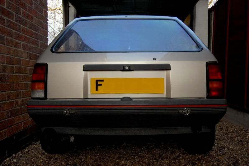

badgeless and stickerless tailgate

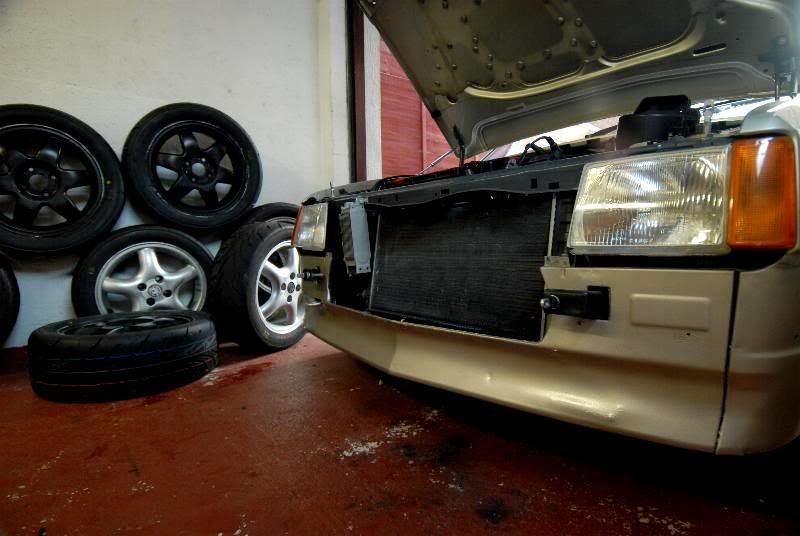

Resprayed the front lower valance again to give it a freshen up

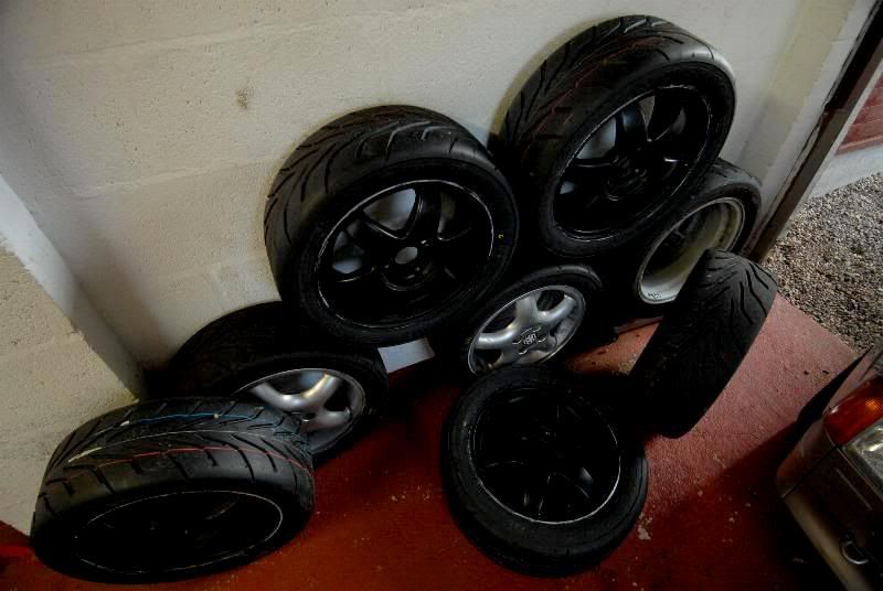

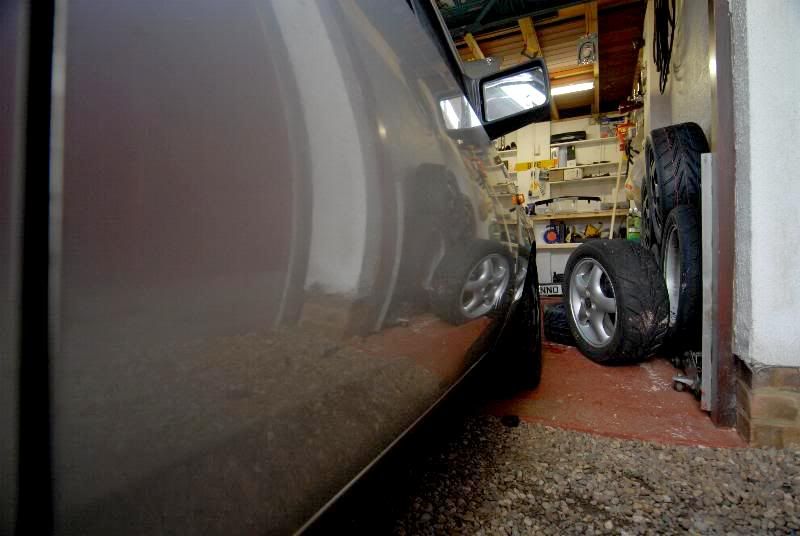

New and used 888s ready for a thrashing at Castle Combe!
http://i136.photobucket.com/albums/q...ure/nc0648.jpg

can you please tell me where you get a toffee/fudge wheel from cos im after one to debadge my car?
any good auto paint shop mate. (that doesnt include halfords lol)
Just a quick question, what pressures do you you run in them from cold?Quote:
Oh and super build.:thumb:
boffer - bought mine from eBay for ?1.99 lol
smcgsi - on that particular day I ran them too high, around 26-28 from cold... eeek!
What would you normally run them at from cold.
sorry about the questions, its just I've got a set on 15's for a lightish corsa and just wondering what people would run them at.
22 front, 18 rear :) Thats never let me down, and I got my second set to run lovely and flat on those pressures.
Will have to try them pressures, cheers Lee just got to get them on the wheels first.
Yeah - as Lee said, he advised me too.
If you can see on the pic on the previous page, of the 8 wheels, you can see "F22" and "R18" on them in yellow chalk, so I know which are fronts and which are rears lol
cant find any of these toffee fudge wheel thingy magigies any where! any ideas of what to type in on ebay?
lol @ that price
here's the one I bought for reference

Removed all the Toyo 888s that were splattered up my wings and doors, they've not been this clean in years lol (brake cleaner is good for this, as it melts the rubber which enables you to just wipe off)
http://i136.photobucket.com/albums/q...ure/nc0673.jpg
