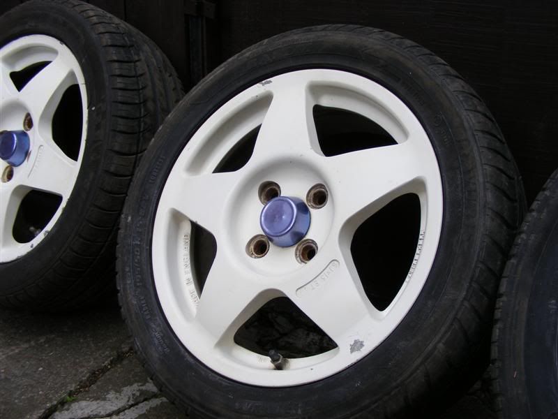

Then another knock at the front door, these babies have arrived :cool:
http://img.photobucket.com/albums/v8...0005Medium.jpg
http://img.photobucket.com/albums/v8...0006Medium.jpg
The tyres are 195/50s, and they do fit on the car without rubbing, but two are fooked. The other two are quite new though, so they'll get removed and sold on....
The silver marks isn't kerbing marks, its just where the paints flaked/lifted. :)
Undecided on what colour to do them atm, but i have a lot of white paint spare from the old wheel refurb, so maybe white. Will be re-doing the centre caps, and fitting new Compomotive stickers too :)

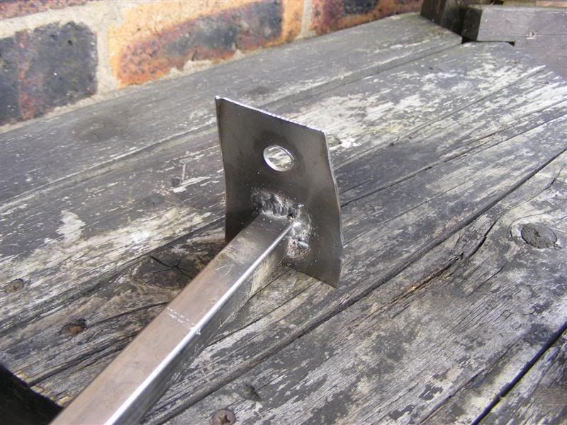

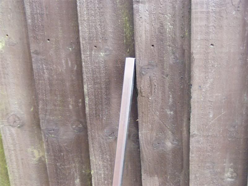

I have no rollcage so had to come up with another plan, which goes a bit like this:
Take 2 bits of old steel cut offs, and drill 12mm hole to fit 7/16s bolt.
http://img.photobucket.com/albums/v8...01Medium-2.jpg
And some of B&Qs finest steel box section
http://img.photobucket.com/albums/v8...0002Medium.jpg
Cut to length, and crack out the welder :cool:
http://img.photobucket.com/albums/v8...06Medium-1.jpg
Not bad, considering im a welding noob.
http://img.photobucket.com/albums/v8...0007Medium.jpg

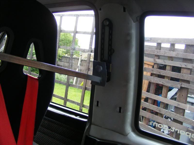

Bolt to the car using the old standard top seat belt mount
http://img.photobucket.com/albums/v8...0008Medium.jpg
http://img.photobucket.com/albums/v8...0009Medium.jpg
Attach camera:
http://img.photobucket.com/albums/v8...0012Medium.jpg
And check the view through it, PERFECTO :cool:
http://img.photobucket.com/albums/v8...0011Medium.jpg
So i now have a camera mount that can be fitted in minutes. Ready for Donny on the 18th :D (will be removing the interior mirror for it)

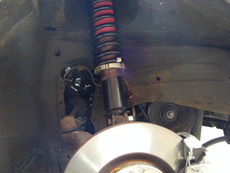

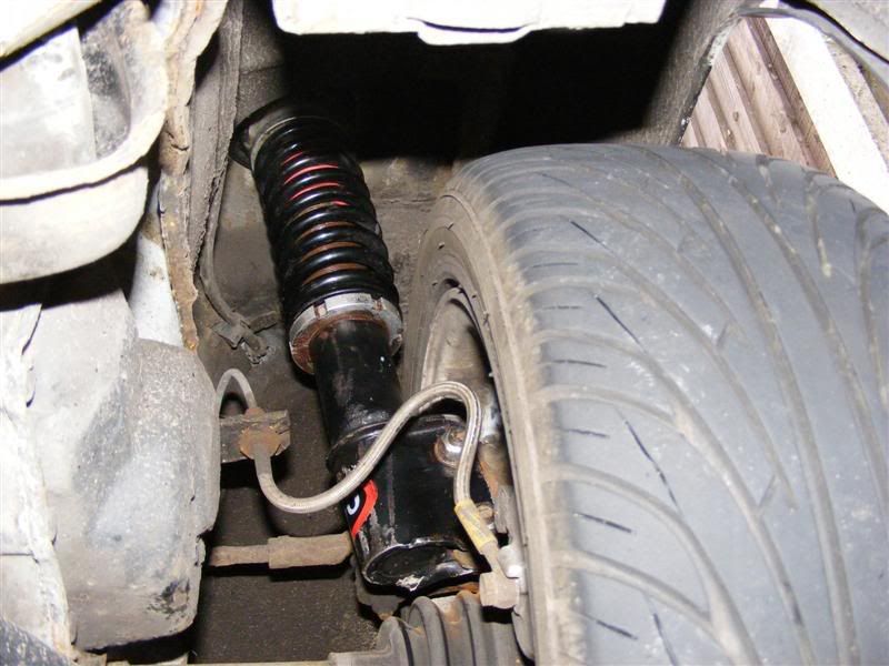

Picked up some 250lb springs off Spanish Fly at Billing, so got cracking and got the Avo's all built up ready.
Had a fooking nightmare trying to get the top mounts on(the springs are 9" in length), which meant there was no thread for the top mount main nut...., not enough coming out of the top mount.
SO, had to use spring compressors to compress the spring slightly, and just managed get the nut on.
http://img.photobucket.com/albums/v8...vosbuiltup.jpg
So wipped the old setup offf today after work
Comparison, old springs looked shagged and about to snap :eek:
http://img.photobucket.com/albums/v8...w/DSCF0245.jpg
New setup on
http://img.photobucket.com/albums/v8...w/DSCF0251.jpg
Here is where problems started, let the jack down and found the spring platform jammed against the tyre... NOT GOOD
So managed to find some 3mil spacers i bought about 4 years ago.
Managed to get wheel/spacer/brake disc lined up, and i just have enough clearance(talking millimeters..)
http://img.photobucket.com/albums/v8...w/DSCF0256.jpg
And check the UNCOOL ride height(thats with the springs adjusted fully low :(
http://img.photobucket.com/albums/v8...w/DSCF0253.jpg
The springs are quite long at 9", kind of wished i had kept with the 7" 300s, as it should sit much lower with those on. But these will have to stay on for Donny now and then i'll decide what do.
http://img.photobucket.com/albums/v8...-crew/250s.jpg
Took the car out for a quick blast and the handling is much improved IMO, steering feels better, and theres less front end roll. Feels a lot more stable, so im looking forward to Donny this Friday :cool:
