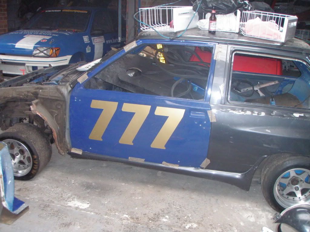

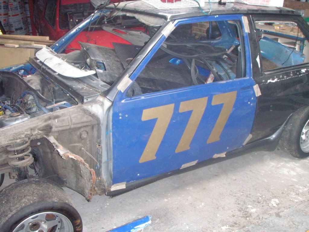

Did a very quick mock up of the new fibreglass door skin on the passenger side;
http://i285.photobucket.com/albums/l...ort/002-32.jpg
http://i285.photobucket.com/albums/l...ort/003-35.jpg
It fits pretty well, I shall put it on quick release pins so it can be completely removed when necessary. If I need to get out of the car in a hurry on that side, it will get kicked off!
colin, if you needed to get out that quick, i doubt if the door will still be there anyway.....any rules on drivers door as in stock hinges/catches etc??? or metal skin?
Door material is free, and there are no specific rules laid down for hinges/catches. But on the drivers side it's going to have to be conventionally hinged I think.Quote:
Originally Posted by mowgli
slap both doors on quick then.....
soon you'll run out of stuff to strip.....
did you hear the story of the skoda rally cars, where they did all they could to lighten them, then kept sticking the shells thru the factory acid bath to thin all the metal down..? they had lots of time & ideas, but no money to do it with.
until colin thrashes the car so much that the rivets come loose.Quote:
Originally Posted by burgo
normally people rivet and bond so the rivets dont rattle.

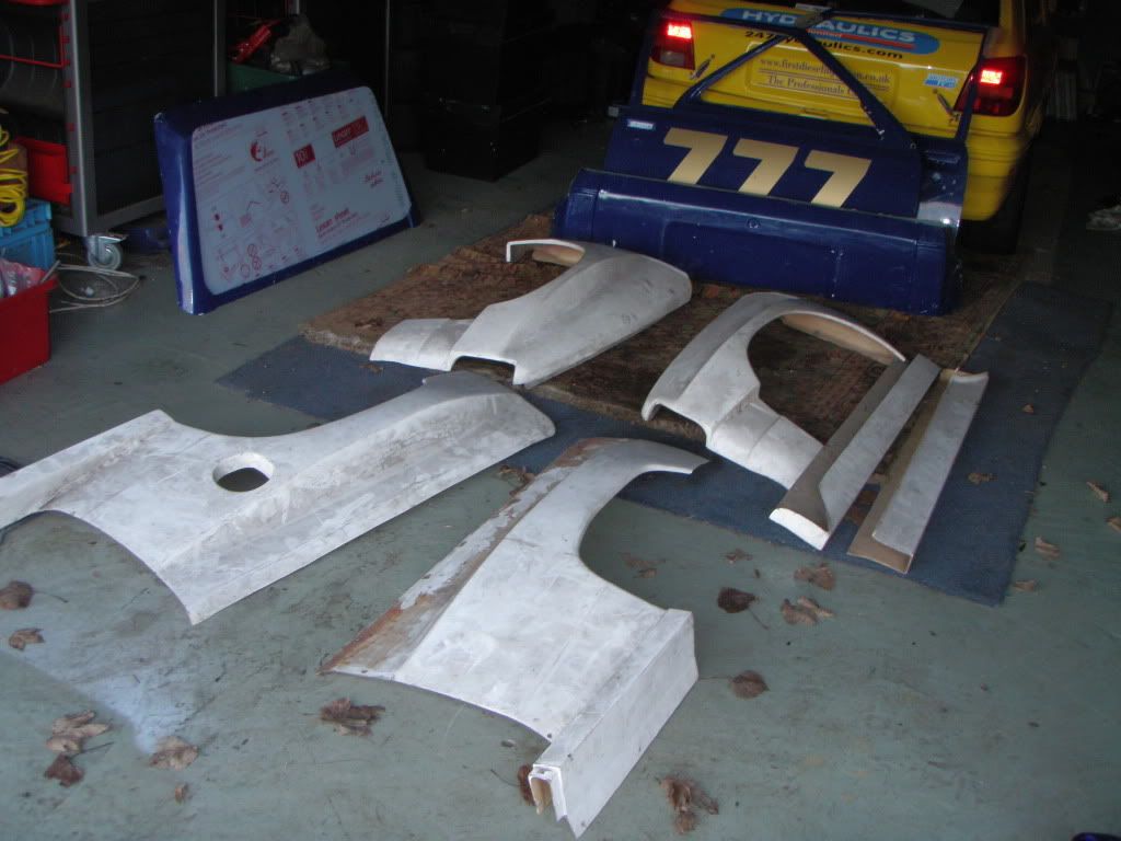

As for the wide kit if you don't use it it may be of use to Steve on his 4x4 nova?
decent bonding agents don't need rivets.. the rivets will induce cracks & cause things to fail.Quote:

Steve did say the wide arch kit might be of interest to him.
Is the wide arch kit a one off then? You should be getting moulds made Colin.

Wide arch kit is a one off, iirc colin got molds with it :) The kit came off my boss's brothers old stock nova. Nova acually got cut up and made into a trailor when he started his fencing company lolQuote:

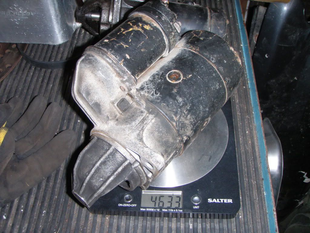

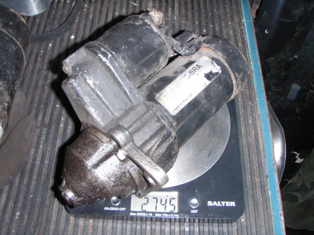

I've found nearly a 2kg weight saving from the starter motor which will be replaced when I get the car back.
Old starter motor;
http://i285.photobucket.com/albums/l...ort/002-33.jpg
'New' starter motor;
http://i285.photobucket.com/albums/l...ort/003-36.jpg
I now have another wide arch kit, which is more suited to my plans than the hugely wide Hot Rod kit that I acquired recently;
http://i285.photobucket.com/albums/l...ort/004-30.jpg

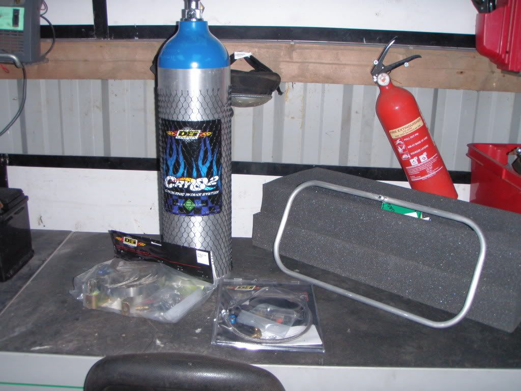

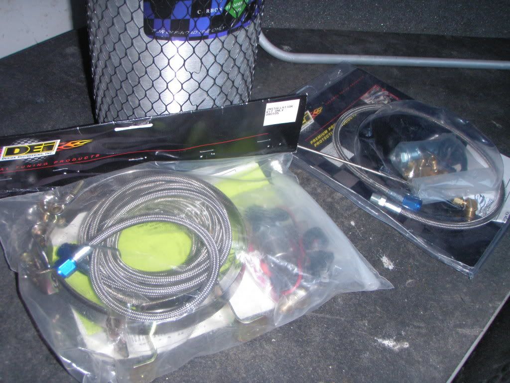

And I also have a CO2 intercooler spray kit which I plan to experiment with to reduce intake temperatures;
http://i285.photobucket.com/albums/l...ort/006-26.jpg
http://i285.photobucket.com/albums/l...ort/007-20.jpg
If it works, the tank will have to be replaced with something small and lightweight, as this is a huge 10lb tank, which is totally wrong for this car!

Looks good Colin. I didnt think there was much difference in weight in the starters lol

intercooler kit looks heavy :eek: lol can you not just wind the boost up a tad for that bit more power? :p
Is there any more weight you could shave off the starter with a grinder?

I was thinking the same - a few large holes in the 'nose' part of the starter wouldn't do any harm
It's actually really light - but only if you ignore the bottle! I'm sure there will be a lightweight bottle option available, bearing in mind CO2 is used in paintball applications.Quote:

http://cgi.ebay.com/Smart-Parts-Max-...item336462ba79
Forever finding them when searching for carbon bits lol
Bloody hell, 310 bar in that little thing! :eek:

I've just been browsing paintball tanks, and there are all sorts of them around.
Need to work out how much CO2 it will consume in a typical hillclimb or sprint run, and then decide if I want a tank which will need changing after every run, or one which will last the whole day.
This assumes that it works as I hope of course.......

i ran nitrous and co2 through a spray bar on both my nova and the cav and to be honest mate save the weight and dont bother as co2 is near useless in comparison to nos and nos is silly dangerous to use as s cooler spray
You have got to remember your turbo is sucking in all that nitrous after it hits your cooler with no added fuel and dumping it in your engine!
and take it from someone that knows it will cause lean running when used and melted pistons
my cryo bar was rigged to my purge valve for the gas and when you spray the cooler with nos you get instant ice on the cooler which is great but for a few seconds after the engine would pic up a few rpm and the wide band would go nuts as it sucked in the nitrous thats in the area causeing lean conditions that the ecu couldnt enrichen enough to sort it
best thing i ever did was fan jets small washer bottle volswagen washer jet pump and a little methonol mixed with water
i had mine atached to my turbo smart boost controller so it sprayed the cooler when set presures were reached and it worked better and safer than what any gas style spray i have ever used or tryed
problem was pod got funny about me using it but that wont bother you
imho you will be better of safer and lighter using water spray
or better still and the best option available aqua mist water injection
when your over sat i will show you the washer jets ect i used to create a mist and the whole set up cost less than 10 quid and is miles better than the 130 quid cryo spray bar 1k worth of zex nitrous setup and spare bottle for co2 option was
