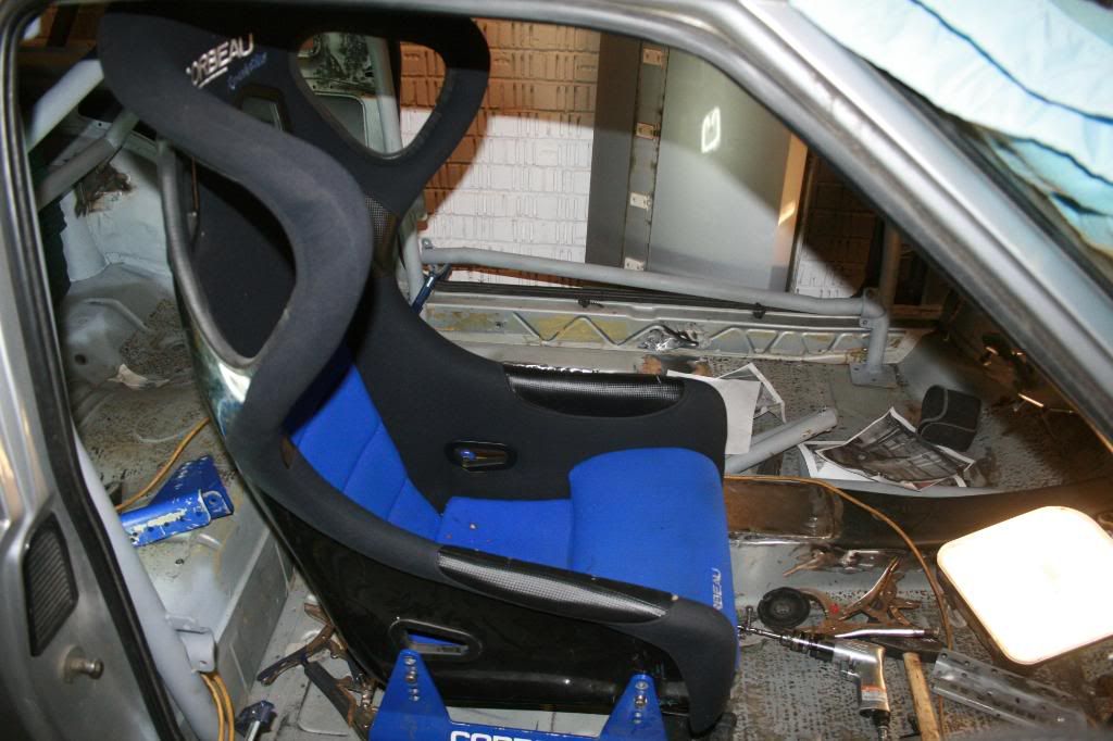

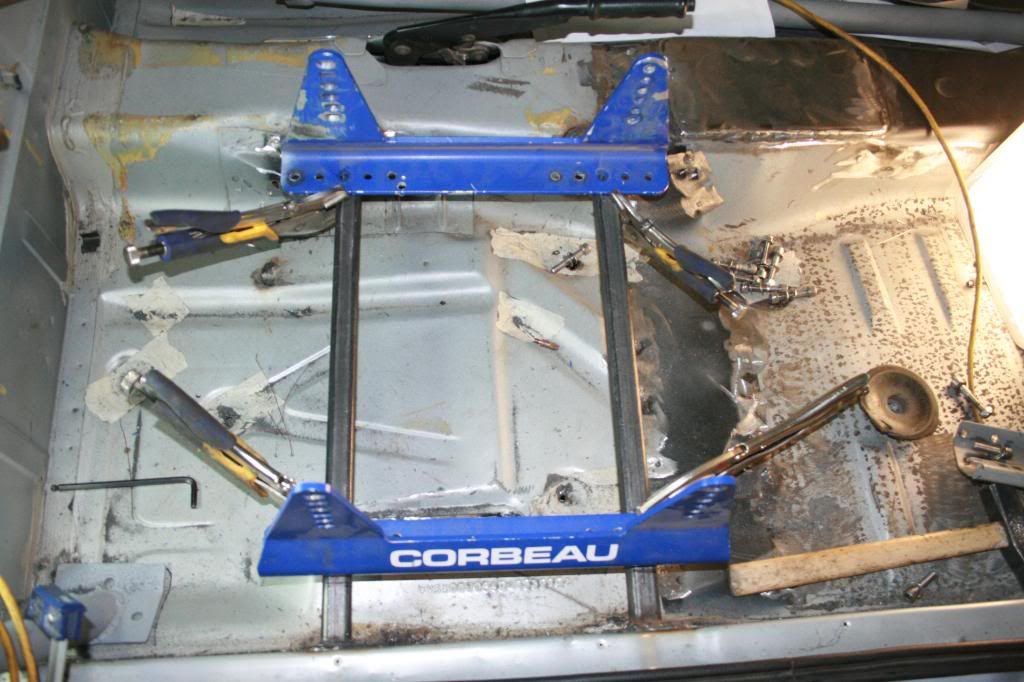

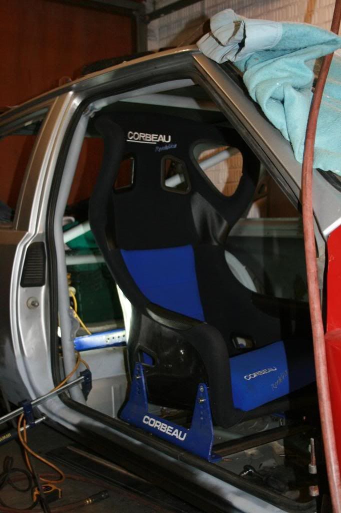

I did however get the drivers seat mounted, I started by fitting the seat to the sub frames then resting it on the new rails and positioning it in a comfortable position.
I found the most comfortable position for the seat was the front slightly turned in towards the centre of the car and the seat close to the exhaust tunnel.
Once it was positioned i clamped the subframes down and removed the seat allowing me to mark out the holes as so
http://i248.photobucket.com/albums/g...ndseats068.jpg
Then i drilled the holes and fitted it all back into place - it fits yay!
http://i248.photobucket.com/albums/g...ndseats069.jpg
http://i248.photobucket.com/albums/g...ndseats071.jpg
PS the box didn't collapse lol

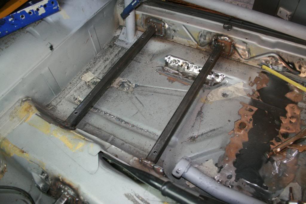

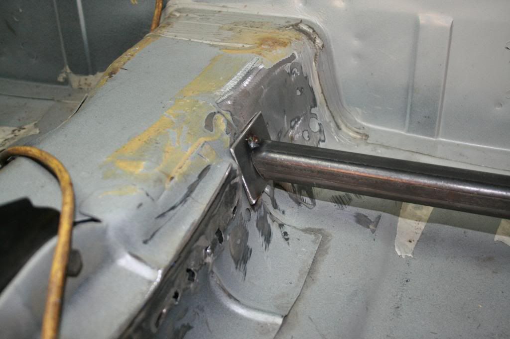

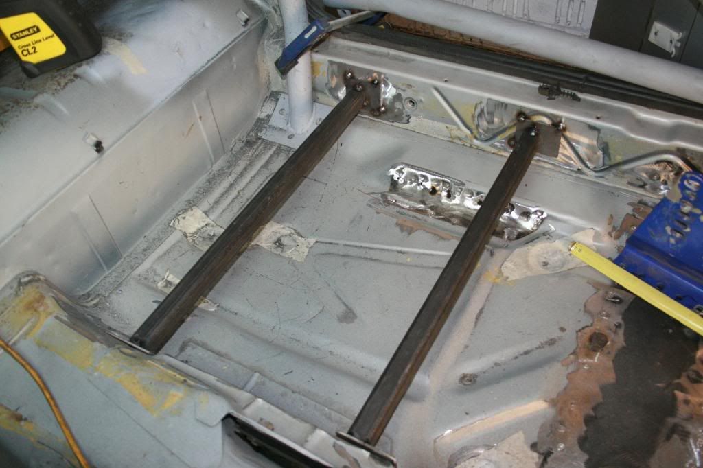

Got on with the other seat rails tonight
Started with this
http://i248.photobucket.com/albums/g...ndseats072.jpg

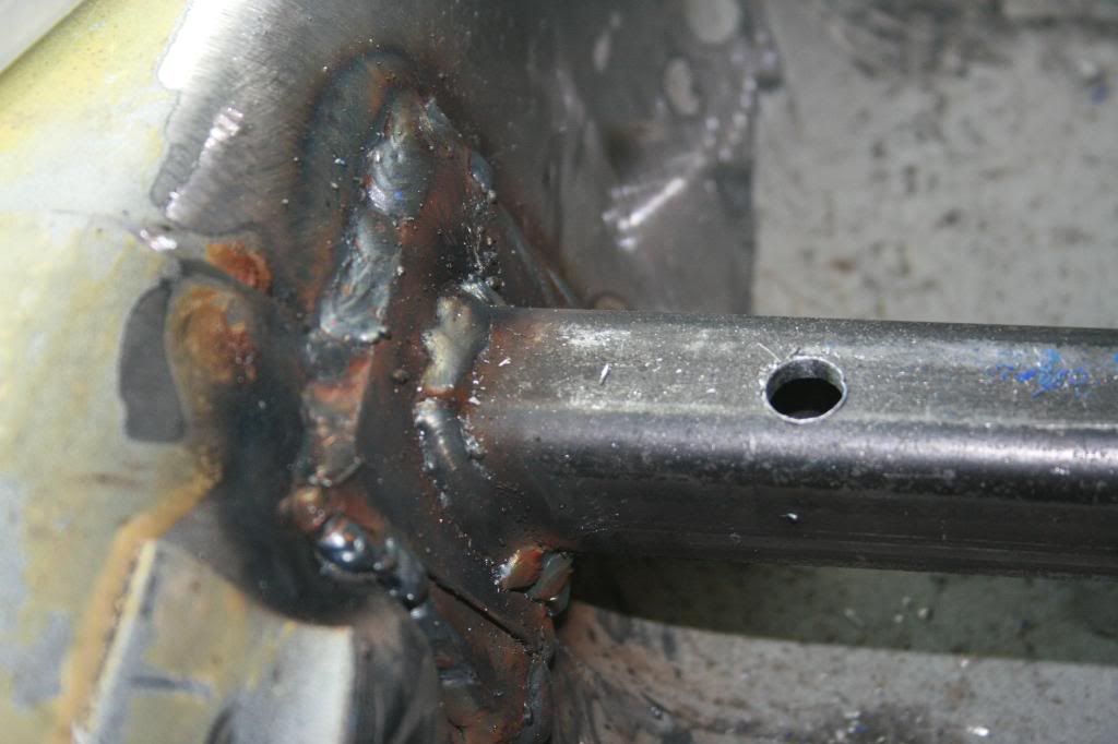

Tacked it all in as before allowing for slight adjustments to make sure everything was level
http://i248.photobucket.com/albums/g...ndseats073.jpg
http://i248.photobucket.com/albums/g...ndseats074.jpg
And the front rail
http://i248.photobucket.com/albums/g...ndseats076.jpg
http://i248.photobucket.com/albums/g...ndseats075.jpg

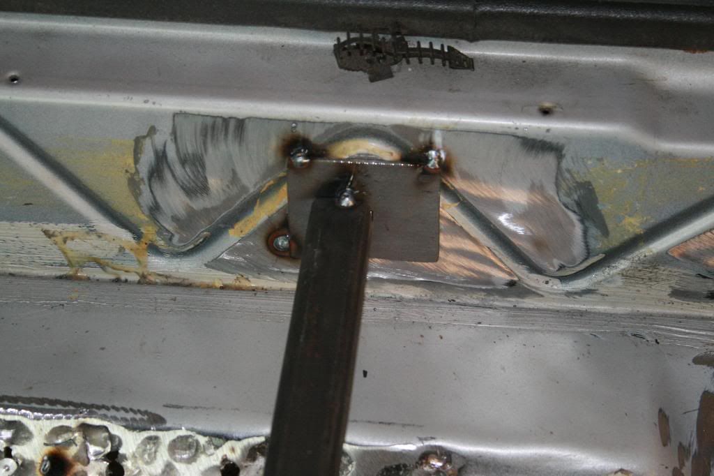

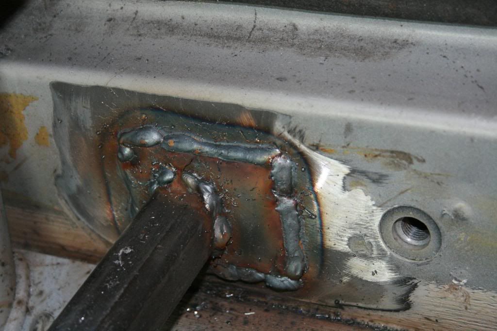

Then welded it in and drilled the holes for the subframes
http://i248.photobucket.com/albums/g...ndseats081.jpg
http://i248.photobucket.com/albums/g...ndseats082.jpg
http://i248.photobucket.com/albums/g...ndseats083.jpg

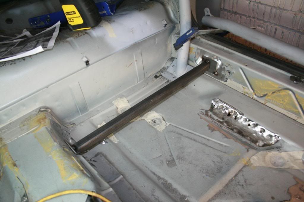

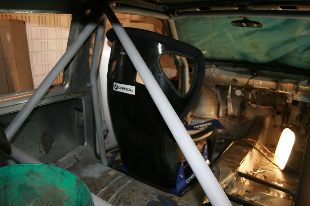

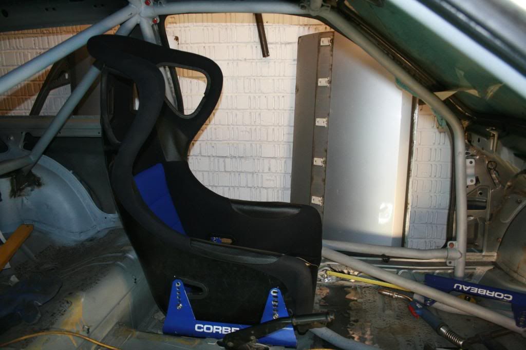

The passenger seat is further back and lower down allowing fro better weight placement in the car and it also gives the driver a better view to the N/S :thumb:
http://i248.photobucket.com/albums/g...ndseats077.jpg

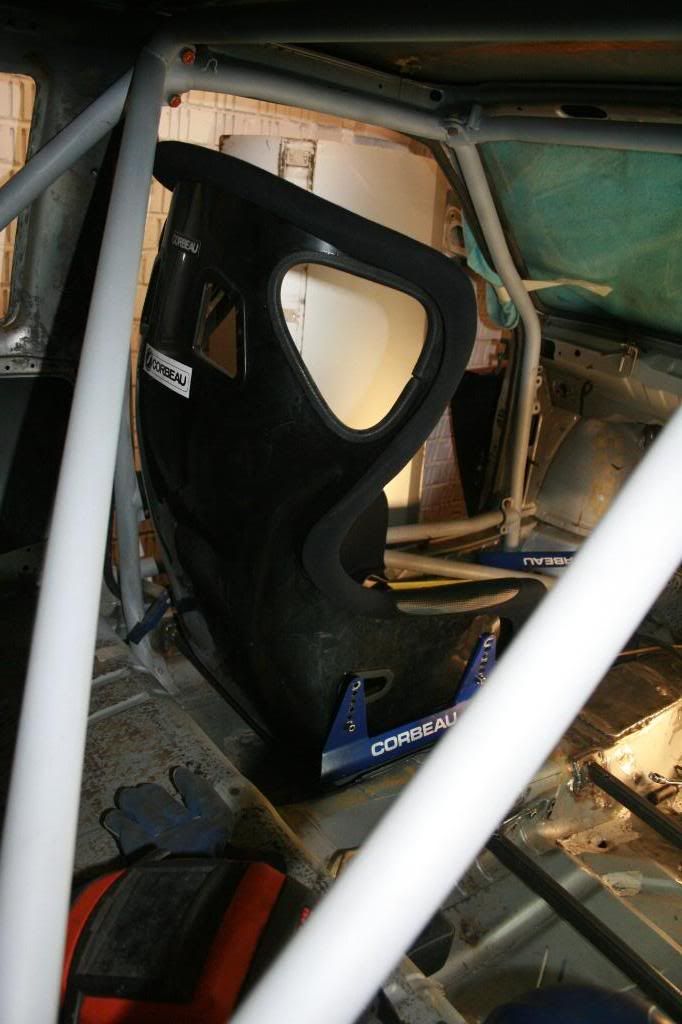

And here is the seat in place - quite close to the cage
http://i248.photobucket.com/albums/g...ndseats078.jpg
http://i248.photobucket.com/albums/g...ndseats079.jpg
http://i248.photobucket.com/albums/g...ndseats080.jpg

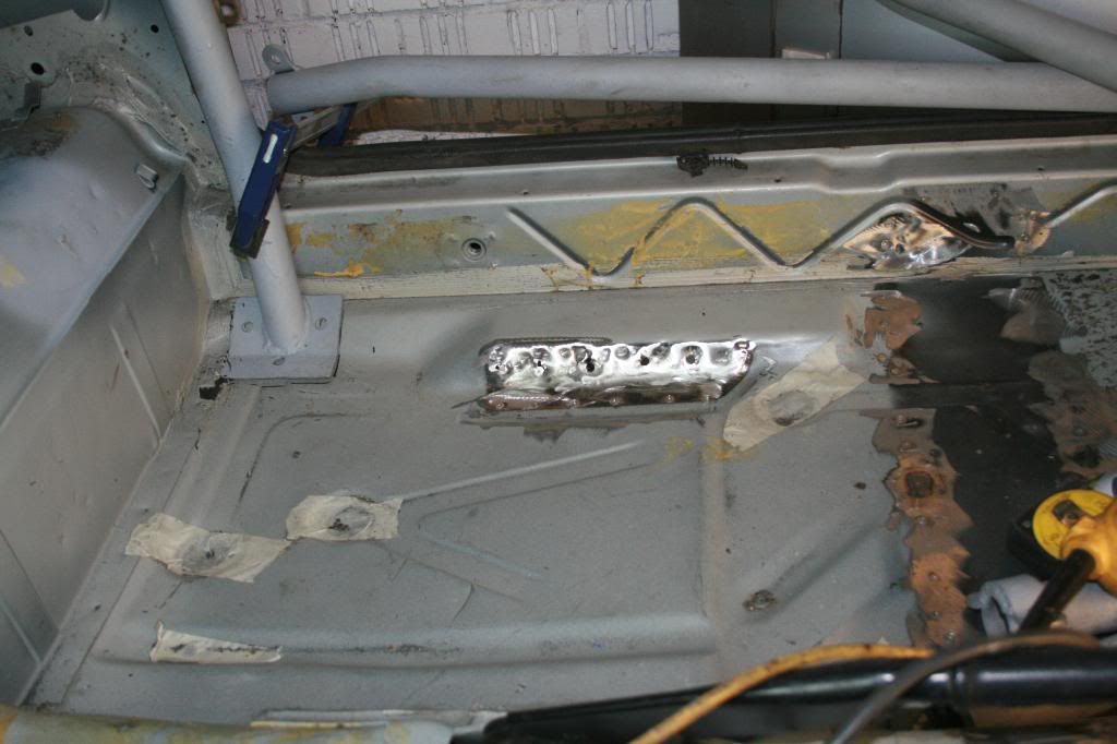

Ive also repaired all the holes in the floor where the spot weld removal didn't go as planned lol
