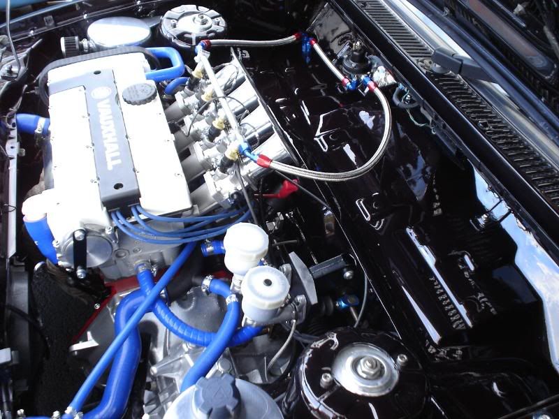

fair dos to your mate, how longs the inlet runners now from the butterly to the divide in the ports now...ish?

The bracket is to support the rear of the manifold, a bit like a oe xe one has ;)Quote:
Originally Posted by peester
It is the BTB/SBD one, fits wet sump engines, he did have a Bowyer developed Tony Law manifold but it didn't fit with the dry sump pump mounted on the front so he sold that.
Phil, the spacers are 75mm iirc, then 90mm trumpets, then the tb casing and then the manifold so a fair bit lol I'll get you a exact measurement if you like.

You still do the throttle body extensions?
Yes mate, got 4 on the shelf at the minute, 75mm ones same as Ben is using.
They can be made in any size though to fit before or after the tb

My origonal plan was to run with a 'sausage' air filter.
If you see by the pic it just wont fit due to fuel rail.
I was thinking of using the spacer between the throttle body & trumpet, then i will get clearance for a filter.
What does it do to engine performance having a longer inlet?

I'll ask him for you :thumb:Quote:
Originally Posted by grooge
Hi Martin,Quote:
Originally Posted by MARTIN KELSON
A longer inlet tract will usually gain you some torque, were not talking a lot but obviously its another way of getting a little, in your case it has 2 benefits as you will get over your clearance issues.
