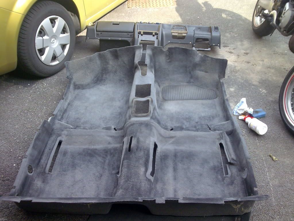

Got a set of ccarpets and a GSI dash which i gave a dam good clean!
http://i215.photobucket.com/albums/c...4/Image007.jpg

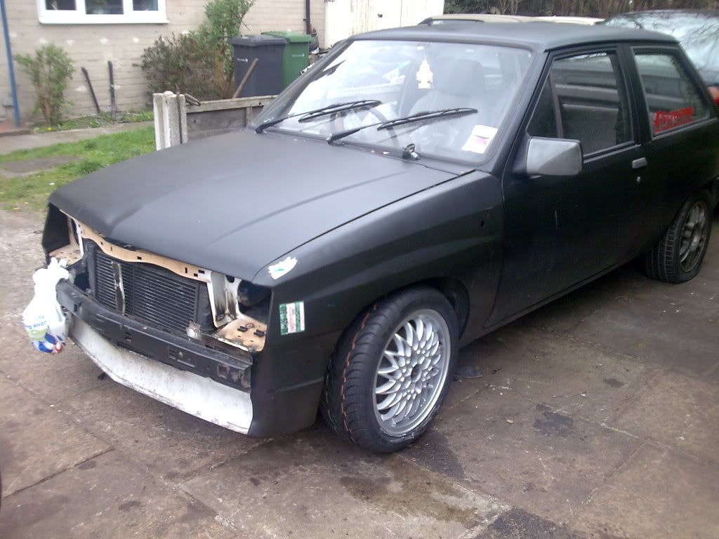

Got some more done on it all the shafts are in, well welded shafts for the time being so i could put the car back on the floor with all the suspension and brakes mounted up,
What colour do you guys think? keep it matt black?
http://i215.photobucket.com/albums/c...4/Image034.jpg
http://i215.photobucket.com/albums/c...Image008-1.jpg
