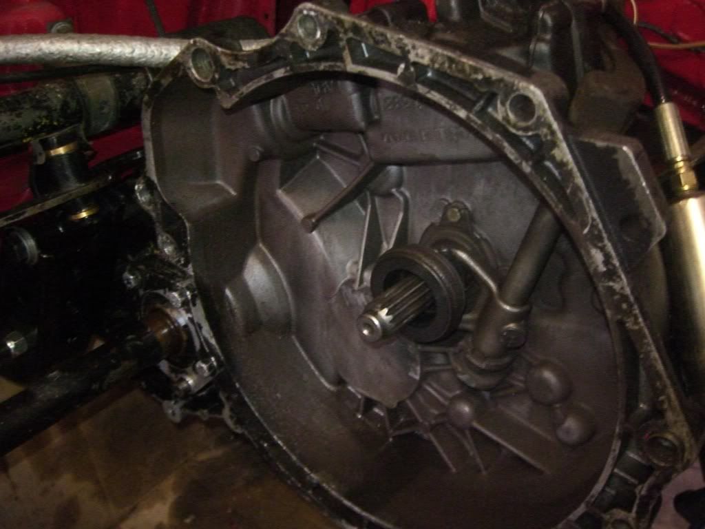

Then i set to on the hydraulic clutch setup which took longer than expected as i rounded the allen key out so out came the drill:
http://i217.photobucket.com/albums/c...1/CIMG1925.jpg
http://i217.photobucket.com/albums/c...1/CIMG1926.jpg
http://i217.photobucket.com/albums/c...1/CIMG1927.jpg
All fitted:

How come youve gone to a hydraulic clutch setup?
Is there any benefit over cable? Apart from being more complex.
Running the twinplate clutch meant theat clutch cables did not last very long.Quote:
