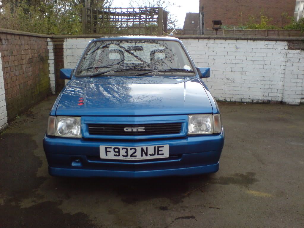

that dent needs pulling out the front bumper, other than that looks spot on.. dont go pins for the bumper lol
ive got a new front bumper which i got off novarally.nice and straight but he neglected to mention the crack in the corner.
smoothing it off,got my bonnet and front and rear bumpers booked in to be resprayed on the 17th of march.so car should definately be ready for 1st of april!!

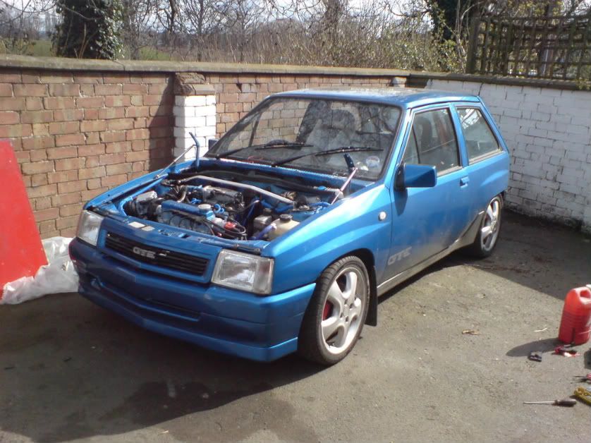

right,been a while since i updated this.but tbh i havnt done alot.
had my bumpers sprayed with my bonnet.collecting bonnet tomorrow.
http://i193.photobucket.com/albums/z...DSC01058-1.jpg
http://i193.photobucket.com/albums/z...DSC01060-1.jpg
got a set of samco hoses off ebay.so was able to let it warm up properly and get the distributor timed in correct.
even though im still getting a mis-fire and the emmisions being way out still.im kinda stuck for what to do.but seeing how th car runs fine when seting the timing.(due to the TPS being bridged and running basic ignition timing)so seeing how last year the car never had the TPS connected for some unknown reason i think thats why it was left un plugged because of it being funked.
going to try source another and see what happens.
took it for a quick spin round a yard at work an the brakes are pretty crap.pedal goes near enough to the floor so got to look at that too.
also the tracking is miles out,got half a day off tomorrow so hopefully sor that.
needs to be mot'd next week so i can tax it for the week after,then have it on the road!!!:D
gotta give it a good and proper clean,bit dirty.lol
thanks for looking.

right,been along time since i've updated this.
got all my body panels back an fitted,car looked like this when it was all back together,
http://i193.photobucket.com/albums/z...8/DSC01065.jpg
needing to get it running properly kept me at my wits end.
having my alternator repaired and ordering a new throttle position sensor got it running at lot better than it was.still had a miss-fire though and eventually just gave up all together.
also seeing too much blue smoke from the exhaust ment i hadnt put the valve stem oil seals on correctly. thinking im a complete doughnut i had to bite my tongue an take it apart again.
using an old mechanics trick, i got the piston to TDC and compressed the valve springs down while i removed the collets,this ment i could remove the springs and see the seals.
http://i193.photobucket.com/albums/z...8/DSC01075.jpg
got the new ones back on and assembled everything yet again.deciding to use the standard cam pulley rather than the vernier for know ment i can make sure it runs how it should without all these variables which could affect the running.
having set it up and got it running again, i opted to get the ignition timing spot on.so,got the timing light out and it was way out, turning the distributor to get it to where it should be just made the engine run worse.so i gave up and went to cry.lol
looking around to find why it wudnt run correctly i found my coil was a bit duff.got a new one from my boss and fitted it. it ran alright but not the best.got back to ignition timing and this time i could turn the distributor to get it smack bang on the pointer.

not too keen on the red bonnet vent, but other than that it looks spot on, very very nice
is the rear bumper smoothed too? :thumb:
its red mesh in the holes and no the rear bumper isnt smoothed.didnt have enough time to do it and not sure if it would look good?!?Quote:
