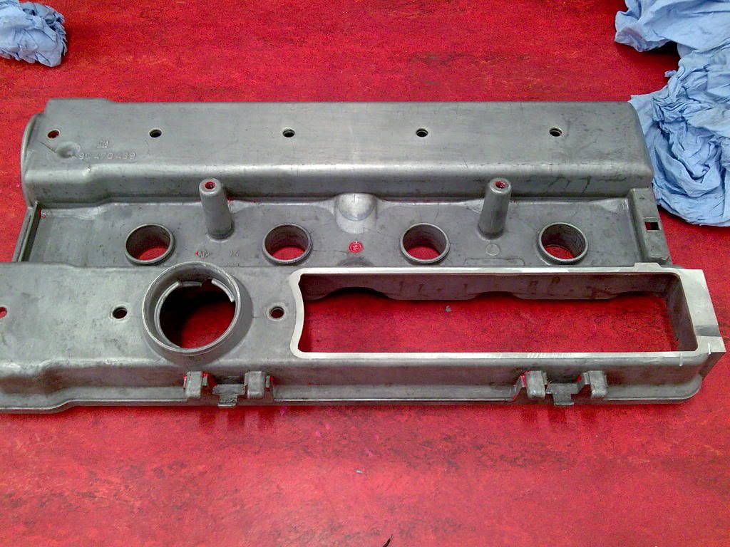

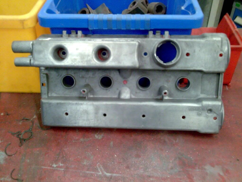

Not much of an update. Had a quiet half hour last night at work so decided to make a start on modding my cam cover for the dry sump system
Started like this:
http://i227.photobucket.com/albums/d...d/Image006.jpg

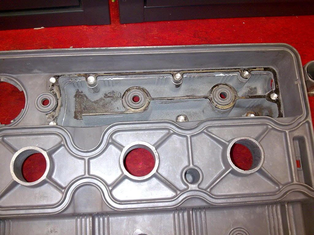

Removed the plate with the breather on from the underside of the cover by drilling the rivets:
http://i227.photobucket.com/albums/d...d/Image009.jpg

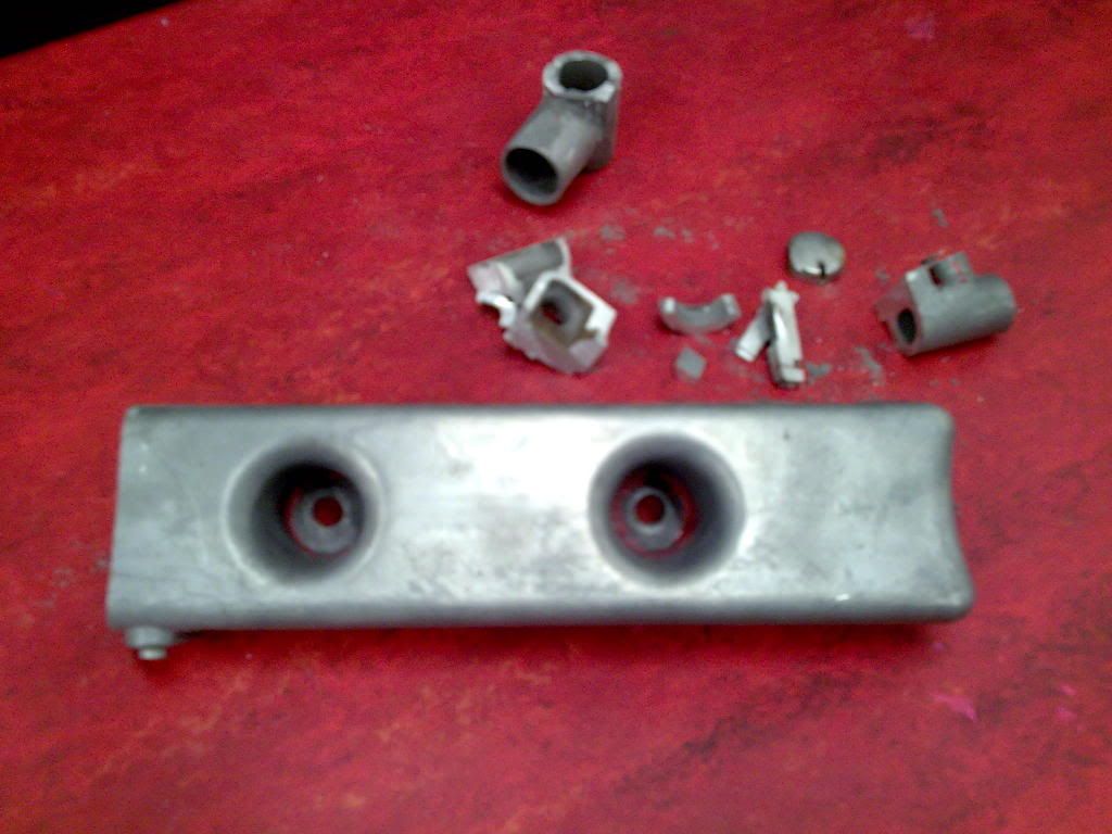

Removed this with the angle grinder (going to use this piece as a test piece for welding not sure what it will weld like being die cast):
http://i227.photobucket.com/albums/d...d/Image012.jpg

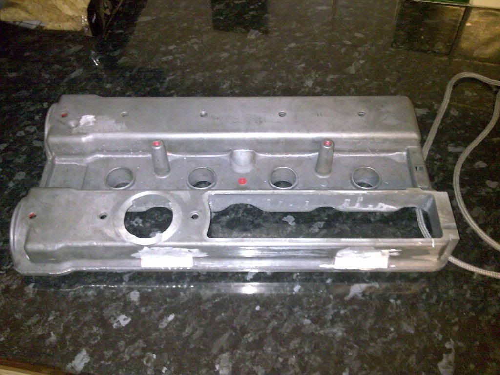

I then clamped it up on the bridgeport and milled off the excess ally:
http://i227.photobucket.com/albums/d...d/Image018.jpg
This is as far as i got:
http://i227.photobucket.com/albums/d...d/Image019.jpg

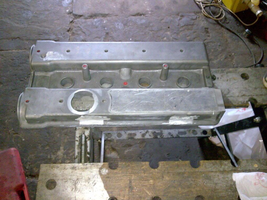

Going to make a plate tonight to fill the hole, may even get chance to fire up the AC set and weld it in. Still unsure whether to remove th oil filler as well as it wont be used? Opinions?
Off to bed. Night :)
Nice. No oil filler cap would look cool :cool:
Remove the front/top lugs too that hold the standard engine cover on ;)
Good point :thumb: will do that tonight.
Decided to remove the oil filler and lugs. Should look smooooothe when painted.
