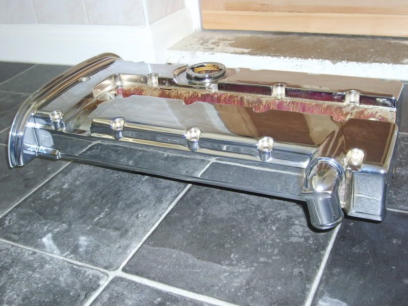

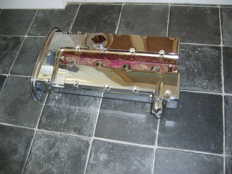

Also I carried on with my rocker cover, I wanted to prepare my own parts for the chroming company as I know the finished articles will be even better If I took my time to remove all the pitting and rough surface etc also hopefully it should make it a little cheaper too!
Rocker cover fully prepared down to 3000 grade!
http://i84.photobucket.com/albums/k2...g?t=1195924188
http://i84.photobucket.com/albums/k2...g?t=1195924205
http://i84.photobucket.com/albums/k2...g?t=1195924223
http://i84.photobucket.com/albums/k2...g?t=1195924241
This took so mega hours to do properly but hopefully should be worth it!

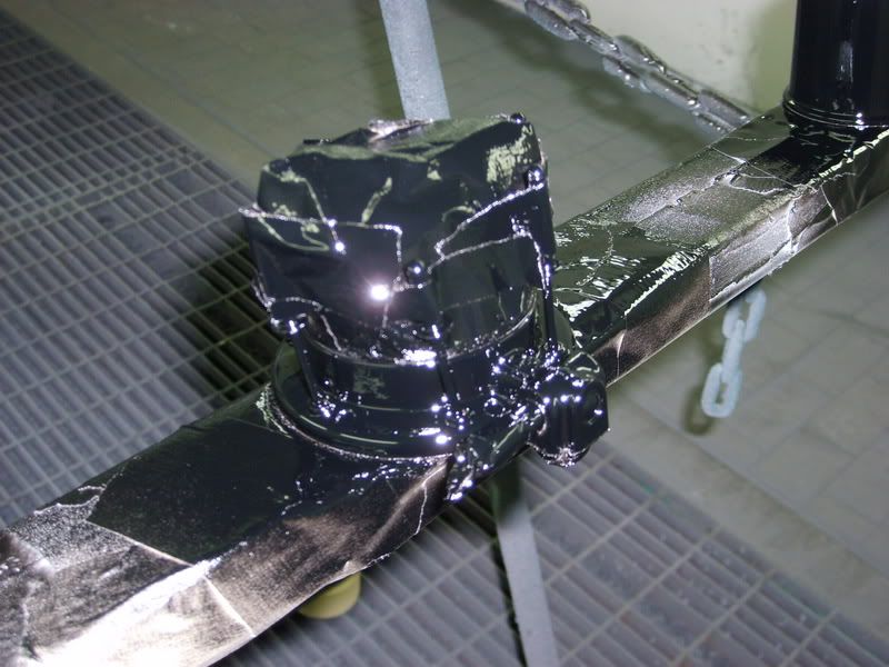

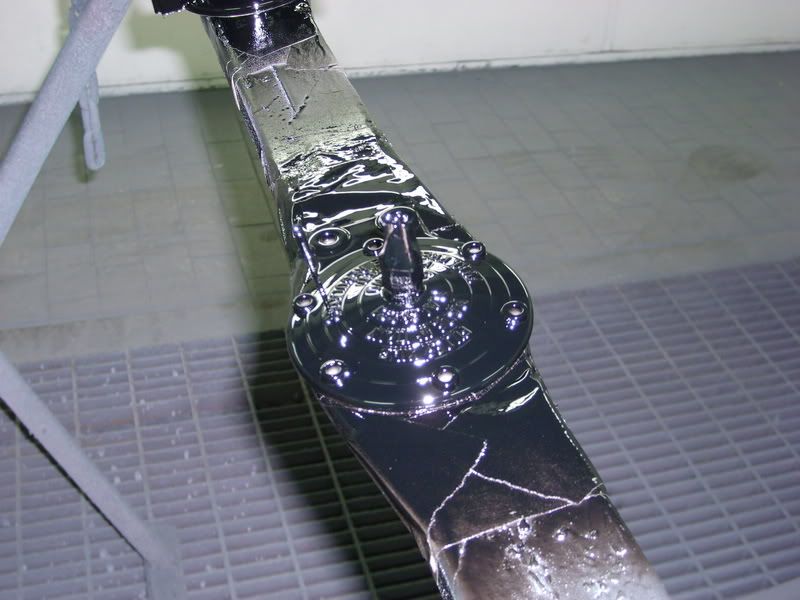

Another part I've recently finished is a front wiper motor... I actually got worried as I'd stripped it completely and it was in so many pieces I thought It would never work again! But after putting it all back together a quick check with the power probe proved it worked and I hadnt wrecked it!
All painted up gloss black.......
http://i84.photobucket.com/albums/k2...g?t=1195924796
http://i84.photobucket.com/albums/k2...g?t=1195924813
http://i84.photobucket.com/albums/k2...g?t=1195924828
http://i84.photobucket.com/albums/k2...g?t=1195924849

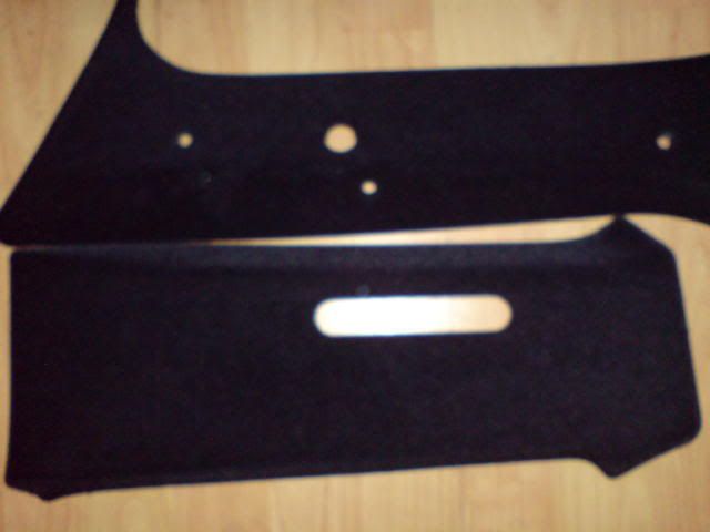

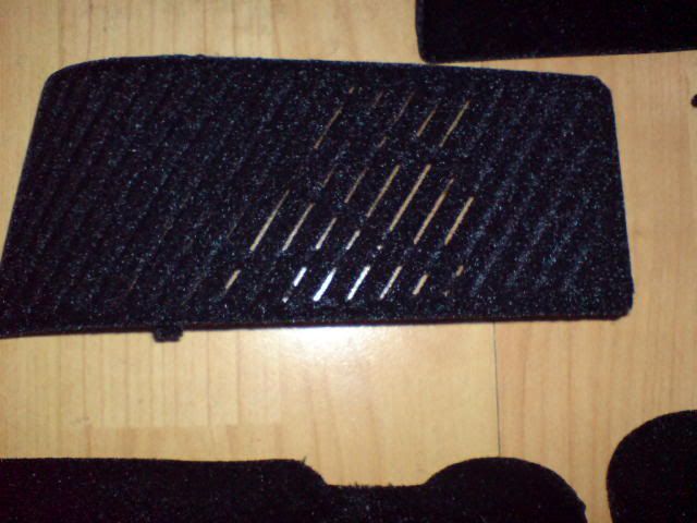

The following went to Raj at autoflock.......
http://i84.photobucket.com/albums/k2...o/DSC00526.jpg
http://i84.photobucket.com/albums/k2...o/DSC00529.jpg
http://i84.photobucket.com/albums/k2...o/DSC00531.jpg
http://i84.photobucket.com/albums/k2...o/DSC00532.jpg

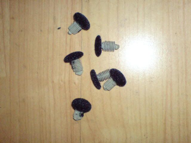

A,B pillar trims,sunvisors,inserts,speaker covers and I had a spare fuse box cover done as the one that was previously flocked was'nt covered properly on the top edge... Im thinking the flocked pillar trims should go great next to the rear carbon cards that are already in place and Although the dash had already been flocked the speaker covers and dash surrounds on the top were not done so Ive had some of these done to match.... However something a little more special awaits the other dash/ interior parts! Big thanks to Raj by the way as the work is excellent and cost me a mere £35 delivered back to me for all of the above!

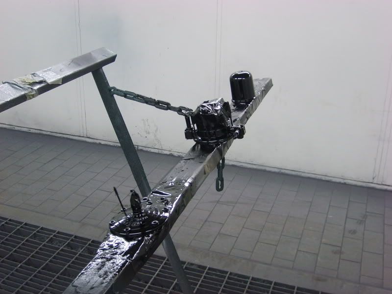

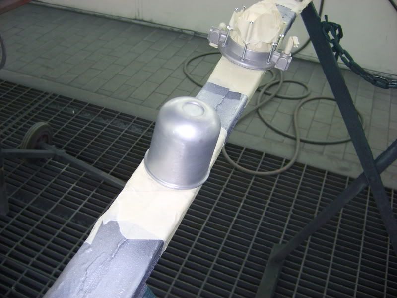

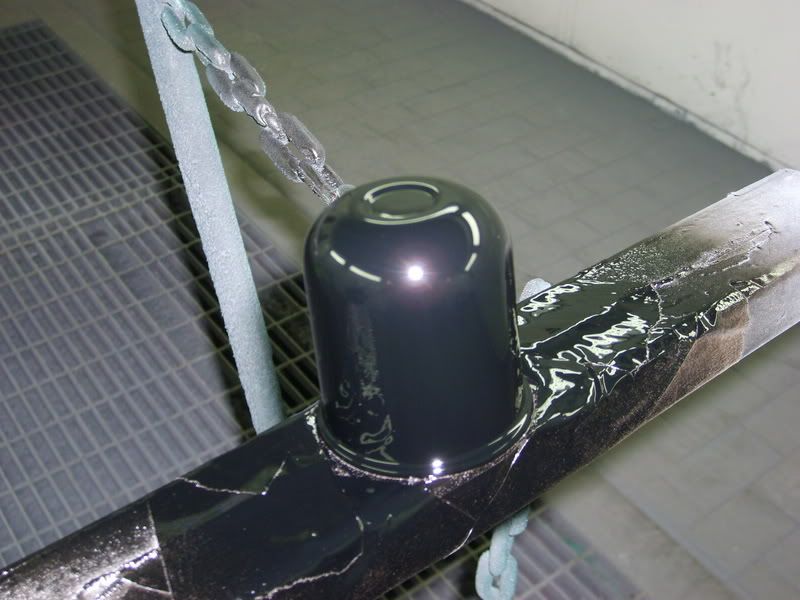

Again I kept looking at the bay to see were I could improve it... I decided that the fuel pressure reg/Filter was going to get it! Bmw 668 gloss black style! Not an easy task though probably the most fidly item Ive ever masked! But well worth it....
All stripped/rubbed and masked....
http://i84.photobucket.com/albums/k2...novawip005.jpg
http://i84.photobucket.com/albums/k2...vawip007-1.jpg
http://i84.photobucket.com/albums/k2...vawip003-2.jpg
I had to place rivets in the reg housing to prevent paint getting into the threads... also using a trusty belt sander I ground down another rivet to fit the reg breather hole in the top. And heres how it turned out....
http://i84.photobucket.com/albums/k2...novawip022.jpg
http://i84.photobucket.com/albums/k2...novawip016.jpg
http://i84.photobucket.com/albums/k2...novawip014.jpg
http://i84.photobucket.com/albums/k2...novawip015.jpg

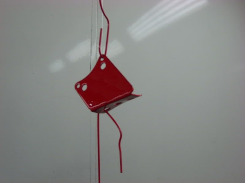

The bracket that holds the pressure reg had been previously painted matt black however as it bolts to the strut top I decided it would be good to paint it bodycolour being ferrari rosso corsa...
Into the paint stripper it went and a quick rub later it was lined up ready for paint...
http://i84.photobucket.com/albums/k2...novawip010.jpg
And painted....
http://i84.photobucket.com/albums/k2...novawip017.jpg

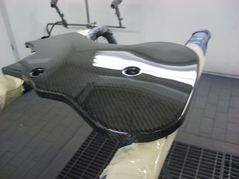

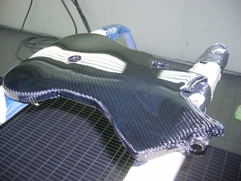

Still continuing with the engine bay I decided that my carbon cambelt cover was looking a little dull so off it came for a freshen up...
All rubbed and ready for action..
http://i84.photobucket.com/albums/k2...vawip001-2.jpg
http://i84.photobucket.com/albums/k2...vawip002-1.jpg
A few coats of sealer followed by a few coats of lacqeur and we have one fine looking cambelt cover........
http://i84.photobucket.com/albums/k2...novawip025.jpg
http://i84.photobucket.com/albums/k2...novawip026.jpg

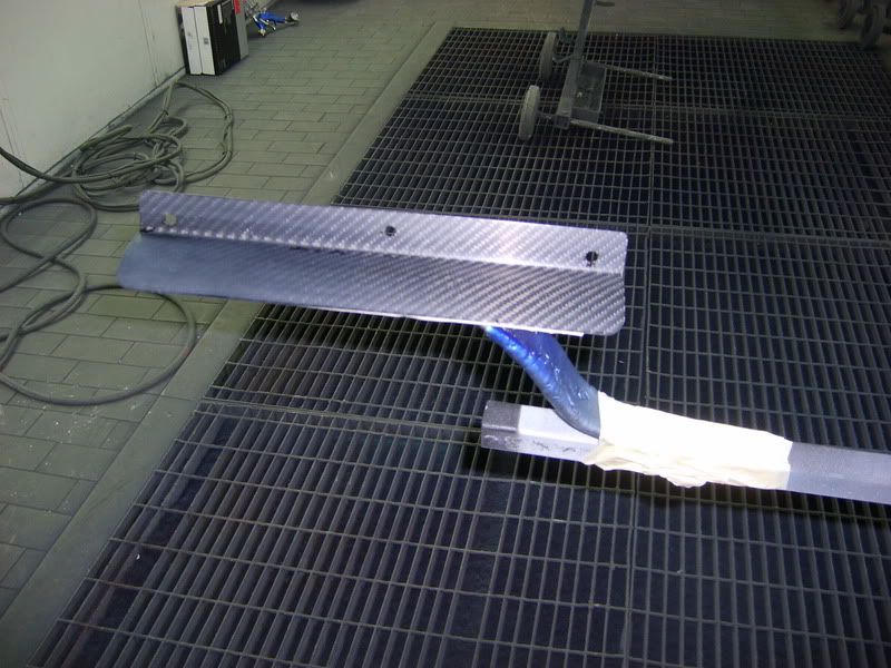

I had also purchased a carbon heatsheild to go with other carbon items under the bonnet but when it arrived it was also rather dull :( And obviously is was going to get rather hot so I didnt fancy giving it my normal treatment... But one of the guys I work with mentioned using a high temp lacqeur on it, As I wasnt happy with the item I thought I may as well give it a try, Heres the outcome....
From this.....
http://i84.photobucket.com/albums/k2...ovawip2007.jpg
To this....
http://i84.photobucket.com/albums/k2...ovawip2012.jpg
A hell of an improvement Im sure you'll agree!

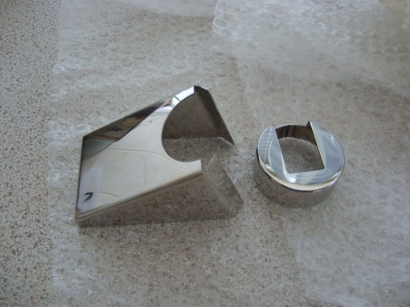

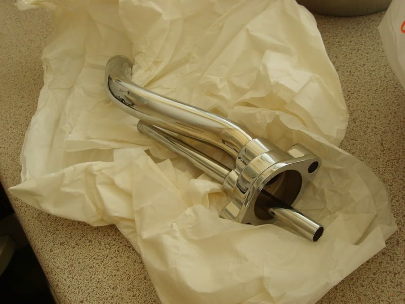

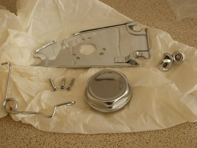

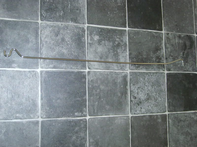

Whilst I was on with the bits and pieces mentioned earlier my local chroming firm were on with numerous bits for me, Im not a huge fan of a huge mass of chrome but little bits here and there I think look well..
Heres some items Ive had done...
http://i84.photobucket.com/albums/k2...utday012-1.jpg
http://i84.photobucket.com/albums/k2...utday013-1.jpg
http://i84.photobucket.com/albums/k2...utday014-1.jpg
http://i84.photobucket.com/albums/k2...utday015-1.jpg
http://i84.photobucket.com/albums/k2...utday016-1.jpg
http://i84.photobucket.com/albums/k2...utday017-1.jpg
http://i84.photobucket.com/albums/k2...utday018-1.jpg

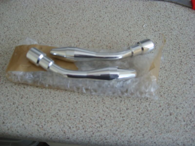

Also I had clive at custom solutions make me this up a while back but although its extremely well made Im a little unsure whether I'll use it as yet...
http://i84.photobucket.com/albums/k2...utday025-1.jpg

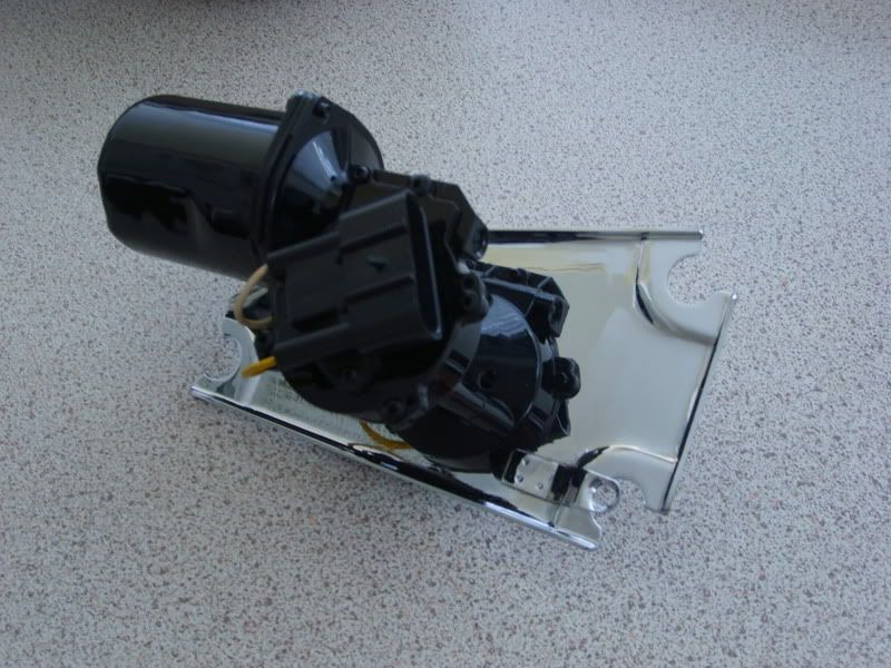

Heres the wiper motor I painted earlier in the year mounted up on the chrome backplate.....
http://i84.photobucket.com/albums/k2...utday028-1.jpg
New cam cover gasket,cambelt cover seal and grommets....
http://i84.photobucket.com/albums/k2...utday027-1.jpg
http://i84.photobucket.com/albums/k2...utday023-1.jpg
