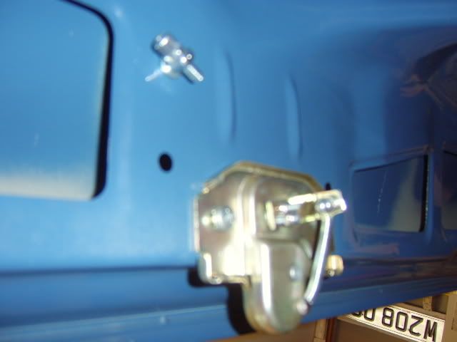

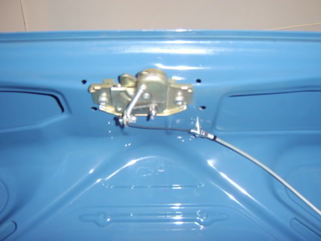

Started by fixing the cable stop at the lock. And also a return spring which is from the plate holder.
http://i73.photobucket.com/albums/i2...ell/cable1.jpg

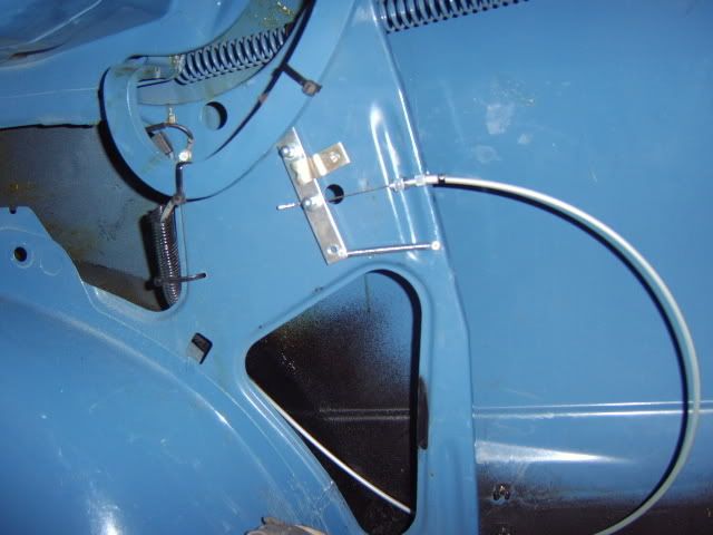

Then routing the cable.
http://i73.photobucket.com/albums/i2...ell/cable2.jpg
Drilling and cable tying as I go, being careful not to damage the outer skin with the drill bits as the two skins are very close.
http://i73.photobucket.com/albums/i2...ell/cable3.jpg

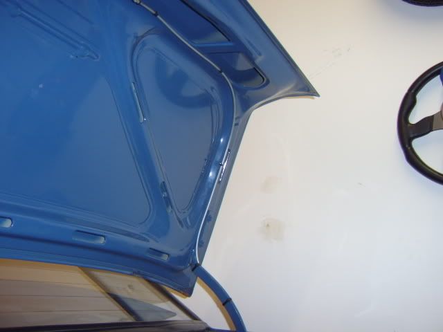

I have to overcome the fact that the cable needs to be loose as it will travel with the hinge but be secured to the inner panel. So have coiled it up as loosley as possible to reduce friction on the cable.
http://i73.photobucket.com/albums/i2...ell/cable4.jpg
http://i73.photobucket.com/albums/i2...ell/cable5.jpg
Adjusted the cable as required, the lock opens with only 40mm pull on the cable. I do not know how much pull the lever I will use will give, but the way I have done it, it won't matter as the front cable can be fixed to the lever anywhere. Have also formed a stop and sprung this lever to. With the rear light removed, I can reach in, push the lever and the boot opens slowly.

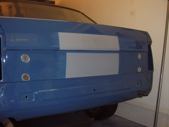

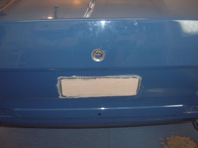

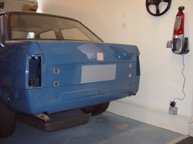

Also finished off the smoothing of the rear panel and the boot lid.
Prepared the fibreglass for filler with that thing I got from B&Q yesterday. Then applied the filler. Whilst that was going off I cleaned the lock hole down to bare metal using a combination of that thing I got from B&Q, sandpaper and a sharpened small flat screwdriver.
http://i73.photobucket.com/albums/i2...nell/boot1.jpg
My loving wife kindly took the bootlid round to a mates to weld a plate over the hole, whilst I rubbed down the filler for another thin coat, then rubbed down and a quick coat of primer.
With the bootlid back, applied a thin layer of filler over the plate.
http://i73.photobucket.com/albums/i2...nell/boot2.jpg
Again, same process as before.
http://i73.photobucket.com/albums/i2...nell/boot3.jpg
