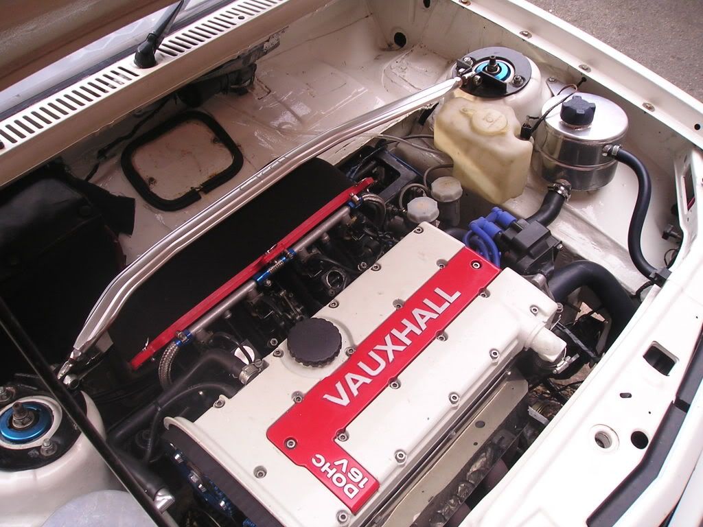

:) that is just porn in an engine bay :thumb:
Just read this from start to finish and I have to say Fantastic Work Chris!!! Look forward to seeing it at some shows/track days this year. Well done :thumb:

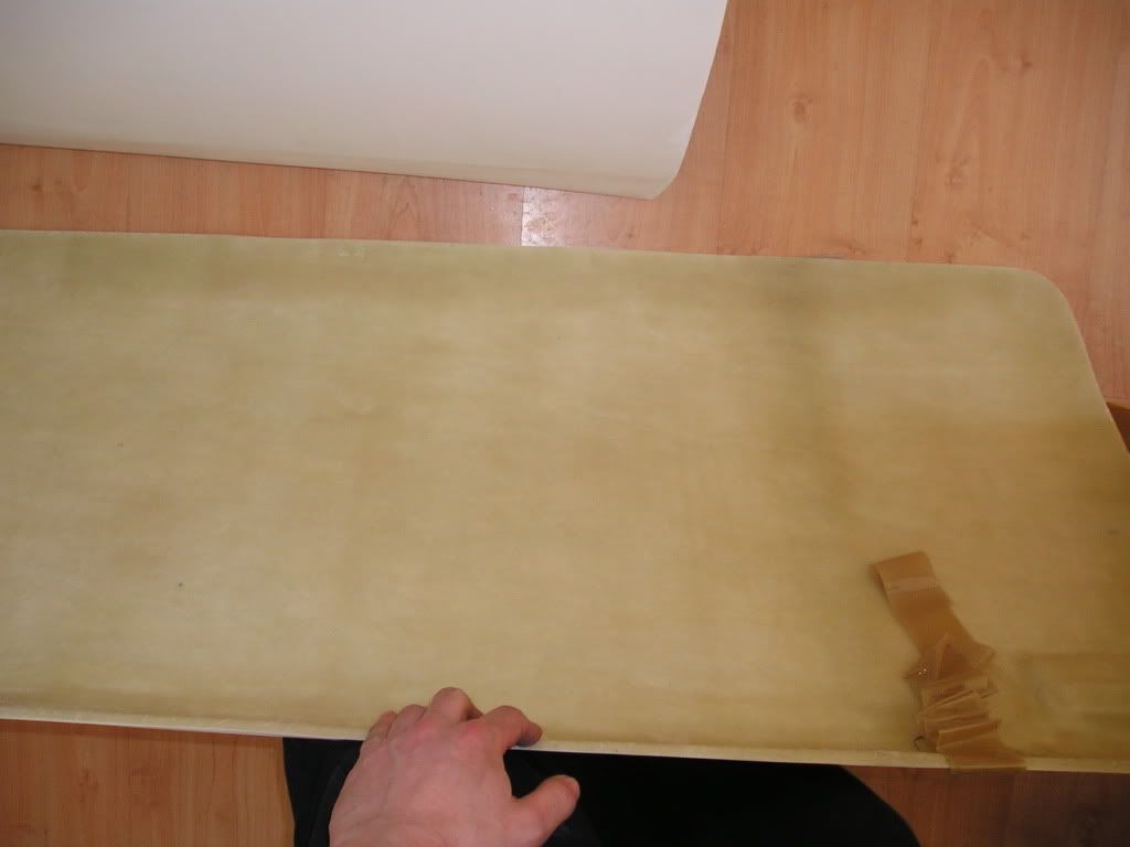

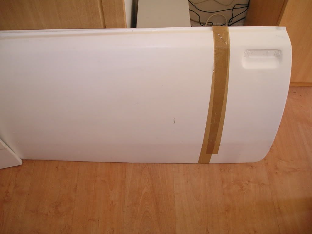

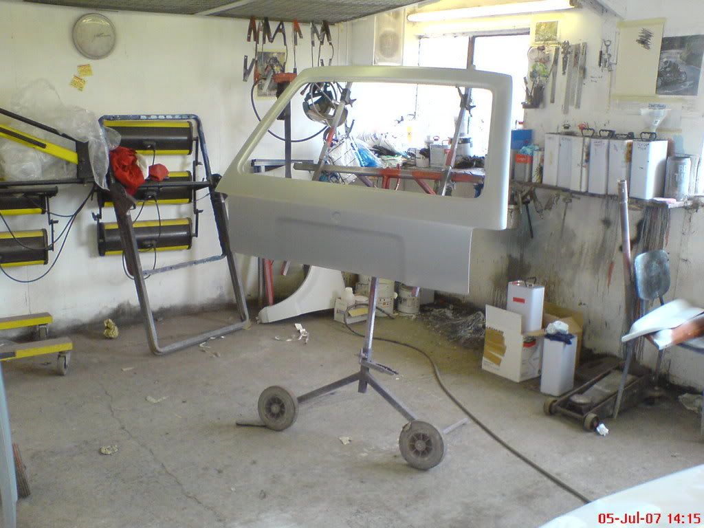

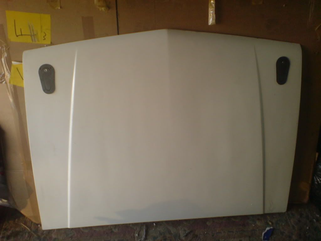

not much to report lately on the build. but been buying in parts for the final clean up. Some new rear arch's (mine were ok but this gives me a chance to mod the rears how id like) also orderd a bonnet and boot hatch amongst things. Then its up to me mates to have it all sorted out. so should have some progress pictures of the body work in progress..

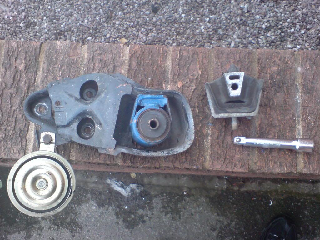

Replacing the ruer mounts for solid finally.. just waiting for one more to turn up.

Some further purchases that have turned up. still a few to arrive.
slowly getting there tho!

Where is the bonnet from? Eurorallye?
all from magnum motorsport. quite decent to be honest. just a little prep needed before painting. :)
They dont need painting, will blend straight in to your nova chris lmao

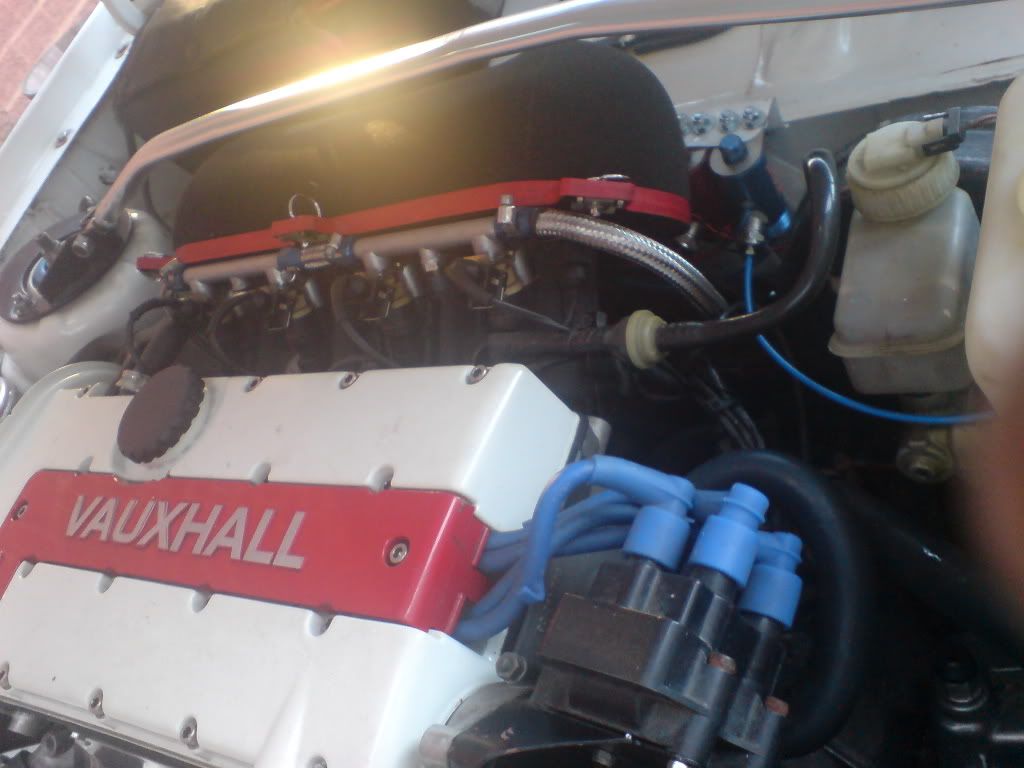

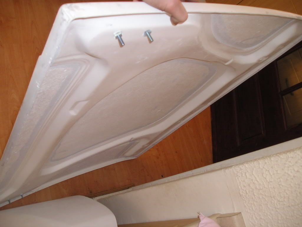

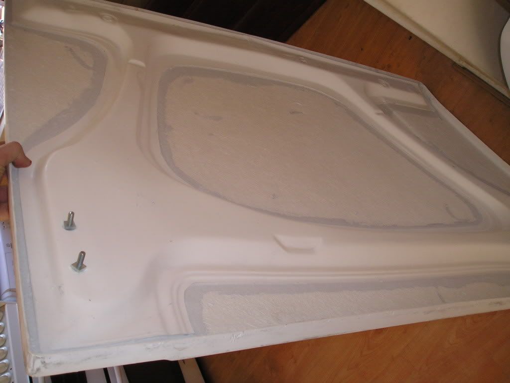

few more updates. mounted nitrous pulsoids ect. also purchased a brake bias box. but yet to get it fitted. Purchased some aeroquip fastners for the fibreglass bonnet so it back be locked down for a touch more security.
http://i123.photobucket.com/albums/o...d/DSC00124.jpg
http://i123.photobucket.com/albums/o...d/DSC00123.jpg
http://i123.photobucket.com/albums/o...d/DSC00119.jpg

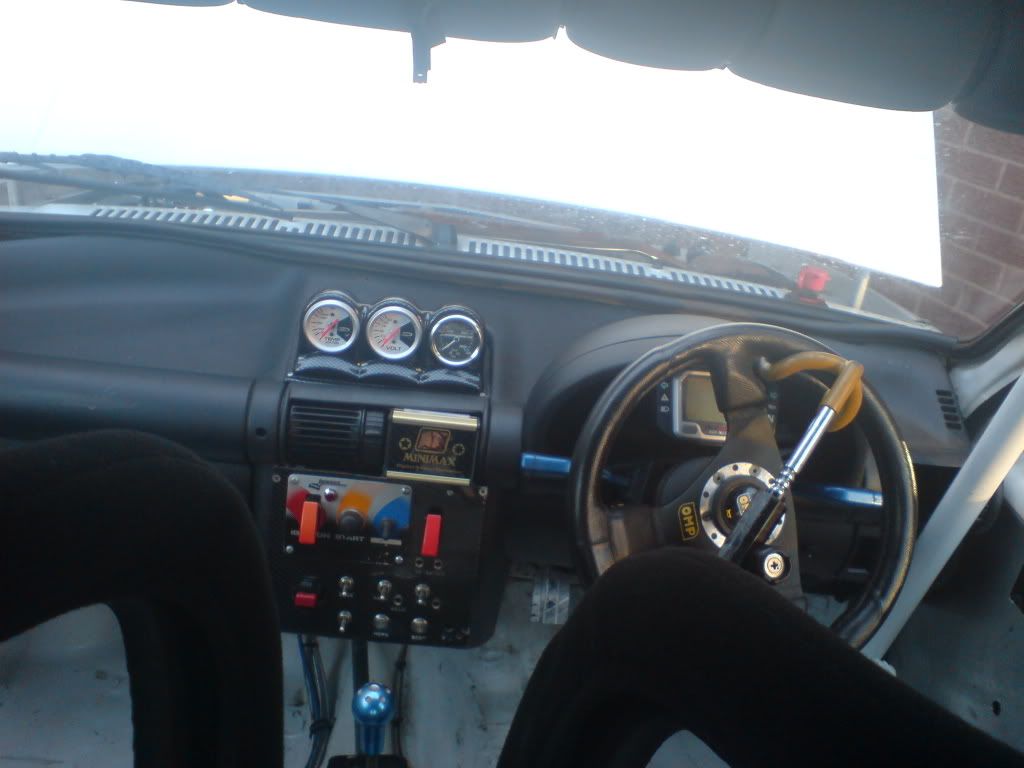

Also mounted the nitrous controller and pressure gauge on the dash along side the other gauges for the car.

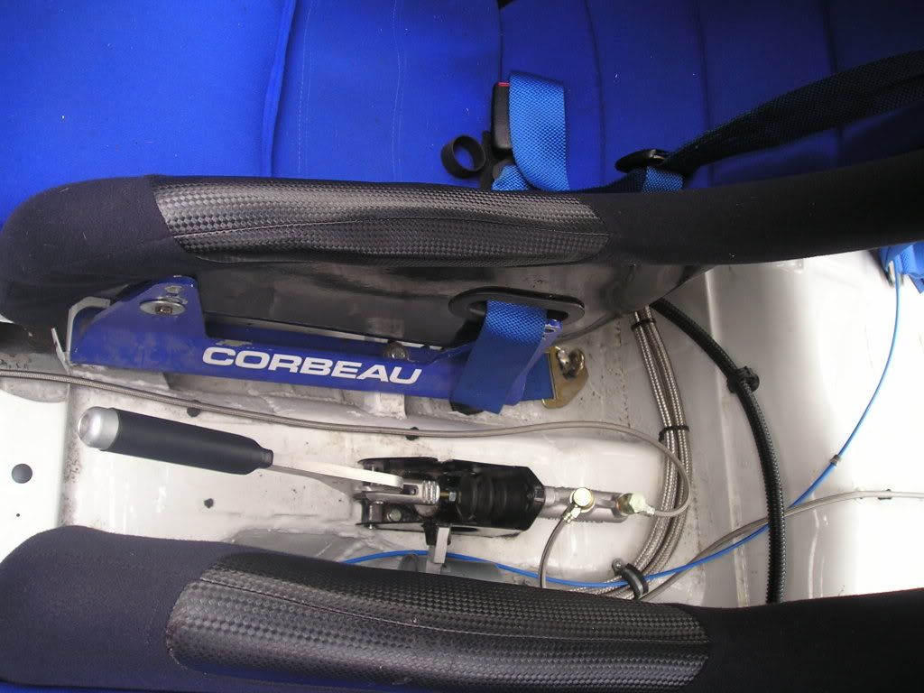

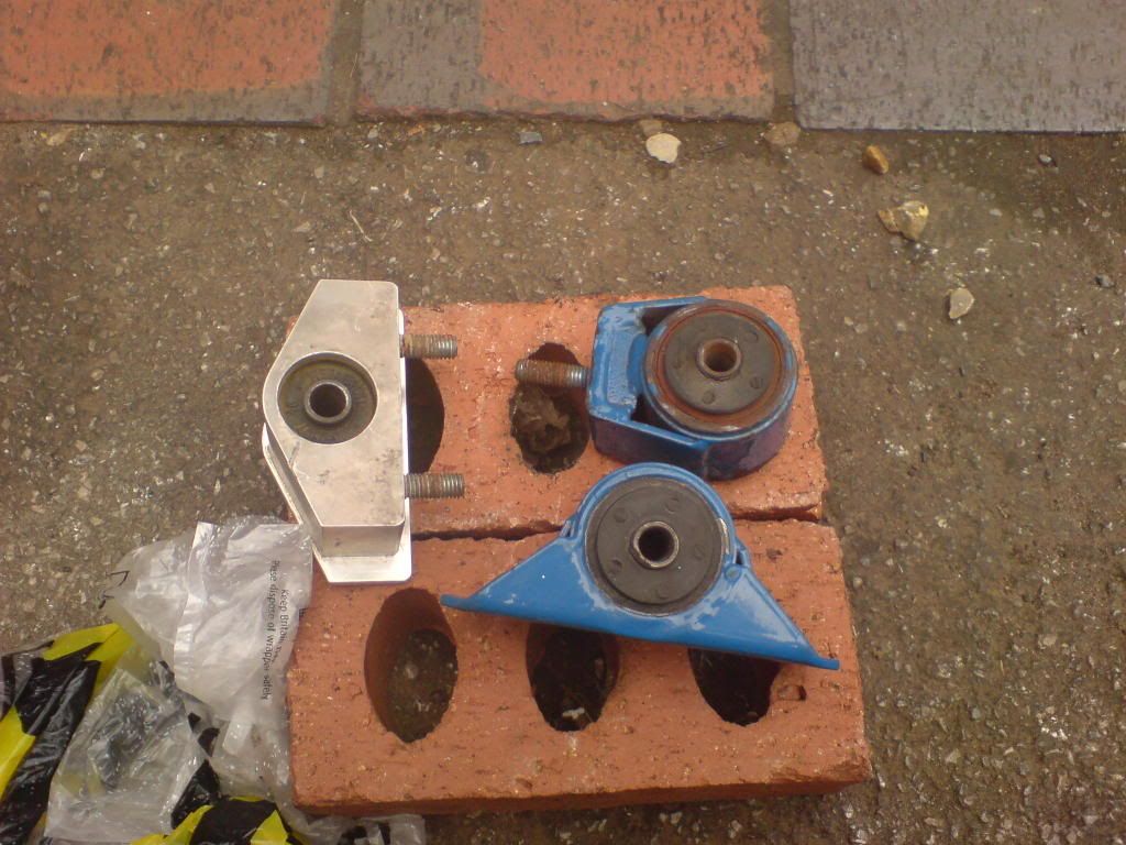

Well over the last week or so while work was going on i decided to fit my solid mounts and bias brake box and braided lines front and back .
The mounts were a pain to fit. But engine is solid now in the bay. No movement forward or back which was the main problem.
heres a few pictures.
http://i123.photobucket.com/albums/o...d/DSC00140.jpg
http://i123.photobucket.com/albums/o...d/DSC00164.jpg
http://i123.photobucket.com/albums/o...d/P1010309.jpg
http://i123.photobucket.com/albums/o...d/P1010307.jpg
http://i123.photobucket.com/albums/o...d/P1010306.jpg
All fitted now with bias box and braided lines throughout the car. All thats left is to bleed of the brakes and get the bias box setup. Once thats done then try using it again lol! who knows it might work this time. :)

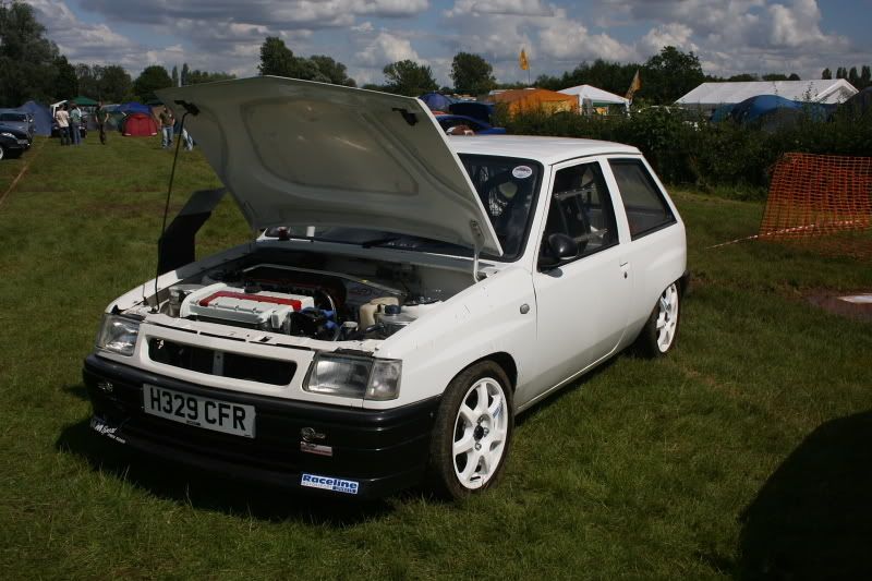

Then came billing. excellent show with the mig lads on there stand. heres a few pics.
http://i123.photobucket.com/albums/o...novaresize.jpg
http://i123.photobucket.com/albums/o...7072007395.jpg

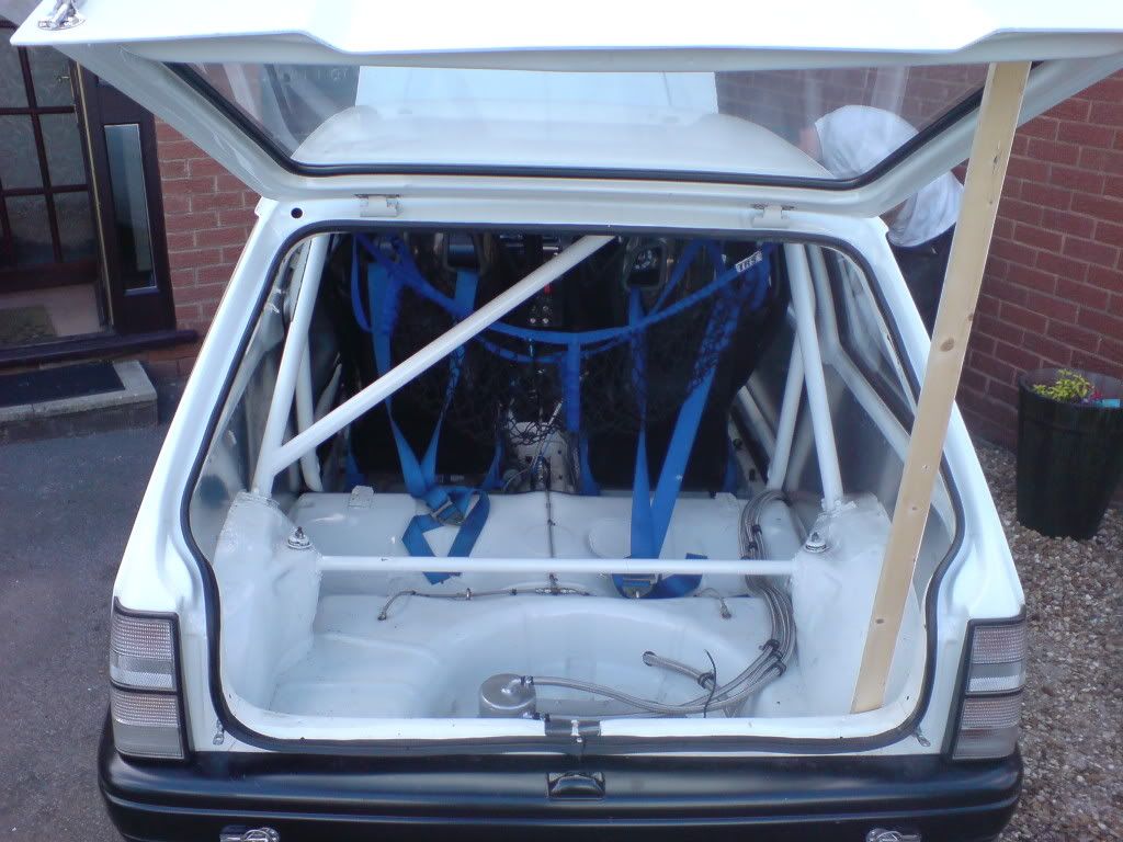

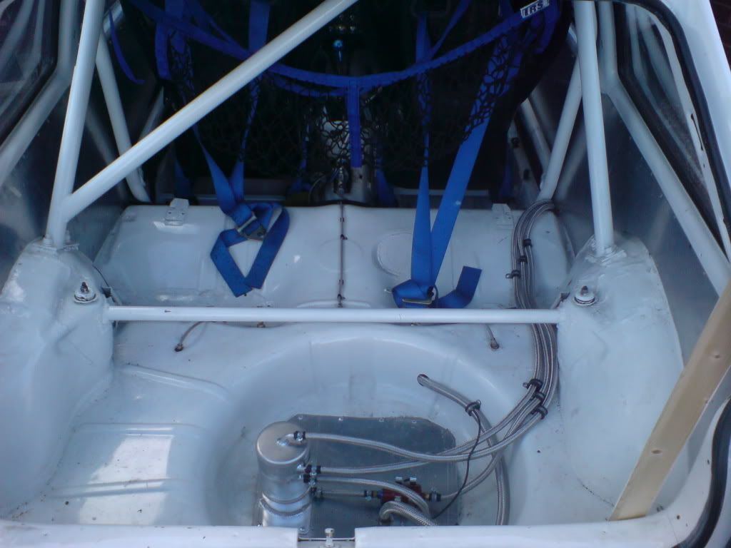

Swirl pot all fitted. just a few more lines to sort out.
Impossible to make these things look neat without spending stupid amounts. more function over form realy.
went for a facet redtop for a pickup pump. bullet filter . and a motosport sytec fse high pressure pump and 1 1/2 litre swirl pot and some braided hoseing.
heres the **** fitted. far to many fuel lines but if it stops the pain up the **** surgeing then im all for it. probably something wrong amongst it but practice will make perfect hopefully.

PS; fuel setup looks spot on! Hoses are like spaghetti junction!
yep hate so many hoses on show but no real choice tbh. but as longs it works. lolQuote:
