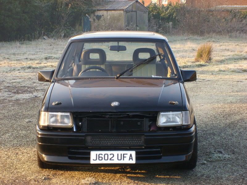

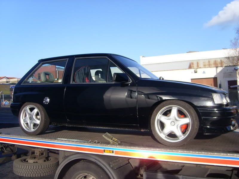

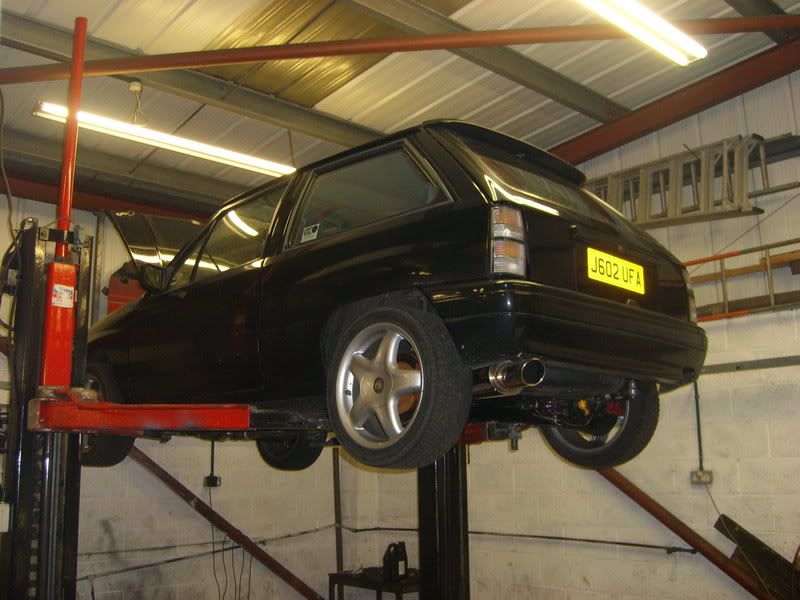

Got a phone call last night from the alarm place telling me his having probs with the door popper on the drivers door, i was ment to be picking the car up this morning to take for an MOT then tax and start running it in. but now there keeping it till monday lunch so im sitting here bored when i could have been out in the car!!!!!! DOING MY HEAD IN!!!!!
YEAH!!!! got car back from alarm place last night at 5pm so to late for mot, sorted last little jobs for the mot out and took it for a drive round the yard, it runs pretty well i must say we run i bit of boost to make sure everything works. got mot this morning so should be on the road this afternoon running it in and trying to get back my grill and boot handle from the painters.
top job mate!
More pics needed :D
Cracking thread Chris, and loverlee car :) Nice meeting you (briefly) on Sunday..

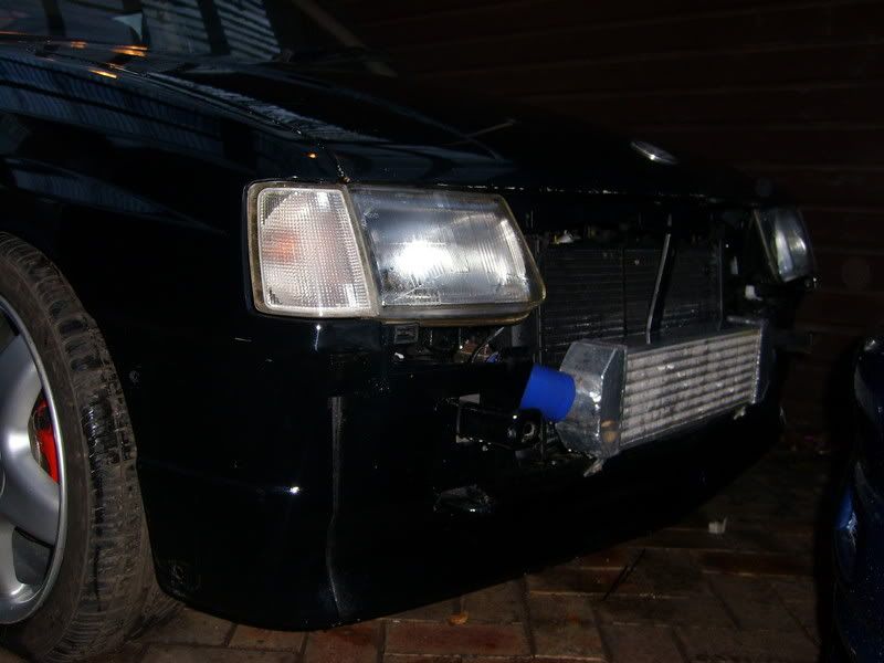

Bigger turbo and some more mods we have done, full engine spec when up and running right. rolling road jan to see how much im pushing then standalone getting put on.Quote:

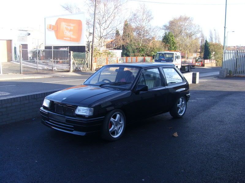

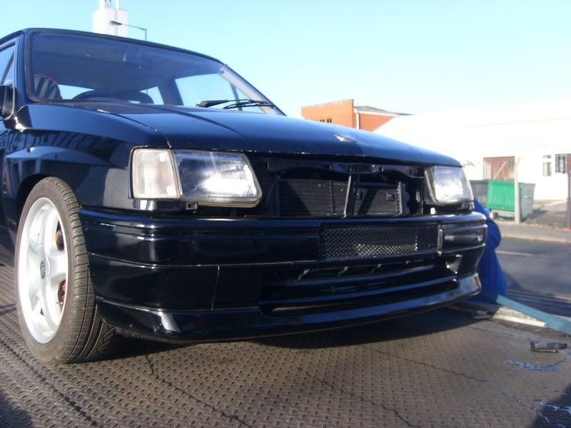

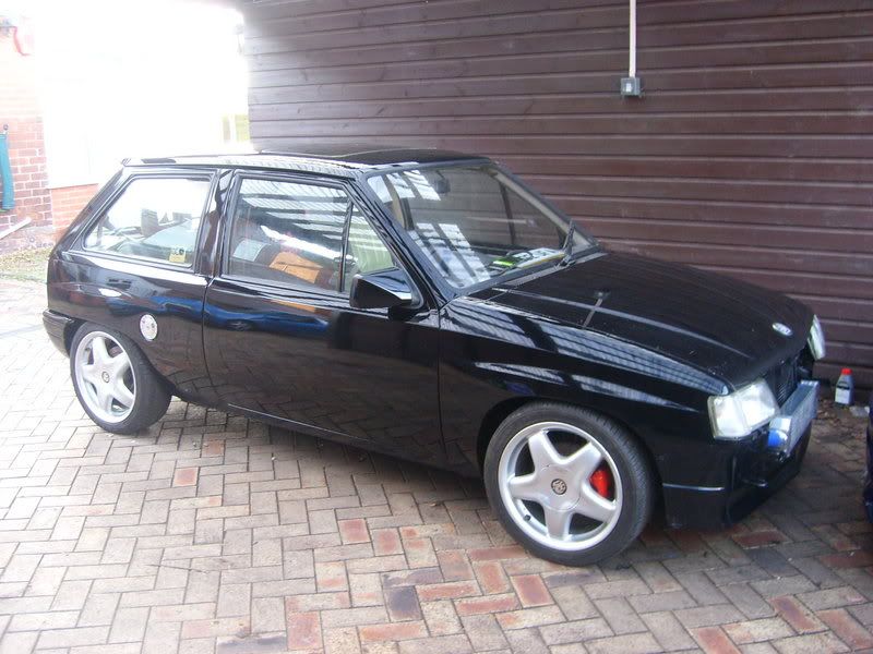

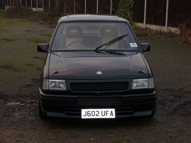

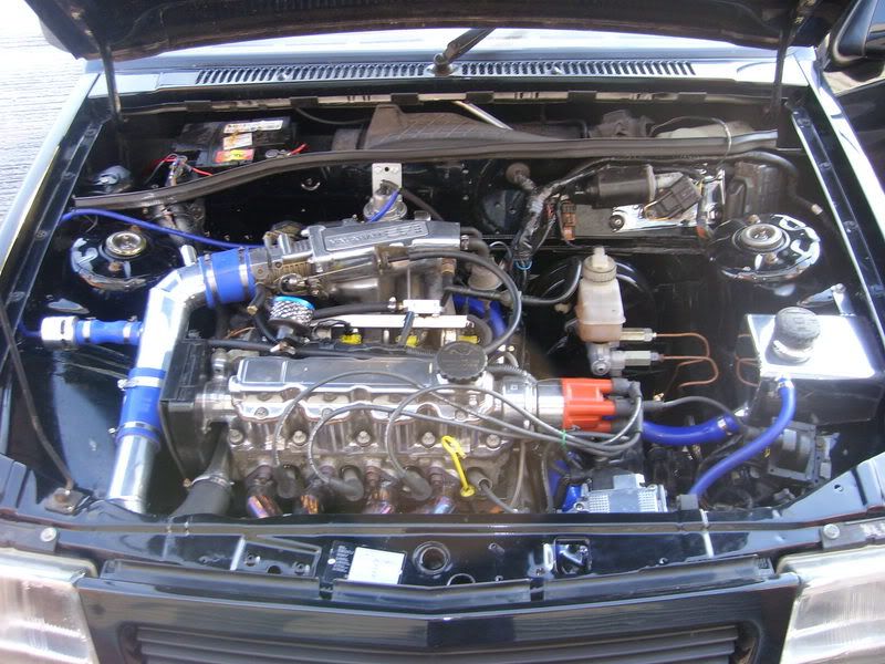

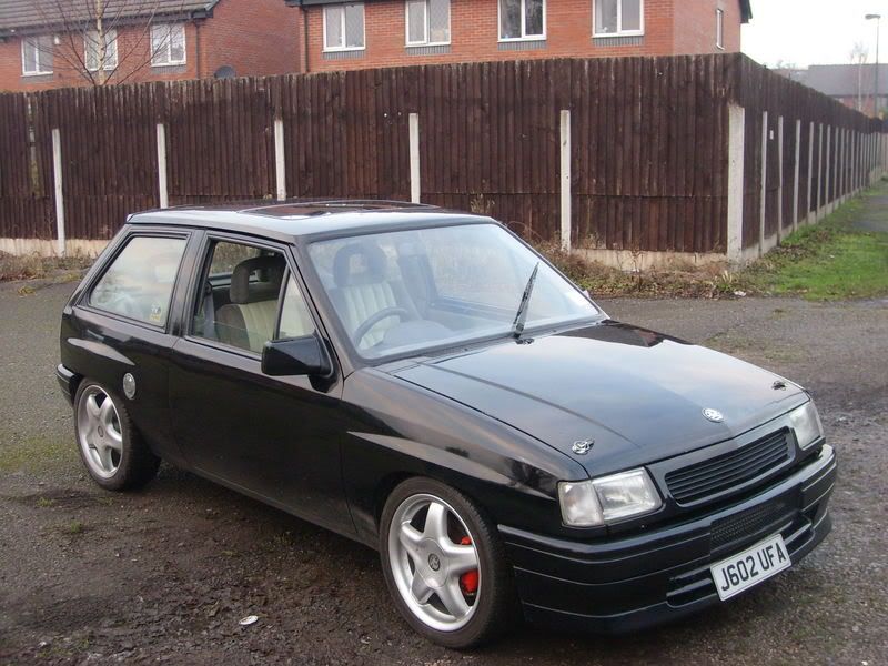

Right then found camera after i lost it for a day, heres some pics with the grill and boot handle in and some engine bay photos, its looks loads better in person. i found the turbo doctors phone number last night on an old thread hoping it still works after new years because i hear he has done 1.6 turbos before and might be worth the drive up to see what he can help me with anyone know if his still around? or any good? i need to get the standalone man on because the cars not ticking over correctly. i was also looking at people are running a 5th injector do you have to run this because at the moment the car boosts alright and doesnt feel like its lacking fuel. parking car up for xmas until the turbo has been sorted on the 3rd so back after the new year, and ive got loads of ideas still to come.
cheers for the comments and help have a good xmas.

Car is looking great mate, bay looks sweet, needs a blue top rad hose tho ;) Lol
Liking the manifold now its turned same colour as motorbike cans do..

Looks lovely that pal. Novas always look nice in black IMO.
Top hose is not that simple in samco both ends are different size's and ive moved the rad, but will sort something out in time, only started on engine bay theres loads to be done yet. yes turbo is re-con from a turbo centre in derby, so takin it back on the 3rd for them to sort out. my mate had same problem with his turbo from there so it makes me think there no good. got a set of xe injectors lieing around so bonus.

Looks stunning (front on pic) with the grille on.

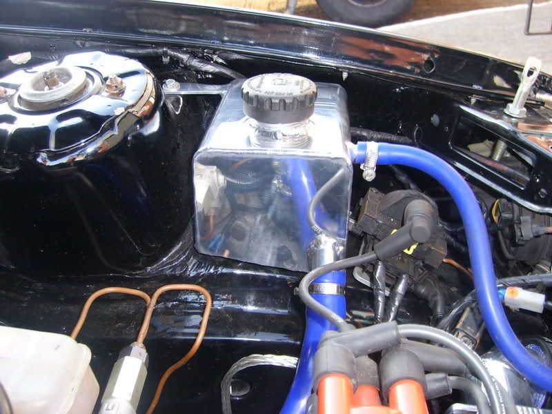

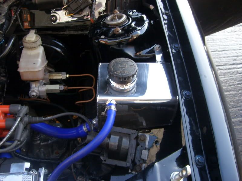

Heres a header tank my mate did for me yesterday!!!
http://i102.photobucket.com/albums/m...l/STP60475.jpg
http://i102.photobucket.com/albums/m...l/STP60476.jpg
http://i102.photobucket.com/albums/m...l/STP60477.jpg
Tank looks nice & shiney.

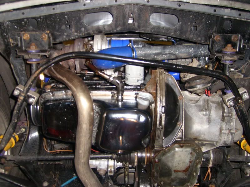

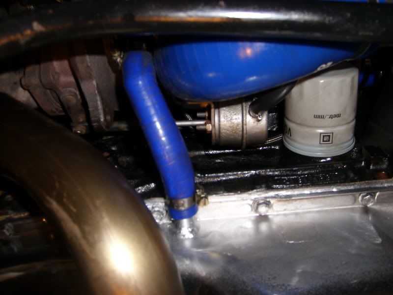

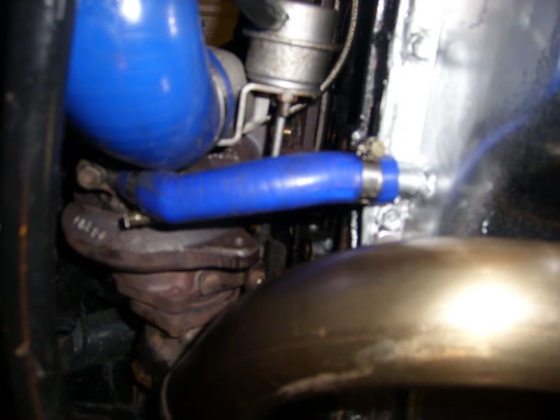

Right then sorted the smokin out the other day and it was the return into the sump cheers guys moved it right upto the lip of the sump.
heres a pic of before.
http://i102.photobucket.com/albums/m...l/STP60483.jpg
http://i102.photobucket.com/albums/m...l/STP60482.jpg
Heres after
http://i102.photobucket.com/albums/m...l/STP60488.jpg
http://i102.photobucket.com/albums/m...l/STP60489.jpg
http://i102.photobucket.com/albums/m...l/STP60490.jpg

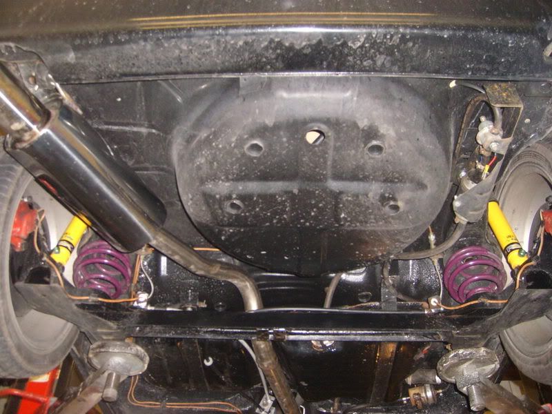

couple of the under side after a couple of drives in the rain
http://i102.photobucket.com/albums/m...l/STP60485.jpg
http://i102.photobucket.com/albums/m...l/STP60484.jpg
http://i102.photobucket.com/albums/m...l/STP60492.jpg
http://i102.photobucket.com/albums/m...l/STP60494.jpg
http://i102.photobucket.com/albums/m...l/STP60495.jpg

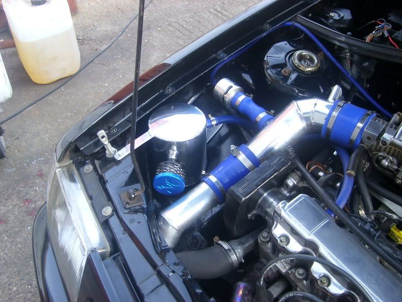

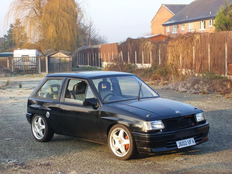

Car run in now, the actuator will only let me run 7psi so havent been able to turn boost up that much but goes alright for now. just had a oil breather pot made and fitted will post pics up as soon as. just looking around at differnet managment systems at the moment then will have one put on in feb. going to santa pod on the 21st to run it on standard managment to see what time it does the see how much differnce it will make when i change.
looks good, should see you at pod on the 21st aswell, ill be the 1 drooling on your engine lol
Looks excellent, liking the chrome bits.

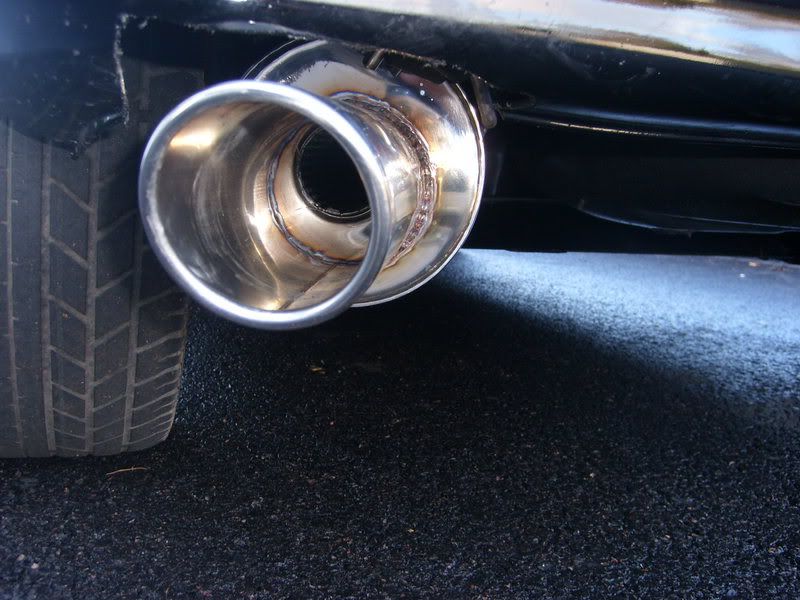

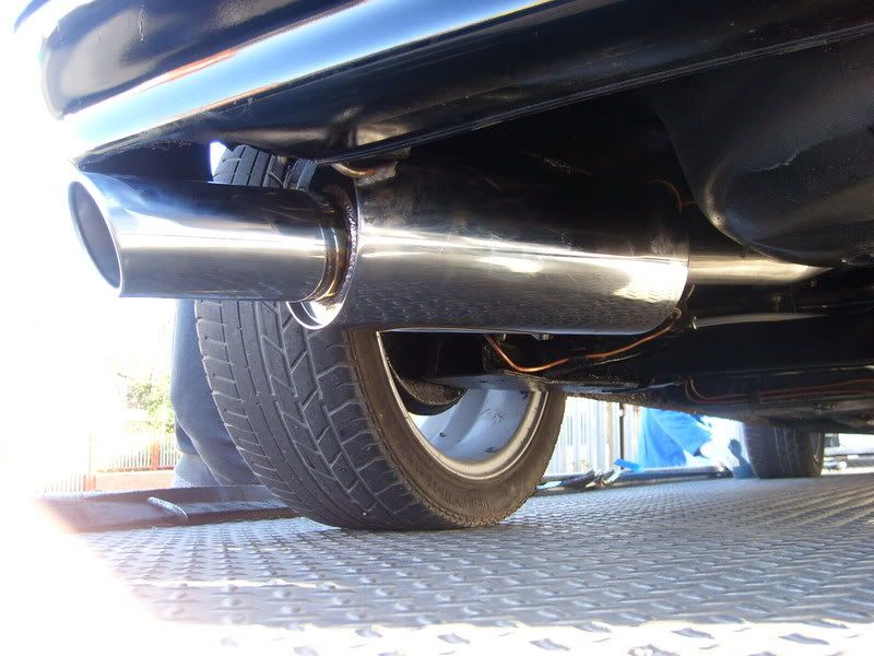

Fooook me, no silencers(apart from backbox)! It must be loud as fook on boost,Lol.

You ought to move the oil filter, looks a bit cramped & hot if left there. You could use a Mocal relocation kit to do that & have run an oil cooler which it will benefit from.
The straight through exhaust probably isnt loud, mine wasnt.

Got this oil breather tank made up the other day looks alright what do you think.
http://i102.photobucket.com/albums/m...l/STP60512.jpg
http://i102.photobucket.com/albums/m...l/STP60513.jpg
http://i102.photobucket.com/albums/m...l/STP60514.jpg
Put a bleed valve on earlyier until i get a bigger actuator, it boosts up to 10 psi but only still holds 6 psi.

i bet that things loud as **** lol
NO! I said before I doubt it.Quote:
Originally Posted by bigbened
I'll explain why, with a turbo the exhaust propeller absorbs & uses the energy in the gases to to drive it. When the gases exit the turbo through the wastegate & off into the rest of the system, the gas has lost a lot of its energy & it doesnt exit with so much force to use a word. Wheras with N/A the gases shoot out the xhaust ports at a much higher speed & make more noise & pressure in the exhaust system.
Thats why turbo cars can have a single silencer/straight through system.
http://i30.photobucket.com/albums/c3...ts4sale033.jpg
I had my centre box removed & a new straight through section made & although it sounded different & deeper it wasnt loud like you may expect.

loving it, i think im gonna get a oil catch tank like that i think !!

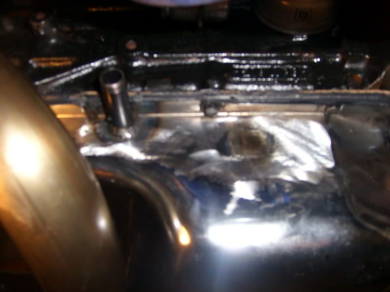

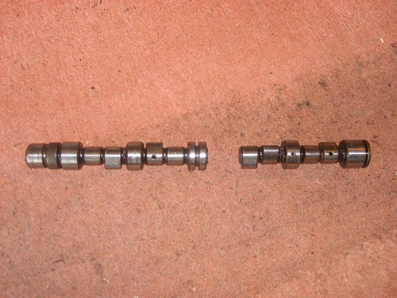

Quick little update- i snapped the cam today while out on the motorway, luckly a friend has a cam spare and will be changing it in the morning so will be putting some pics up in the morning. also brought another CR F13 box so will be stripping and polishing that for the PV2007 show. apart from the cam the car was running alright. was out the other night and only just beat a 2L 8v nova, but it was pissing it down and i was spinning up to fouth then got past him but after that he could'nt keep up with the pace, LOL its like a little toy im so glad i built this and didnt go back to the XE. i would recommend this any person.
do you know somebody that makes tanks? ie header or what im after washer bottle? cars looking nice mate sounds good
snapped a cam :eek:

Changed cam in it yesterday and its running mint again so looks like i didnt damage any valves luckly. i think this week were going to try and put another breather port out of the rocker cover because it doesnt seam to be breathing well enough. hoping the weather holds off this weekend and i'll run it POD to see what it does on standard managment, then in later feb put some omex on with a cam and run it again.
heres some pics-
cam snapped where nail points too.

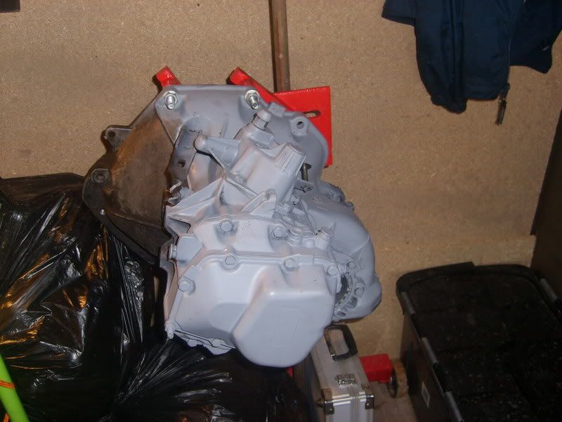

here one of the F13 CR box i brought on the engine stand ready to be stripped.
http://i102.photobucket.com/albums/m...l/STP60519.jpg
Anyone else snapped a cam before?
