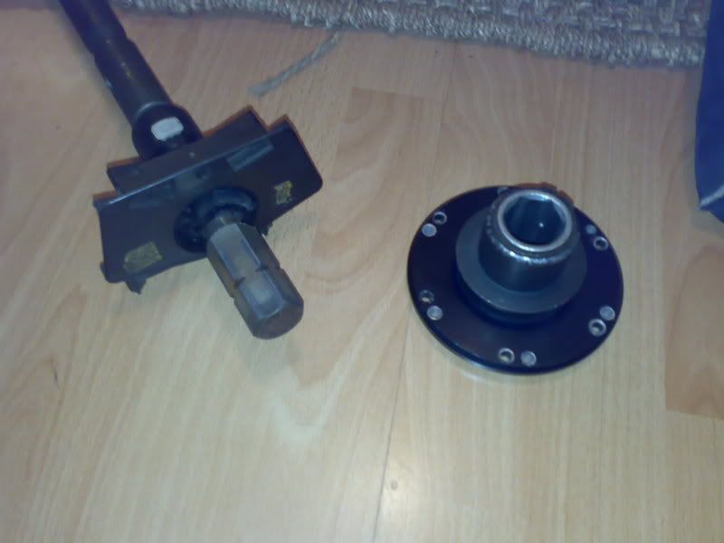

Cav shifter donated from a mate who stripped his cav:D

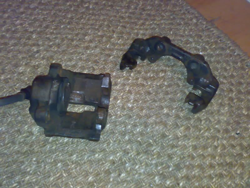

Next is I thought I'd start to freshen up my 16v callipers. Gave them a good wire brush up and got the old paint off, and also slipped on one and split the piston seal! lol BUT I was going to re do the seals anyway.
So from this
http://img.photobucket.com/albums/v3...3052007144.jpg
To this
http://img.photobucket.com/albums/v3...3052007145.jpg
http://img.photobucket.com/albums/v3...3052007146.jpg

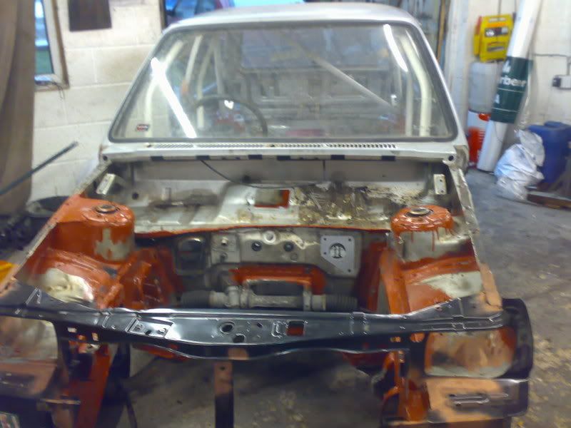

Well its update time again, and this time im well chuffed as it actually looks as if its taking shape. Really happy with it as it stands:)

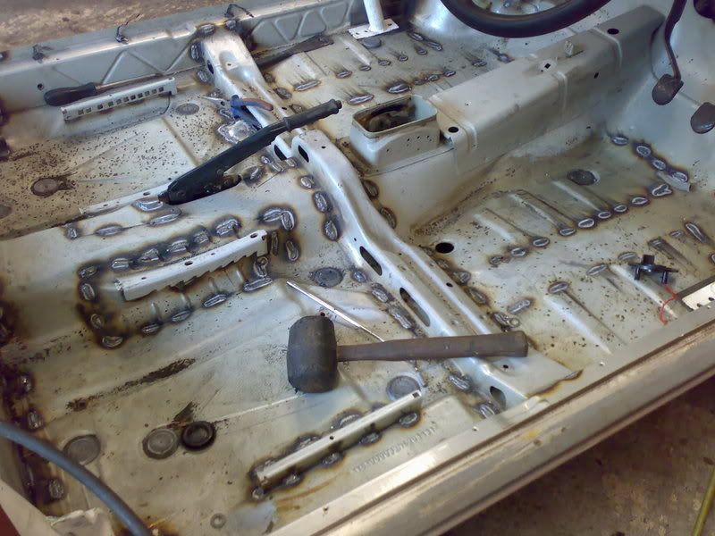

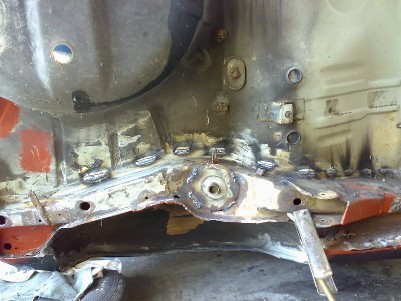

Anyway here goes! The rest of the seam welding complete
http://img.photobucket.com/albums/v3...2052007182.jpg
http://img.photobucket.com/albums/v3...2052007183.jpg
Hole that was in the corner of boot floor plated
http://img.photobucket.com/albums/v3...2052007184.jpg
Interior seam welded, and if you notice that the standard seat mounts are there, this is because there will be more than just me driving this so need to keep the seat adjustable.
http://img.photobucket.com/albums/v3...3052007186.jpg

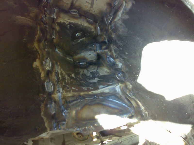

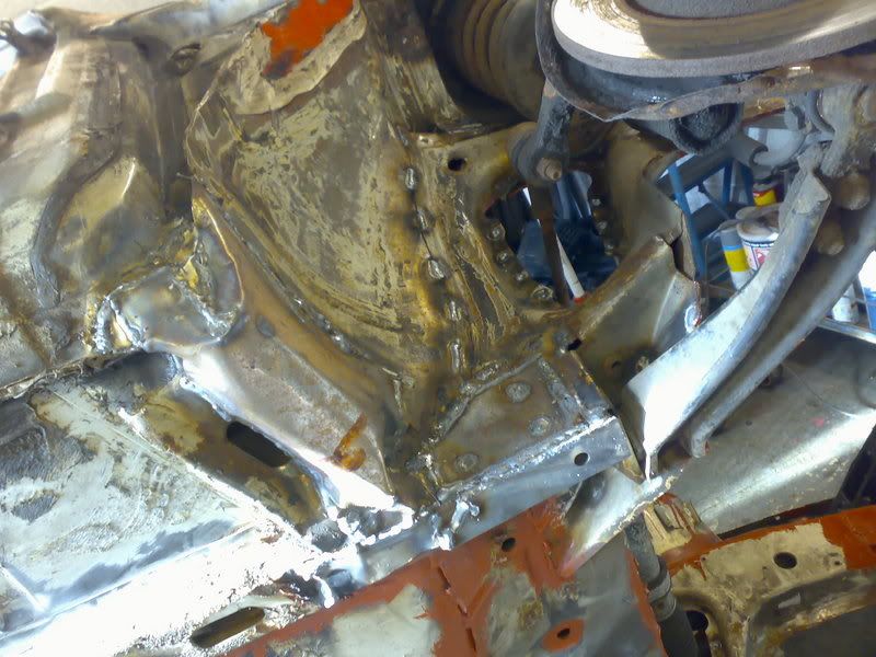

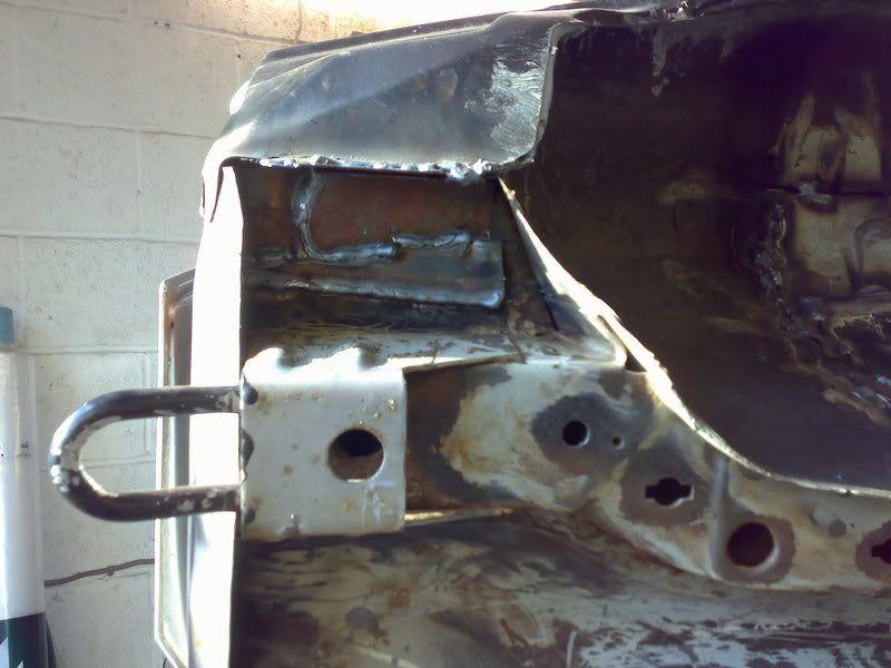

Drivers side front arch and chasis leg, holes plated and seams welded and strengthening plates in place
http://img.photobucket.com/albums/v3...2052007185.jpg

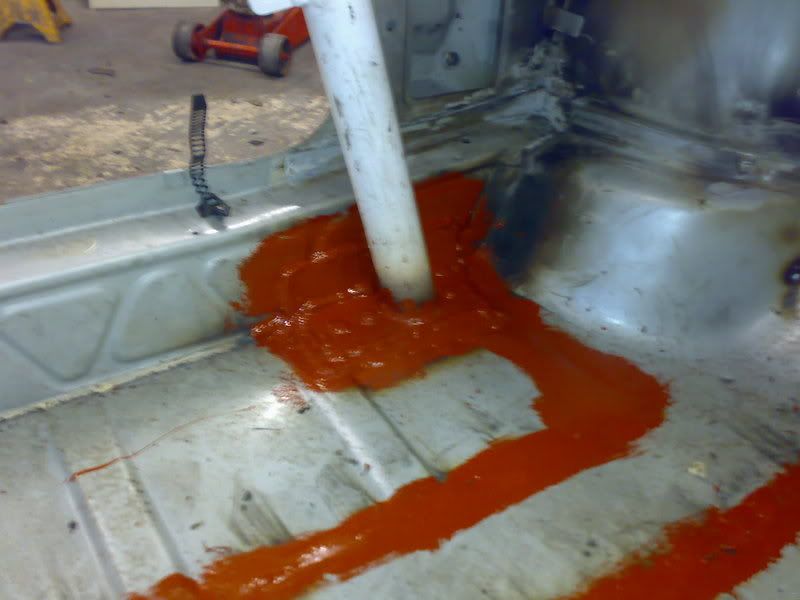

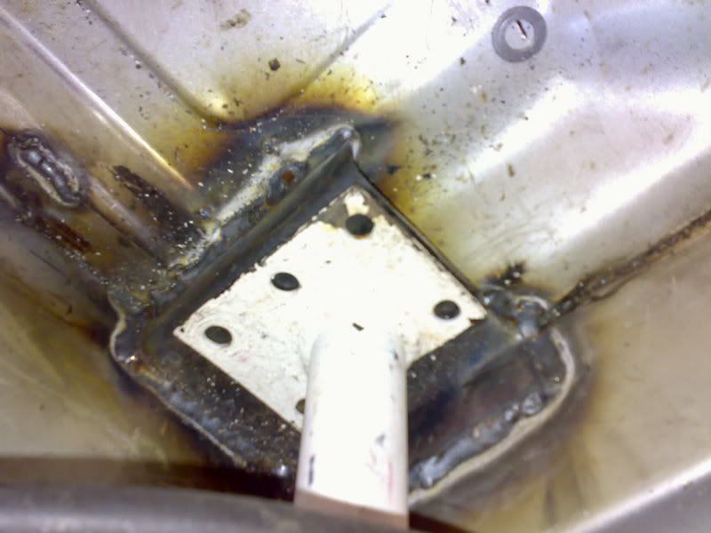

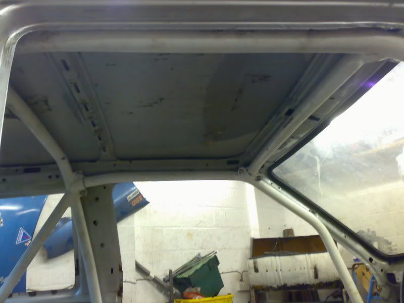

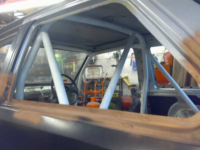

Now for the big bit!! We trial fitted the cage and I made up the mounting plates, then my final decision was to weld the cage in as it will be stronger than bolting, so in it went! Had the porter power on it as well and go it nice and tought and got it welded in place.
One of the main hoop mounting plates welded in and cage sat on.
http://img.photobucket.com/albums/v3...3052007187.jpg
welded and red oxided!
http://img.photobucket.com/albums/v3...3052007191.jpg
Front cage leg
http://img.photobucket.com/albums/v3...3052007194.jpg

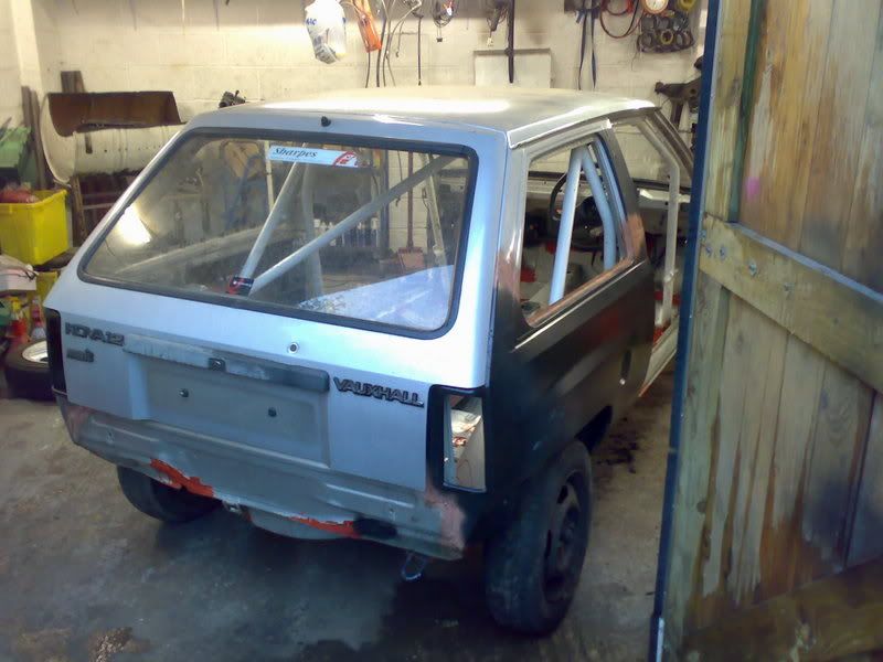

Cage in Place good and proper!!
http://img.photobucket.com/albums/v3...3052007188.jpg
http://img.photobucket.com/albums/v3...3052007189.jpg
http://img.photobucket.com/albums/v3...3052007195.jpg
http://img.photobucket.com/albums/v3...3052007193.jpg
http://img.photobucket.com/albums/v3...3052007192.jpg

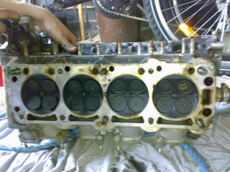

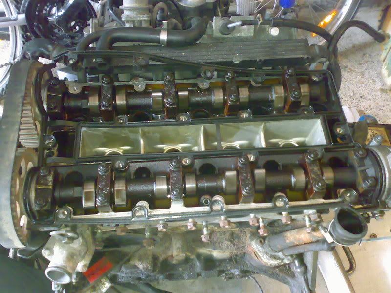

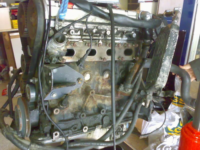

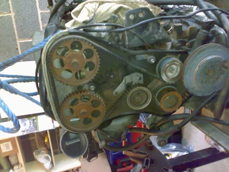

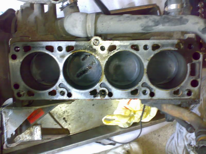

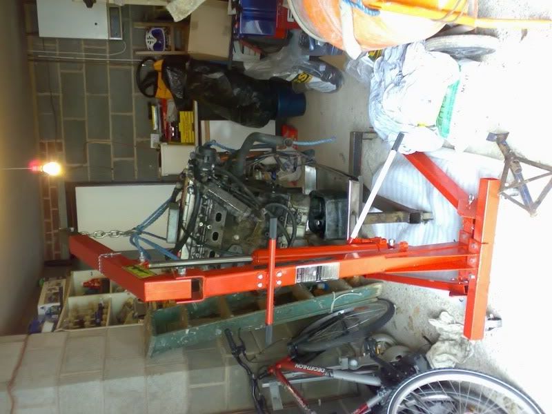

Well this weekend I made a start on the engine. Wanted to whip the head off and check everything was ok in there and headgasket etc. Also I was planning on doing the cambelt, water pump and generally give it a tidy up. Aswell I just wanted to take an engine to bits as I've never done it before and want to learn so thought this was a good opportunity!!lol
Heres some pics
http://img.photobucket.com/albums/v3...0062007225.jpg
http://img.photobucket.com/albums/v3...0062007223.jpg
http://img.photobucket.com/albums/v3...0062007222.jpg
http://img.photobucket.com/albums/v3...0062007224.jpg
Cams
http://img.photobucket.com/albums/v3...0062007226.jpg

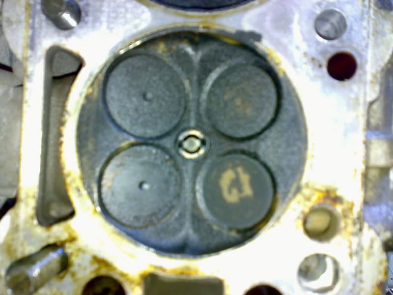

In the ports there is some oil that has been coming up from the block, so a new set of rings are in order!
http://img.photobucket.com/albums/v3...0062007230.jpg
You can see here on the valves evidence of this too
http://img.photobucket.com/albums/v3...0062007231.jpg
http://img.photobucket.com/albums/v3...0062007232.jpg

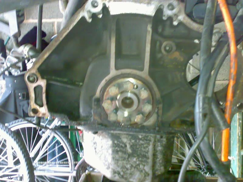

Head gasket was in good order, no signs of deteriation, so alls well really. Next is to strip the head, and start cleaning everything up. Well chuffed that i'm making some constructive progress now. Thanks to my mate steve who gave me a hand too!
Cheers
Ian
The thing on the sump is the oil level sender for the oil level gauge on the 'digi dash'. If you are using a digi dash, connect it, if not, snip it off at the sump.
Cheers Rob:thumb:

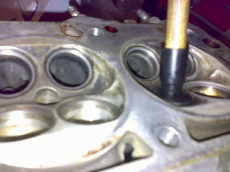

Not much to report, however I have stripped the head and have mostly been lapping in valves! very fun job :thumb: Also cleaned up some parts, sump etc so its nice and clean for when needed!
http://img.photobucket.com/albums/v3...0072007241.jpg
http://img.photobucket.com/albums/v3...0072007242.jpg

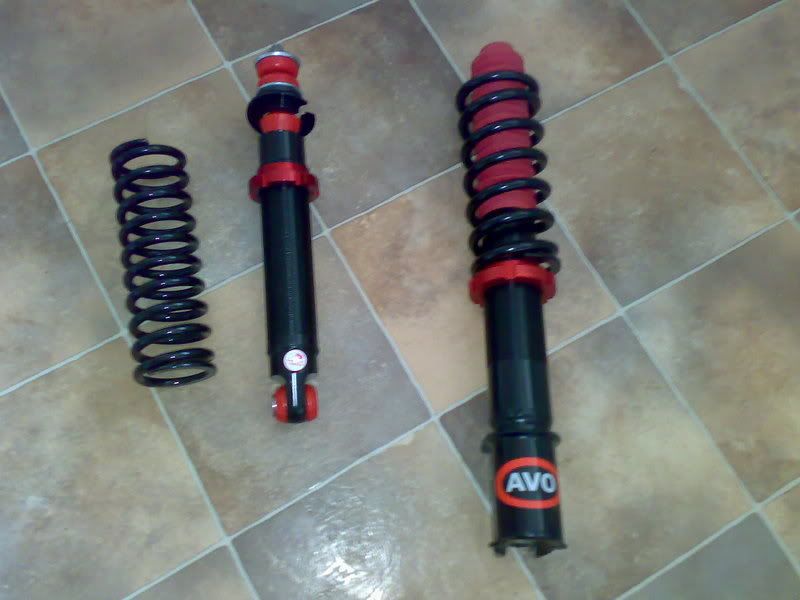

Had these Shiney new news through from Chris Astley Motorsport today.
Full Set of AVO Coilovers, with 300lb front springs. Should help in the handling department!
Well chuffed with them:D
http://img.photobucket.com/albums/v3...72007245-2.jpg
Very nice indeed! Looks like a mighty fine suspension setup.
ah, the wicked new ones. old ones where very good, but no one looked after them and complained, these new ones are **** hot.
its true, you have more money than sense lol
coilovers look spangly :thumb:

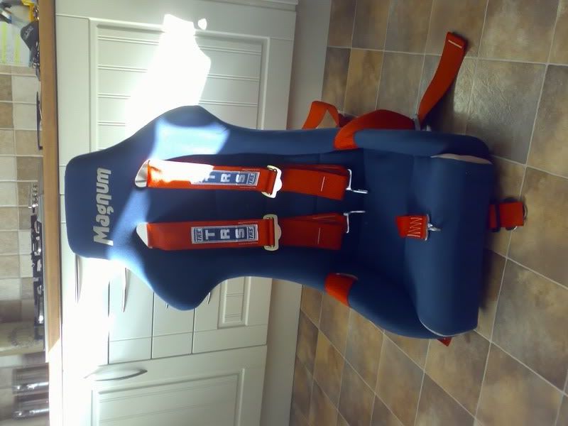

Well not done anything as Ive been off on me hols for two weeks, although my seats turned up just before I went, BIG thanks to Gazz for them, well chuffed with them, there sooooooo light!!!
Heres a pic with my harness on one of them
http://img.photobucket.com/albums/v3...7072007248.jpg
