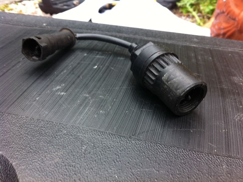

hey nick - whats the score with the vss on these ? .. do you just snip the original wire going to the hub sensor, and link it to a 6 pulse gearbox sensor ?
Erm if your talking about the speed sensor on the gearbox I won't be using one, I'll be using an early gearbox that the Speedo cable on the nova will plug into. If that's not what you ment then I'm not sure sorry.
between the cable and the box i mean.

Well good news I've been doing some research and it turns out that because my car was a late 1.2 injection model it already has a vss that should be fine to use with the x18xe1

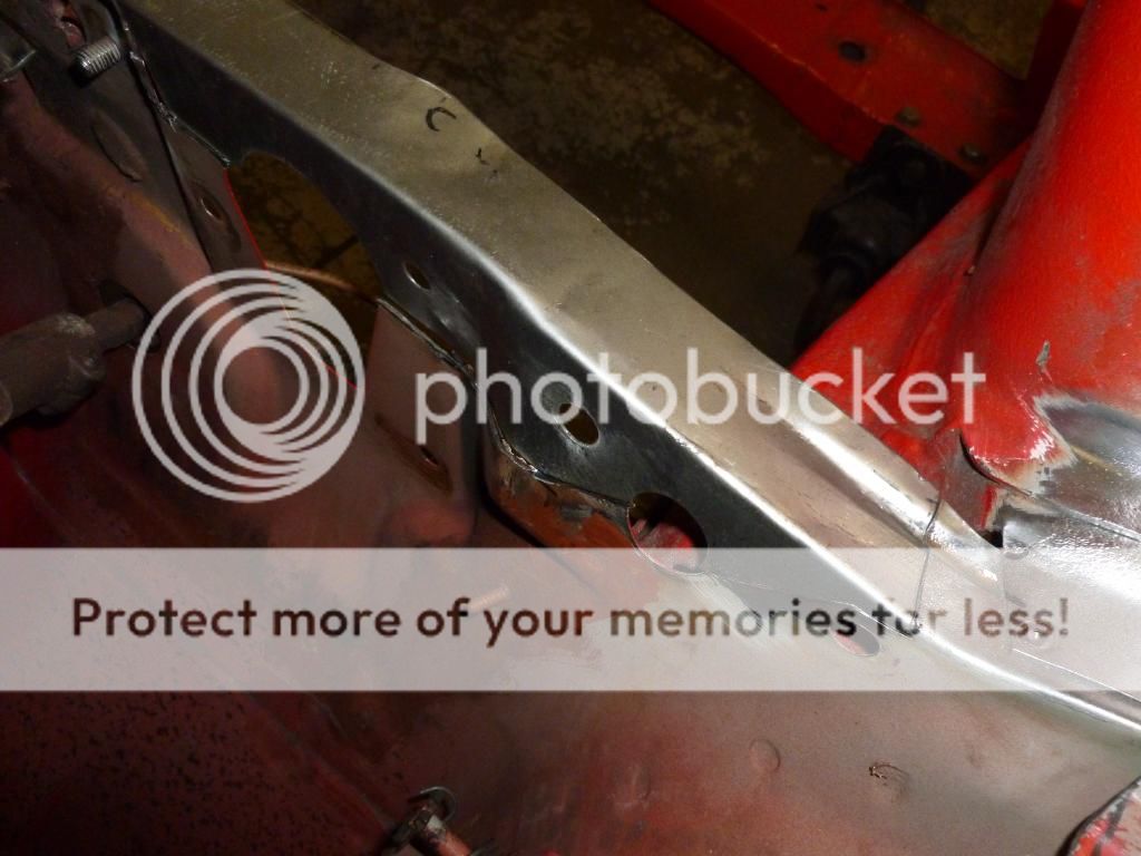

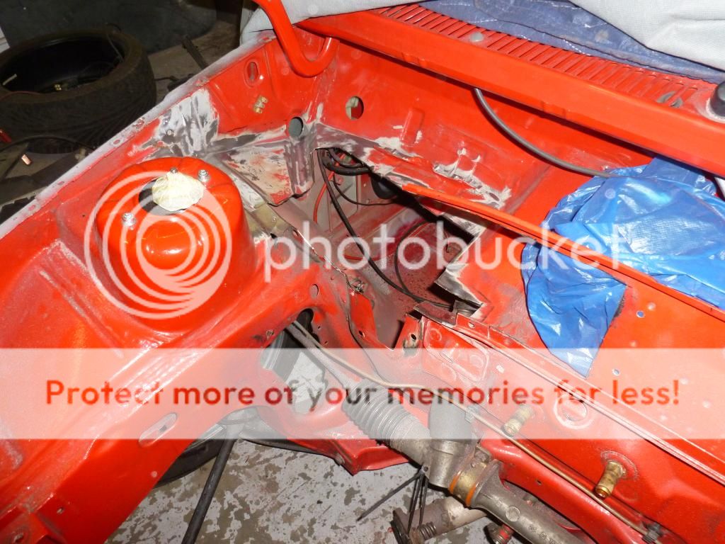

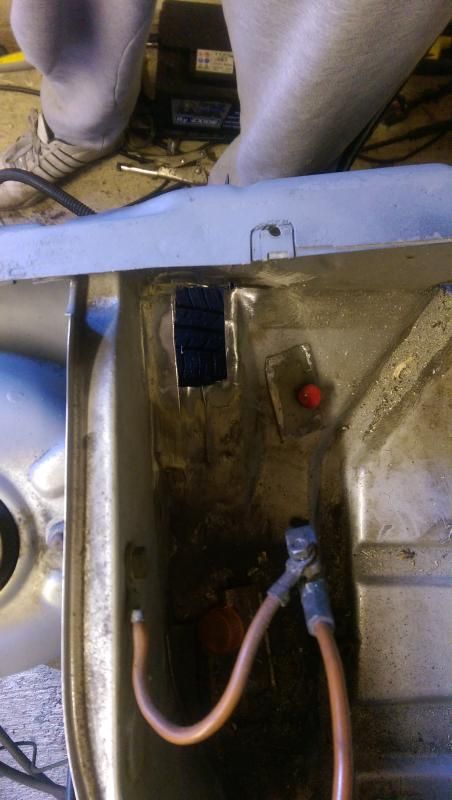

Only a small update, I started out the day with the intention of removing the underseal from the front wheel arches, about ten minutes in i found some tin worm hidden under the underseal, access wasn't to bad as it was also in the battery tray, lucky I caught it early.

And all repaired
[IMG]http://i5.photobucket.com/albums/y15...1.jpg~original[/IMG]
The welding isn't perfect but its strong and will do, nothing the grinder wont sort.

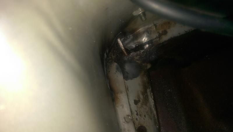

Feeling really disheartened at the moment, found some rust and it might just be to far gone, I'll uploads some pictures in a few minutes.
well i knew there was some rust in the scuttle area as i had seen this
[IMG]http://i5.photobucket.com/albums/y15...9.jpg~original[/IMG]
i then went inside and peeled back the carpet and found this
[IMG]http://i5.photobucket.com/albums/y15...0.jpg~original[/IMG]

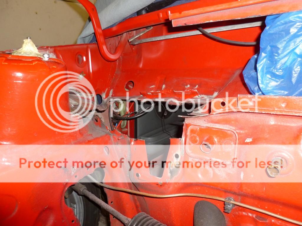

Now im new to this whole restoration stuff and im learning as I go, so in peoples opinion is this repairable? its in such a hard location to get to, even thinking i might have to remove some of the scuttle to get to it.
what do people think?
Anythings repairable but it is an awkward place just have to cut out the rust and weld it up again in sections ,good luck
Yeah i think im going to strip the dash out and attack it from the inside, cut out the rust and see what im left with and then take it from there. looks like an early start in the morning.

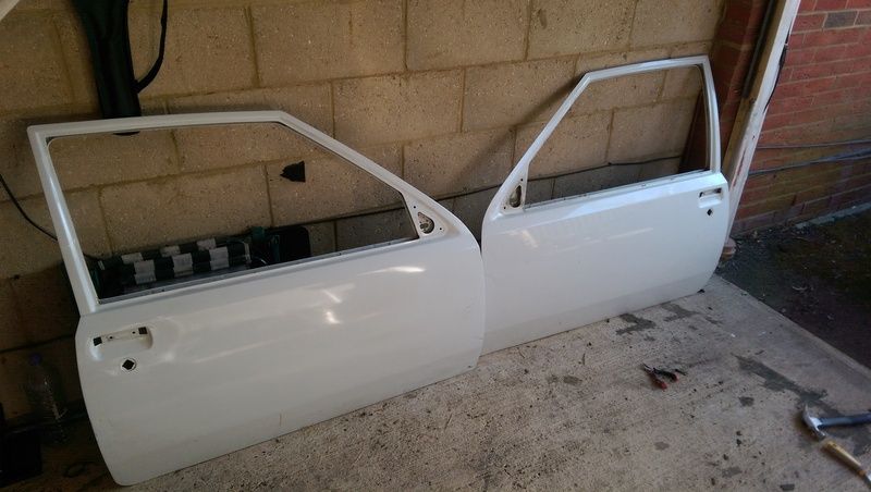

A few moths ago I picked up some second hand doors that are 100% rot free, thay had polycarb windows in them previously so I need to replace the metal that splits the two windows but thats easily sorted from my rusty set.

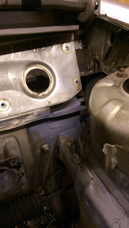

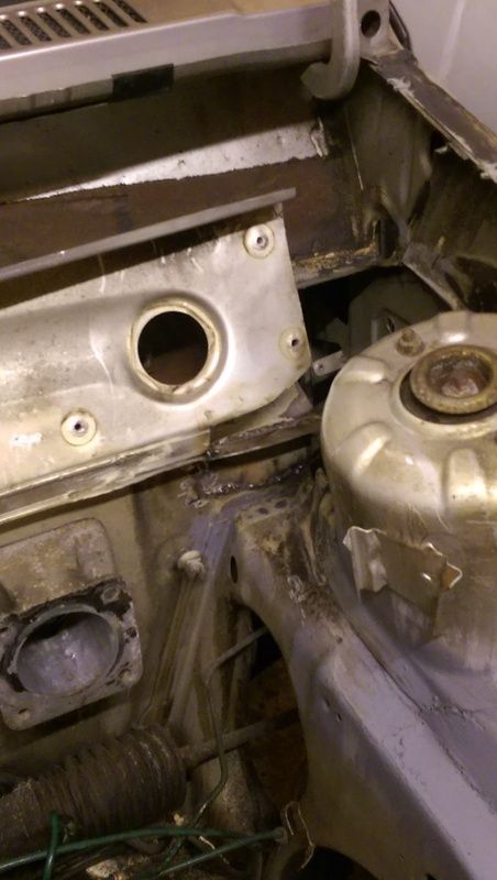

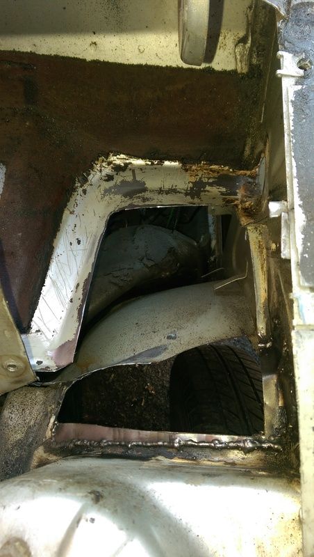

Here is the problem area
So i whipped the dash out, not as painful as i thought it would be and dont think i broke anything to costly.
Removed the loom from the bay
[IMG]http://i5.photobucket.com/albums/y15...3.jpg~original[/IMG]
time to get cutting
[IMG]http://i5.photobucket.com/albums/y15...2.jpg~original[/IMG]
[IMG]http://i5.photobucket.com/albums/y15...6.jpg~original[/IMG]
[IMG]http://i5.photobucket.com/albums/y15...8.jpg~original[/IMG]
and after i gave it a clean up
[IMG]http://i5.photobucket.com/albums/y15...4.jpg~original[/IMG]

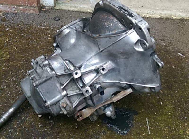

Also I've got loads of new parts I wont list them all just the important bits.
[IMG]http://i5.photobucket.com/albums/y15....jpeg~original[/IMG]
Nice f13 gearbox, it was very oily when i got it but ive given it a quick clean up and it will be painted at a later date.
