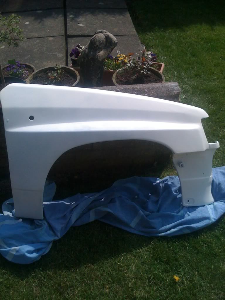

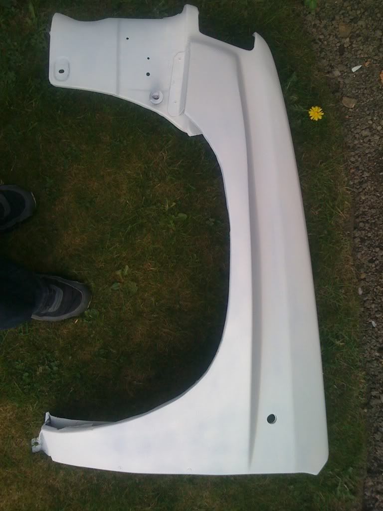

Pic of one of the two new steel wings that I've made the other is buried at the back of the garage and couldn't be arsed to dig it out lol
http://i828.photobucket.com/albums/z...3/484320d7.jpg

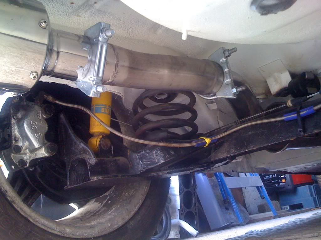

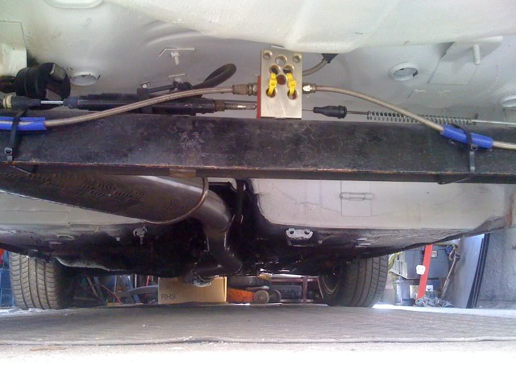

Update car has just come back from having exhaust built couple of poor pics here I'll try and get some better ones up Friday
http://i828.photobucket.com/albums/z...3/bb81486f.jpg
http://i828.photobucket.com/albums/z...3/cc19ad0f.jpg

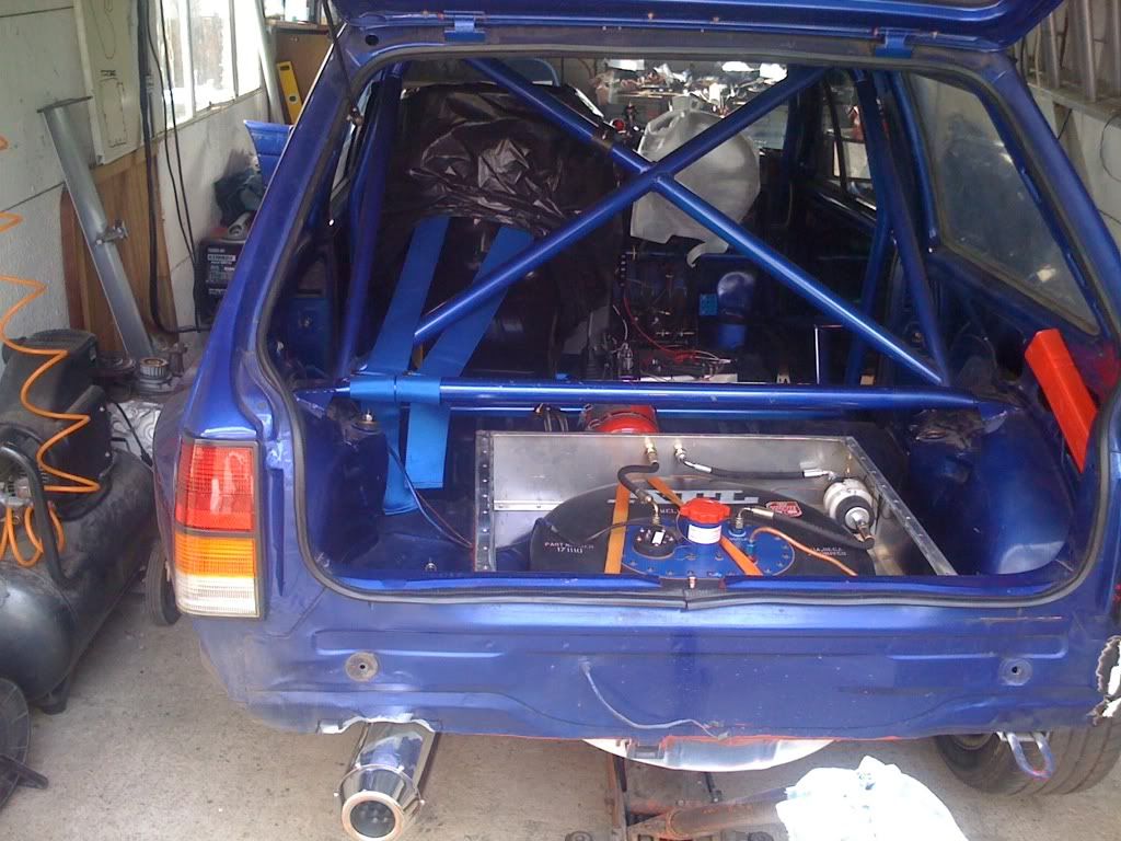

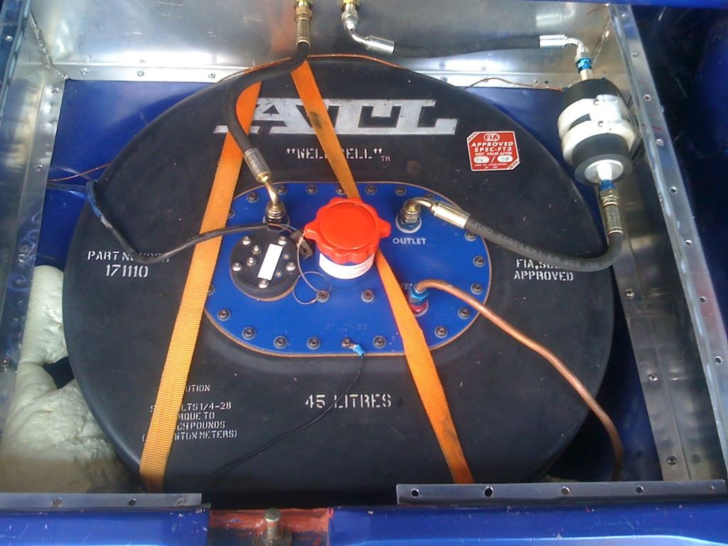

Another quick update fuel system totally finished now
Pics of ATL fuel cell set up
http://i828.photobucket.com/albums/z...3/79f4b803.jpg
Cover for fuel cell
http://i828.photobucket.com/albums/z...3/e38a69b5.jpg

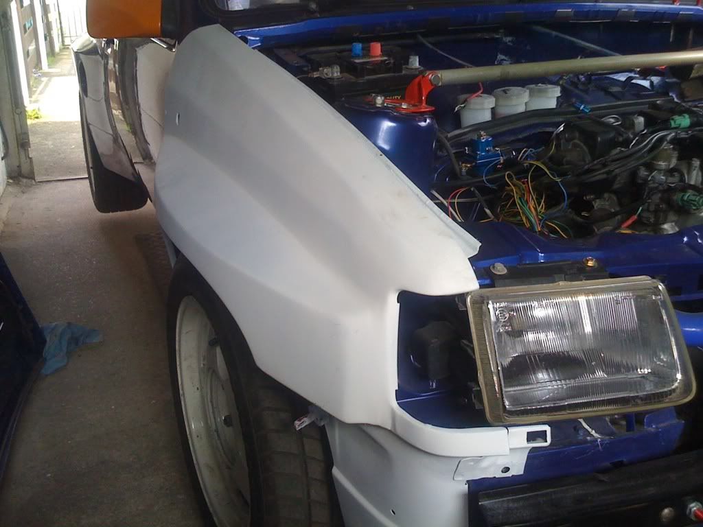

Drivers front wing finished ready for top coat
http://i828.photobucket.com/albums/z...3/ab32dfd8.jpg
Passenger wing 90% completed
http://i828.photobucket.com/albums/z...3/fbf75393.jpg

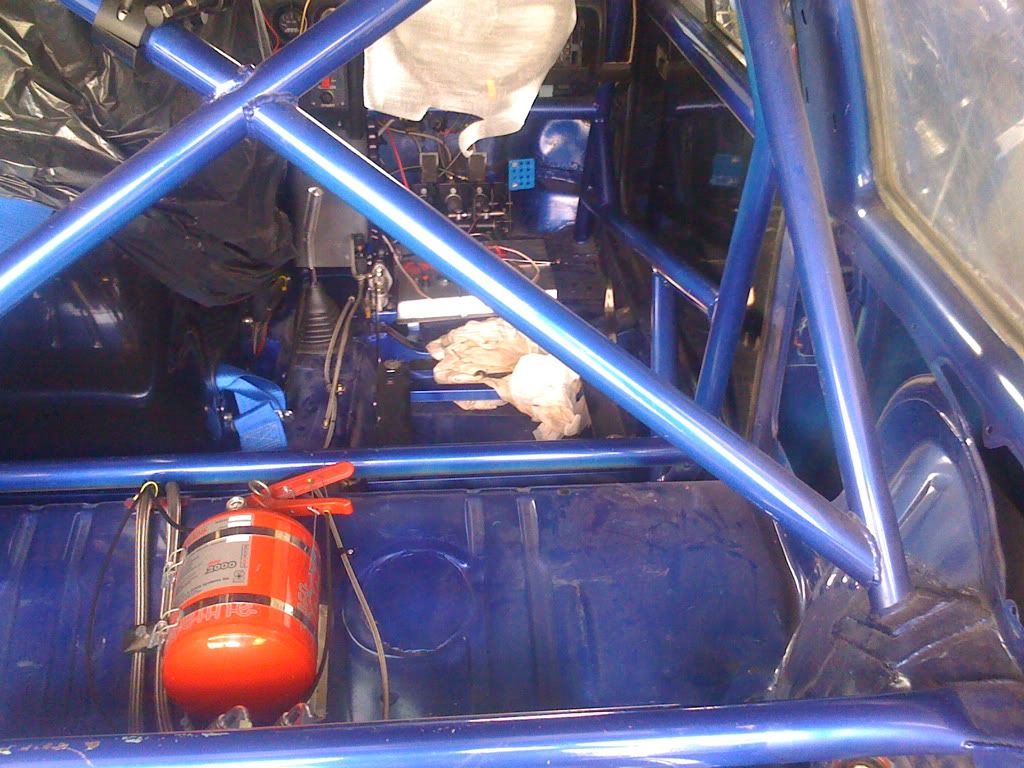

Quick inside shot
http://i828.photobucket.com/albums/z...3/1bd24f07.jpg
Rear end new repackable silencer
http://i828.photobucket.com/albums/z...3/0d77ffeb.jpg
