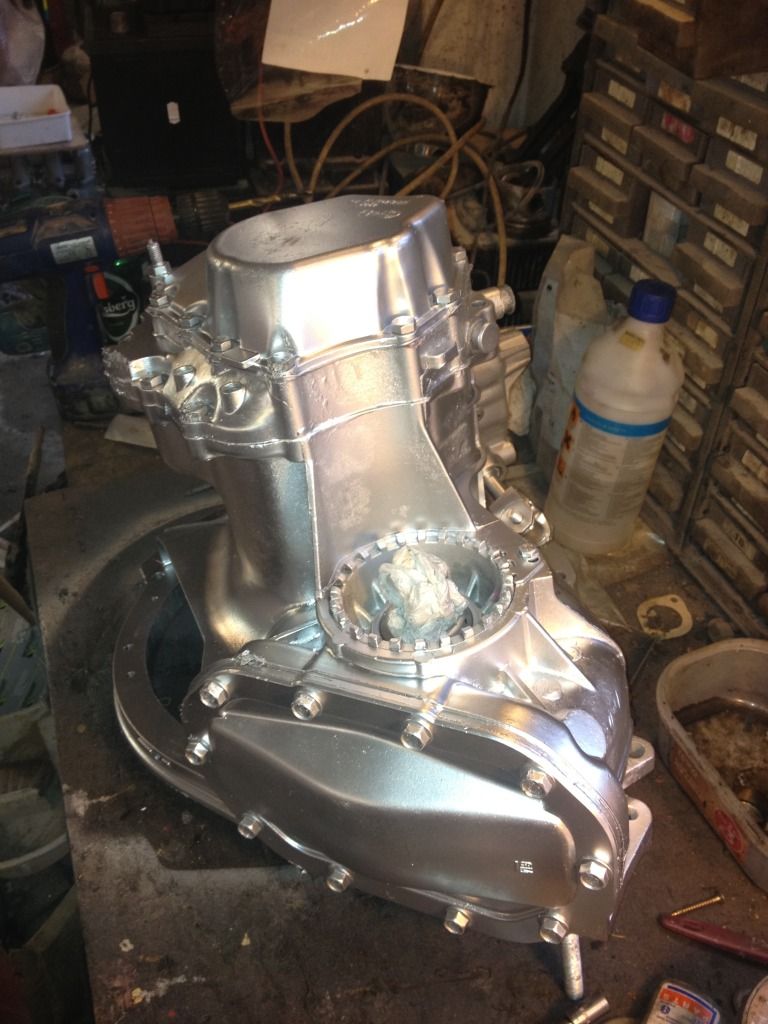

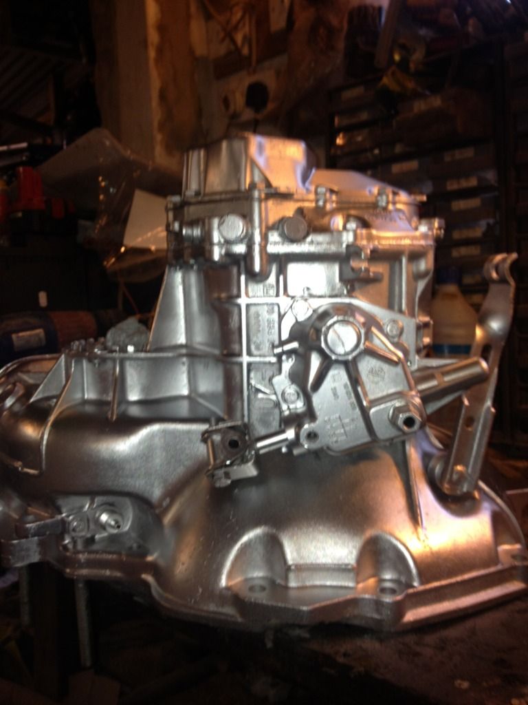

Gearbox looks nice and clean a bit too clean..... wont stay like that for long!
http://i641.photobucket.com/albums/u...uild/044-1.jpg
http://i641.photobucket.com/albums/u...uild/043-1.jpg

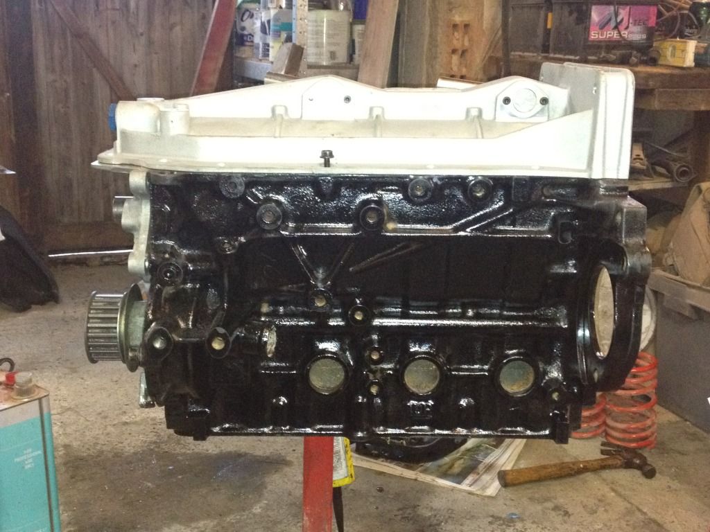

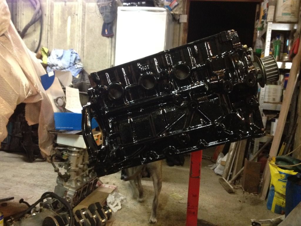

More painting, just couldnt resist after is acid dip!
http://i641.photobucket.com/albums/u...ebuild/028.jpg
Got the bungs in!
http://i641.photobucket.com/albums/u...uild/046-1.jpg

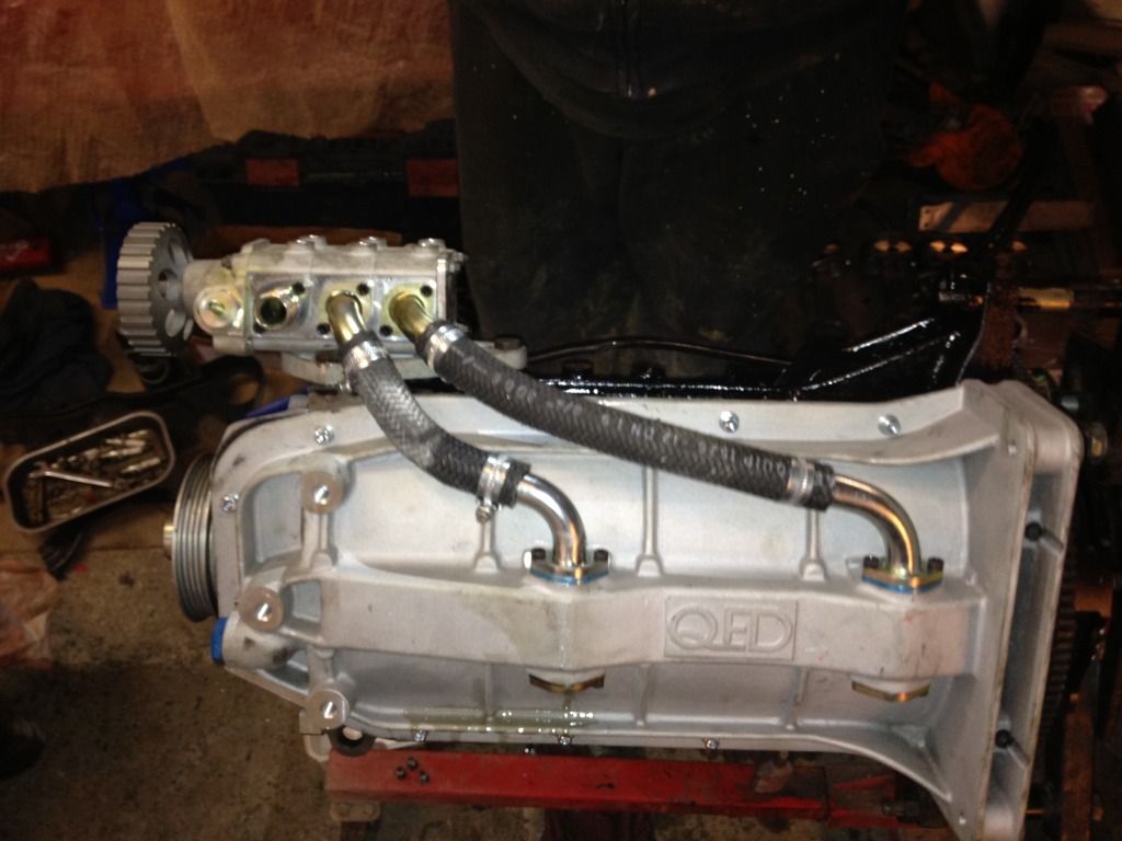

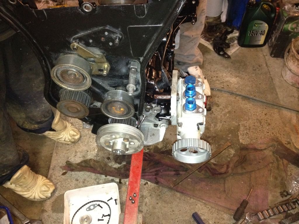

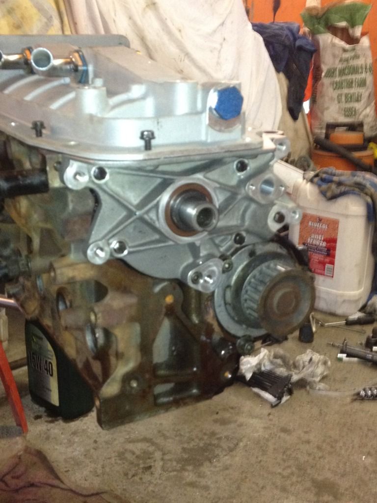

Sbd front plate oil pump replacement
http://i641.photobucket.com/albums/u...uild/040-1.jpg

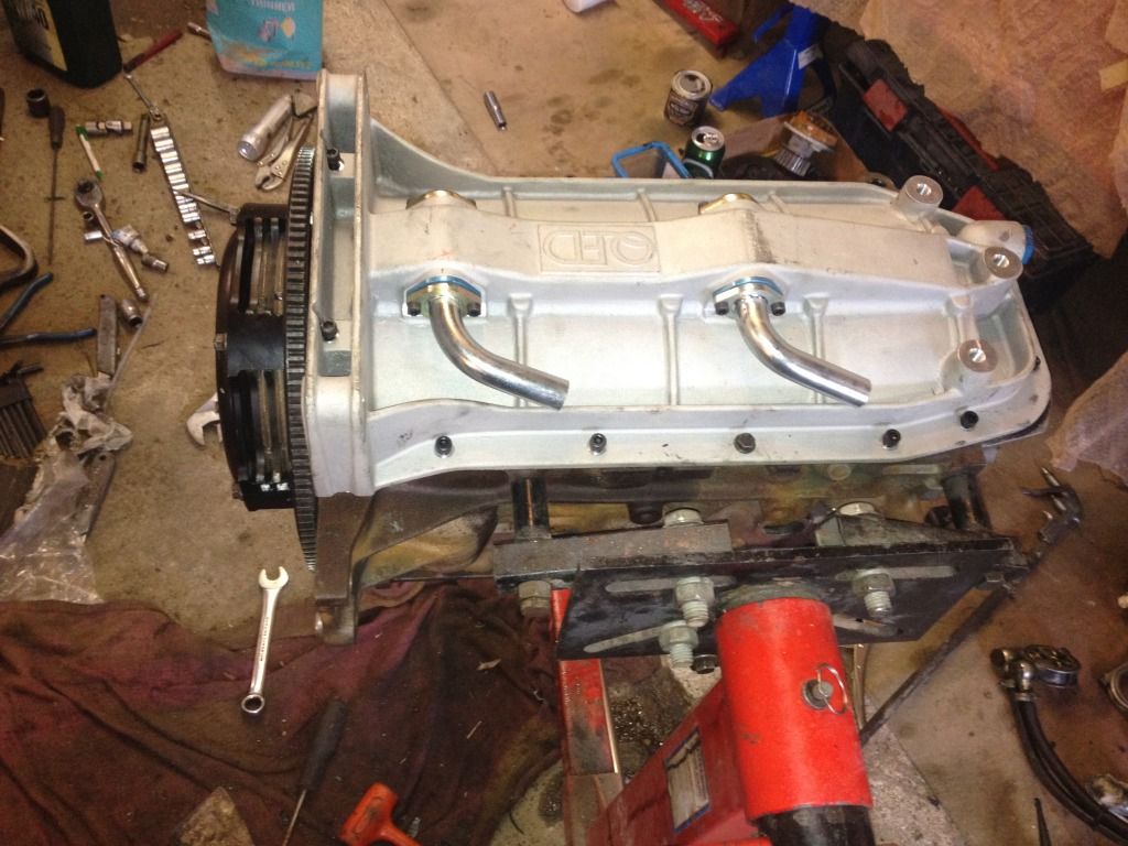

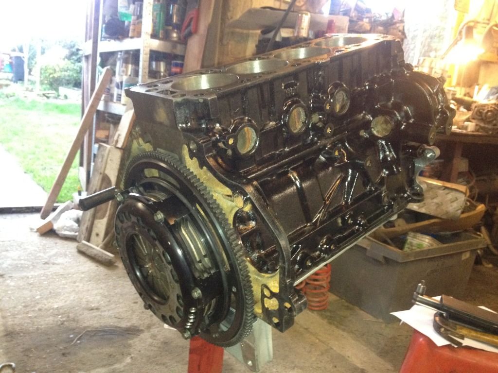

Got the twin plate 7"1/4 clutch on with 2 new plates
http://i641.photobucket.com/albums/u...ebuild/047.jpg

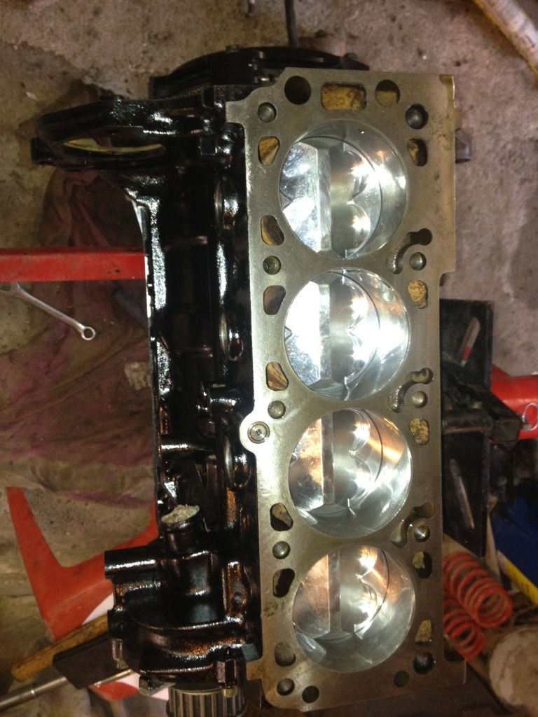

I did plop the head on for show, just to make me feel better! just waiting on the shims so we can get it on and check valve-piston clearence
http://i641.photobucket.com/albums/u...ebuild/049.jpg

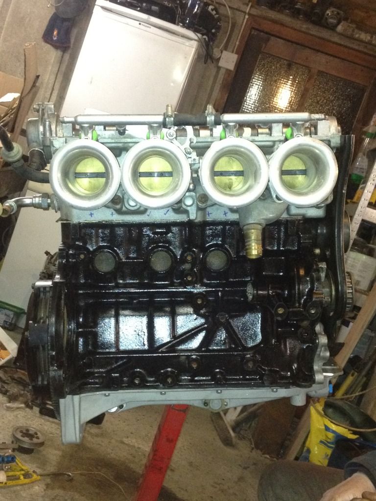

Not an awfull lot left to do on the engine its self, but now i can start prepping the bay ready and get the wiring done!

The sump pan is nicer than the SBD item by the looks of it as it can bolt to the lower half of the gearbox. Having seen a expensive gearbox fall to pieces ( Non Vaux ) as it wasn't bolted top and bottom its good to see QED/ Titan have thought ahead

Yeah i much prefer the QED kit although there were a few niggling bits with it!
