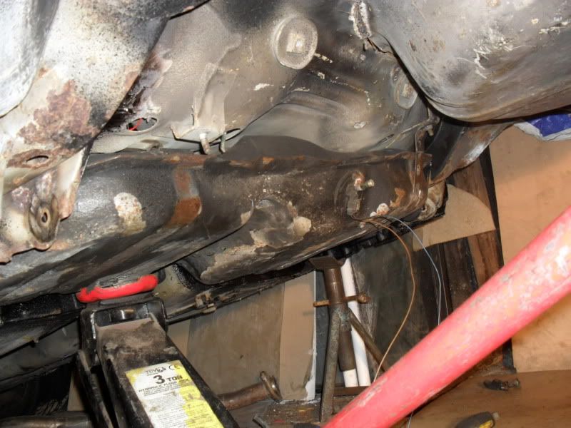

the sill need work anyway so im not bothered if they take the paint off, once all around the tank and beam is done and they are back on ill support it via the beamQuote:
Chassis leg is always better than the sills but you know that.
What's the plan all the rust sorted then start on the insides?
yes i know that but i want to work on the chassis legs lol
yes its only surface rust so will attack it all with the wire brush and then treat it before fresh underseal, the plan is to just get it sorted for its MOT first before worrying about making it look pretty lol

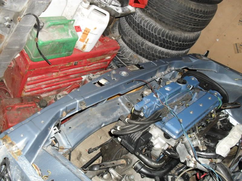

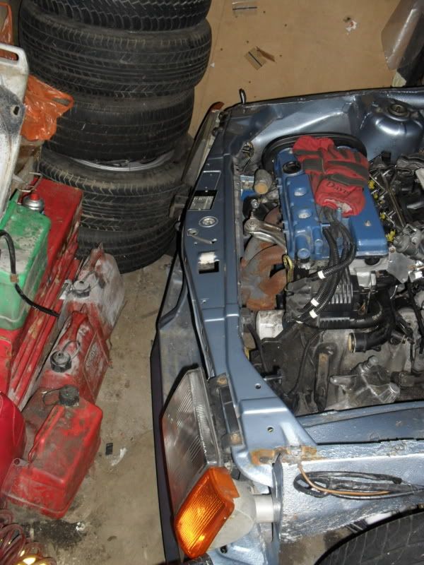

couldnt be arsed to get to grubby today so did abit in the engine bay
started by cleaning all round the bulkhead before putting the servo and wiper motor back in, i was a tit and put the wiper motor in before the servo, which doesnt work apparently lol. after i did that i decided to de-baxter the engine :p

i know its not a great deal but some is better than none when you've got this much todo, ill probably go out and start to sort out the engine loom later anyway :d
Good stuff Luke, forgot you had this!

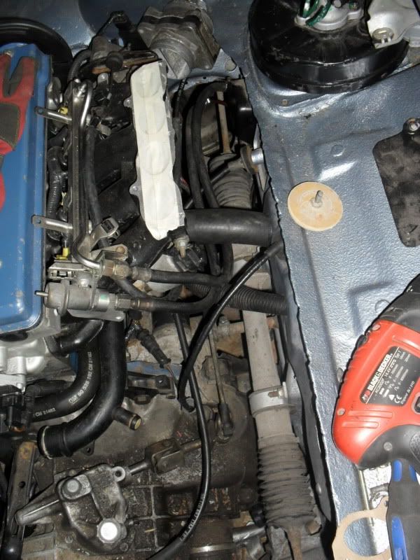

what fun ive had today, the task was to get the engine loom finished and i did :d
this is what i started with
http://i12.photobucket.com/albums/a2...t/SAM_0268.jpg
first i cleaned up the injectors and rail before re-tapping the mini loom to make it all tidy
http://i12.photobucket.com/albums/a2...t/SAM_0269.jpg

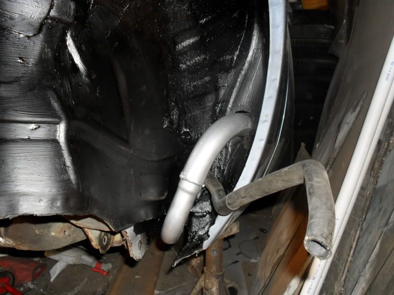

no not strictly the wiring this had to be done now, so found a suitable pipe to remove the heater matrix piping
http://i12.photobucket.com/albums/a2...t/SAM_0271.jpg
and then the fun begins
http://i12.photobucket.com/albums/a2...t/SAM_0272.jpg
not any pics of how i changed the loom to fit but it does lol, i also decided to hide it within a pipe aswell so it looks like there no wiring at all
http://i12.photobucket.com/albums/a2...t/SAM_0273.jpg
and inside
http://i12.photobucket.com/albums/a2...t/SAM_0274.jpg
i placed the powerbox on aswell to see how it looked, now bare in mind everything is plugged in so that in theory it would run, done a pretty good job of hiding it all even if i do say so myself

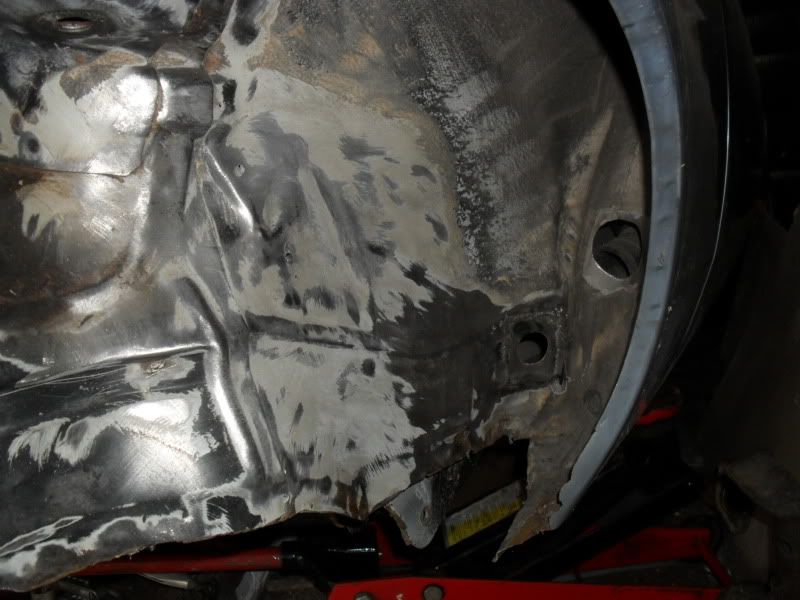

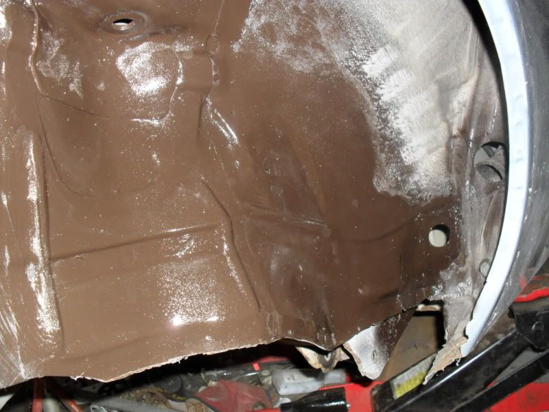

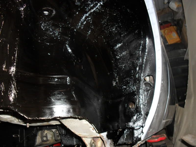

being as that was done i attacked the arch with the drill and then kurust
http://i12.photobucket.com/albums/a2...t/SAM_0280.jpg
decided my back had had enough by now so that'll do for today

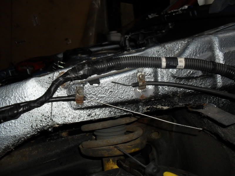

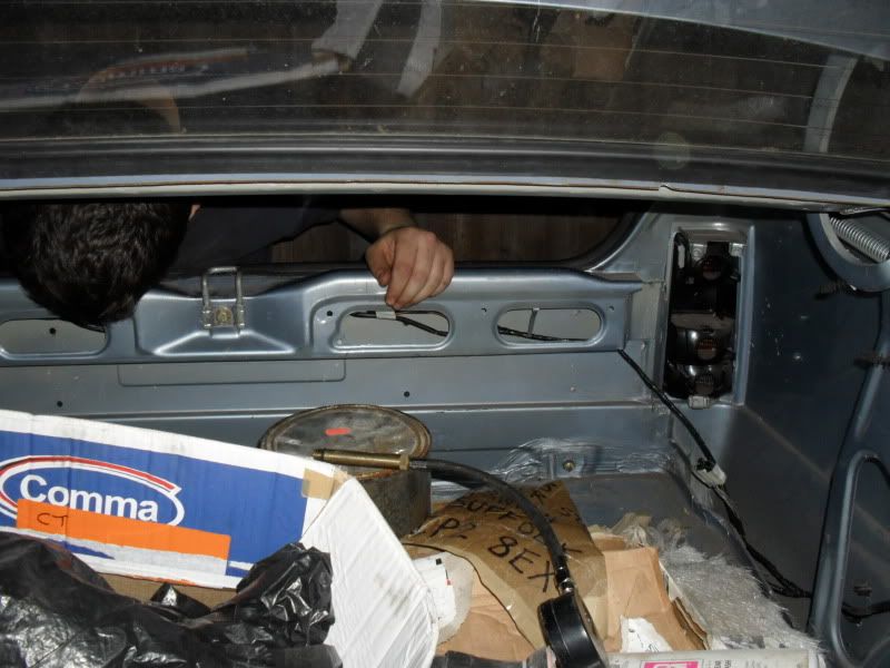

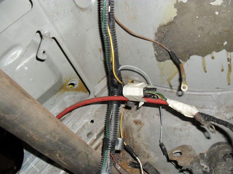

with that done i decided to get my loom fitted, all hidden away naturally

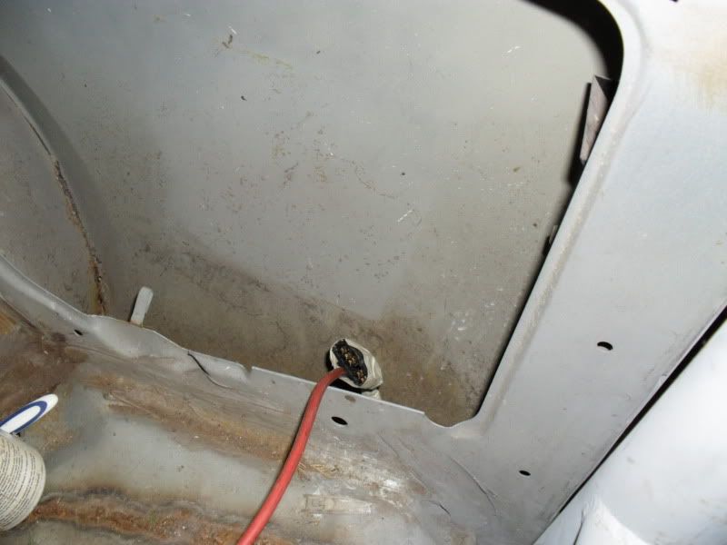

attaching the rear half to a wire to pull through the sill
http://i12.photobucket.com/albums/a2...t/SAM_0289.jpg

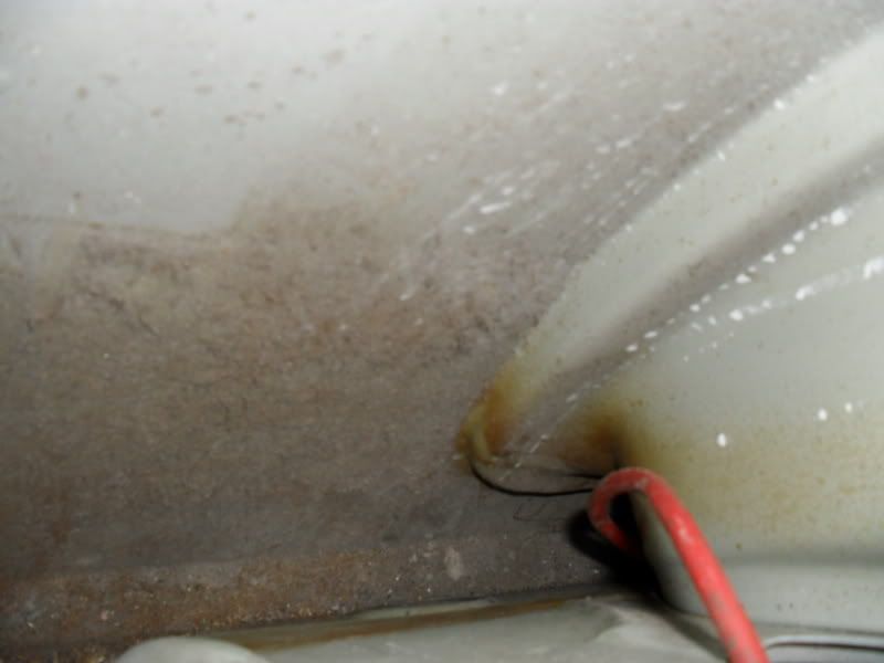

coming up here (yes my sills are lush)
http://i12.photobucket.com/albums/a2...t/SAM_0290.jpg
there it is
http://i12.photobucket.com/albums/a2...t/SAM_0292.jpg
sam fitting it back into the rear panel
http://i12.photobucket.com/albums/a2...t/SAM_0293.jpg

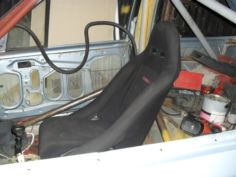

also placed my seat in, this is actually how it is going to sit, i love how low it is, bare in mind the top of my head sits the same level as the top of the seat :d

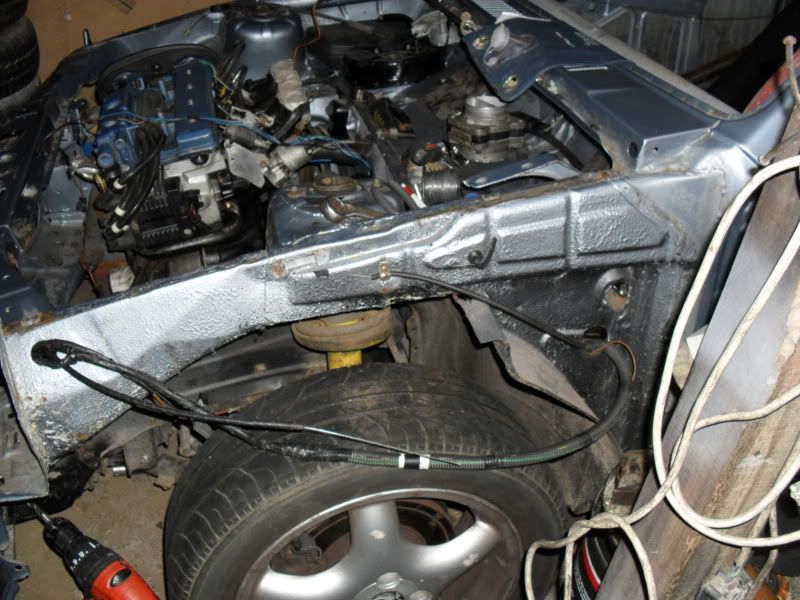

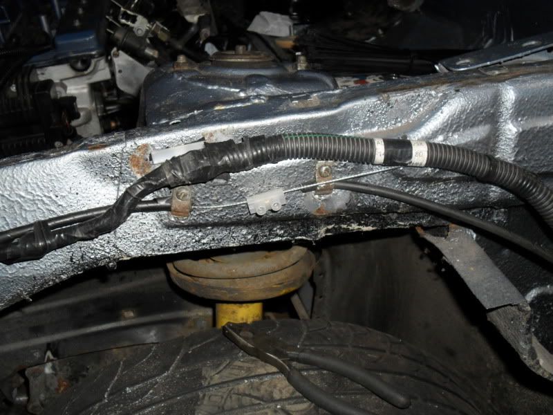

this one is more for southie, my lighting wiring, fan, horn and stuff is actually all fitted here ;), also re routing my bonnet pull as well
http://i12.photobucket.com/albums/a2...t/SAM_0295.jpg
where it all hides, will get a better pic of the bonnet pull cable once its finished
http://i12.photobucket.com/albums/a2...t/SAM_0296.jpg

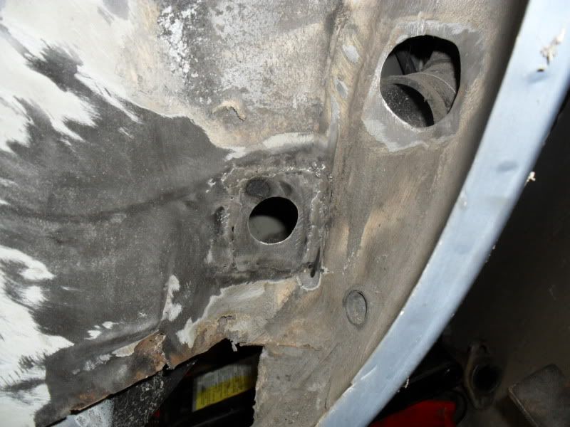

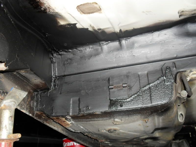

decided to do the work to allow me to fit the fuel tank today which meant sorting this
http://i12.photobucket.com/albums/a2...t/SAM_0260.jpg
forgot to take any pics of whilst doing it but basically cut generously around it, plated it and then drilled the new breather pipe hole
http://i12.photobucket.com/albums/a2...t/SAM_0407.jpg
http://i12.photobucket.com/albums/a2...t/SAM_0408.jpg
then lobbed on some random paint (brazil brown FTW)
http://i12.photobucket.com/albums/a2...t/SAM_0410.jpg
then underseal
http://i12.photobucket.com/albums/a2...t/SAM_0413.jpg
done (ish), ignore random hose lol
http://i12.photobucket.com/albums/a2...t/SAM_0416.jpg

my extension of the bonnet cable is almost complete, just need a choc block to join the cables
http://i12.photobucket.com/albums/a2...t/SAM_0417.jpg

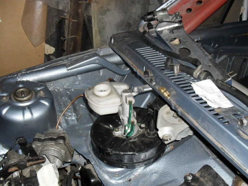

new master cylinder that me brother robbed for me bolted in
http://i12.photobucket.com/albums/a2...t/SAM_0420.jpg

You sure your gonna see over your dash with the seat that low lol lol
i dont have a dash...... so yes :dQuote:

a quick question though because i want to do the same sort of thing how are you gonna mount your seat that low have you got some box section welded in ??
yes ive just got some 1 inch box section that i'll be welding in, ill take pics when i do it :dQuote:

Are you gonna be running the lhd bonnet pull then? How come the join the cable is huge, i had to cut loads out of mine.
Good work with the cable and loom, i love hiding the loom in the sill, very trick.
nice car cant wait to see at pv keep up the good work
no bonnet pull is in the normal place lol hence the join as ive had to use two bonnet cablesQuote:

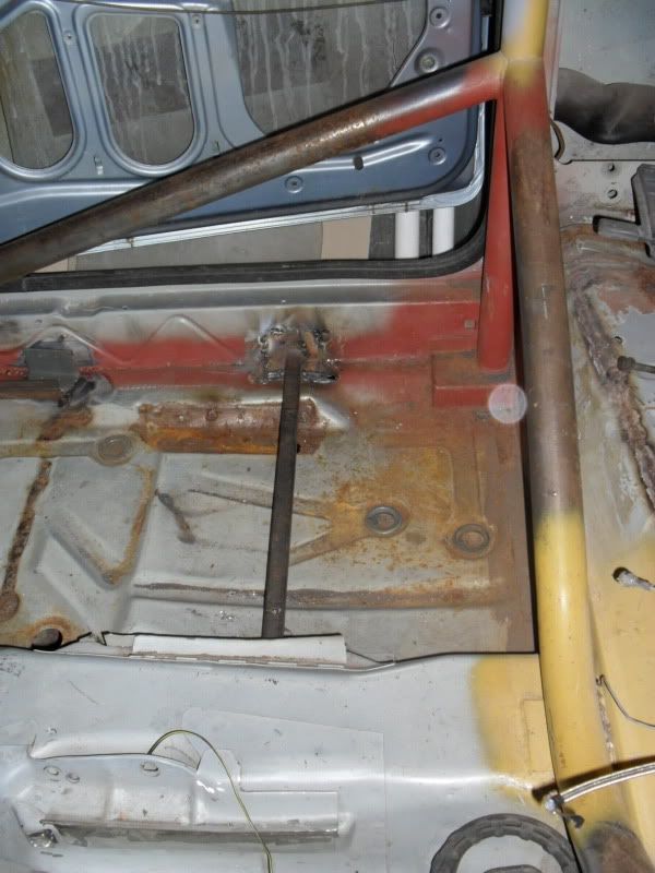

i decided to try and get the seat mounted today, tis confusing and very awkward being as im bolting directly and not using mounts. because of how late i started i only got the back bar in lol, front one will be in tomorrow

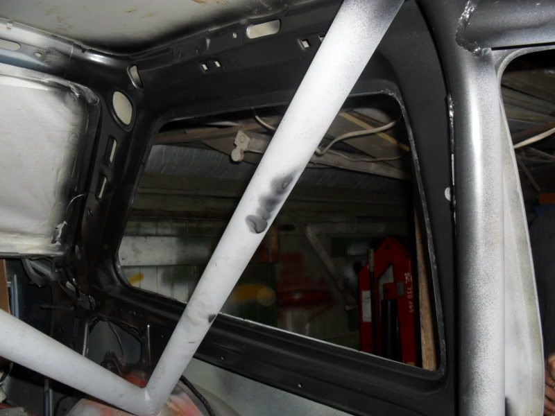

i then decided to start throwing some paint around, because i couldnt find the colour i wanted in the book i went for silver - 02 :confused: dark metalic silver anyway
http://i12.photobucket.com/albums/a2...t/SAM_0430.jpg
http://i12.photobucket.com/albums/a2...t/SAM_0432.jpg
http://i12.photobucket.com/albums/a2...t/SAM_0433.jpg
yes im only using rattle cans but its only gotta last a couple of years and will look 10 times better than it does at the mo
bonnet pull connected and works pukka as well :d
http://i12.photobucket.com/albums/a2...t/SAM_0435.jpg
