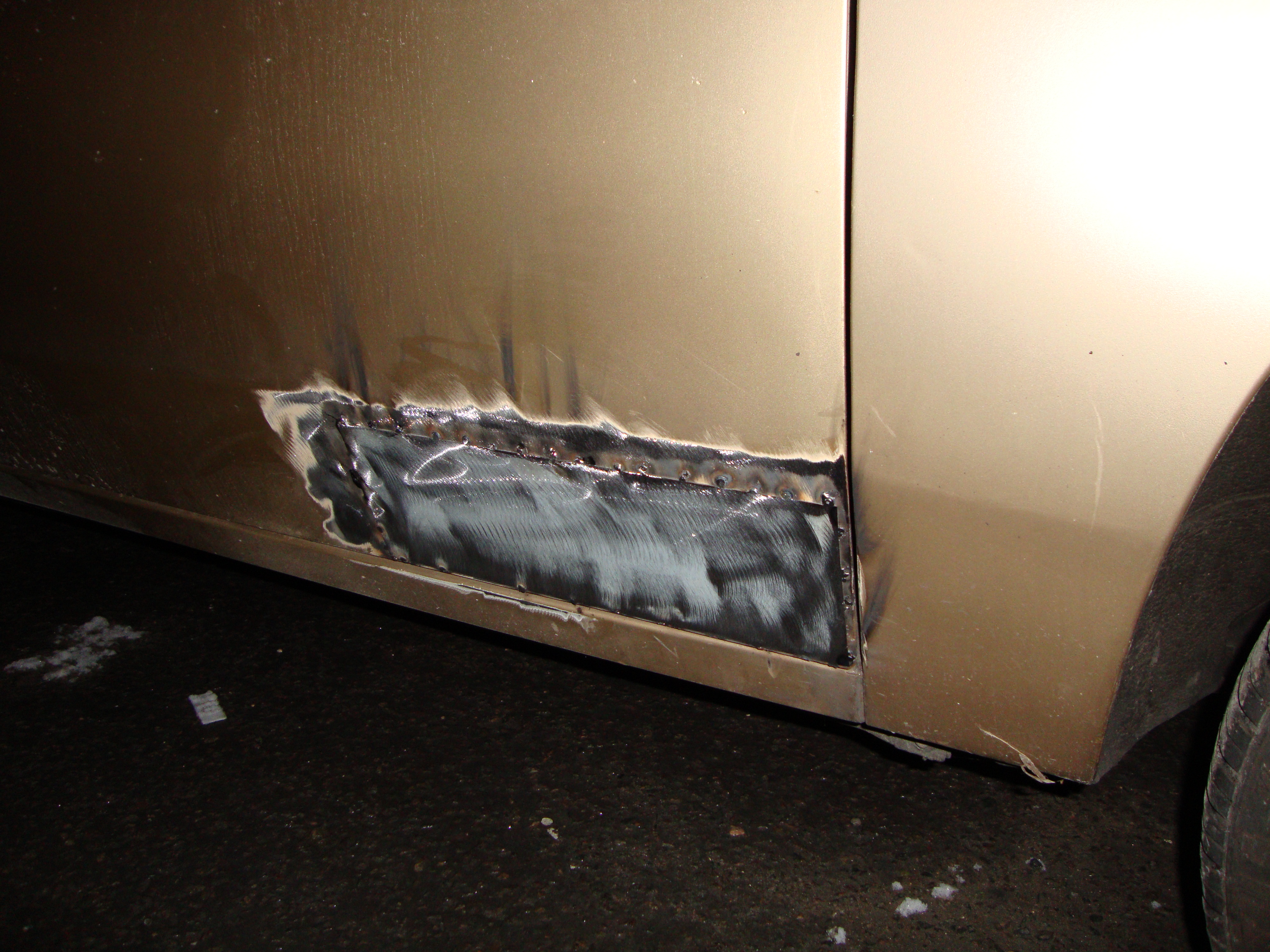

Look just wanged on TBH. with no folding of the standard arch or the new replacement panel :confused:Quote:
Coming on well! Looking forward to new pics!
They're not 'wanged on'. I double checked today when I went there. He cut the original panel and then fitted the new panel on but put a slight overlap of the two panels. He did do cutting as the inner arch was in worse shape than the outer arch so he did plenty of cutting and cleaning.Quote:

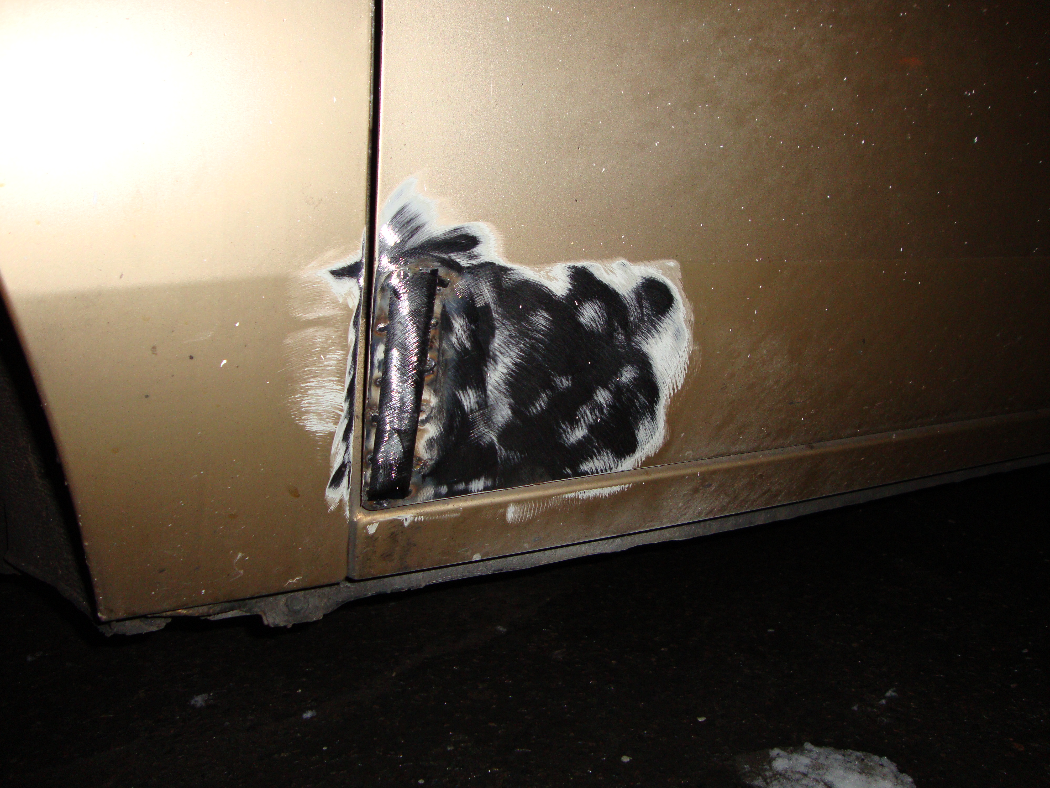

I went and visited them earlier on and they had completed all exterior weld work.
Here's the pics:

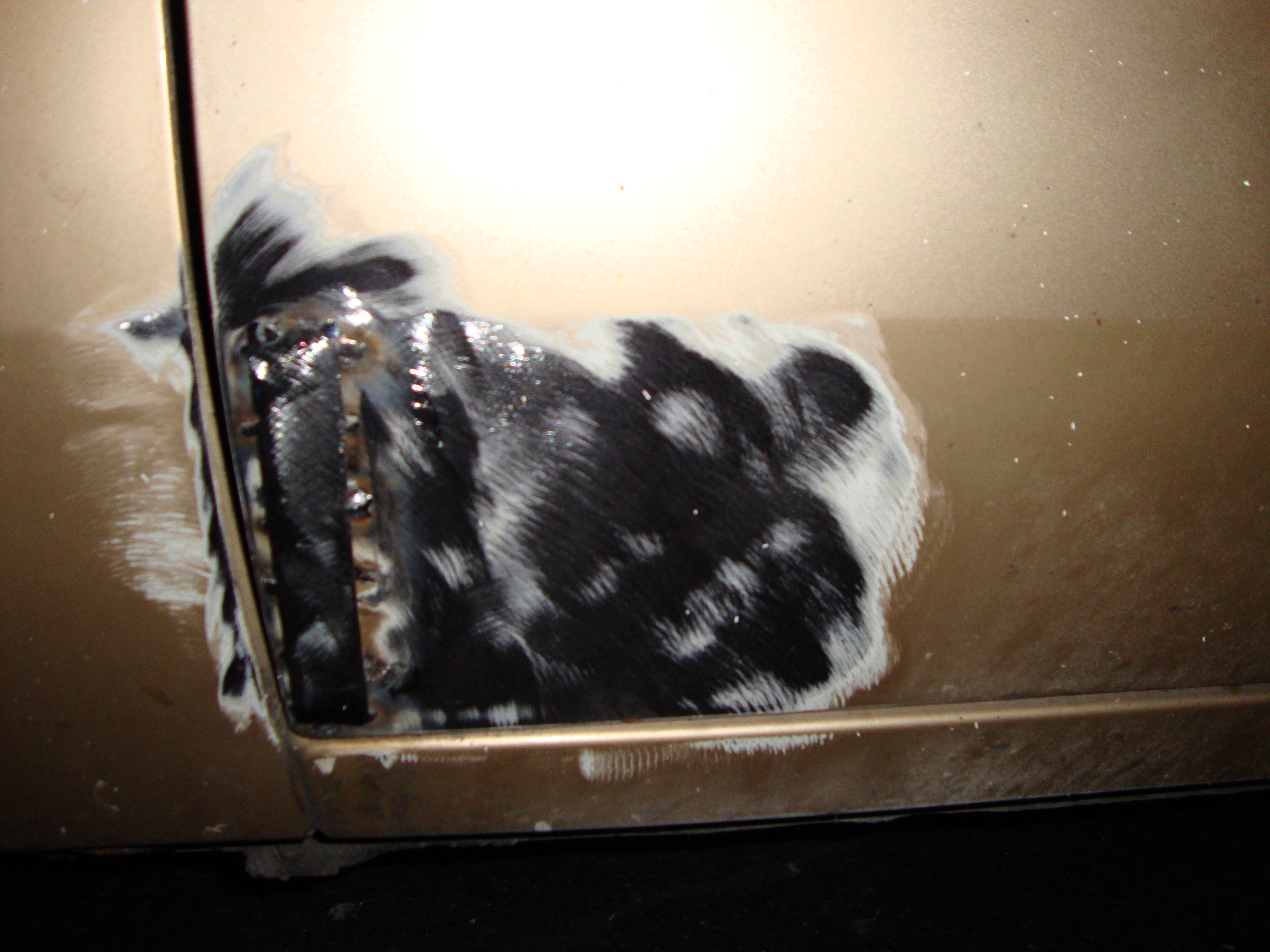

Passenger door: (sorry for the out of focus shot, was rather dark)
https://images2.imgbox.com/00/07/iFwKkqkQ_o.jpg
http://img28.imageshack.us/img28/7295/dsc00603k.jpg
http://img191.imageshack.us/img191/7739/dsc00604wl.jpg
http://img707.imageshack.us/img707/5152/dsc00605f.jpg
https://images2.imgbox.com/c6/cb/waLZGoPE_o.jpg
https://images2.imgbox.com/6d/ec/2U2pAxDM_o.jpg

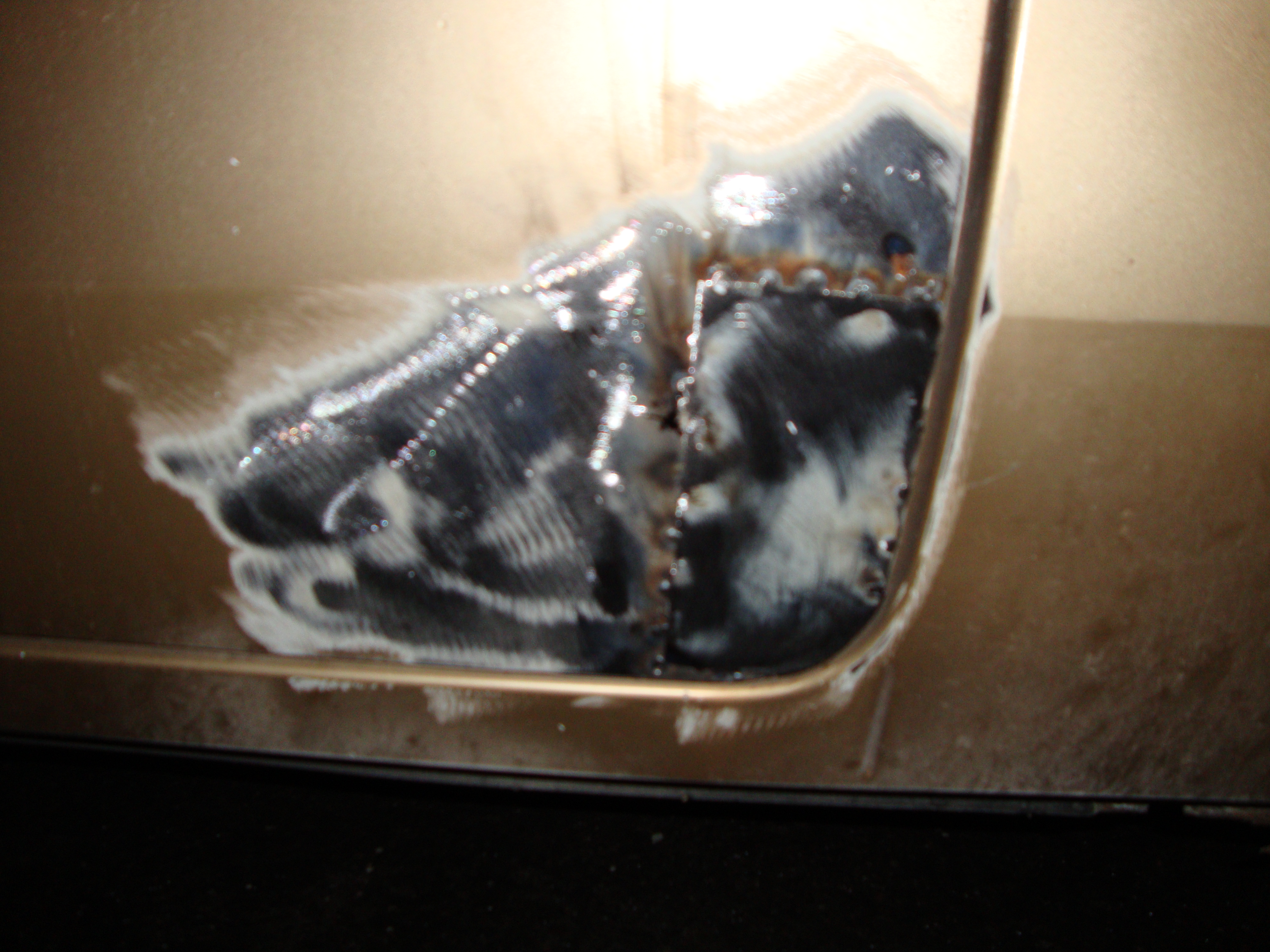

Driver door:
https://images2.imgbox.com/0a/f4/q2ExBQVb_o.jpg
http://img191.imageshack.us/img191/3083/dsc00601f.jpg
For the drivers door the rust seemed a small hole but just behind the paint it started to go so they cut away more skin to weld a bigger plate for a neater job and get rid of any chance of corrosion starting over.
He said aside from that the doors were fine and the door bottoms were clean too. He said after paint he will waxoyl the doors.
He will be starting filler work for the whole body. He said that the car had been repainted in it's life and it was done rather badly as the paint finish was fairly rippled when looked closely. So he will be doing extensive smoothing and filler work to get it 'glass' smooth :)
As for the concerns. I do understand what you are saying, and yes other people are never as detailed as we enthusiasts are. But I've visited every two days and on some occasions everyday when possible. The body shop even rings me to say that they've done something for me to come check and make sure it's fine. So I have no concerns of corners being cut.
That is all for now :thumb:

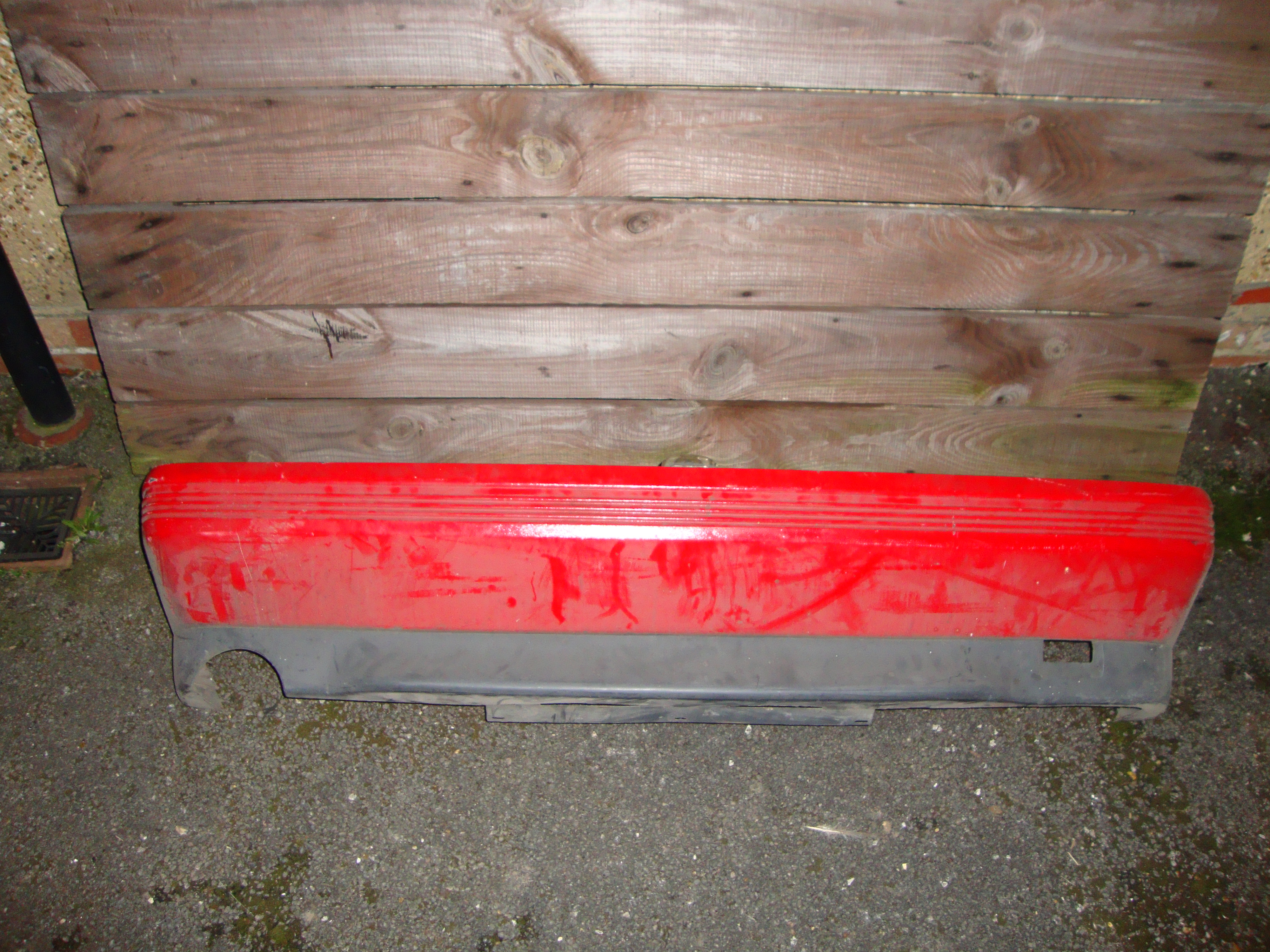

Should be getting my GTE rear bumper tomorrow :thumb:
Small update:
I went and got my GTE rear bumper:
https://images2.imgbox.com/c2/b8/ZOgeqqFq_o.jpg
http://img638.imageshack.us/img638/5222/dsc00607a.jpg
http://img52.imageshack.us/img52/9053/dsc00610s.jpg
Got it off G-Mans off here (cheers bro :thumb: ), a top bloke. We had a good chat, talked about Nova's (obviously) and admired his MINT Nova! Ignore the fact that it's a bit dirty, all the important bits are straight and in good condition and I got it for a great price too. Not worried about the colour as it'll be getting sorted at the bodyshop.
Tomorrow I will be dropping off the bumper taking my pov spec one home :) Hopefully there will be some filler work done too.

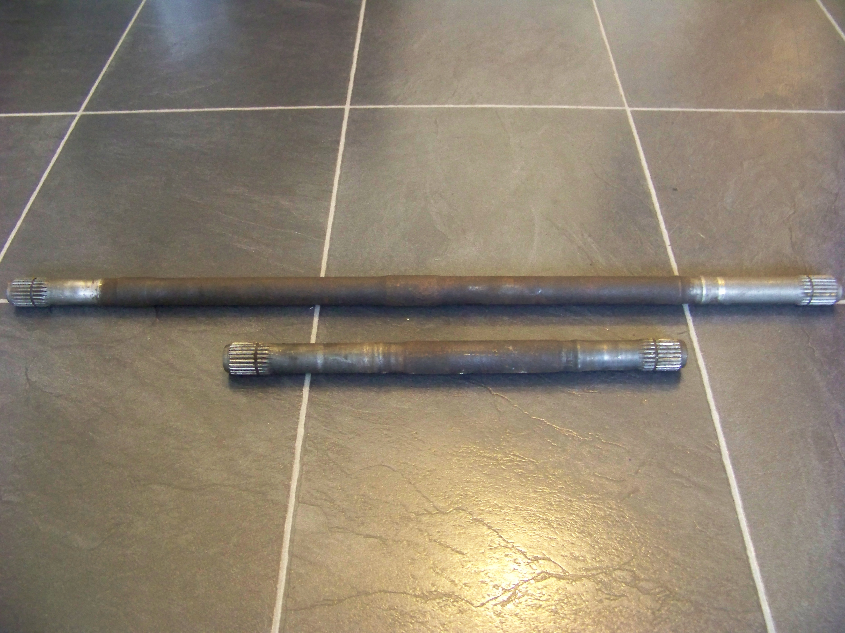

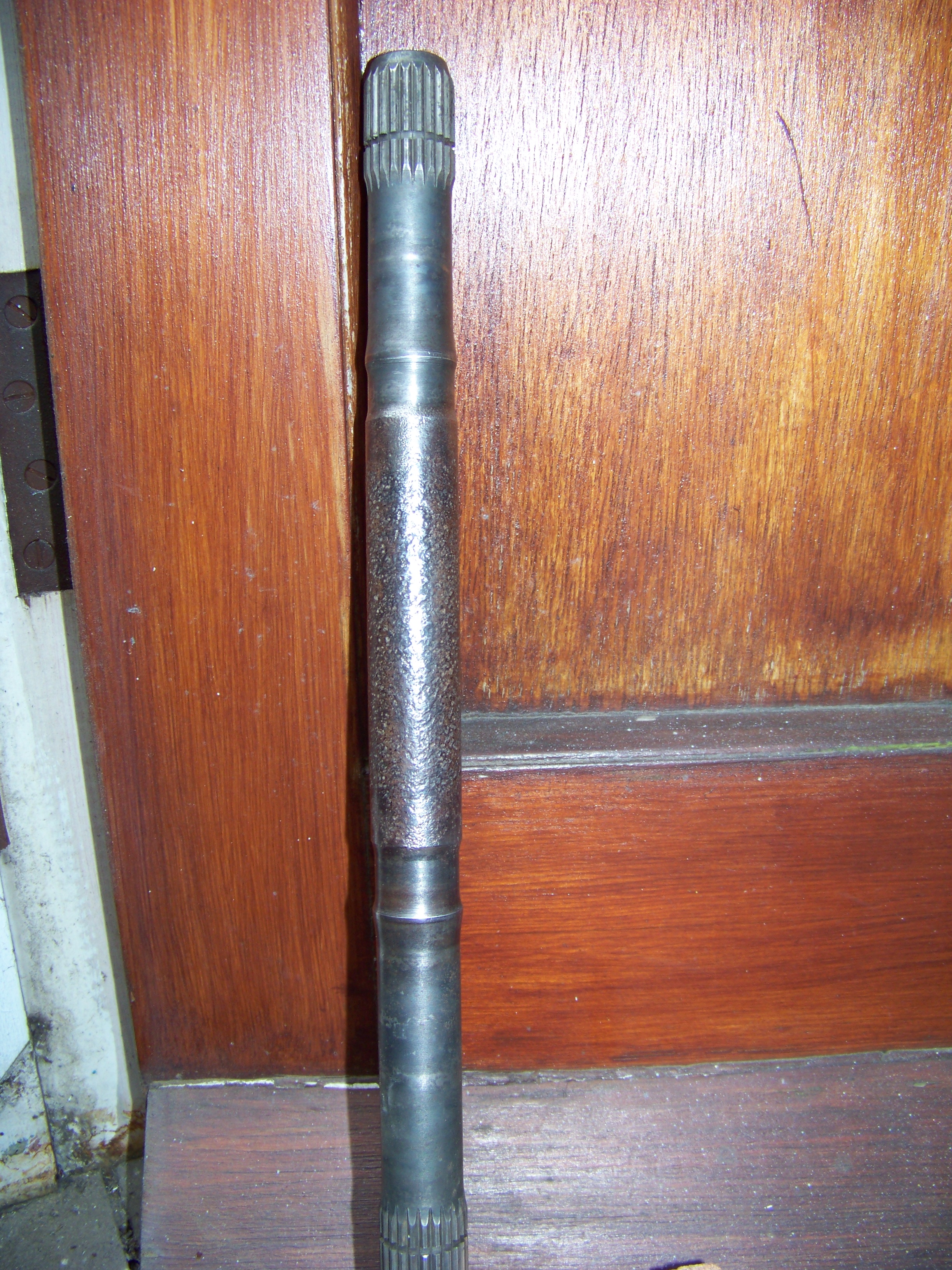

22 Spline GTE Shafts from Damen
https://images2.imgbox.com/e5/5f/0gn9V0U1_o.jpg
http://img717.imageshack.us/img717/6173/1000582k.jpg

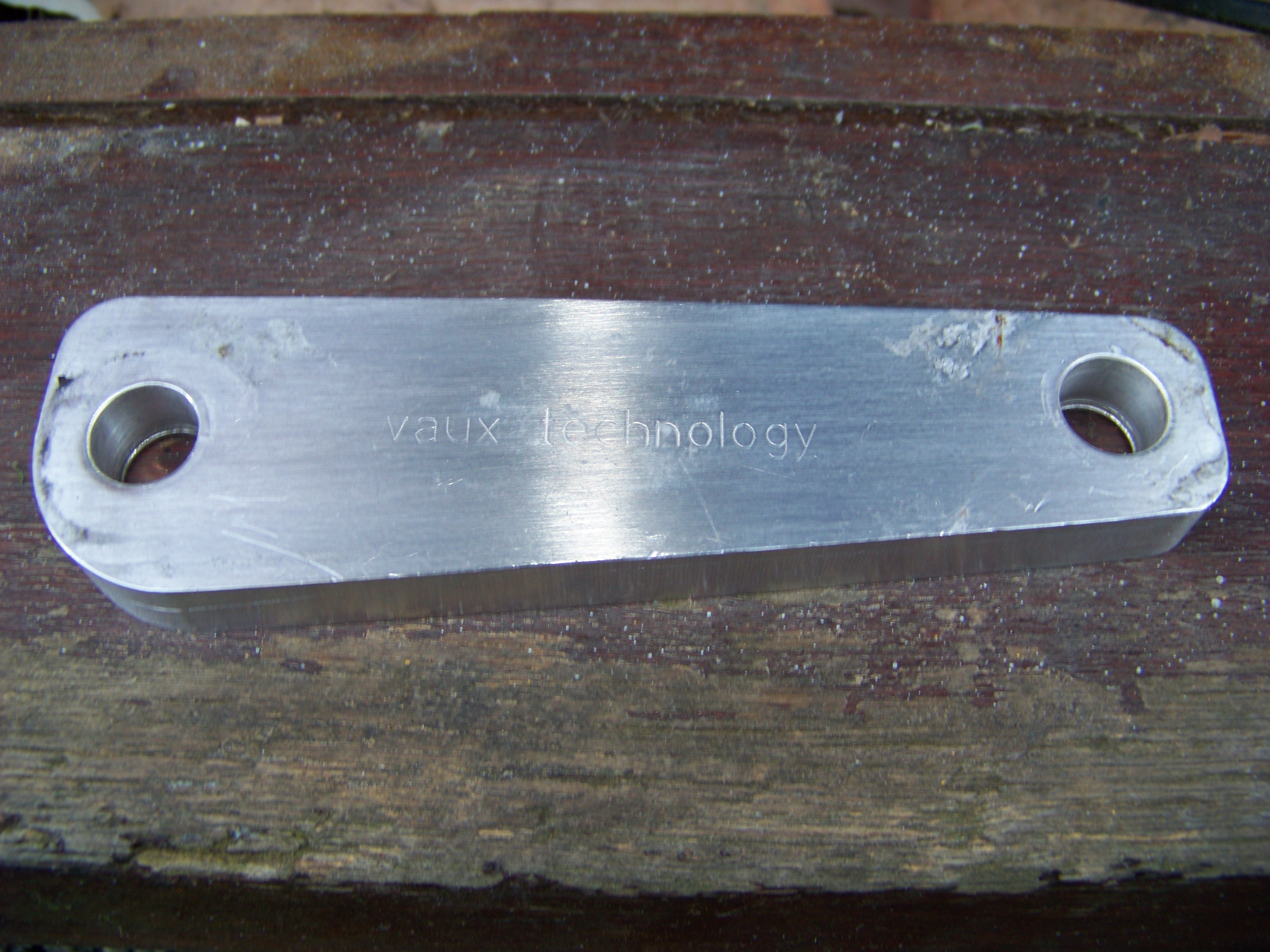

Started off with the easiest part, the M-Tech gearbox spacer. Gave it a good clean with some washing up liquid, then a light rub down with some very fine wet n dry to remove the tougher dirt and polished it up with some t-cut.
Still has some slight corrosion around the mount holes but no biggie, still looks clean.
https://images2.imgbox.com/96/b5/mfBpRf8u_o.jpg
http://img52.imageshack.us/img52/4742/1000578.jpg
^ Vaux Technology … V-TEC?? ^

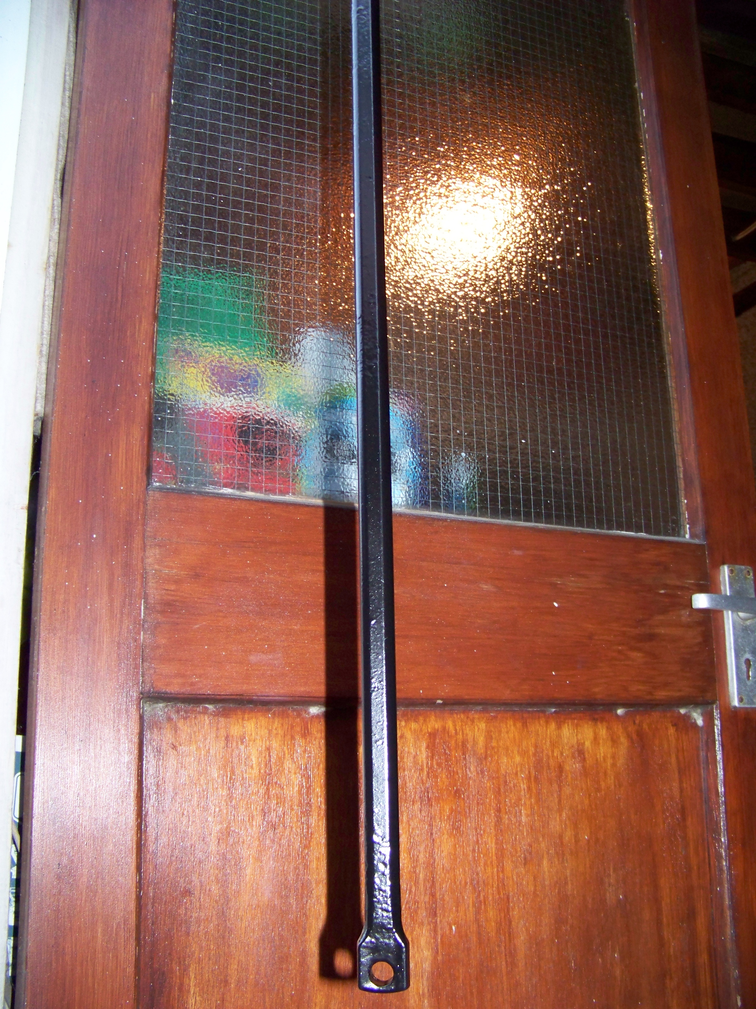

The rear ARB was next on the list as that was quite flakey and dirty. Attacked it with a power drill with a wire brush attachment. It was going well but after a while didn't seem to cut through the paint very well. So I flicked the rotation direction to counter clockwise and boy did it shift the crap off it.
After some power tools treatment
https://images2.imgbox.com/cc/7c/p9qOACVm_o.jpg
http://img687.imageshack.us/img687/4451/1000580k.jpg
Couple coats of acid etch primer
https://images2.imgbox.com/da/33/Z5aCYOOv_o.jpg
http://img707.imageshack.us/img707/6735/1000579.jpg
Let that dry for a bit......................................
Then I thought I'd smooth it out a bit with some filler primer and once that had dried, it was time to give it some good few coats of enamel black. I chose this as it's a very tough wearing finish, which can be easily recoated and has a rubbery feel to it.

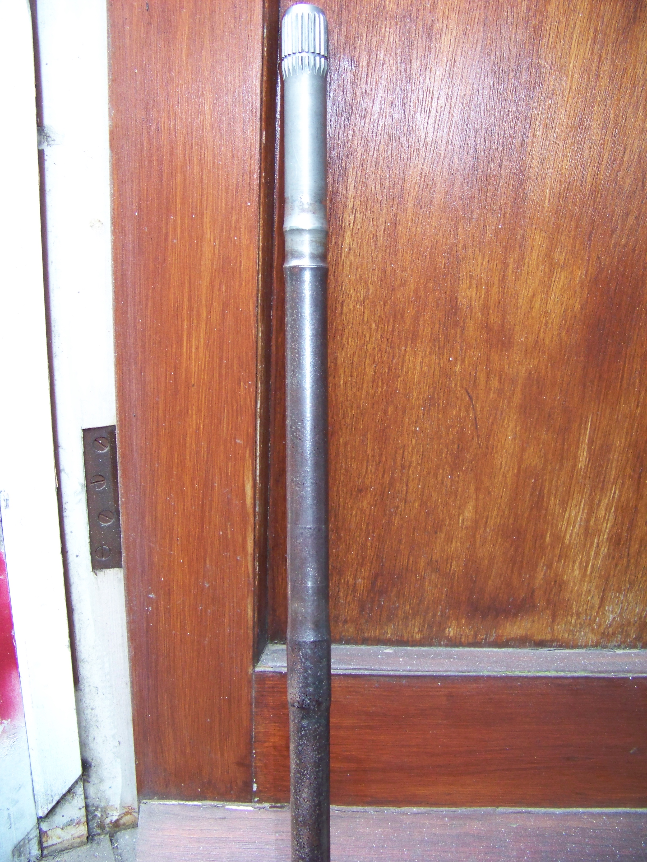

Just about to go start working on the shafts. They're only grubby, so a clean, light rub down with wet n dry and some lovely sliver Hammerite should make them look mint again.
I assume it's only best to paint the dirty areas of the shafts (if you look at the pic).

So I started cleaning up the shafts, at first I thought it was just a bit of road dirt, grease, but soon found out that wet n dry and a cloth weren't going to clean anything... so out came the drill and wire brush again. They were nowhere near as bad as the rear ARB and the wire brush cleaned them up rather swiftly.
Long shaft
https://images2.imgbox.com/bc/7b/tYaVLvAE_o.jpg
http://img215.imageshack.us/img215/8730/1000584o.jpg

Between coats I went back to the shorter shaft and cleaned that up, it took no time at all
https://images2.imgbox.com/1e/00/0zWX2H31_o.jpg
http://img91.imageshack.us/img91/954/1000585.jpg

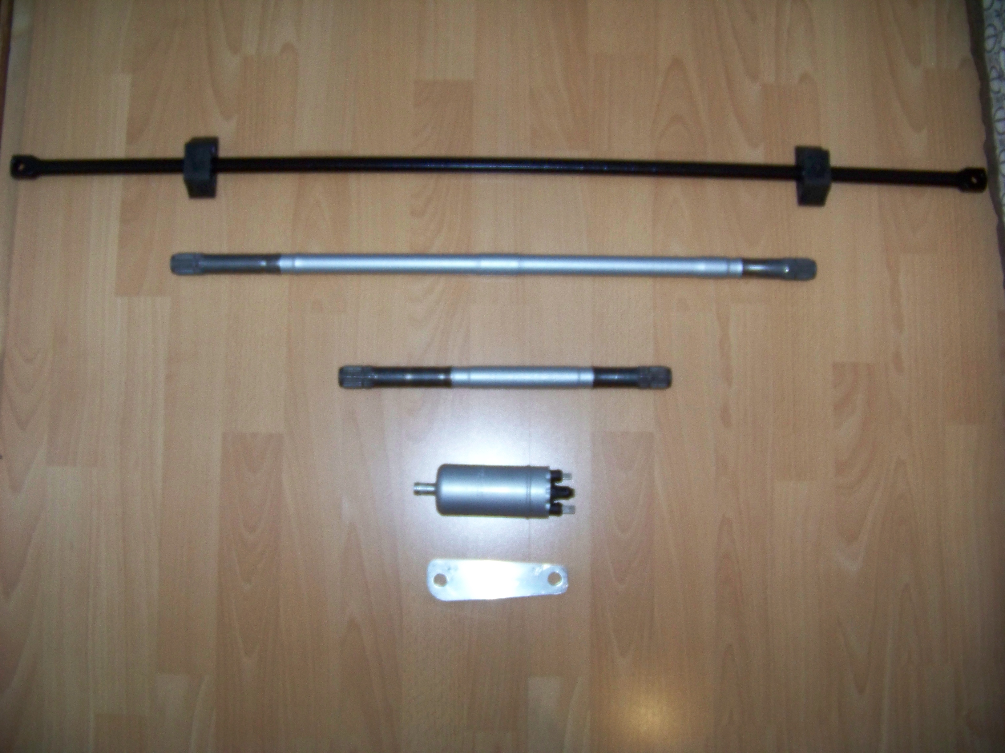

I alternated between the two shafts and once I had applied 3/4 coats of paint I put them aside to set.
I then started on the fuel pump. Again, wasn't too dirty just needed a quick clean. I undid all the rusty jubilee clips (one had actually snapped whilst unscrewing it), removed the fatter rubber hose and then the smaller rubber hose.... oops! Dunno how or why but as I pulled off the rubber hose from the smaller end I also pulled off half the nipple where the hose clamps on to :cry: It will now mean I have to improvise a connection so that it doesn't leak :mad:
Cleaned up the pump then thought 'hmm why not give it a light coat of silver'. 'Tis what I did.
Unfortunately, no pic of the pump as my camera is really doing my head in.
I left the pump and shafts overnight in the warm garage for them to harden. With some fresh batteries I shall be taking some after shots of them.

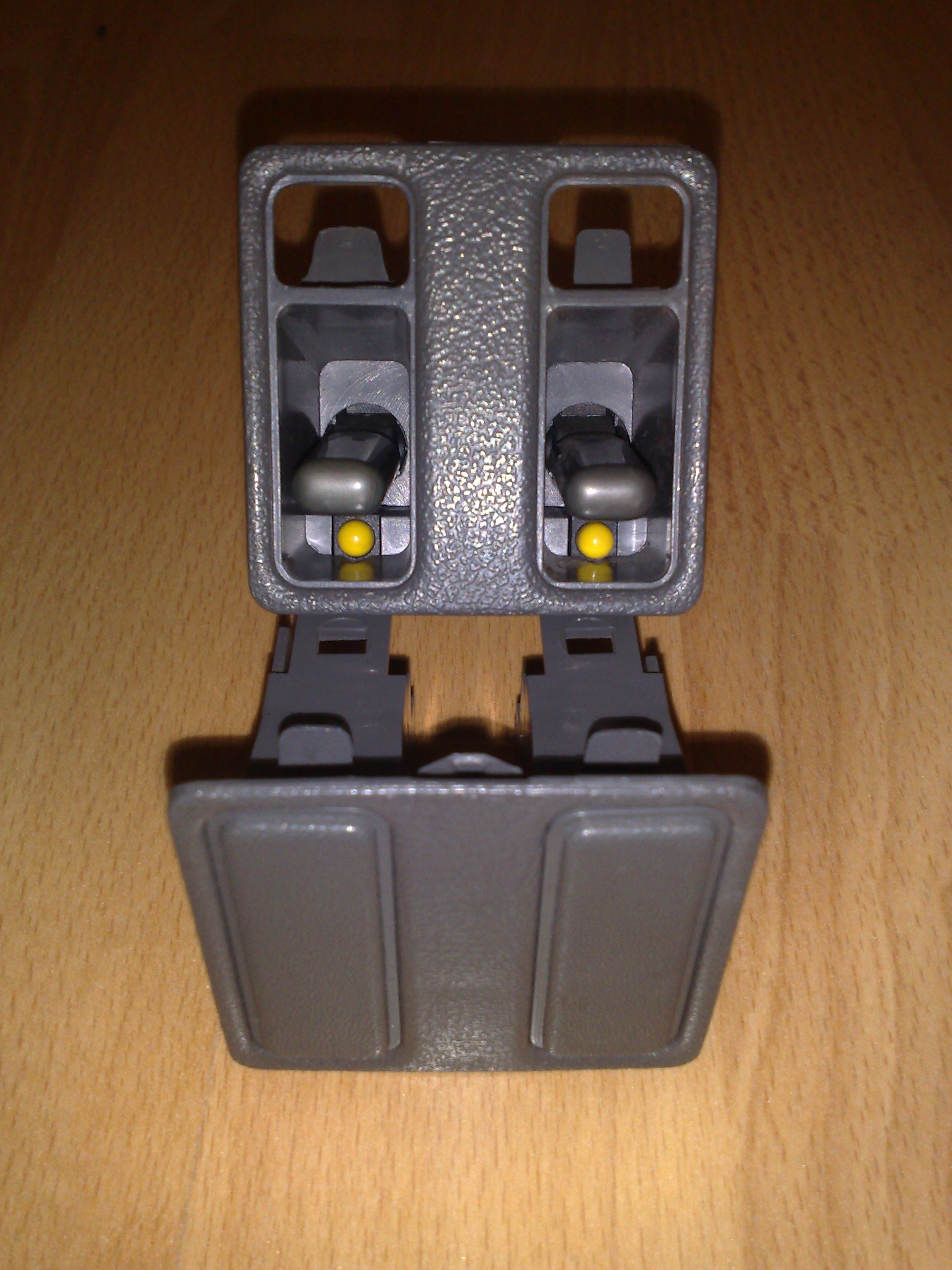

More switch-a-roos. These will be used for the heated screen and manual cooling fan override.
https://images2.imgbox.com/a3/99/HIT7afGn_o.jpg
http://img188.imageshack.us/img188/6650/28012010293.jpg
And the finished product (please excuse the blurry photo looked great on a 2" screen)
