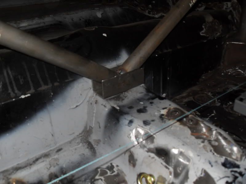

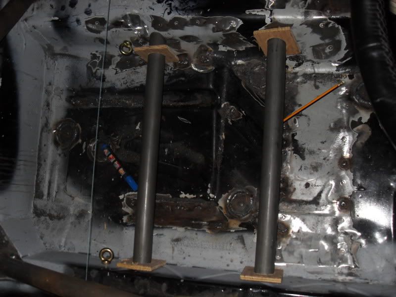

First off, the harness mount plates should be inside the tunnel, they're spreader plates and are designed so that in a crash they have to pull through the panel. Welded on top it's too easy for them to rip free in a heavy shunt. Best way is to drill 3 11.5mm holes, 1 for the thread and 2 for puddle welds on opposite corners of the plate, keeps the heat affected area down making the mount stronger.
Next, your tunnel brace, or hoop brace or whatever they've called it, where it meets the hoop it should be at the same height as the door bars and rear stays for the most effective triangulationand hence strength. Just a minor thing as you have it pretty close anyway :)

with regards to the spreader plates i have already welded them in wtf should i do with them now as there is no way they are coming out :cry:
with regards to the hoop brace i am a little unsure weather i am going to use that setup at the minute, i may end up putting an x in there but fear it maybe more weight thats wasted over strength, there is still an x to go in back half of the cage yet. i can adj the height they sit at because i have still go to weld a spreader plate on were it meets the tunnel.

I think I probably prefer the x idea myself, provides a bit more support if you put it on it's roof, but then the current setup gives a lot more support in the event of a heavy side impact. 6 and two 3's I guess. Although a horizontal tube touching the tunnel with a V going from the centre of that to the top corners of the hoop is a more modern option. or even a horizontal level with the door bars and rear stay cutting through a single diagonal. Loads of options to consider depending on what you feel suits you best :thumb:

also need to make a spreader plate for the hoop to tunnel brace awsel.

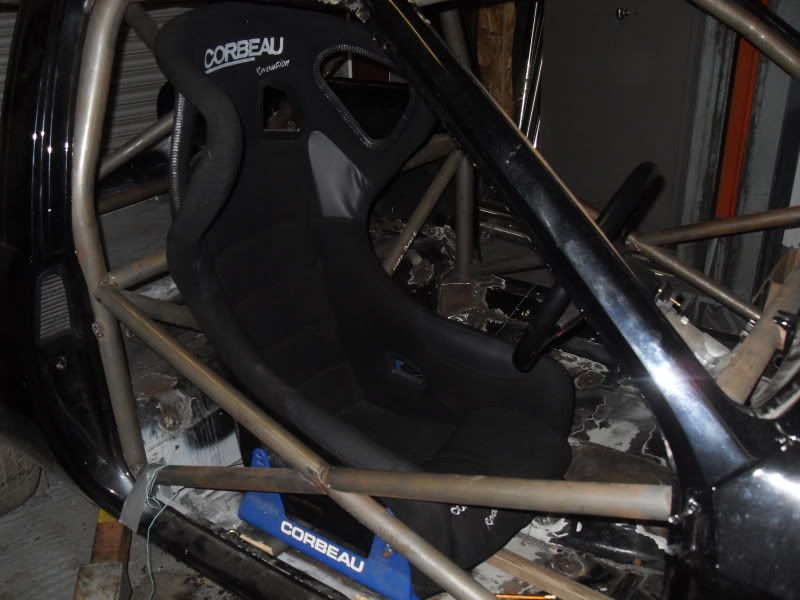

Went up to ricks a phew weeks ago and collected some seats, seat rails, holley lift pump, swirl pot, internal line and a few aero quip fittings

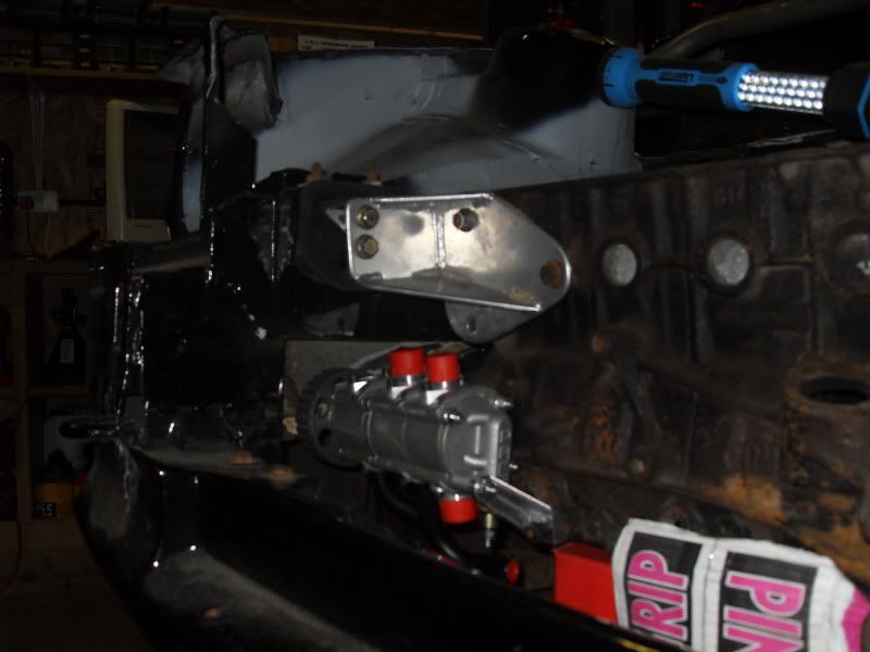

My solid engine mounts should be here some time this week so i can mock up for the dry sump becasue iirc i need to remove so chassis rail :cry:

Nice seats!

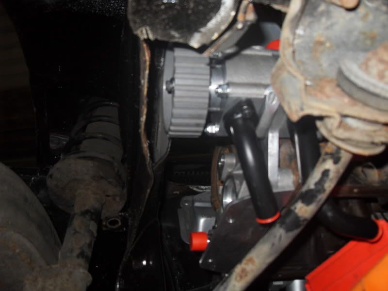

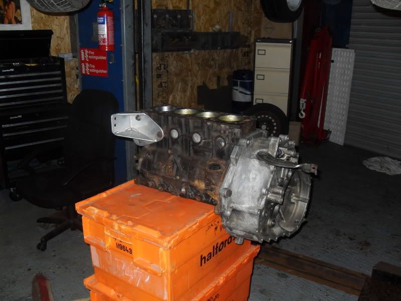

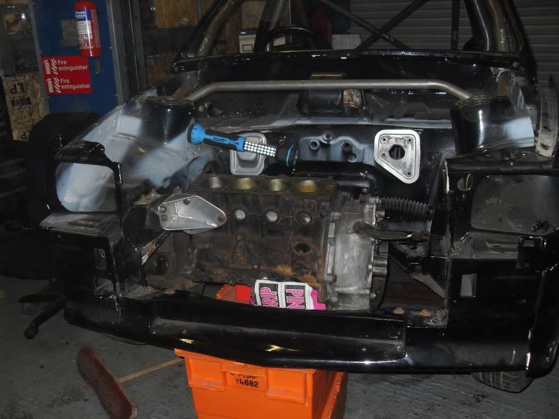

some mocking up for the dry sump tonight lol
http://i69.photobucket.com/albums/i7...ney/001-48.jpg
http://i69.photobucket.com/albums/i7...ney/004-41.jpg
http://i69.photobucket.com/albums/i7...ney/002-47.jpg
http://i69.photobucket.com/albums/i7...ney/005-37.jpg
http://i69.photobucket.com/albums/i7...ney/006-32.jpg
looking good mate. i need to get a dry sump kit orderd up asap as ive got mocking up to do to.
cheers mate, cant belive how much i had to cut out lol
you don't know what cutting out is mate! lol
lol i had a look last night and there aint much room with the seat all the way back mate
