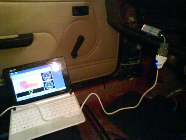

And for those interested, hooked up to the laptop!:
http://i71.photobucket.com/albums/i1...a/DSC00936.jpg
