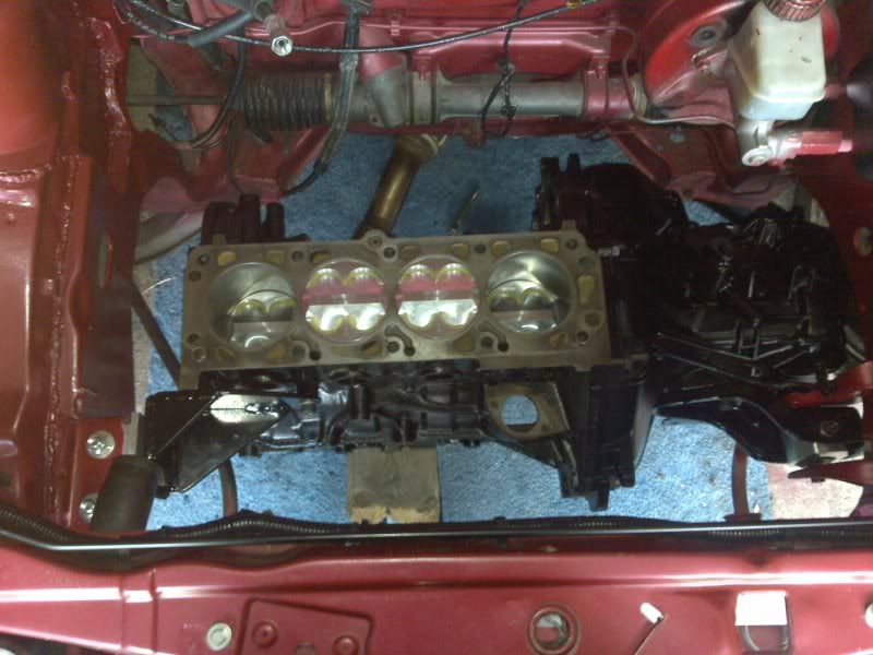

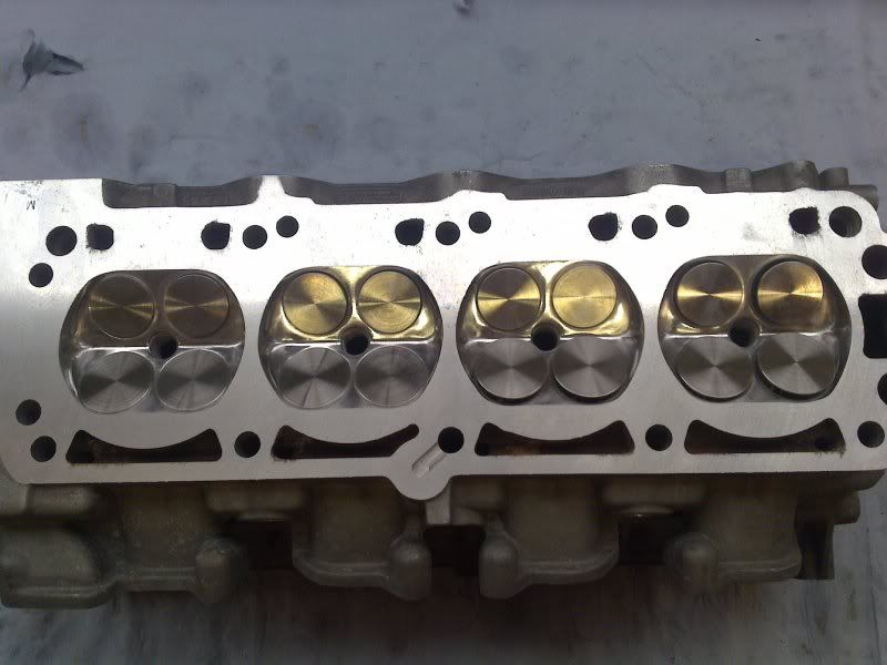

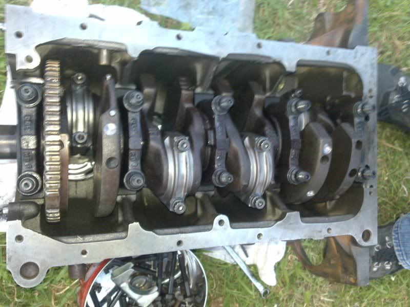

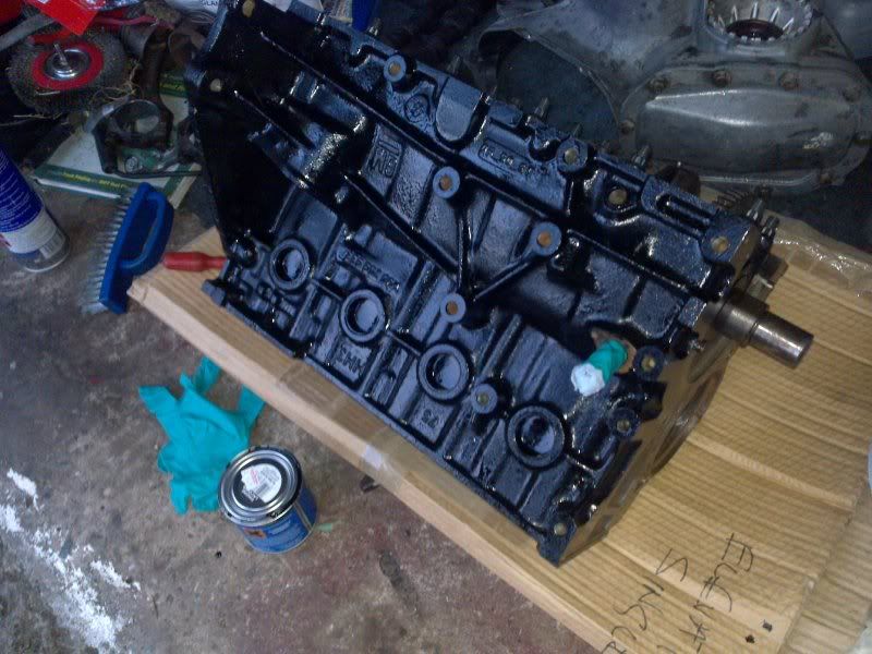

ok all sent some bits to the powder coaters 2day and apart from that im just waitin on my sbd order so i can finish the block and get it back in, and my head stud kit of steveboyslim. need some other bits but i am proper skint at the mo lol

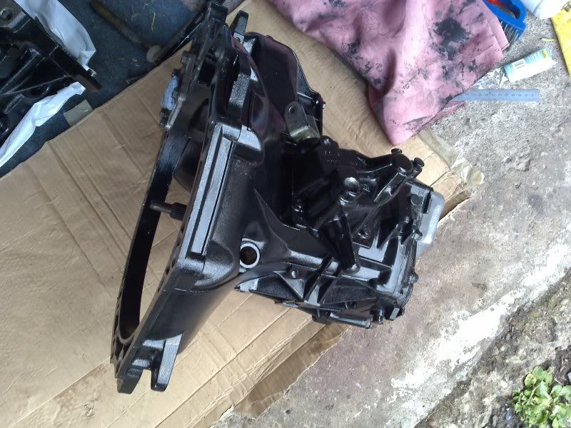

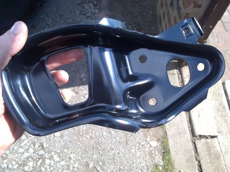

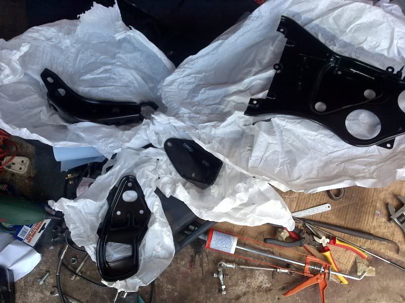

gearbox done, clutch on and some powder coated goodies :)
http://i7.photobucket.com/albums/y29...4062009380.jpg
http://i7.photobucket.com/albums/y29...4062009374.jpg
http://i7.photobucket.com/albums/y29...4062009368.jpg
http://i7.photobucket.com/albums/y29...4062009371.jpg
yummy powder coatings :D
those gubbins look great!
this has been quite a fast rebuild up to now.

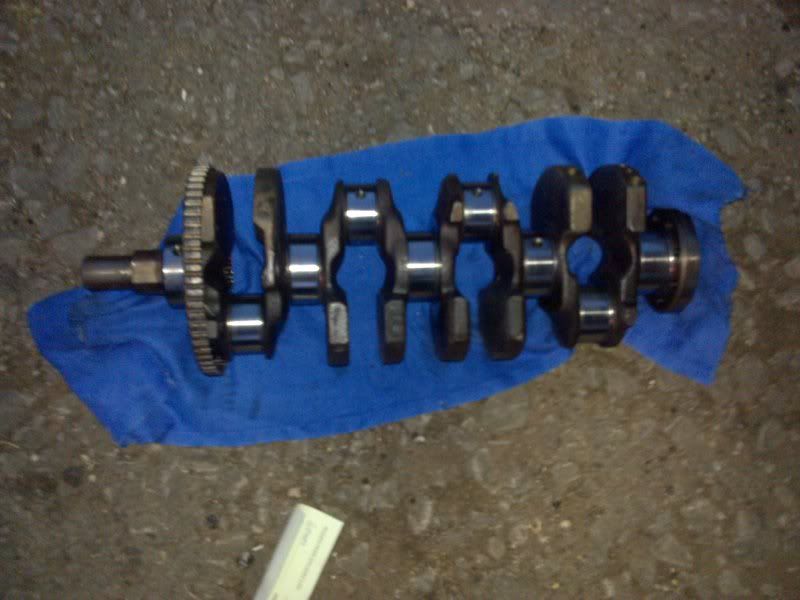

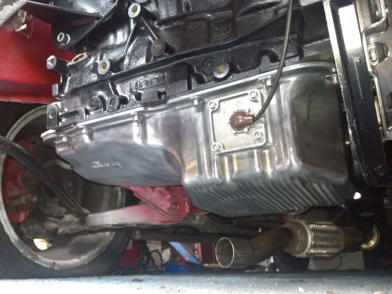

stuff from sbd arrived today, but all iv had chance to do is get the oil pump machined, fit the sbd oil gear, and fit the pump, hopefully gonna try and get the engine in 2morrow!
http://i7.photobucket.com/albums/y29...1072009390.jpg
http://i7.photobucket.com/albums/y29...1072009389.jpg
http://i7.photobucket.com/albums/y29...1072009386.jpg
Have fun building that lot up.

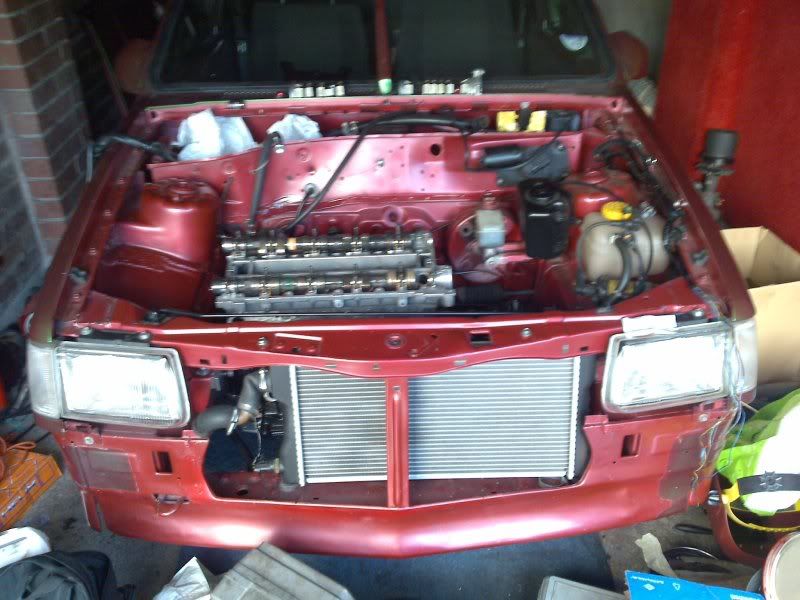

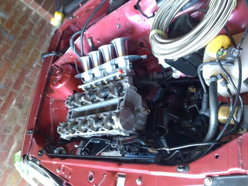

after ****ing around gettin the back gearbox mount redrilled, i finally got the engine back in properly, looks pretty good aswell me thinks;) ready know to start pipin and wirn back up!

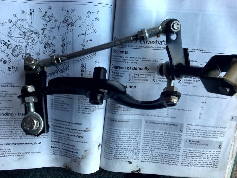

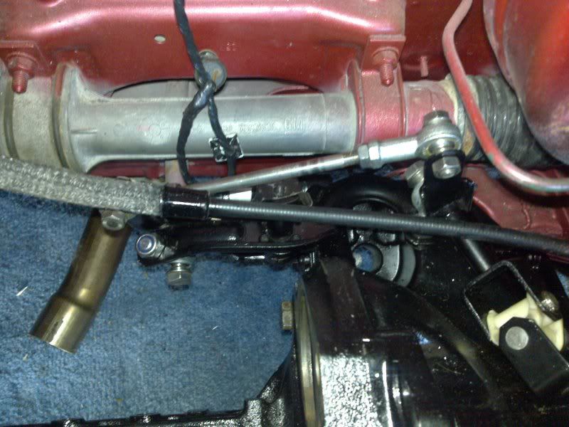

me finished rose jointed linkage
http://i7.photobucket.com/albums/y29...2072009402.jpg
on the car
http://i7.photobucket.com/albums/y29...3072009446.jpg
re drilled gearbox mount
http://i7.photobucket.com/albums/y29...3072009447.jpg

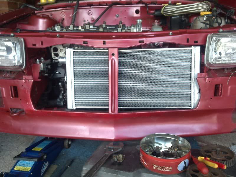

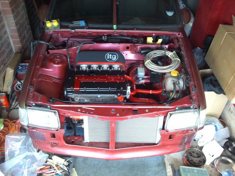

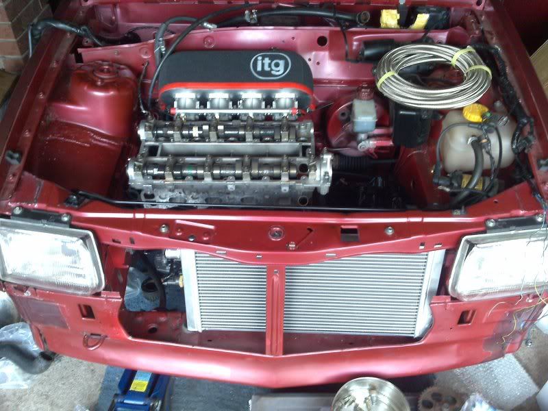

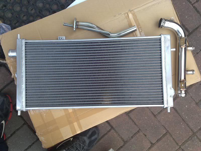

hi all, 2 day recieved my ally rad, s/s breather and water bar, very suprised on how good the quality of it all is considering the price, check it out,
http://i7.photobucket.com/albums/y29...8072009471.jpg
on the car
http://i7.photobucket.com/albums/y29...8072009473.jpg

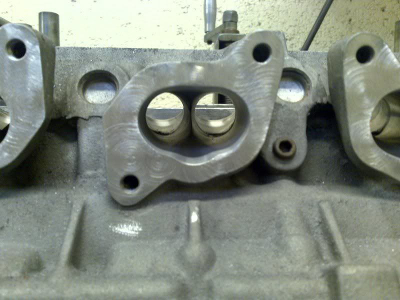

also started to build up my t/bs, then trial fitted them to the car,
http://i7.photobucket.com/albums/y29...8072009480.jpg
http://i7.photobucket.com/albums/y29...8072009484.jpg
http://i7.photobucket.com/albums/y29...8072009495.jpg
http://i7.photobucket.com/albums/y29...8072009497.jpg
everthing seems to fit really well, hoping to get my roose hoses, bailey header tank and brake bias box by the weekend and 2moz im going to start running the fuel lines, still tryin to decide if i wanna go all out track and gut the inside, or keep the gsi trim? opinions? cheers, sean

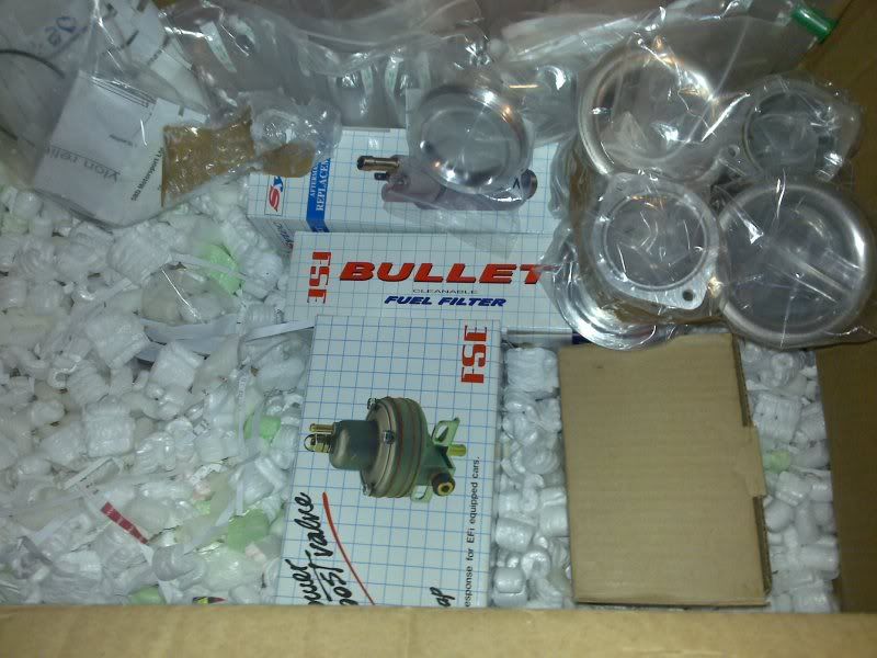

What injectors did you go for then?
'Small Peco injector, yellow 480 High flow 14 Ohms'
Those ones, just copied and pasted from sbd's website:)
What do they offer over Vaux creams? any idea?
Price (CBA to look on SBD) lol
These i think are the 'upgrade' from the creams
INJ-690
High flow injector, blue 690cc, 12.5 Ohms. Direct replacement in the standard system. Used on high specification, turbo & super-charged engines
Or take a look
http://www.sbdev.co.uk/Fuel_Injectio.../Injectors.htm

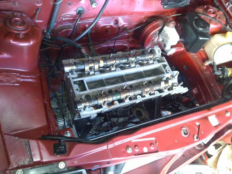

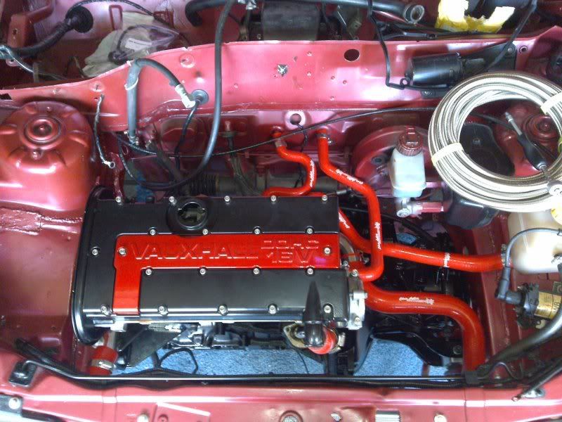

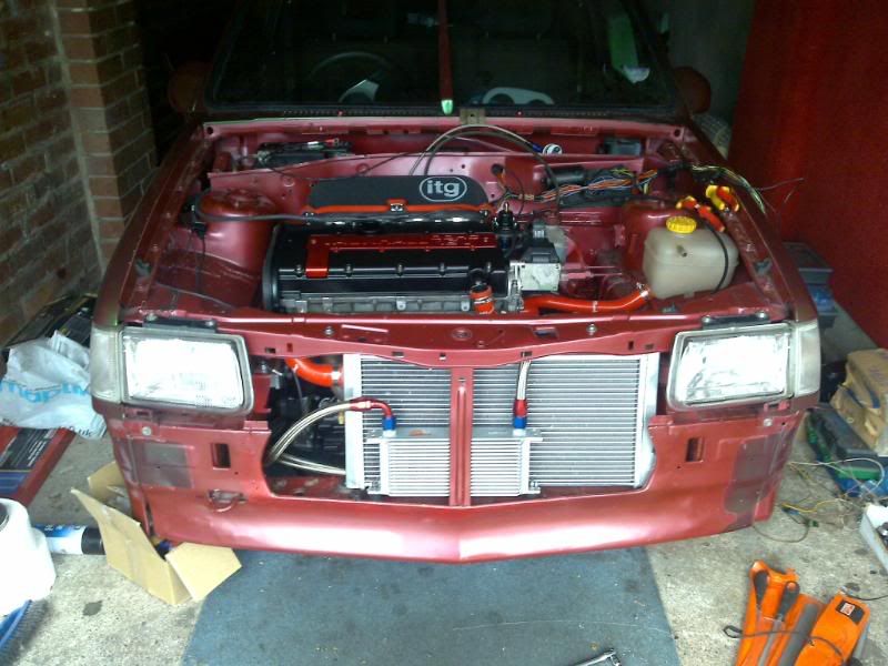

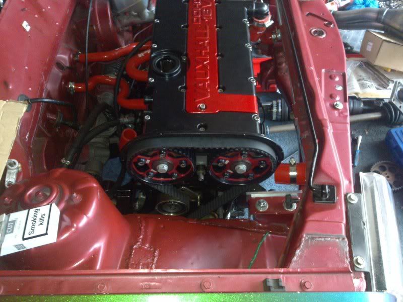

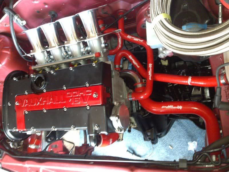

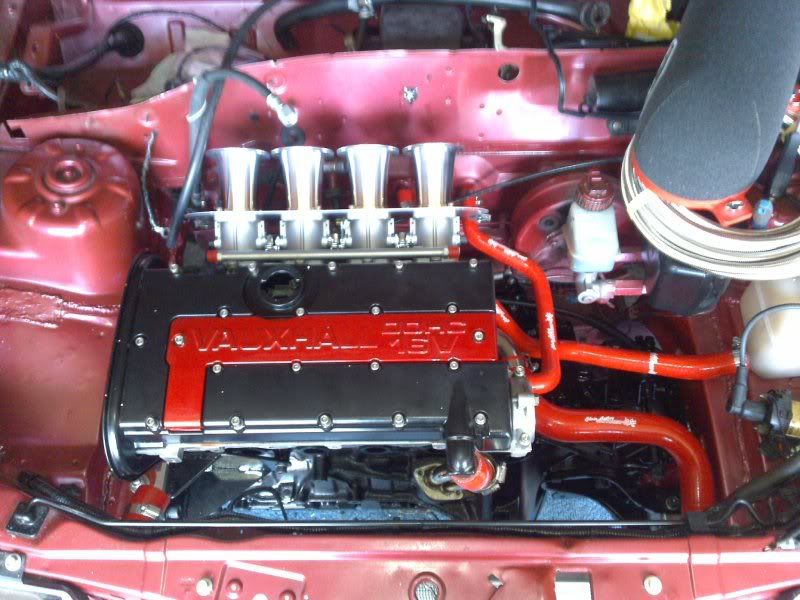

Okay, today got my roose hoses and s/s clips and piped them in, also dropped the rocker back on to stop the **** gettin over the cams. put starter motor back on 2 and gonna start lookin at doin the fuel lines 2moz. does any1 know whats the best plugs and leads to run, some1 told me just to use the orignal gm stuff but that cant be right? anyways heres some progress pics :)
http://i7.photobucket.com/albums/y29...0072009510.jpg
http://i7.photobucket.com/albums/y29...0072009511.jpg
http://i7.photobucket.com/albums/y29...0072009514.jpg
http://i7.photobucket.com/albums/y29...0072009519.jpg
yeah pal just stick with genune GM plugs and leads.
ngk bcr8es i think. or something like that anyway, what we use on all the hi-po xe's round here, and some beru leads or magnecor

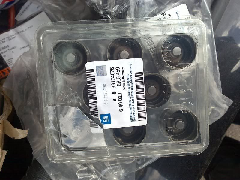

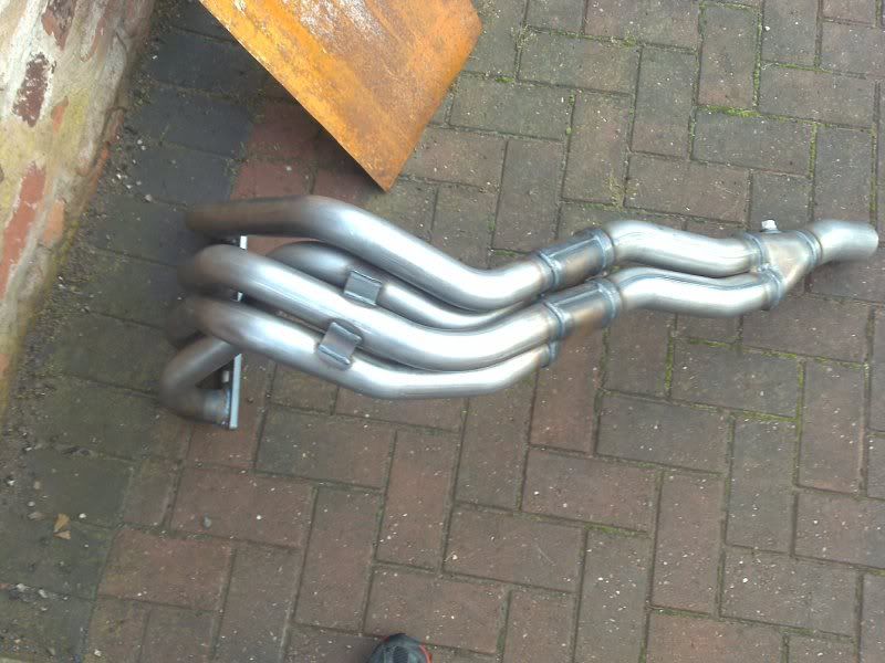

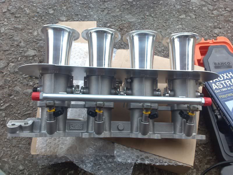

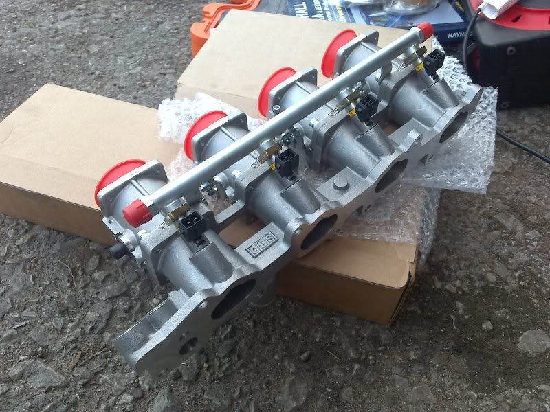

well this huge thing came 2day lol! as well as some beru leads and ngk plugs
http://i7.photobucket.com/albums/y29...1072009537.jpg
might have to go back tho as i think its dinged on the 2nd primary :(

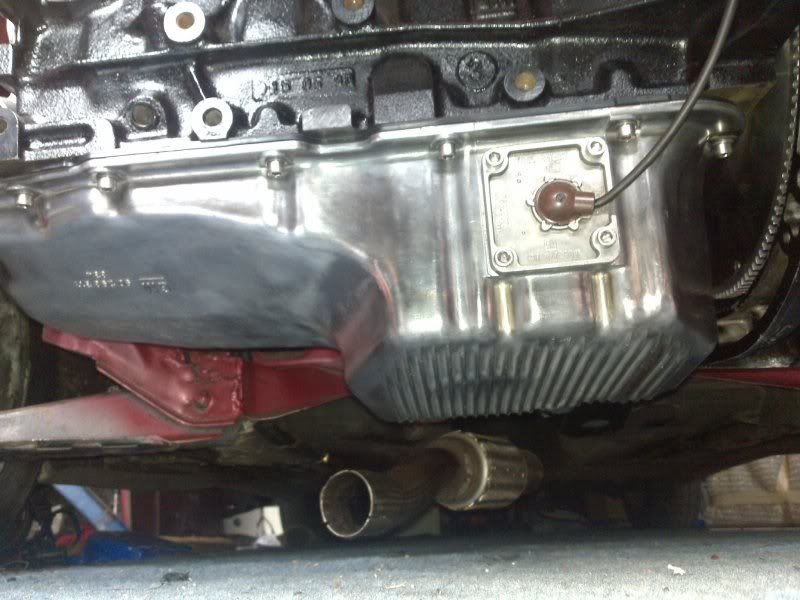

had to make a spacer at work so i could pin the rear cover to the l8 type gm sbd pump, the mount is thineer on the l8 type
http://i7.photobucket.com/albums/y29...6072009529.jpg
that engine is sweet bud nice work

Thats the same BTB i had, i sold it in the end, as unless your going to run 300bhp it's not really worth it IMO, i just use a SBD type A now.
looking good bud! some top performance parts gone into the engine:eek: would luv to see it shift once finished:) nice..
i know m8, but this is only the 'get engine in and running well' stage of the build, once its worn in and im happy, its coming back out to have the shell done, trust me it will be flawless :thumb:Quote:
not 100% acurate... the type C manifold is what is required for throttle bodies if you want to get any place close to SBD's estimated figures.. i had the type A and over standard it made 15bhp... the typce C is meant to release another 10bhp but 20 to 30 extra torque, and torque is whatya need :)Quote:
ill let ya know when i get the new exhaust mapped ill see what the difference is between them both
Sorry i guess i should of put more detail to what i meant, OK if your running a VERY Hi spec engine, then yes that manifold will work, but if it's a mile'd spec engine on TB's i cant see it building the pressure required to need it, thats what i was trying to say, although i think i could do with a better manifold now lol but no where near as big as the BTB one was.Quote:

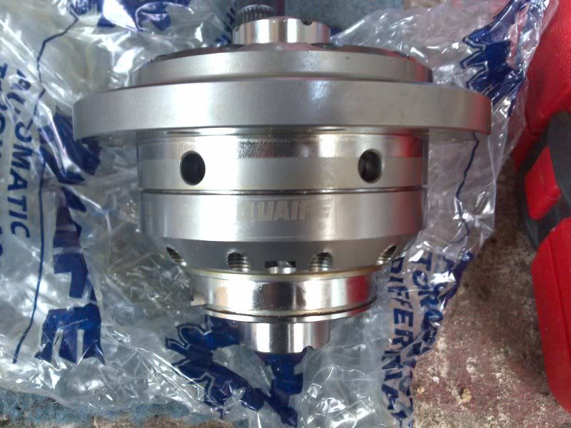

hi all, not alot been goin on really as iv been doin a shed load of overtime at work to fund me project! but this came 2day, me quaife diff, thanks steveboyslim
http://i7.photobucket.com/albums/y29...5082009591.jpg
any ideas on how to get the speedo drive of the old diff, and what torque to do up the diff gear bolts? cheers

any luck fitting the dif?
yeah m8 diff is fitted, quite easy actually as i made up a tool that fit the castle pieces on the diff housing, welded a 1/2" socket to it and wound it in no probs

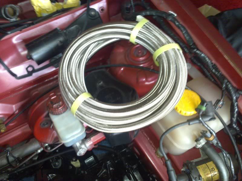

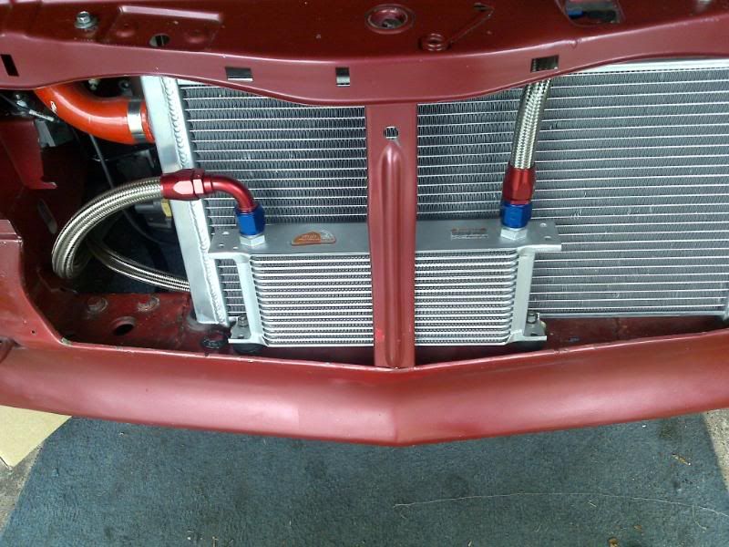

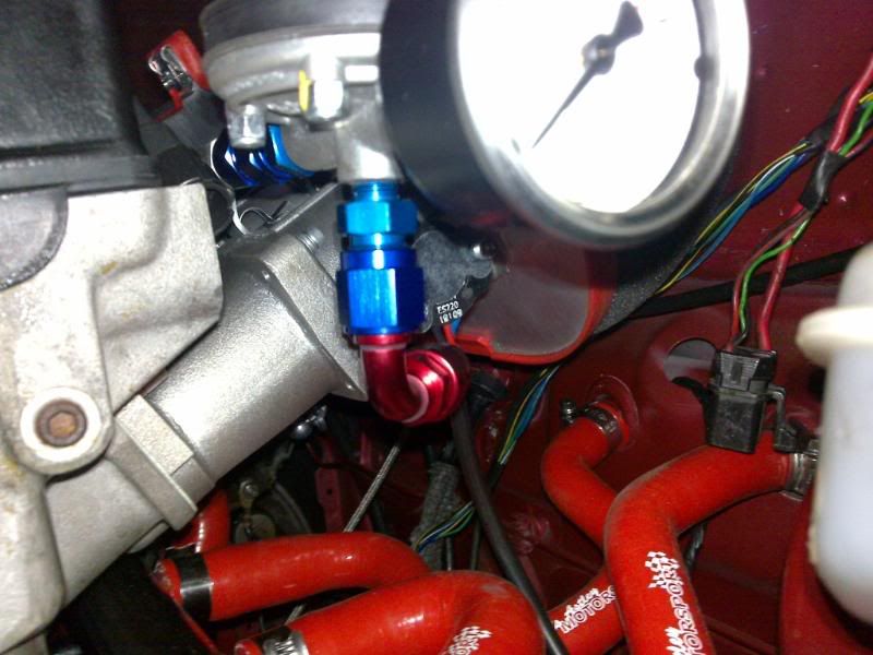

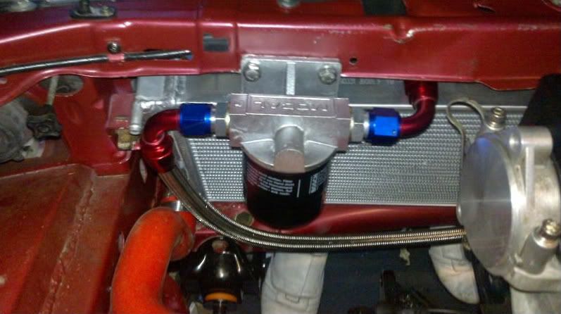

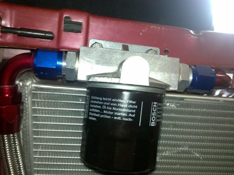

ok beens bust doin the fuel/oil lines and sortin out my hubs etc. heres some pics:
http://i7.photobucket.com/albums/y29...4092009636.jpg
http://i7.photobucket.com/albums/y29...4092009639.jpg
http://i7.photobucket.com/albums/y29...4092009640.jpg
http://i7.photobucket.com/albums/y29...3092009627.jpg
http://i7.photobucket.com/albums/y29...2092009617.jpg
http://i7.photobucket.com/albums/y29...2092009618.jpg
http://i7.photobucket.com/albums/y29...2092009611.jpg
http://i7.photobucket.com/albums/y29...2092009620.jpg
http://i7.photobucket.com/albums/y29...4092009635.jpg

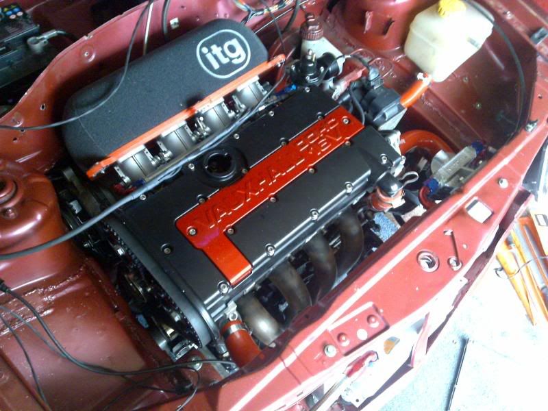

got it fired up yesterday all seems good!
