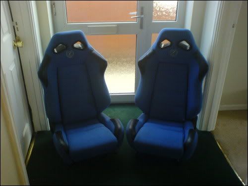

Then thought about what seats i wanted then i sat in these and fell in love with them, wasnt happy there wernt that light but they were so comfortable i had to get them

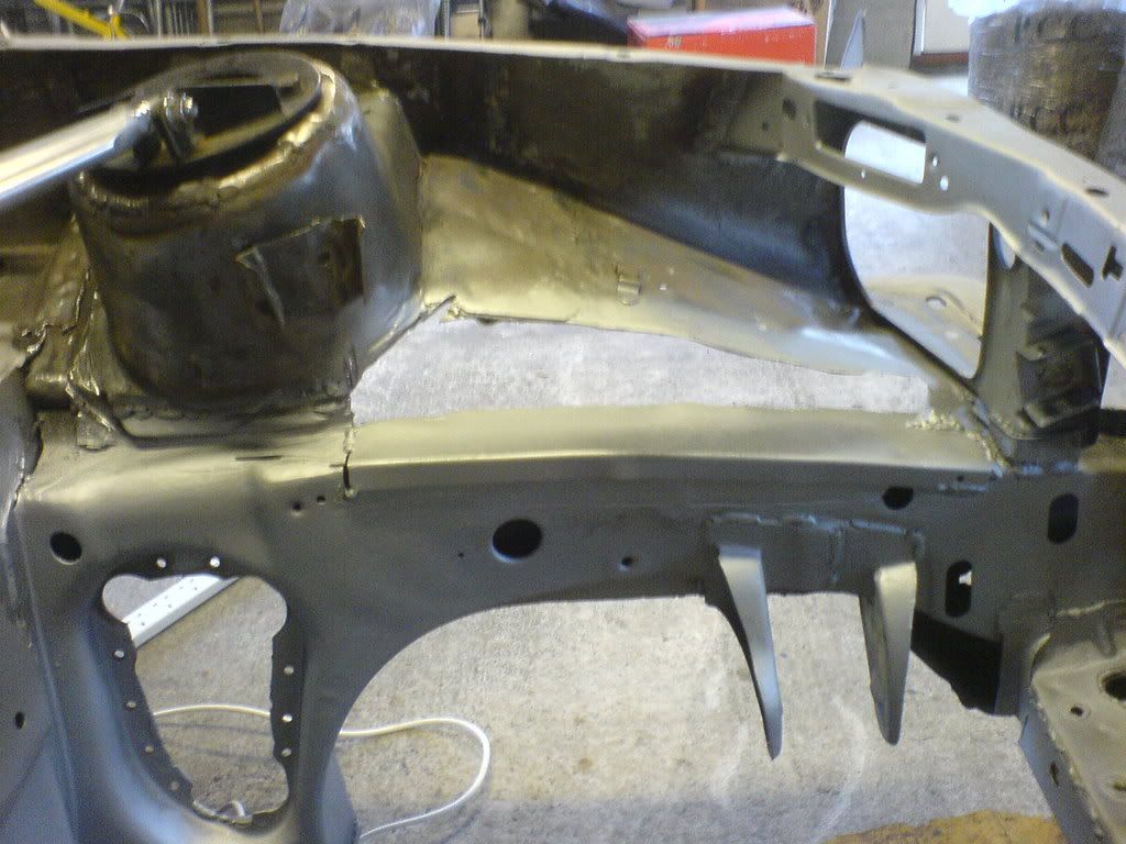

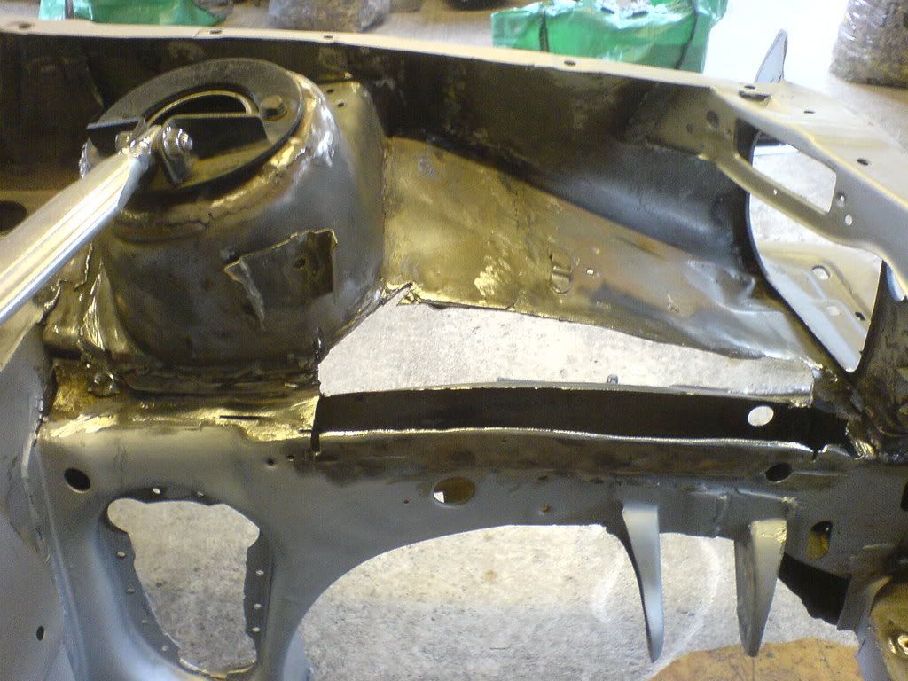

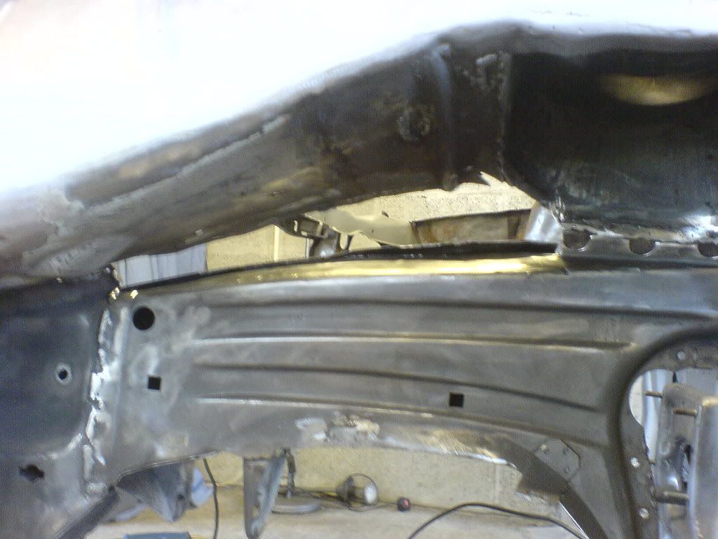

then i thought about the strength more and noticed the inner wings were rubish so cut them out
http://i241.photobucket.com/albums/f...section004.jpg
http://i241.photobucket.com/albums/f...section002.jpg

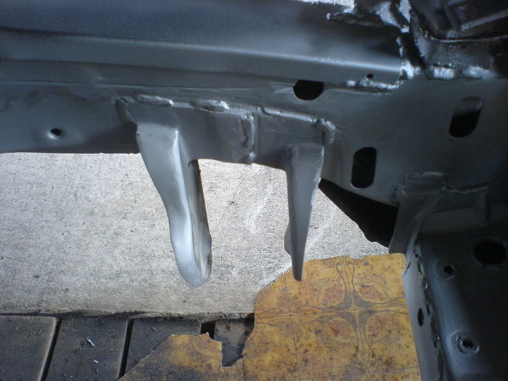

And put box section ontop of them
http://i241.photobucket.com/albums/f...section003.jpg

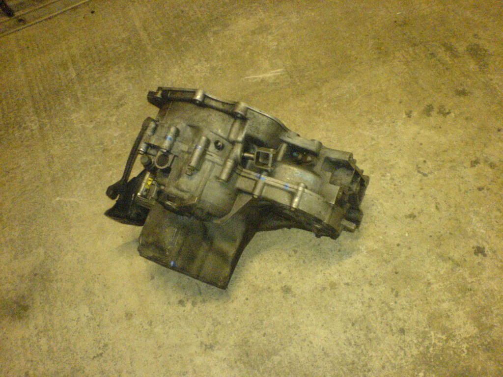

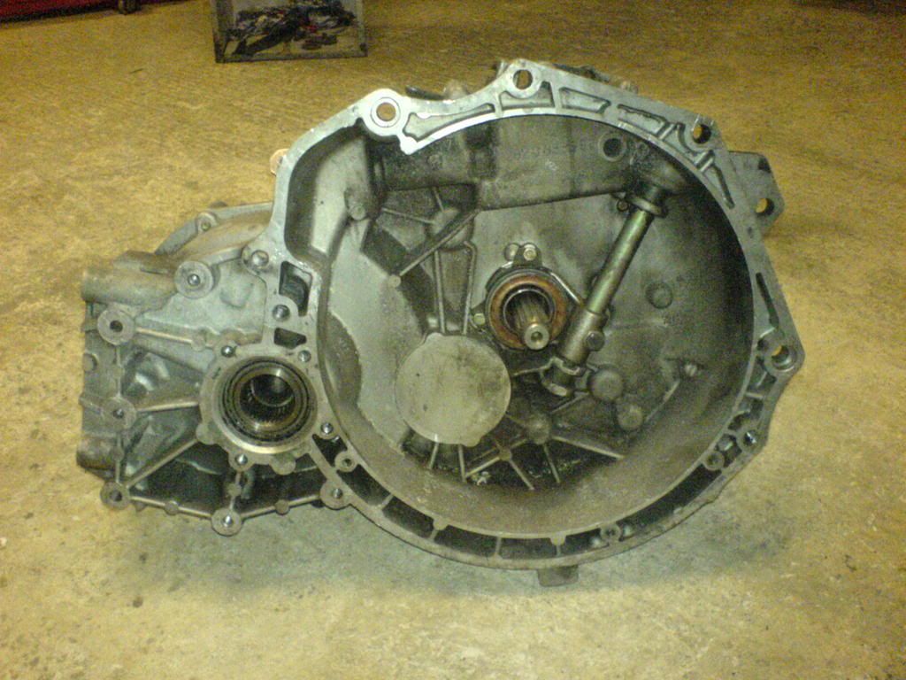

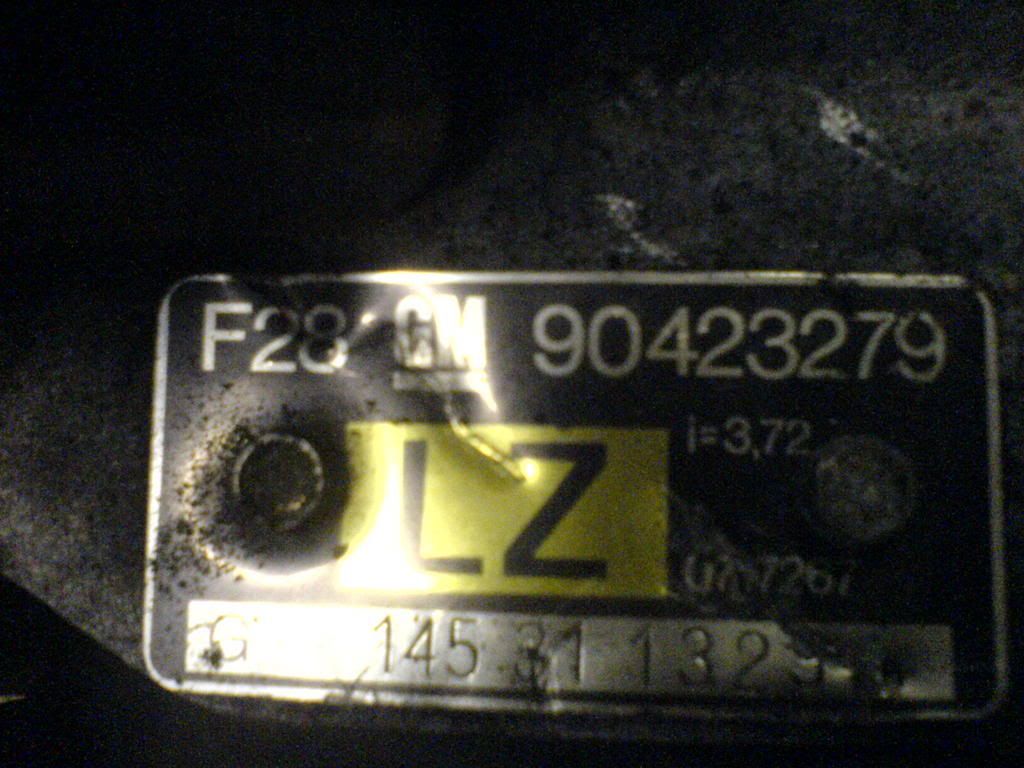

After being in my mates 6 speed astra turbo i really liked the feel of a 6 speed. So went a bought a recondtion one from VTS
http://i241.photobucket.com/albums/f...tr/bits026.jpg
http://i241.photobucket.com/albums/f...tr/bits028.jpg
http://i241.photobucket.com/albums/f...tr/bits030.jpg

oh and awesome work by the way. but im guessing that exhaust is gonna be running through the car? its going to be a mission to get it down past the f28 and under the car!
