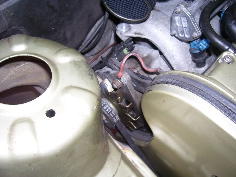

Anyone got any ideas on the inlet bellows? i'm a bit worried about using a silicone hose in case it narrows a bit too much on full throttle.
as you can see, not much room!
http://i97.photobucket.com/albums/l2...n/100_1341.jpg
as will f said when we fitted a dis engine to my b reg shell i found the engine sat a little to high only slightly and with the mount i have used my cam belt cover is almost touching the the actually metal chassis mount, ill get pics up another nova k reg 2 in fact that i have used dis engines these seemed to have a bit more space and we used the same mounts etc as my b reg shell
any luck with the engine mount issue does your bonnet shut now?
nah, not had chance to touch it since sat, you got any pics of how it fitted in your shell?
odd my diss pack xe fits fine using the top hole,,,trying to find you a picture
