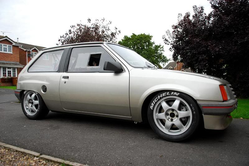

OK then, so today I achieved what I have been working towards for along time now, that it's all worked out fine, apart from uncovering some more problems that I will need to sort out.
Some daylight pics of my car to show the colour match and 'un flatted' finish on the wings and bonnet...

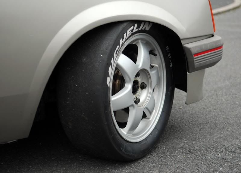

As you can see - I have been playing with the ride height just to see what my options are available to me, and I'm pleased to say that even at the height below, I get no scrubbing problems on either lock, or when just driving (albeit, only to my road and back, due to being full race slicks lol)
http://i136.photobucket.com/albums/q...ure/nc1095.jpg
So in a straight line, you can see that the lipless round arches are a godsend when it comes to clearence, as they'd usually have hit
http://i136.photobucket.com/albums/q...ure/nc1097.jpg
Still have circa 8mm outwardly clearence, which could enable me to up my 5mm spacer, to 7mm, to aid spring clearence

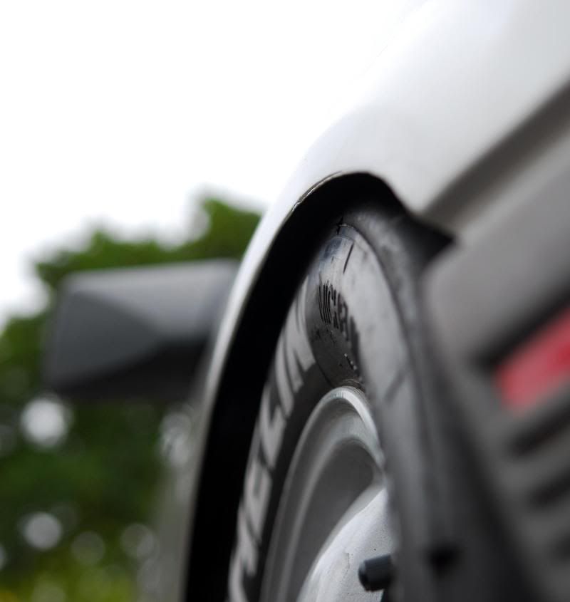

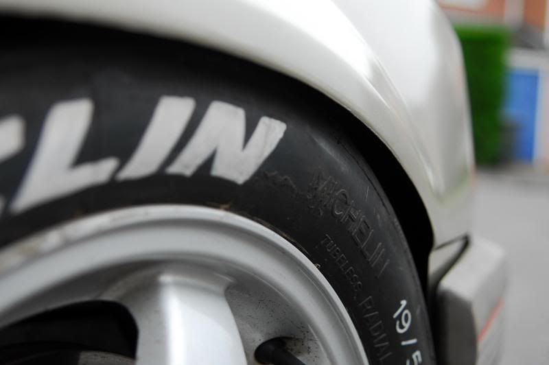

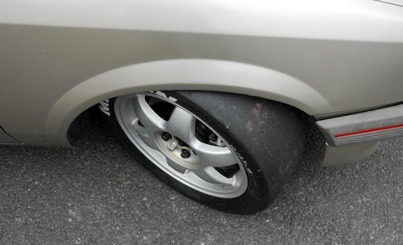

So... my right lock isn't a problem, it only stops night of "full lock" due to the inside of the rear part of the tyre hitting the inner arch, or the passenger tyre hitting the end case of the gearbox, neither of which is a problem
http://i136.photobucket.com/albums/q...ure/nc1100.jpg
As you can see, I could afford to drop it even more should I want to, but I probably wont... or might lol
http://i136.photobucket.com/albums/q...ure/nc1101.jpg
Left lock is the same as it always has been, just stops when the front leading inside edge hits the inner wing, which is also fine

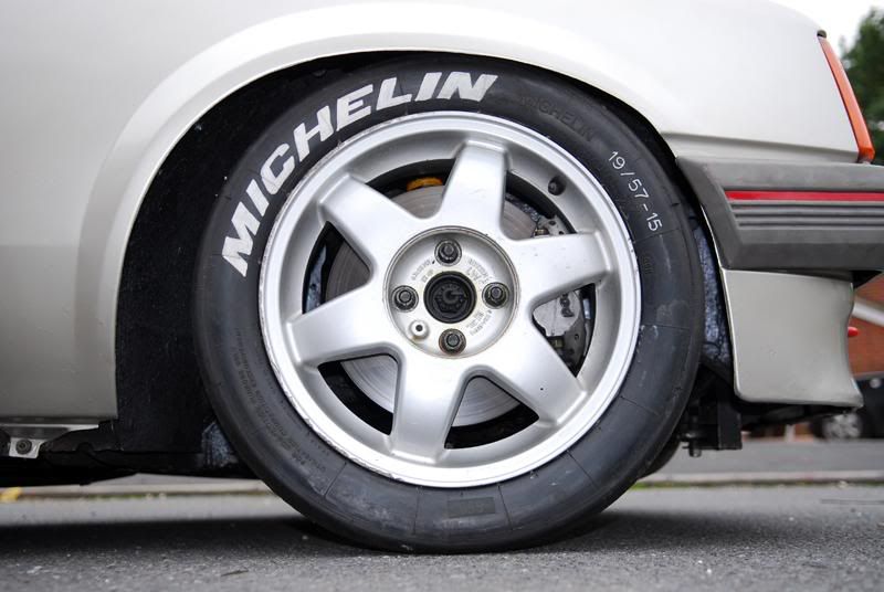

Increased the castor again, now this is the absolute maximum you can achieve with running an XE, with the oil filter in the standard location, so without going to a remote filter, this will do for now lol
http://i136.photobucket.com/albums/q...ure/nc1105.jpg

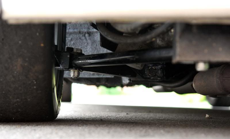

TCAs are now rising towards the outside of the car, as opposed to going down, but the tiebars would now plunge down towards the front of the car, so I will remove my lowering block to bring them back level, should I decide to stay at this height
http://i136.photobucket.com/albums/q...ure/nc1104.jpg
And my new fave pic of the car...
http://i136.photobucket.com/albums/q...ure/nc1103.jpg
OMFG, that looks awesome. Theres something about it that looks cool as fook :cool:
I spose the 5dr wings are ok, in that pic anyway :p
