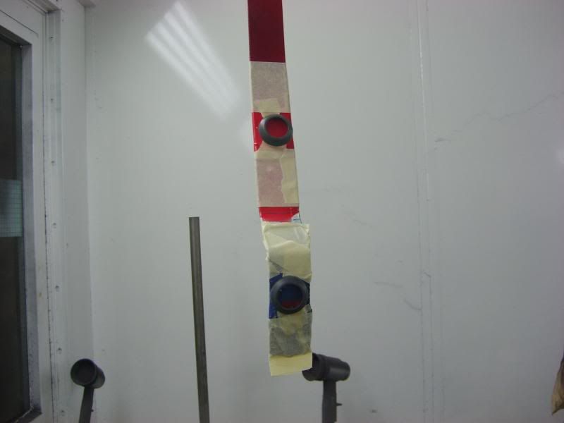

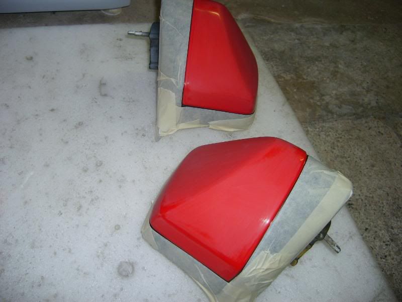

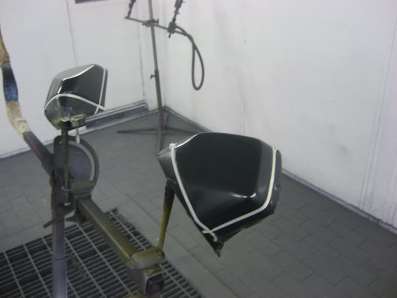

I got them all rubbed and masked off the majority for the following day at work where they were placed on a stand and the edges were fine lined out for a perfect edge........
http://i84.photobucket.com/albums/k2...g?t=1253295892
Shortly after that picture was taken we had these.......
http://i84.photobucket.com/albums/k2...g?t=1253295974

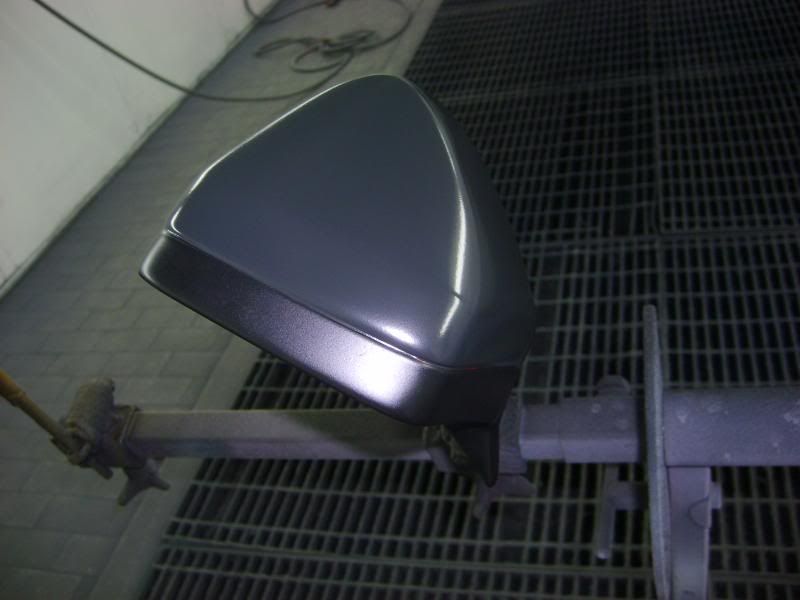

I could have painted them body colour but I wanted to stay with the sr's original colour scheme of grey colour wing mirror covers etc. Next pic shows them demasked and ready for fitment!......
http://i84.photobucket.com/albums/k2...g?t=1253296066
http://i84.photobucket.com/albums/k2...g?t=1253296127

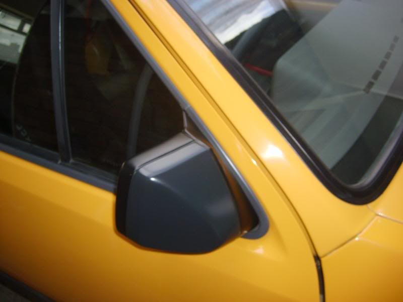

Once I got home I thought Id try one on to see how it looked. Im not going to fit them permanantly just yet as I want to wait until the cars all finished. But here's how it looked........
http://i84.photobucket.com/albums/k2...g?t=1253296341
http://i84.photobucket.com/albums/k2...g?t=1253296406
Im pleased with how the mirror looks and with the colour. I'll be using the same shade on the door handles/lock surrounds shortly as well. On another note Id like to keep this car for some years to come so when I got offered the following at a good price I thought they would be a good investment.......

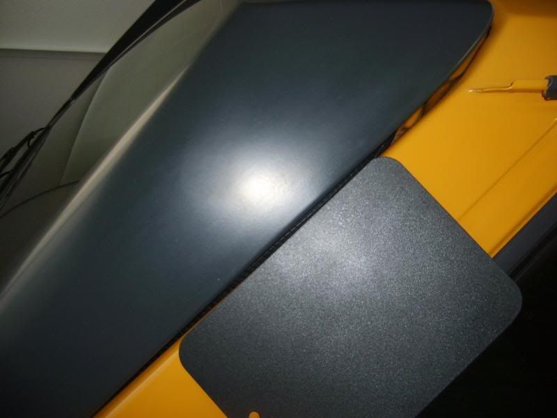

I think the grey looks too metalic.or is it the camera bringing it out?
The grey on the mirror caps looks too glossy,maybe a drop of matting ajent?
(could be the camera)
The colours are all a satin finish, But some have a little more texture than others and thats what your seeing. The mirrors are'nt at all glossy its just down to my camera picking up the smooth finish. All colour chips and colours shown appear totally different in the flesh to be honest! Im sure as a painter you'll know exactly what I mean. ;)Quote:

Stumpy mirrors look good, wasnt sure if they were going to suit it tbh, but they do look good in grey.

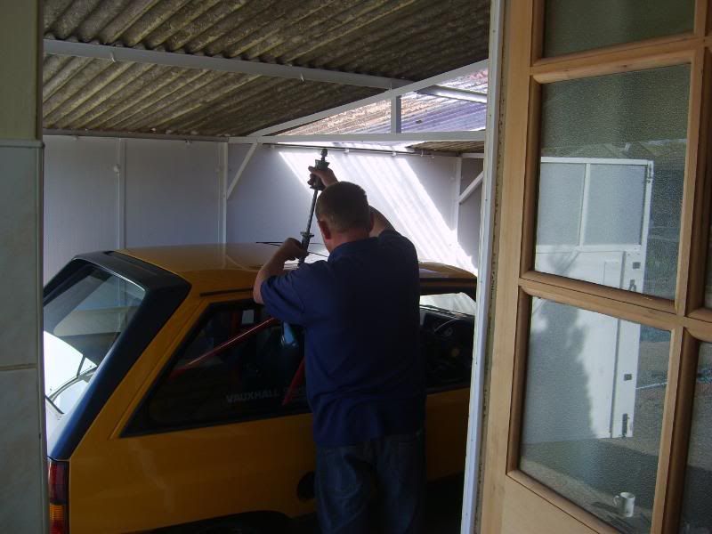

Ive also been waiting for my dent guy to have the time to pay me a visit also. This saturday he turned up at around 9.45am and didnt get away until after 5pm!! The result is absolutely stunning though! One perfectly straight nova. He slowly went round the car lifting all imperfections on the bodywork including levelling up one or two old repairs that werent quite perfect,The main panel was the roof that took almost 3 hours! As there was three identical dents down both sides of the roof. Ive had him doing my cars for years now and he never fails to impress. Having all imperfections lifted means no use of filler at all which obviously will save me hours of work when it comes to painting the shell. Some pics below........
http://i84.photobucket.com/albums/k2...urbowip056.jpg
http://i84.photobucket.com/albums/k2...urbowip057.jpg
http://i84.photobucket.com/albums/k2...urbowip055.jpg

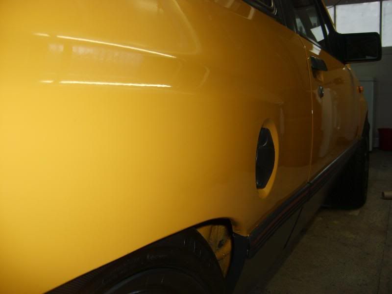

Some after shots showing super straight panels!.........
http://i84.photobucket.com/albums/k2...urbowip060.jpg
http://i84.photobucket.com/albums/k2...urbowip059.jpg
http://i84.photobucket.com/albums/k2...urbowip062.jpg
http://i84.photobucket.com/albums/k2...urbowip061.jpg

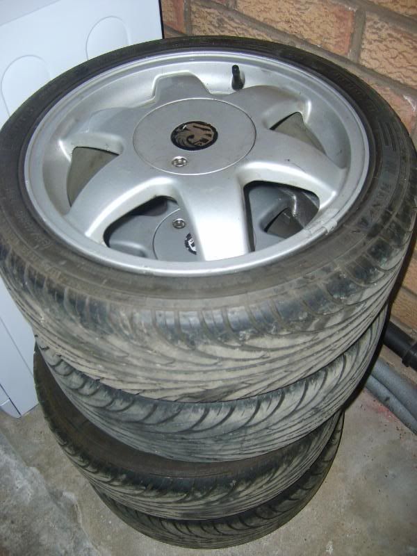

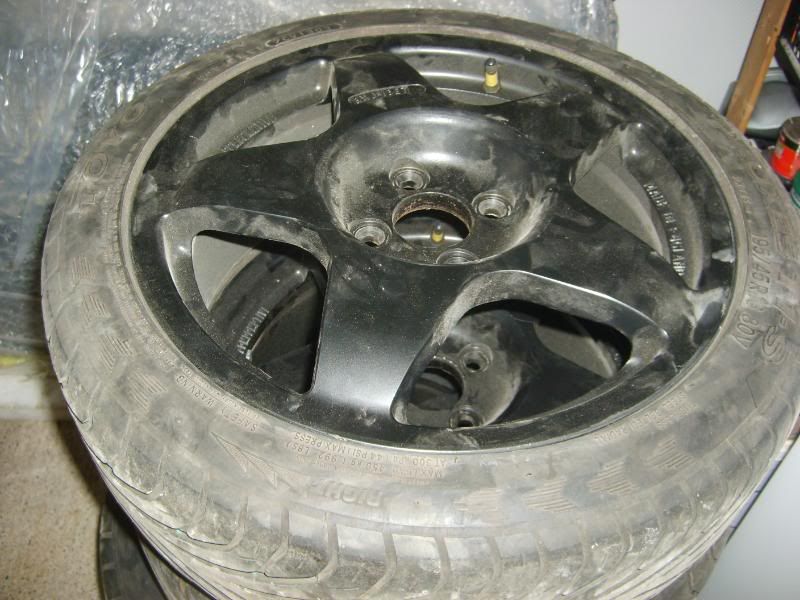

Ive also been looking at wheel choices as I think allesios as great as they are may just look a little too new for the age/shape of the mk1 nova. Just my opinion anyhow! As some will have seen I was on the lookout for some compomotive mo flat spoke wheels. Simply because they are uber rare and look great. However after a few weeks of no joy I was getting rather impatient! And after seeing the following for sale I bought them.......
http://i84.photobucket.com/albums/k2...urbowip064.jpg
A good condition set of cesaro's. Nothing groundbreaking I know but painted up in grey is my intention and I think they'll look well. Nice and simple etc.

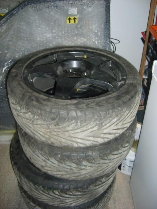

But then to my horror a few days later what should pop up for sale?.... Some bloody mo's in 15 and 16". Typical None whatsoever available then two sets and a size choice at the same time! Anyhow after some fund fettling I went on a trip to oldham to meet Rick Draper for these below.
One set of 16" flat spoke mo wheels with excellent toyo rubber.........
http://i84.photobucket.com/albums/k2...urbowip065.jpg
http://i84.photobucket.com/albums/k2...g?t=1254337204
As Rick has'nt long since had them powdercoated there in tip top condition just a little dusty. Once Ive got a little free time Im going to get the tyres off them and get them prepared for painting. The same grey Ive recently settled on for the other parts will be used followed by a satin finish lacqeur should see the looking cracking. Plus as an added bonus the comps have plenty of room behind them for big brakes so no spacers should be needed to clear the Reyland front brakes. Thats it for now guys as nova funds are empty for a little while now! Be back with more updates soon.

What you can see in the pics scott is the glue gun method. This works by a small plastic clip being glued to the panel over the bent area. Then a slidehammer type tool that clips to the above being used to pull the panel surface outwards removing the dent. Its an excellent method which works well in areas the guys cant get into like box sections or areas behind impact bars etc. He used this method on my roof to save stripping out the headlining. ;)Quote:
Dan/Keith/Benn...... cheers guys!
Nick.
Wow top stuff Nick! Wheels will suit well i reckon. What's the actual colour you've decided on for the lower half/wheels?
Ah i see! the only way i have seen it done is before prep/paint with similar method but they weld a small rivet type thing to the panels etc.
Cheers John! Its finished up as a custom mix, I found a colour near as damn it to the vauxhall blue/grey colour then tinted it slightly to finish it.Quote:
Originally Posted by John H
Scott, Yeh its almost the same method as the repair method "Pin Pulling" Only the dent chaps similar method doesnt mark the paintwork at all.
