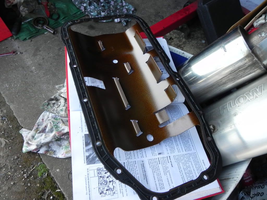

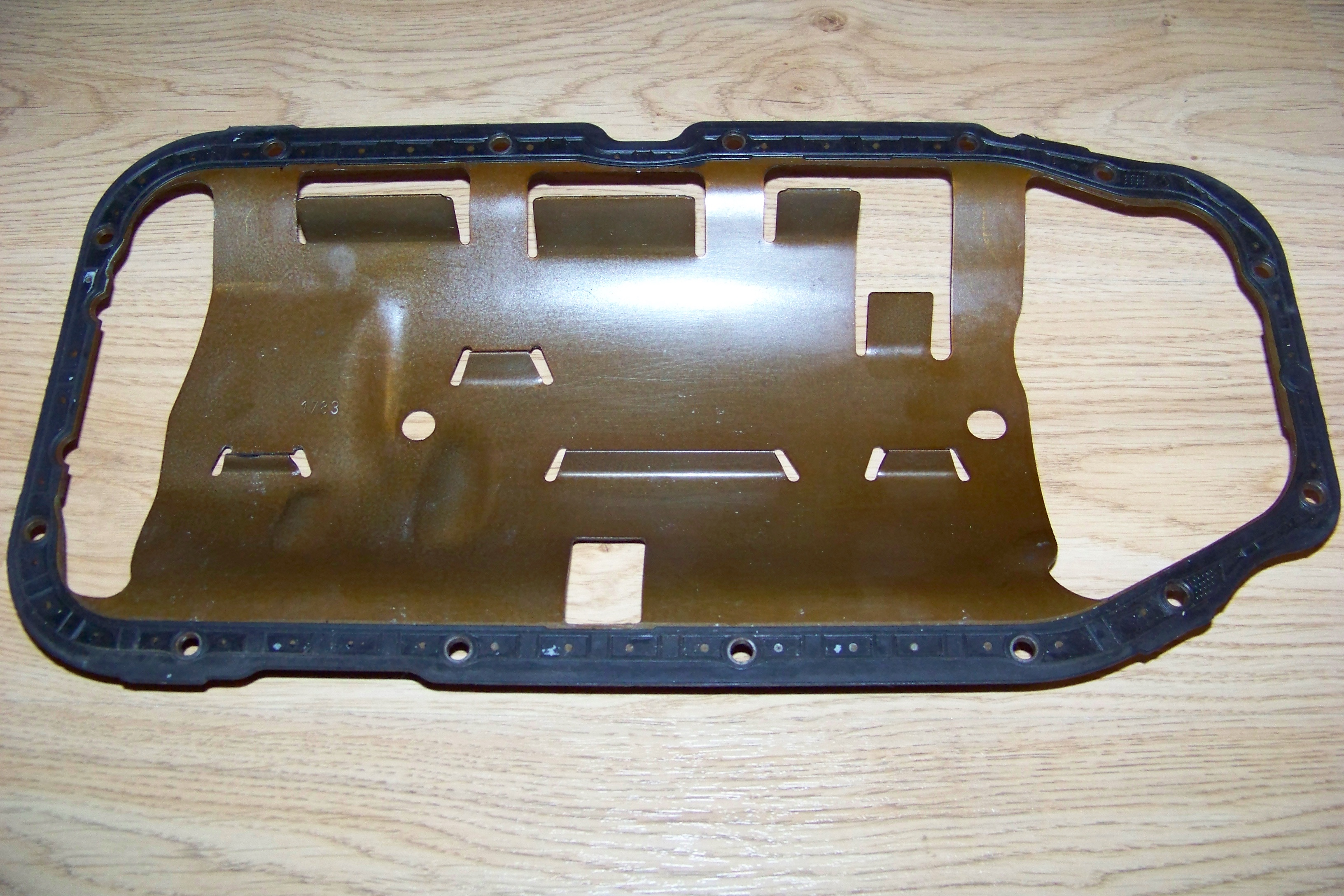

Where did you get your baffle from?
The turbo looked a mess so it had to get done, once you paint you can't stop really lol
my baffle was from autovaux in the bottem end gasket kit.

is yours and early or late engine?
true true, I did see a AutoVaux ad in TV which showed the baffle. Will have a look see. Did you get iridium plugs or normal ones? No idea if it's late or early tbh. What am I looking out for to determin if it's the late or early engine?
i got normal plugs.
square tooth pulleys are late and round tooth pulleys are early. most easiest way to determine. also the late has 2 guide pulleys near enough next to each other where as the early has one guide pulley.
Cheers pal, I'll go have a look in my free time. I found the AutoVaux ad in TV. Elring baffle £19.95 (without screws) I'm assuming the stainless steel sump kit screws and washers I got will work with it (am I right in thinking that one screw fixes the sump gaskest and baffle at the same time?)

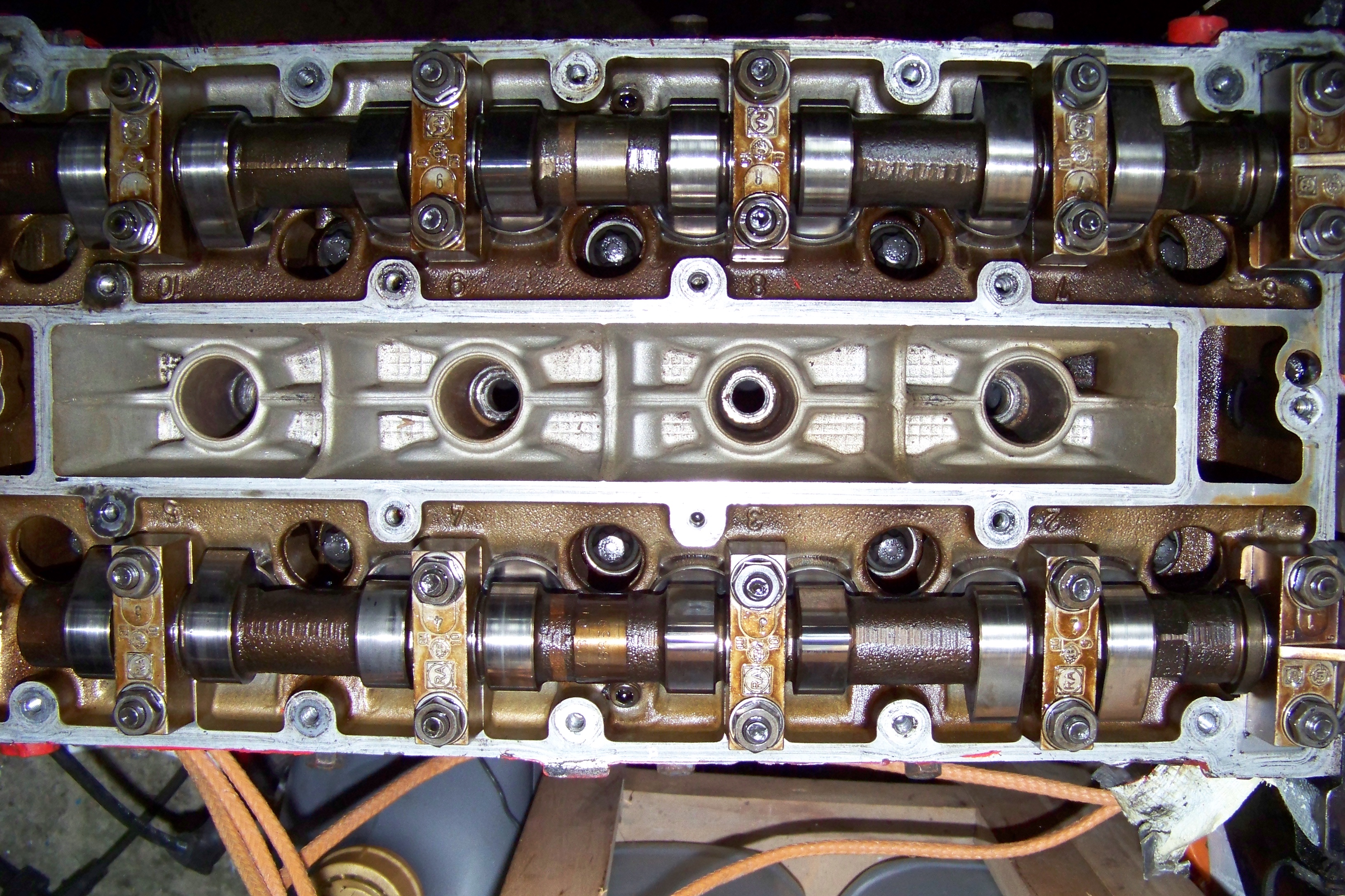

the gasket is the baffle, you need to use m6 x 20mm bolts with this gasket/baffle and m6 x 25 for the 2 end ones.
I thought the baffle went in first then the gasket. I'm pretty sure it was either Vaux or one of the motorfactors that explained that to me. I purchased a stainless steels screw sump kit off ebay.
http://img19.imageshack.us/img19/6491/1002015w.jpg

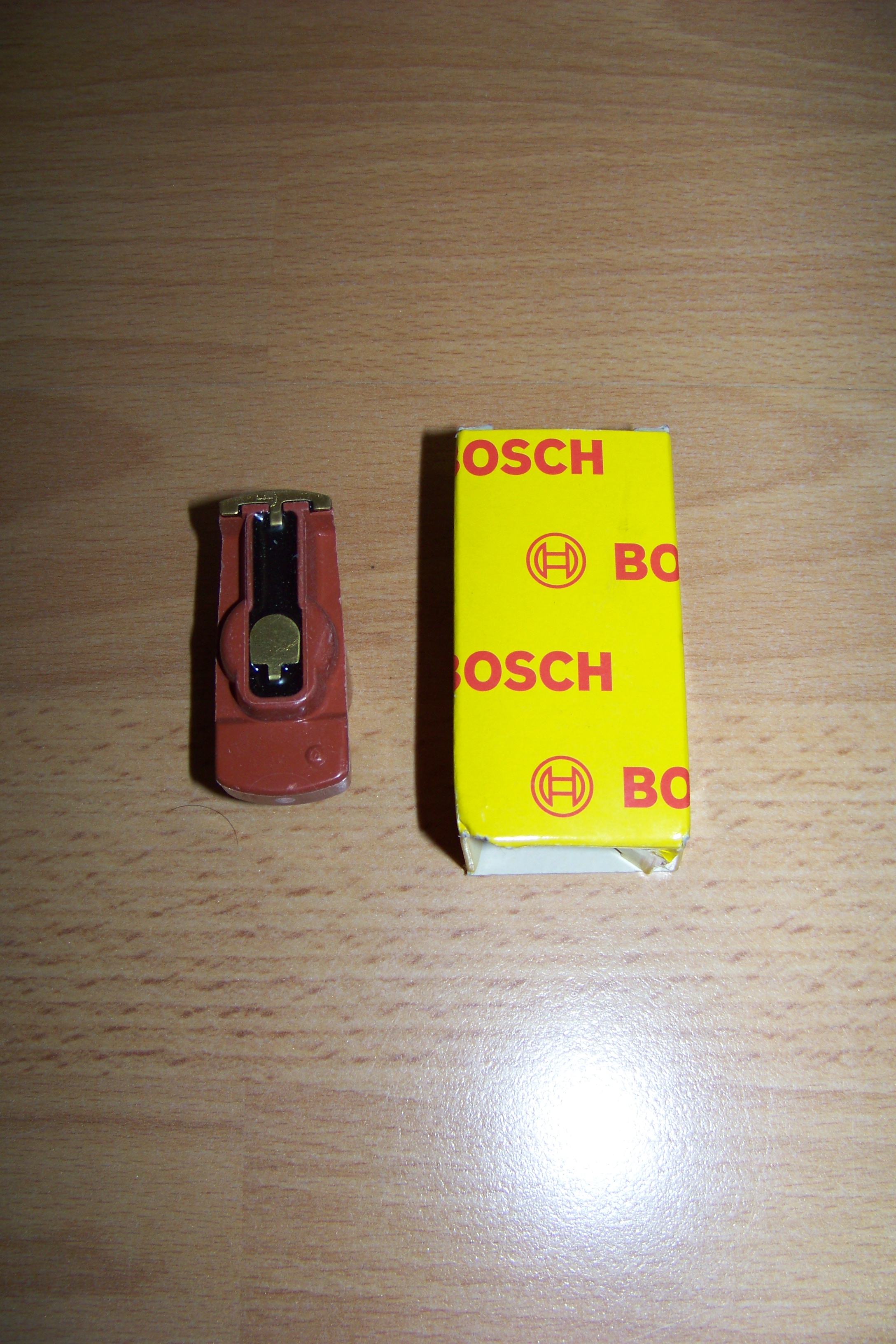

Need to return the rotor arm as it is the wrong one :roll:
http://i193.photobucket.com/albums/z...8/DSCN2504.jpg
this is my one, the gasket is part of the baffle. make sure you bend the correct tab out of the way before fitting it though.
So you saying that I don't need to fit a gasket? just the baffle with its own gasket?
If your fitting the gasket in the pic above yes. The let/xe us a metal one in between 2 cork gaskets which always leak, the rubber is the gasket with the baffle built into it so no need for anything else. You will need slightly shorter bolts so they dont bottom out.
Ahhh ok gotcha, must've misunderstood the chap at Vauxhall. So all I need is to buy the sump baffle with the rubber gasket and the correct bolts.

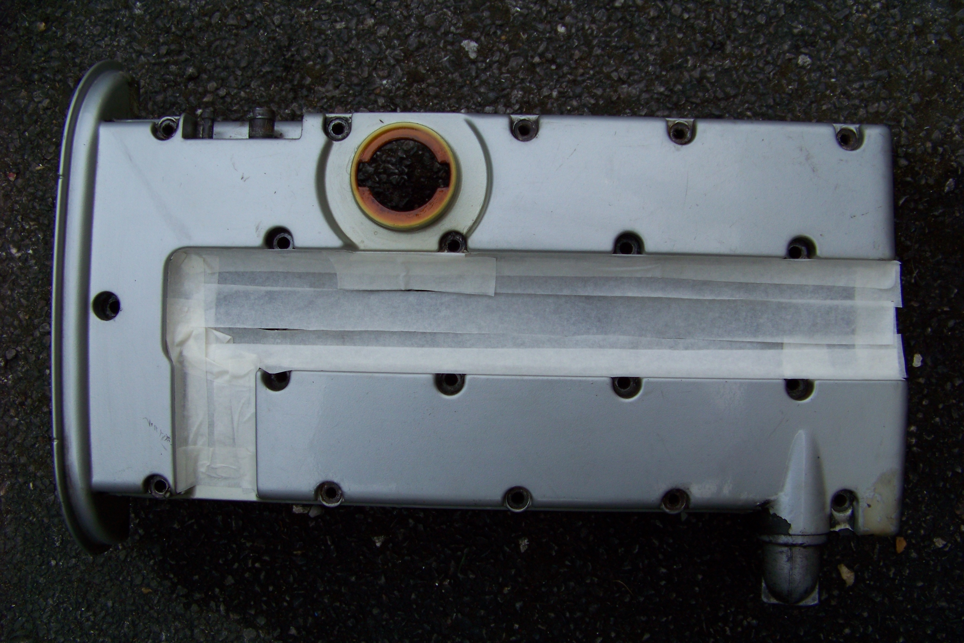

UPDATE
Got home from work about 4:30 and as it was still daylight and sunny, I decided to crack on with some straight forward quick work. It was the turn of the crankcase breather/dipstick pipe. This is how it came off the engine:
https://images2.imgbox.com/68/2c/cXyqZ5hP_o.jpg
This is it after a rub town with 240 grit wet and dry and a wash with detergent

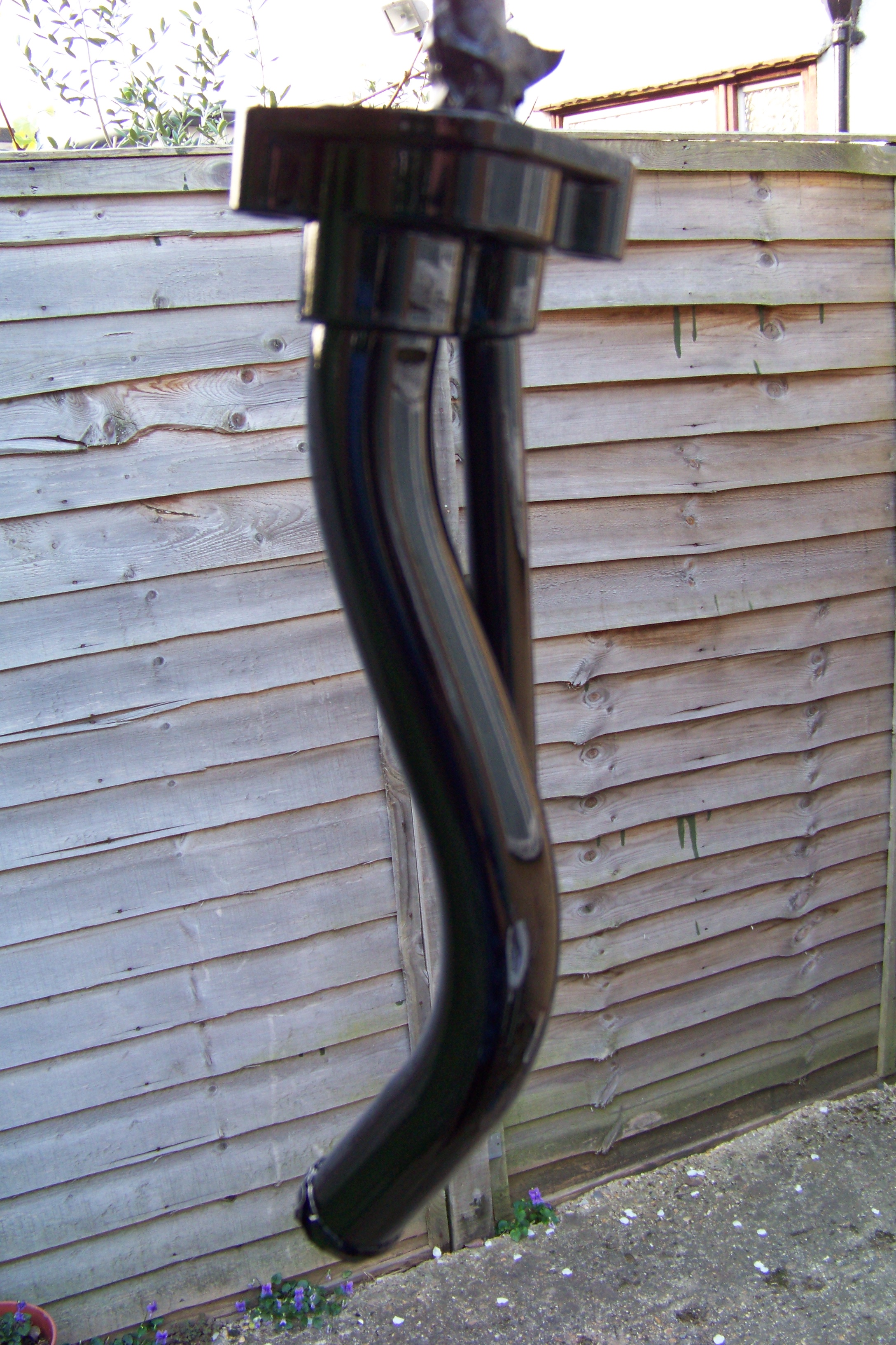

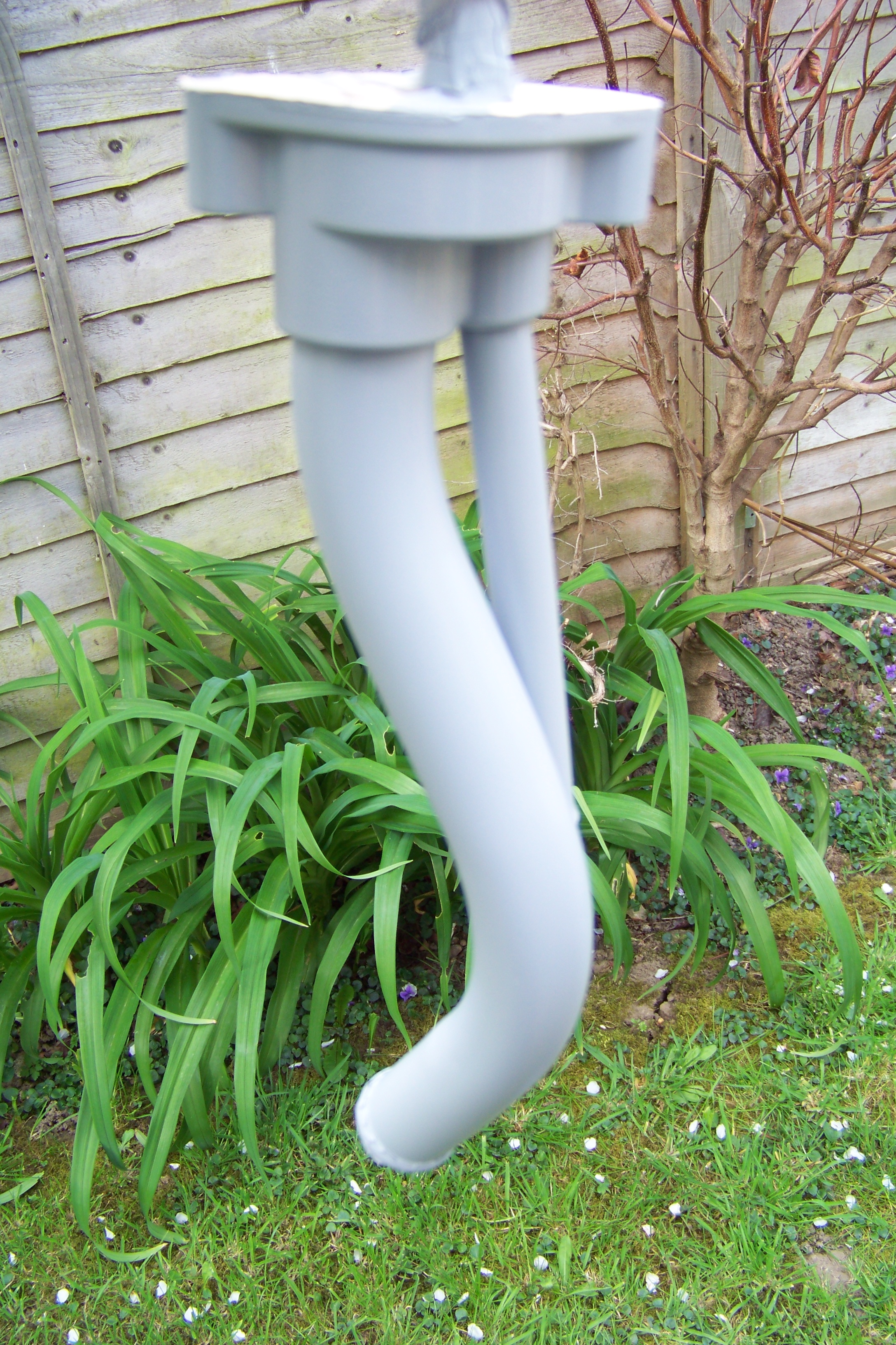

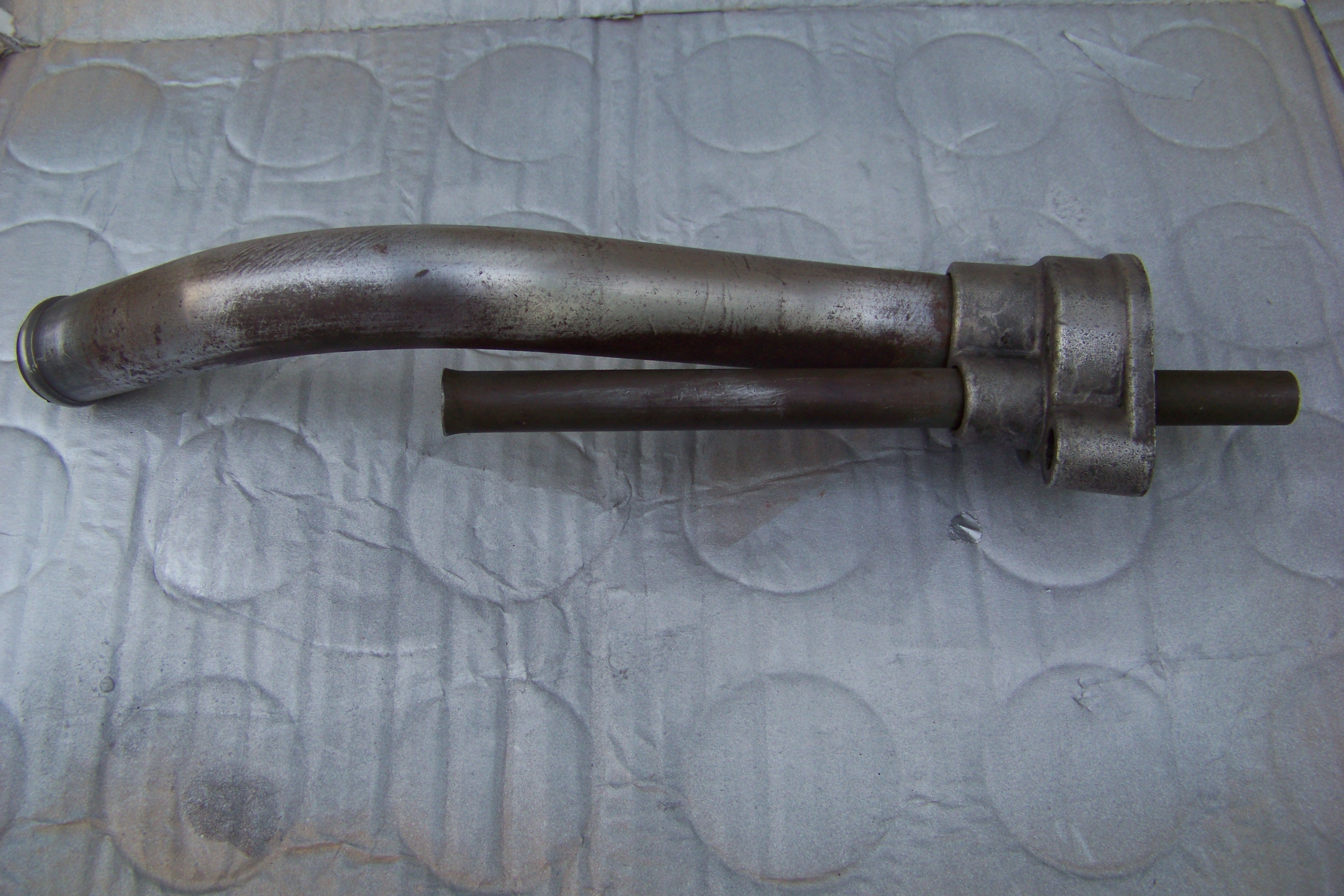

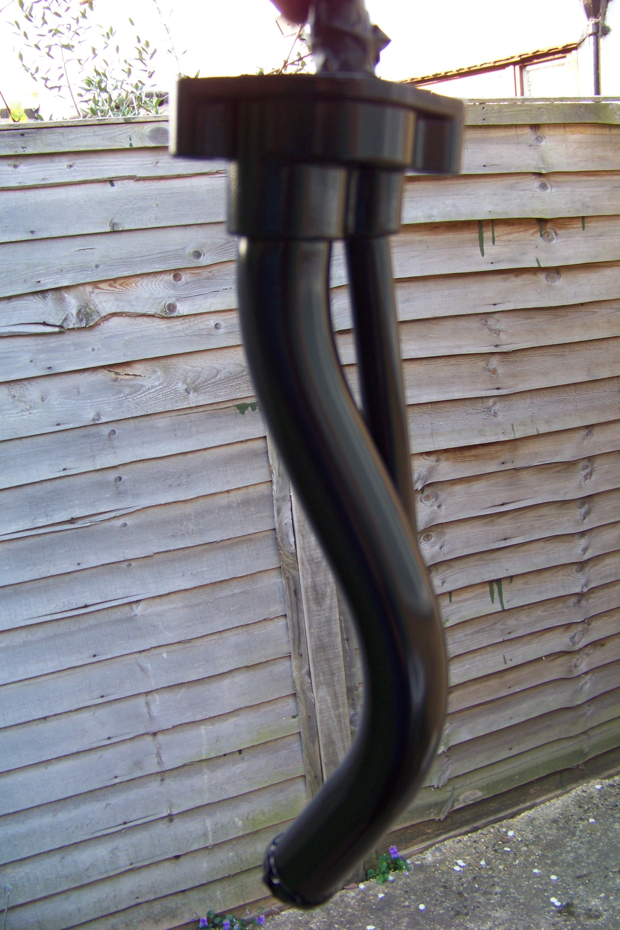

UPDATE

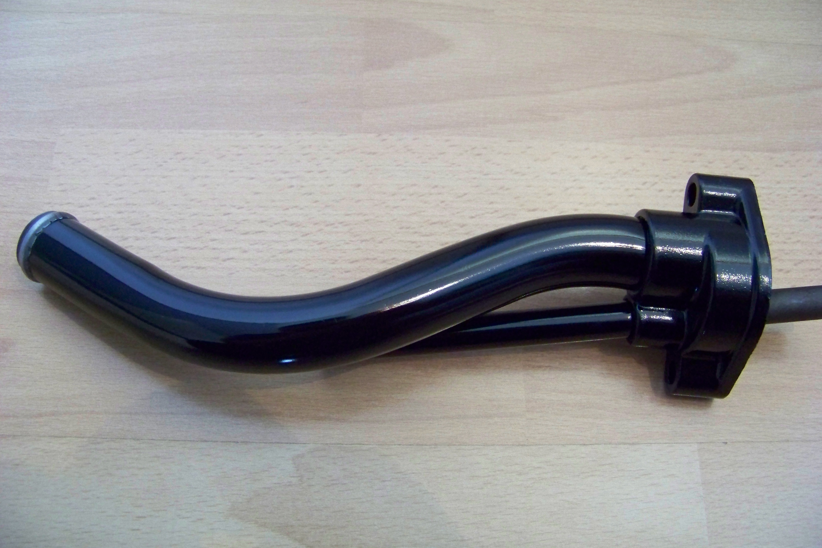

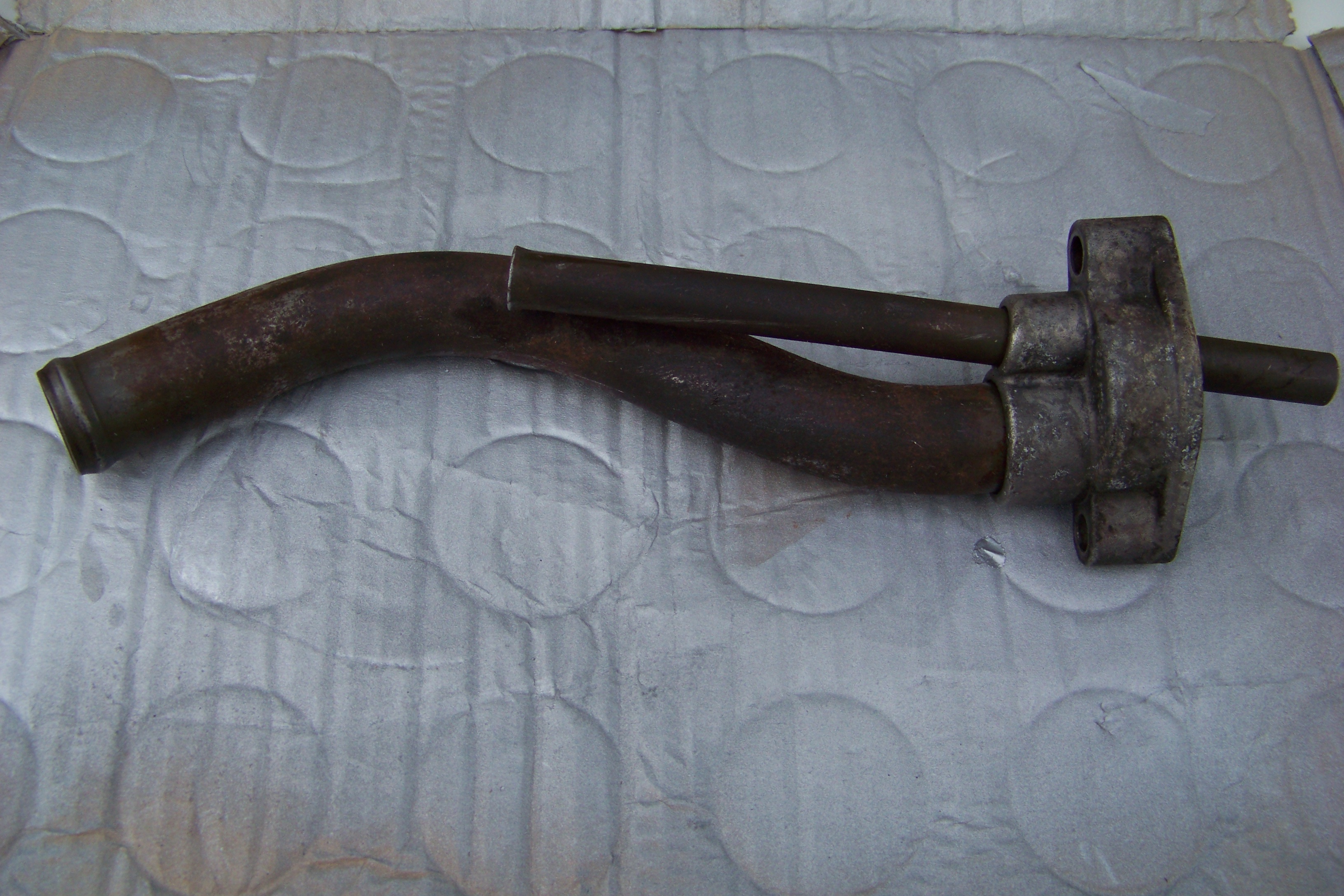

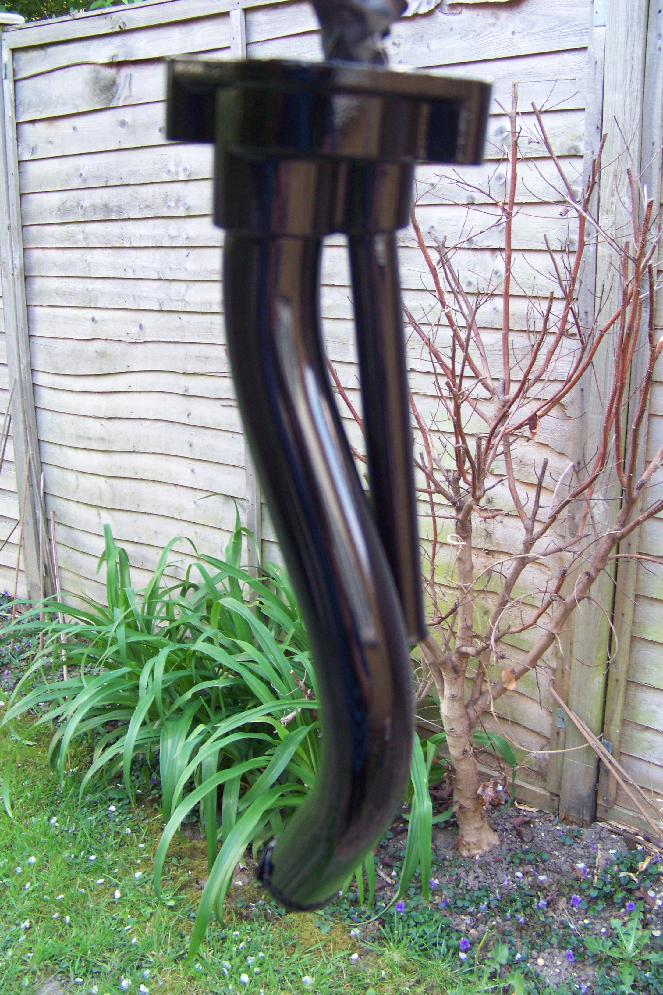

Woke up and went to check to see if the breather pipe had hardened. Great thing about my garage is that he boiler is located in there so in the evening when its on to give hot water it does get nice an toasty in there and with the weather being mild the garage probably hits 25 degrees easily.
It had dried properly and has come out real nice (bling, bling).

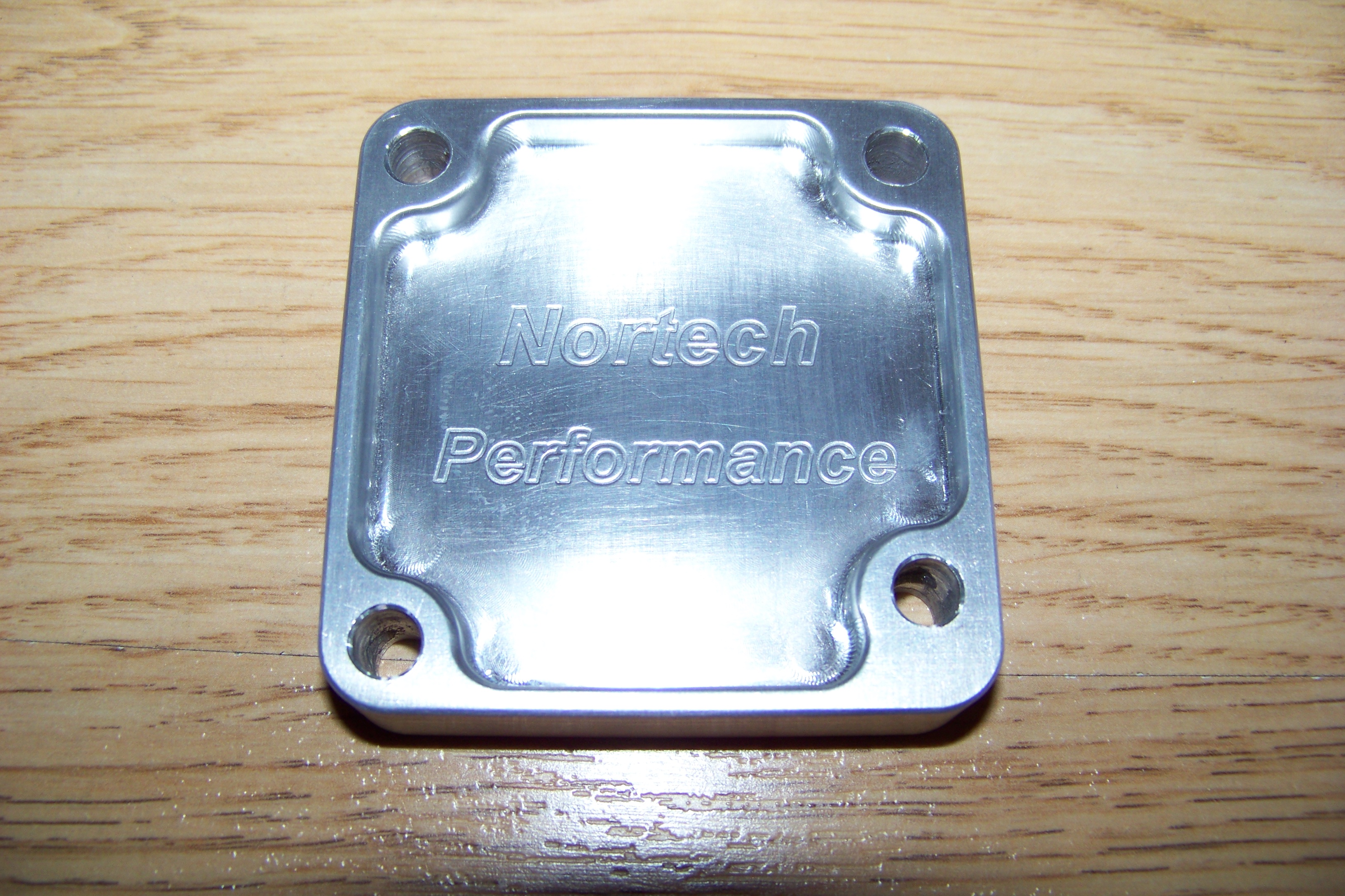

The postman also brought me a gift so I can now help protect a few more areas of the Nova, although reading the warning label has persuaded me to go buy some latex gloves before I use this stuff as 'it can harm the unborn child' :eek: Best not get pregnant!
https://images2.imgbox.com/06/51/WCWrIRwv_o.jpg

UPDATE
Went and exchanged my rotor arm for the proper one

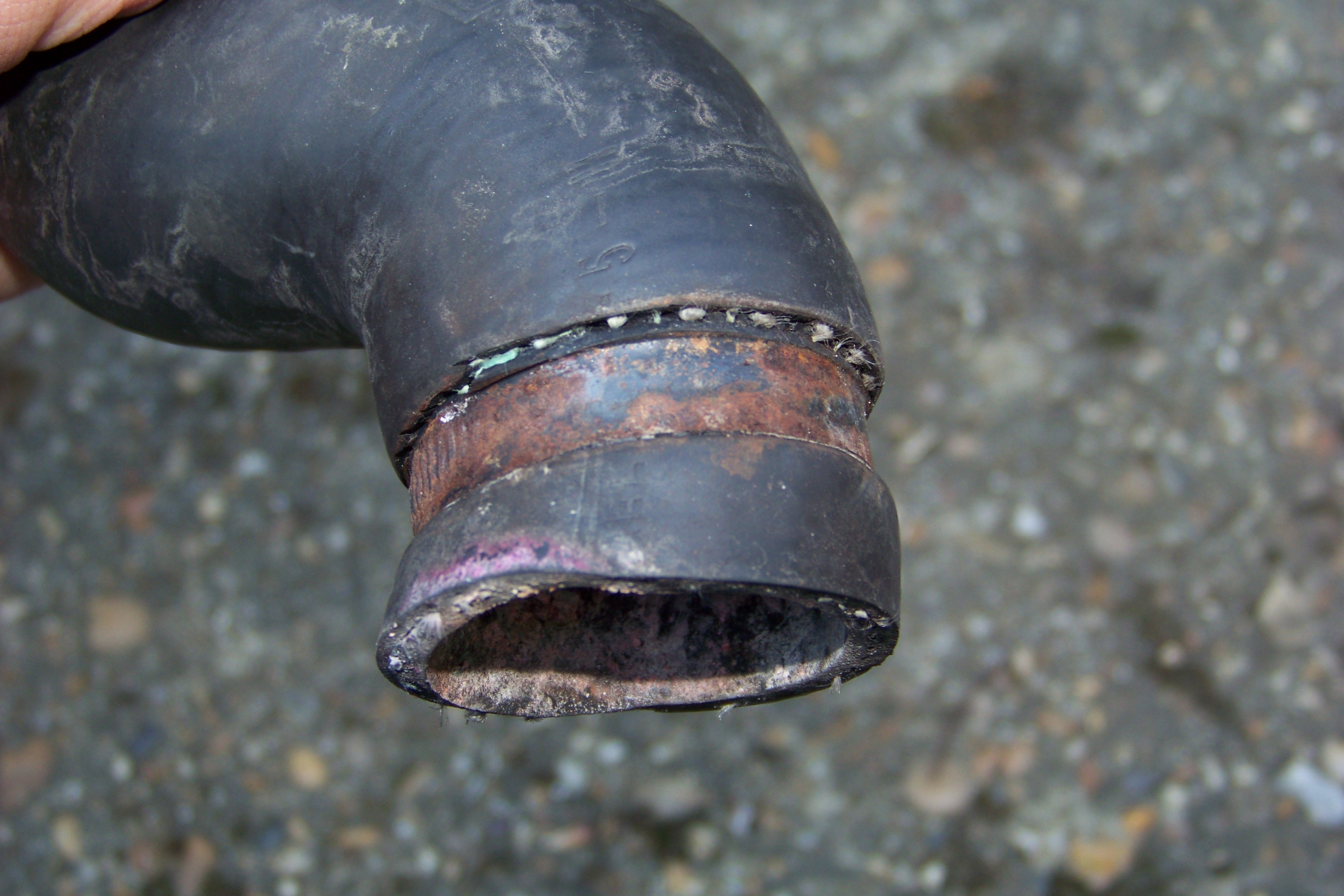

and also remembered that I'll need a new one of these.
https://images2.imgbox.com/47/d4/bUPOB3eN_o.jpg
http://img848.imageshack.us/img848/558/1002221.jpg

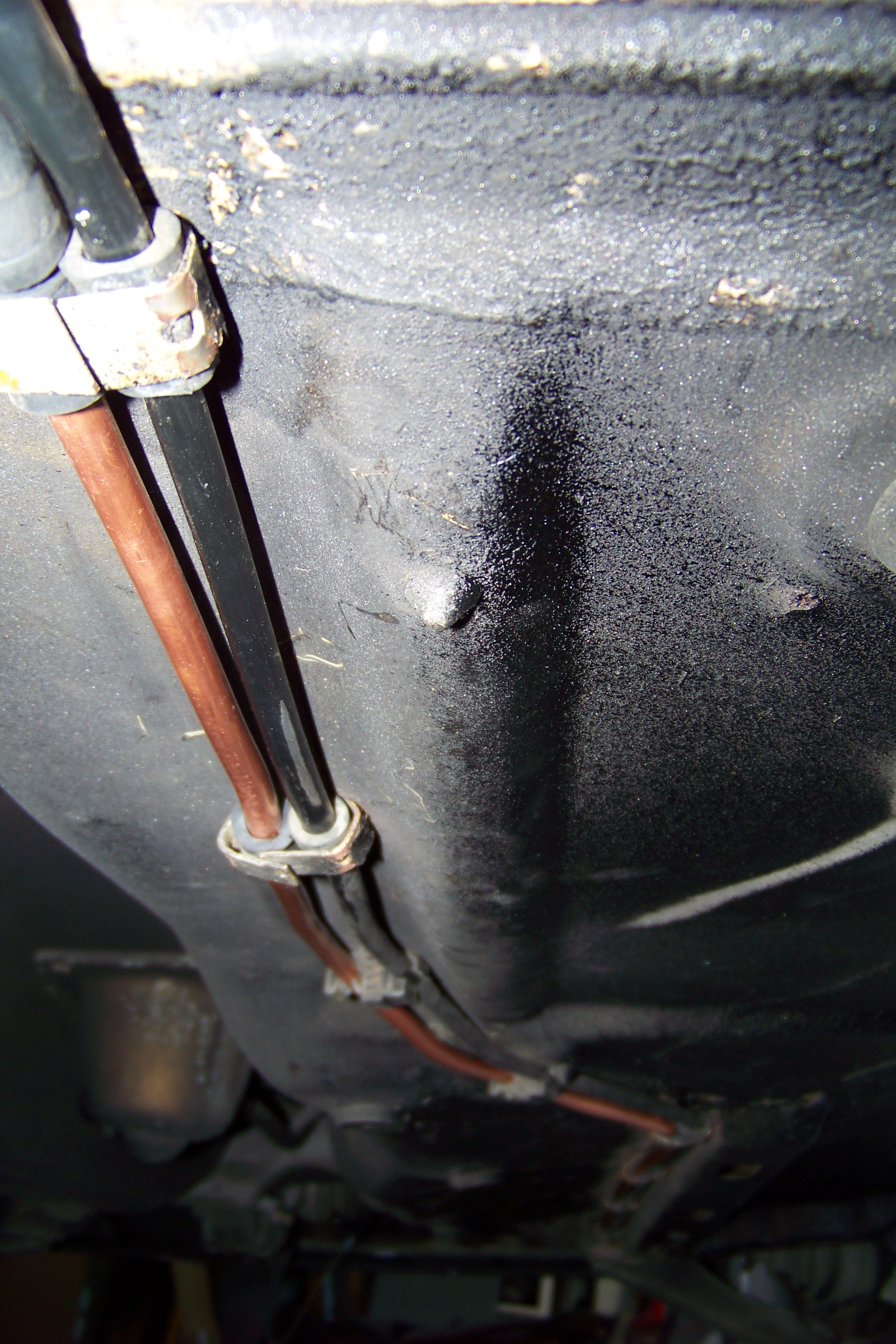

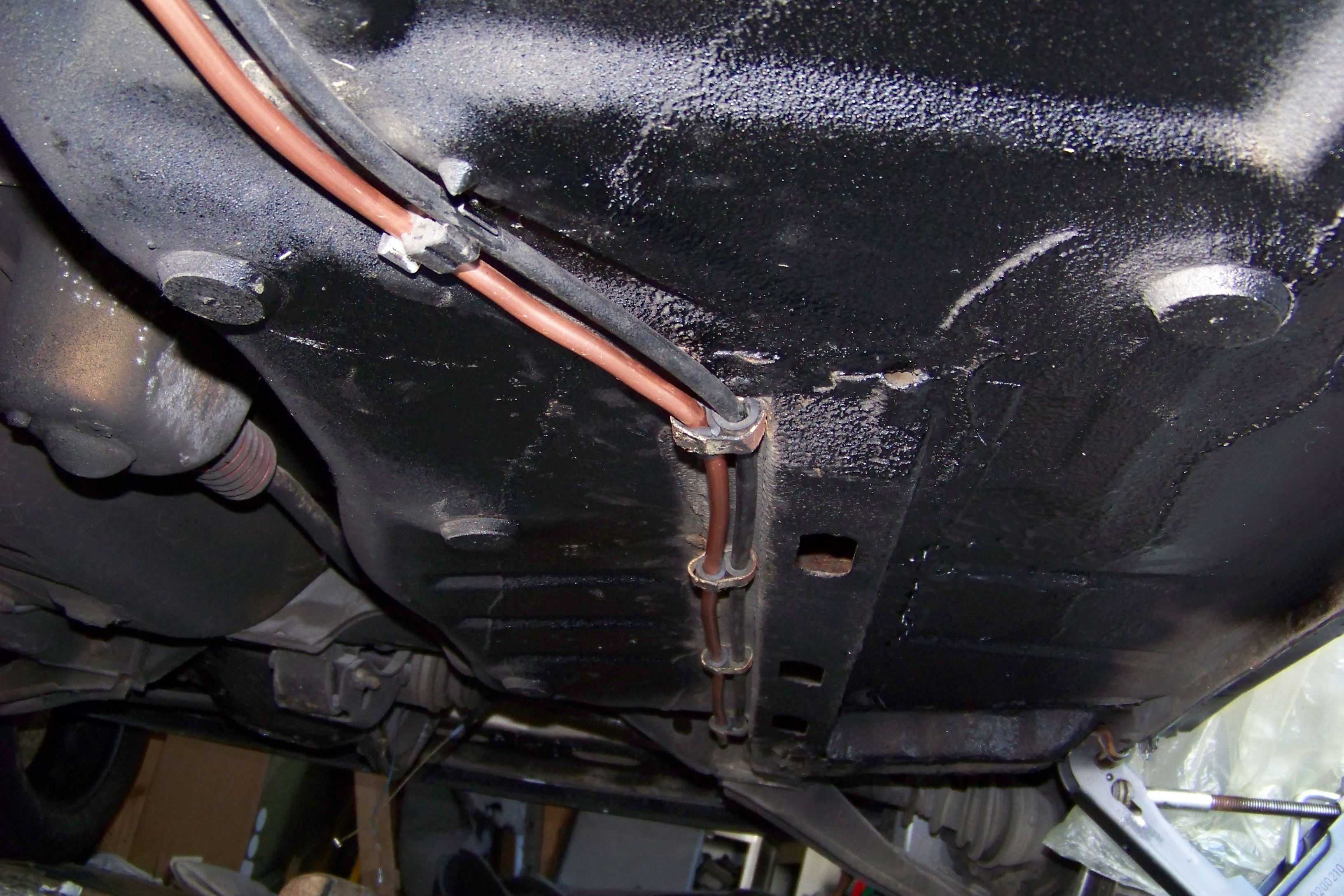

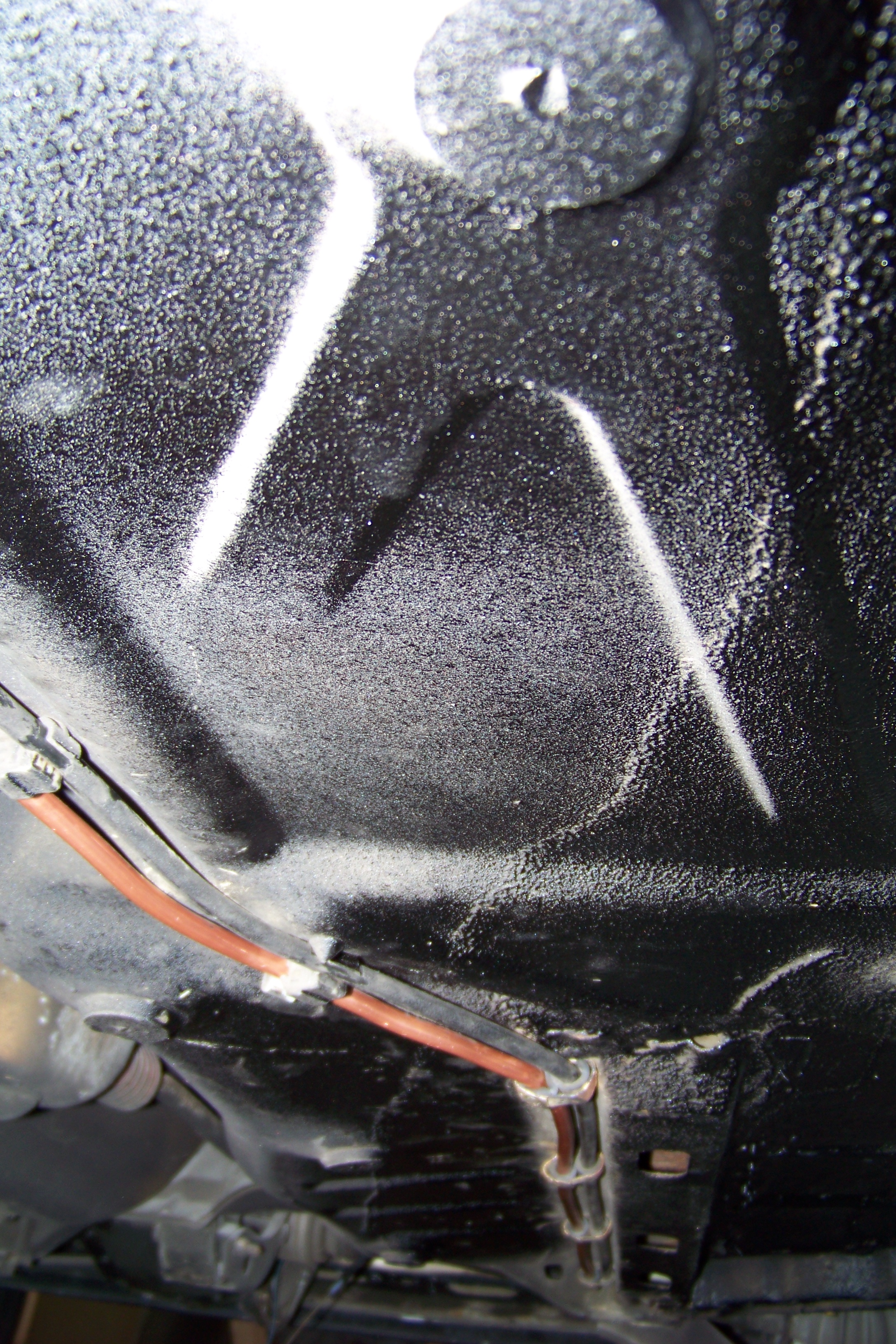

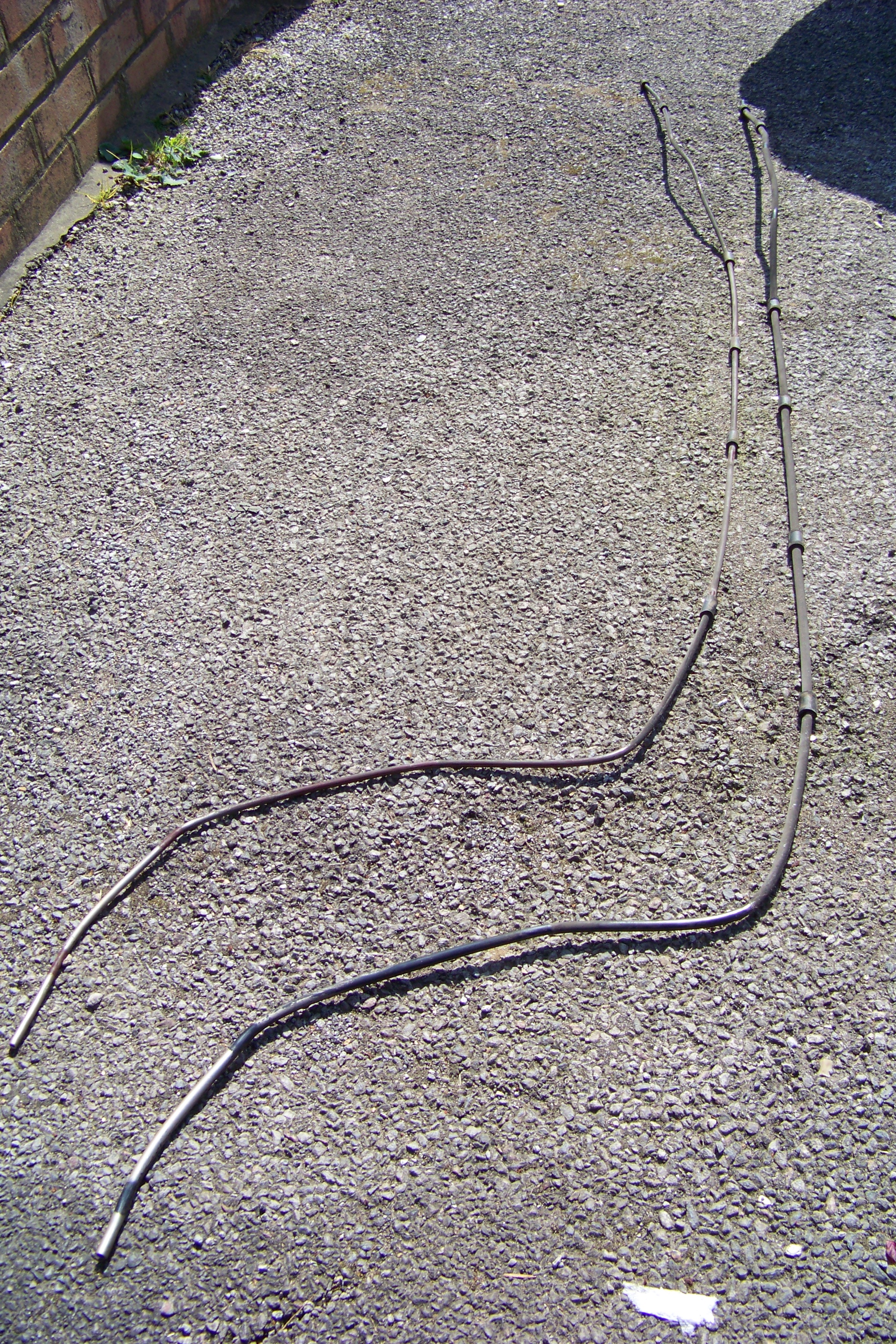

Thought I'd get a move on and make good use of the lovely sunshine. After a bit of breakfast I popped over to Le Garage. Pushed out the Nova and got it up in the air in order to sort out the copper fuel line. The plan was to take the existing feed line and swap it with the return and for the copper line to take the feed lines' place.

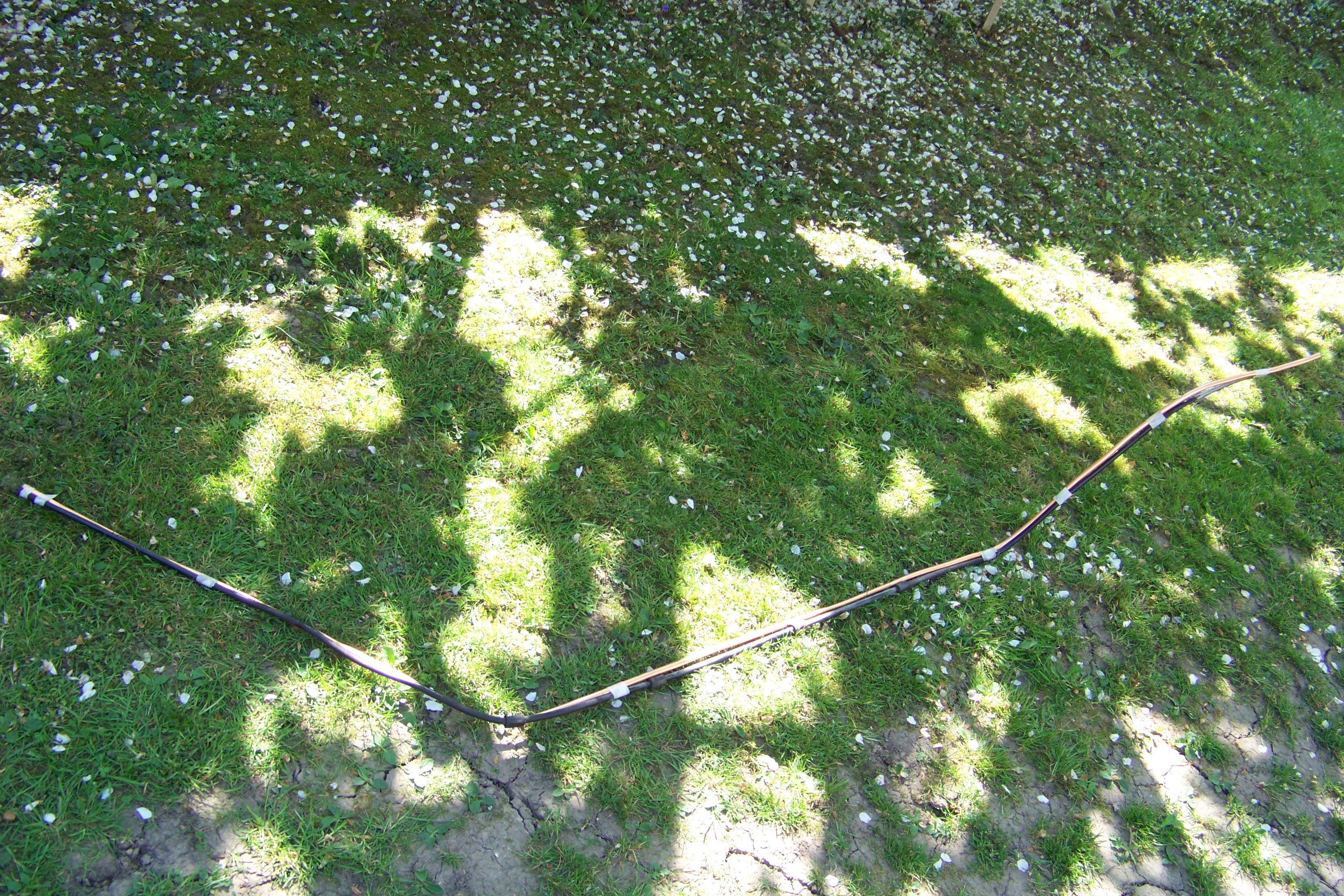

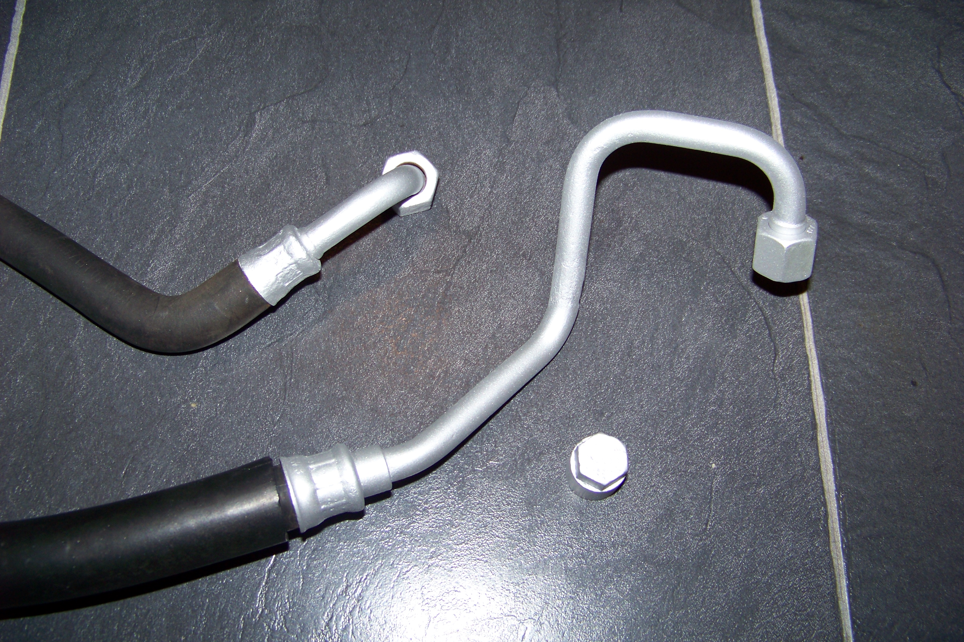

After some fiddling I removed both the lines:
https://images2.imgbox.com/2b/66/H9tsBREs_o.jpg
I then got out the copper line. Seeing it coiled I thought 'hope this is enough' didn't realise how long it was, probably enough to do two lines. Then came the hard bit, getting it in shape of the old line. I masked the lines together and started to bend the copper line into shape, not 100% to shape but enough to give me an idea and roughly fit into place. Whilst fitting it I'd be able to fettle bits here and there to get it exact. I thought that was hard... the next bit was a right funking pain. Fitting the copper line back in. The worst bit was the part of the line that went into the bay. As the nylon lines were flexy they were dead easy to position and feed through the bottom of the chassis leg whereas the cooper one proved to be pain. I managed to go it fitted albeit slightly kinking it where it exits the bay and bends to run under the floor. I bent it back opposite way and got most of the kink out. There's still a slight kink but I doubt it'll have any effect as the copper pipe is 10mm (ID).
The next bit was dead easy, running it under the floor and fixing it in place. The plastic pipe clips were a big help and all that was needed was a slight bend here and there and it was done. A few pics:
https://images2.imgbox.com/27/bb/SPALIgNN_o.jpg
Next up was to re-apply some underseal as I managed to take some off with some of the tools I was using I made sure I put on many coats of the stuff. As I had also removed the exhaust I gave the exhaust tunnel a good going over too.
https://images2.imgbox.com/37/d7/xtCChohk_o.jpg
https://images2.imgbox.com/9b/2f/FITu4w0g_o.jpg
https://images2.imgbox.com/9e/f1/KV1FwbbK_o.jpg
There is a few cm's of copper line I need to trim in the bay as I left some just in case it was short. Need to pop over to my mate across the street and use his pipe cutter.
All in all a fairly productive day, just waiting for the angus steaks to cook on the BBQ mmmmm

the copper pipe i used wasnt the best. was off ebay but very thin walled so kinked rather easy. i managed to half inch some other stuff from work for the second line.
pm on the way about the hazard switch.
^ This stuff was good quality, took some hand power to bend it, and it bent very uniformly. My mate across the street is a plumber and he had a look and said its good stuff (should've really asked him to get me some though).

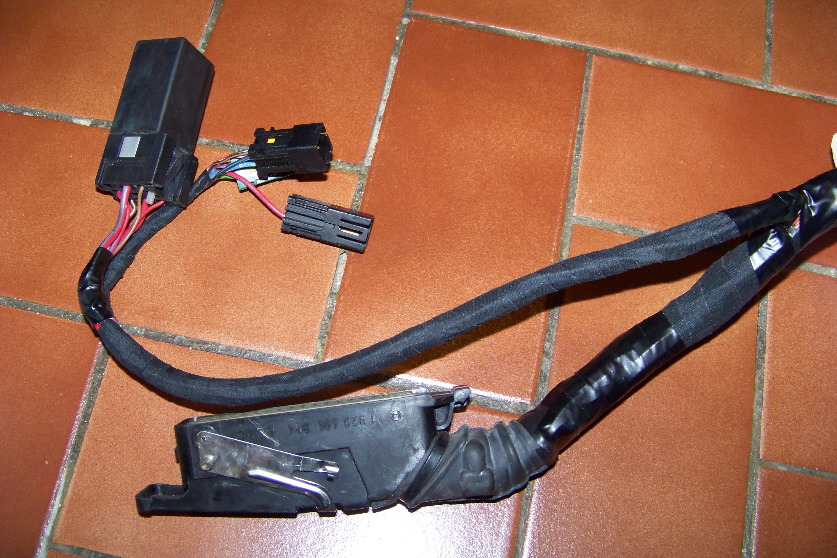

I just finished off the last bit of the loom, found the fabric tape in 'le garage' but it was just short so I finished the rest with self- amalgamating :)
https://images2.imgbox.com/c1/94/kY6G9A1Y_o.jpg
http://img37.imageshack.us/img37/751/1002227m.jpg

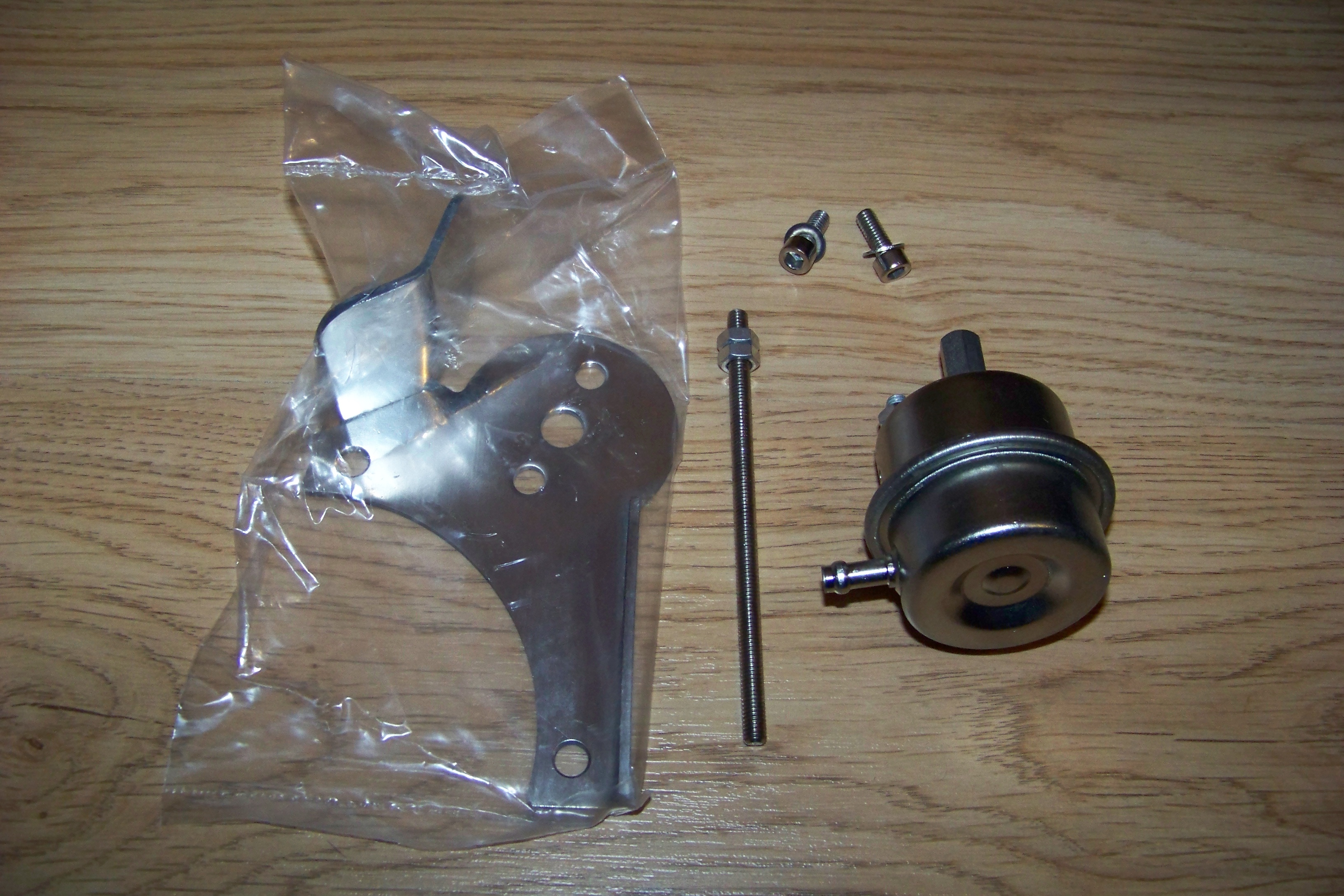

Got another bit in the post today, unfortunately I had to go work so I couldn't check it but I had a good idea what it was

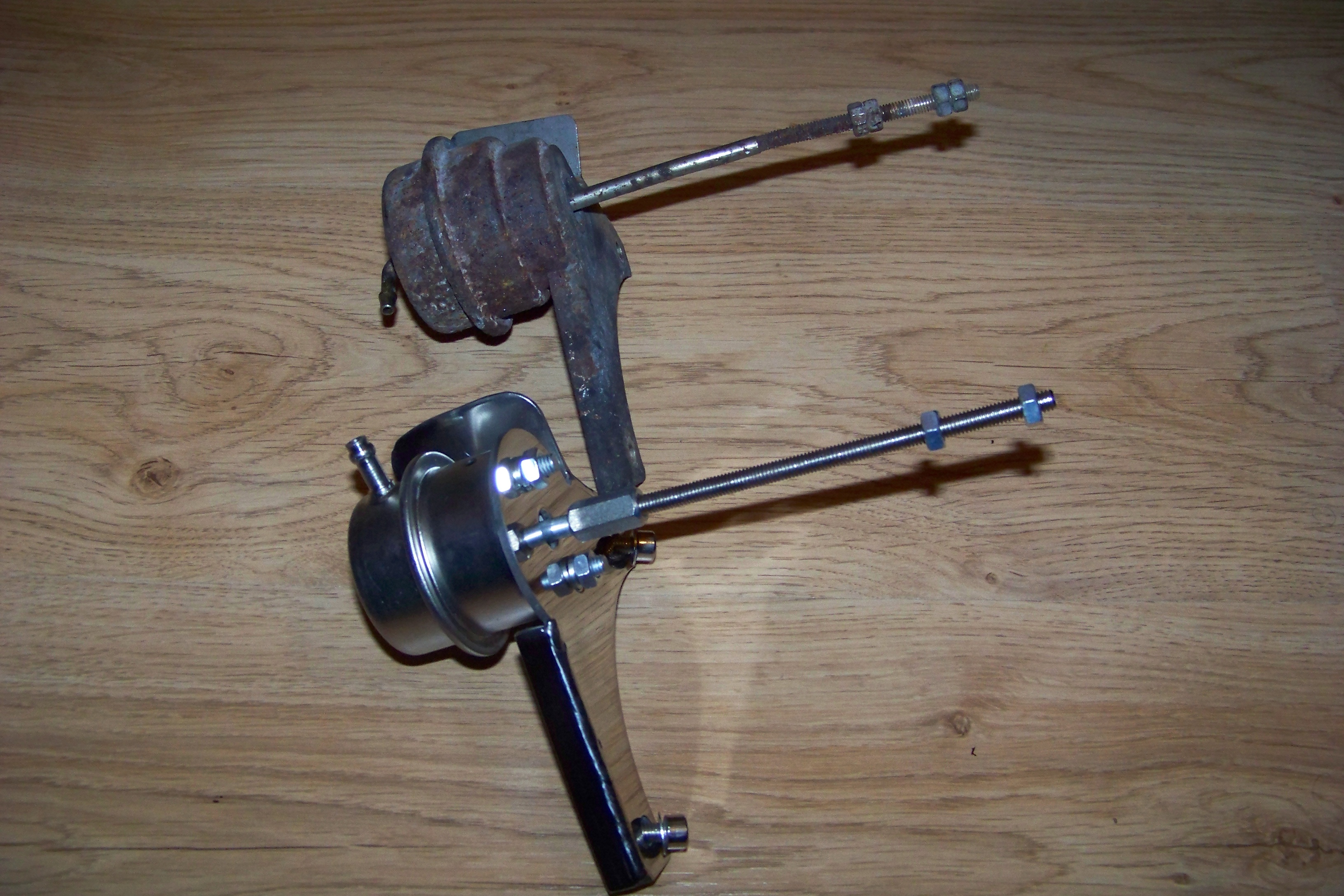

Got home and ripped it open like a man sized kid. It was the uprated TX Autosport actuator I got off eBay:
https://images2.imgbox.com/dd/d2/UgIeDnH1_o.jpg

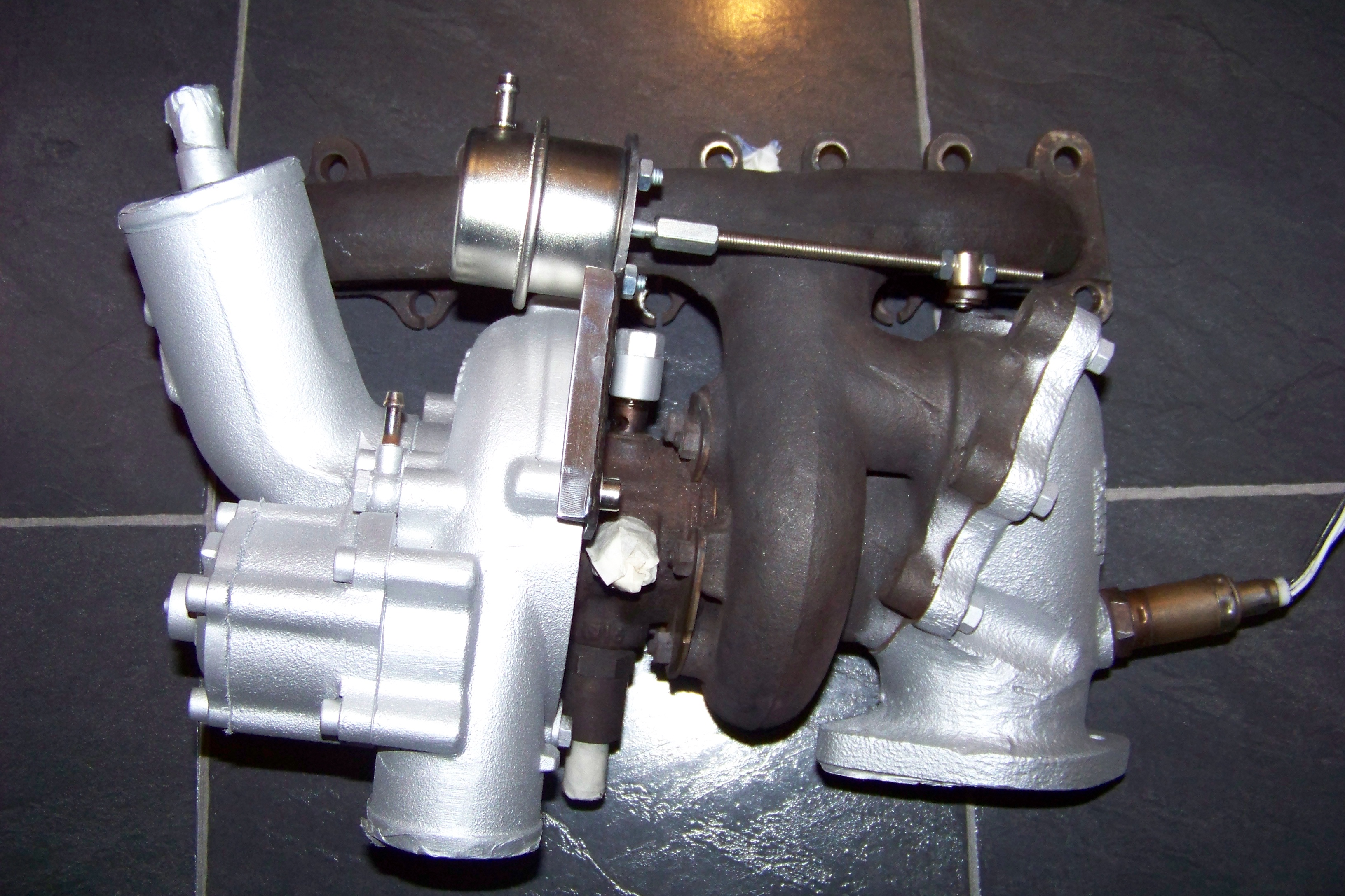

Assembled it and thought I'd compare the old one to the new one
https://images2.imgbox.com/11/83/HdBaVqG2_o.jpg
And then fitted it to the turbo, I'm guessing I set it up right (took the screw positions as it was on the old actuator)
https://images2.imgbox.com/09/81/xEQfz4fs_o.jpg
This one deffo feels a lot tighter and stiffer compared to the original one. I could easily move the actuator rod on the old one and hardly move it on the new one.

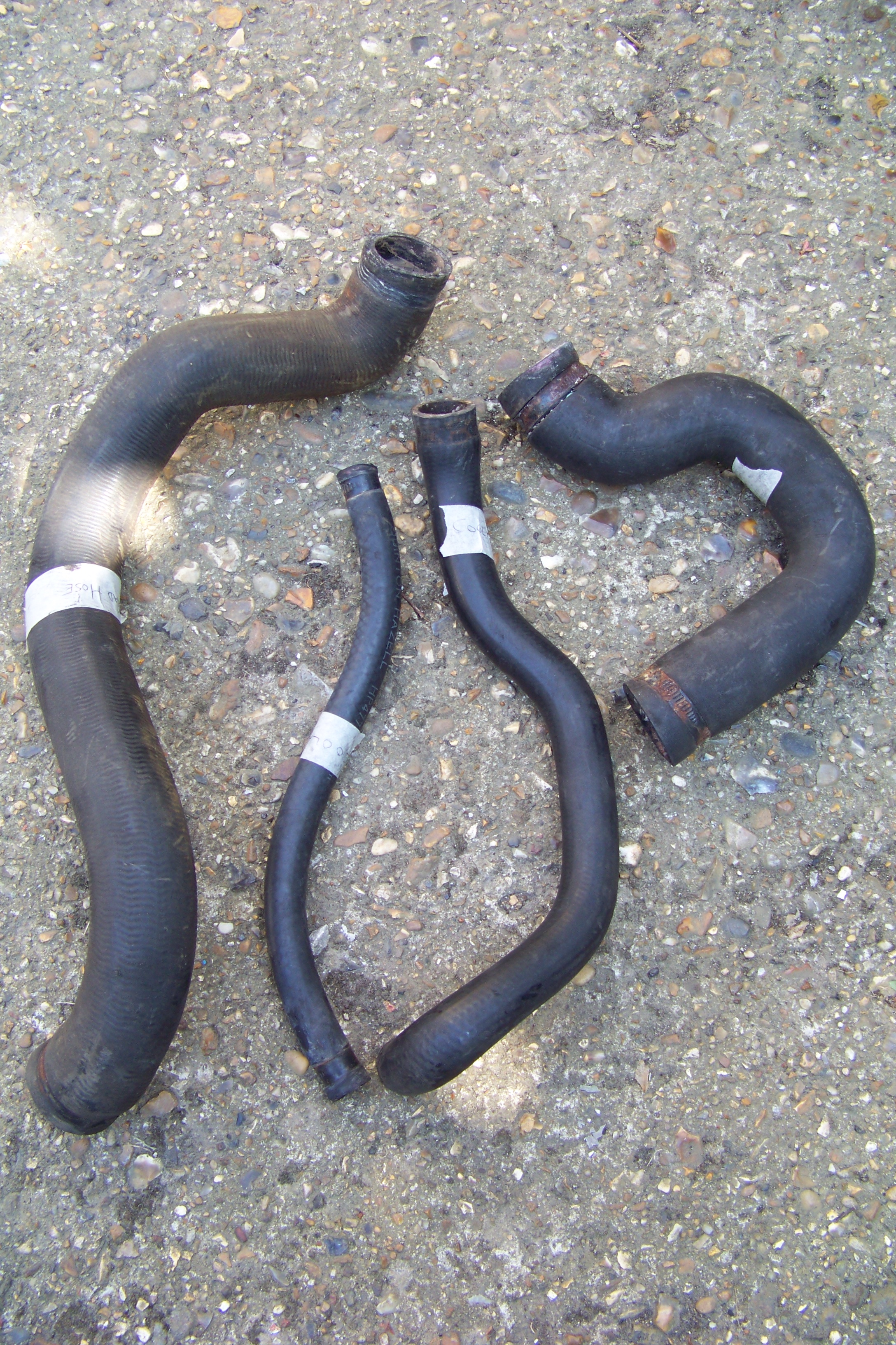

Another sunny day off so I thought I'd continue with the boring but somewhat satisfying outcome (when finished).

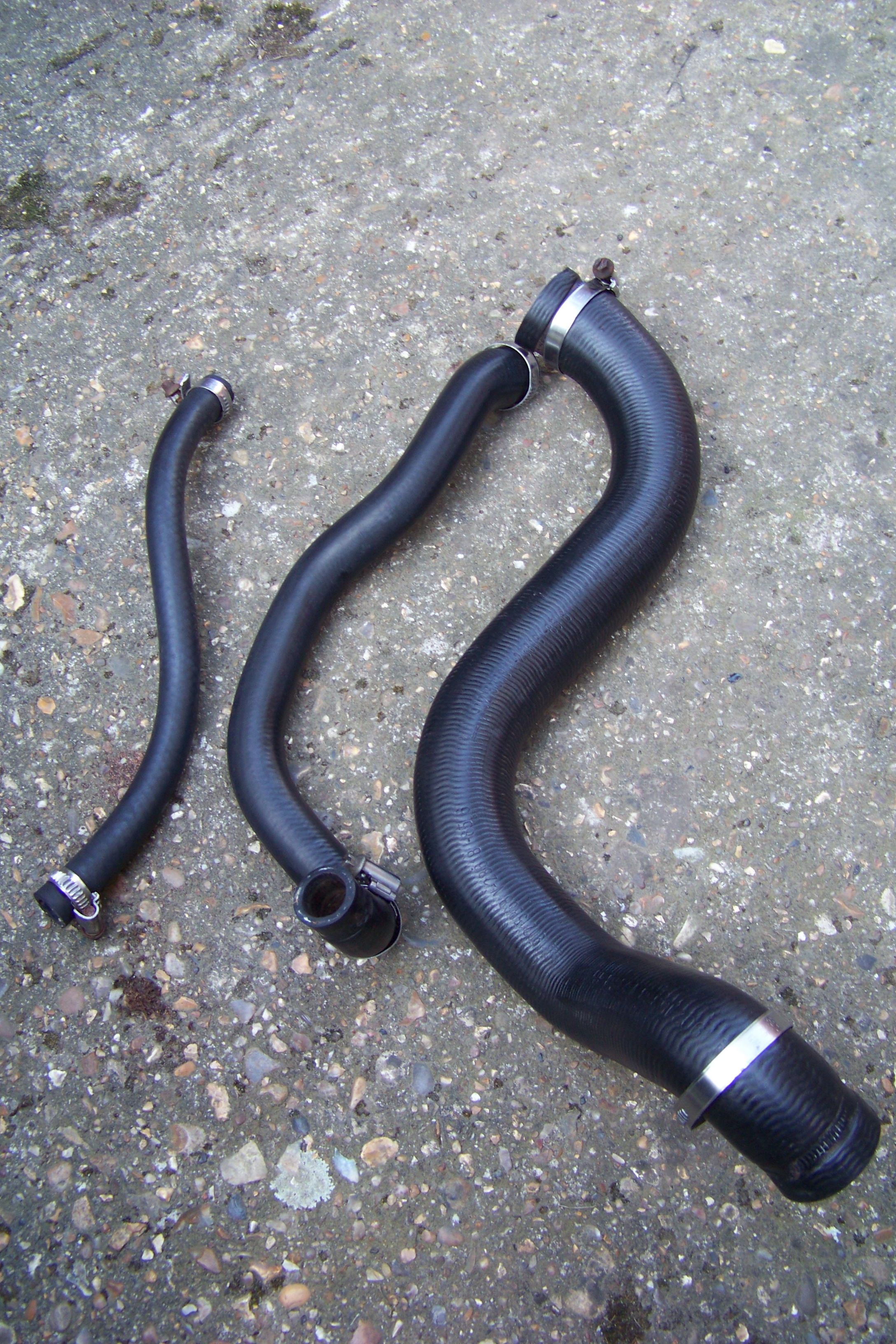

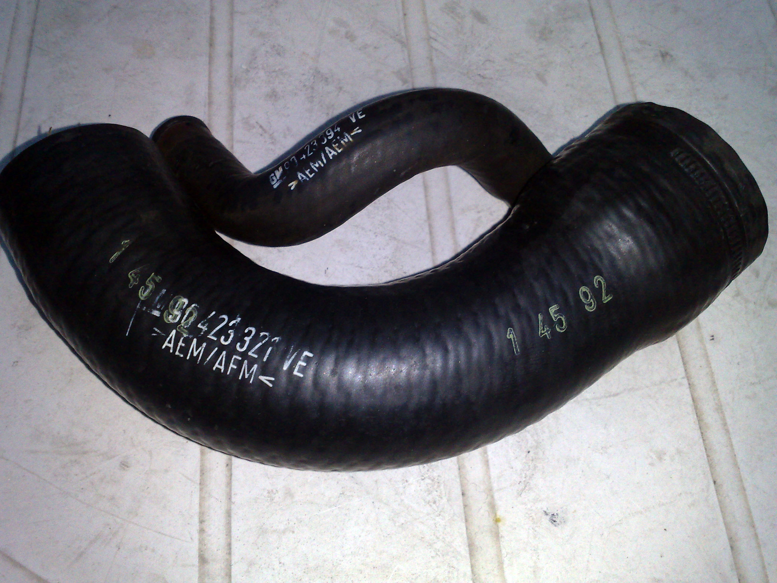

Started sifting through all the hoses. I put aside the two turbo hoses that need changing but the other hoses are perfectly fine, in fact the two I cleaned today look brand new. Here they are at the bottom of the turbo
After some good scrubbing with detergent and hot water this is how they turned out. I'm pretty certain that they are new hoses as they still have the part numbers on them nice and bright
https://images2.imgbox.com/88/81/fKaFsCR1_o.jpg

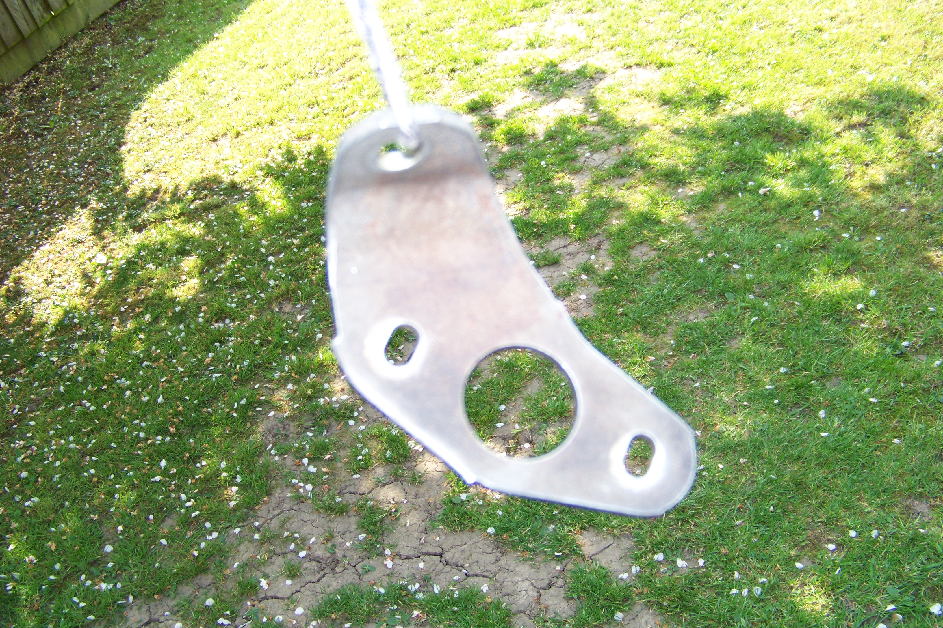

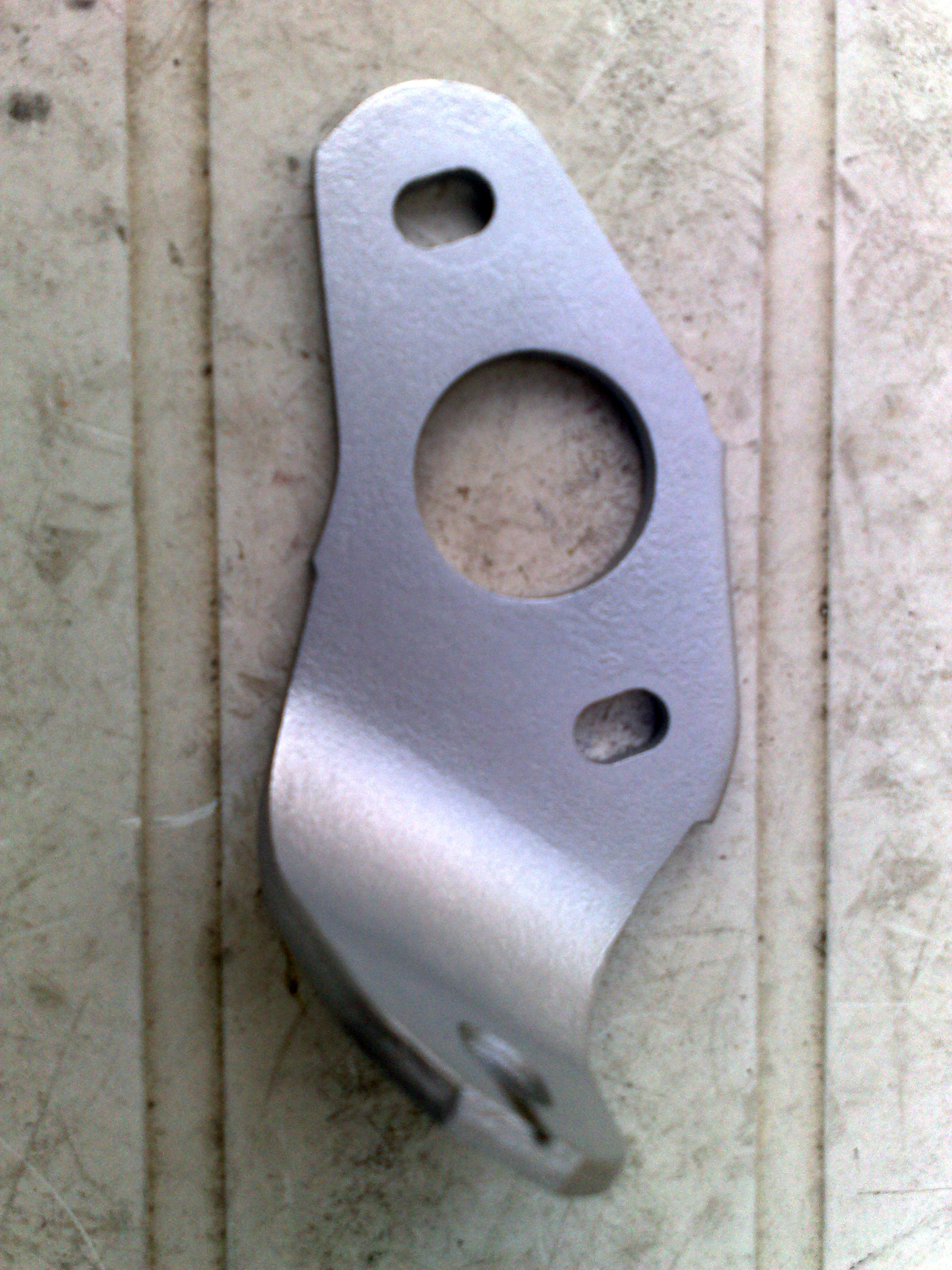

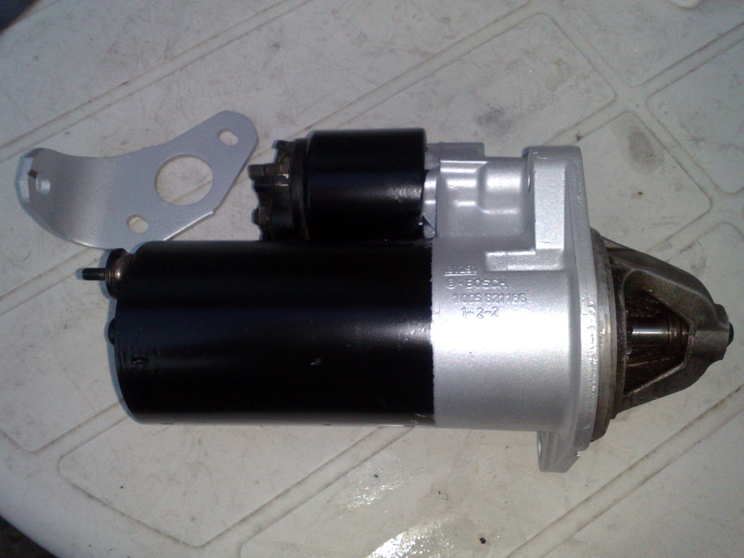

I then moved on to one of the starter motors. I bought two off eBay for a damn good price but they looked a bit battered I decided to sort one of them out. Did the usual clean, rub down with wet and dry, wipe, mask and paint.
Painted the bracket in aluminium silver
https://images2.imgbox.com/7e/81/6vNtWmP1_o.jpg
https://images2.imgbox.com/04/29/OksPLWTM_o.jpg
After a good clean and rub down:

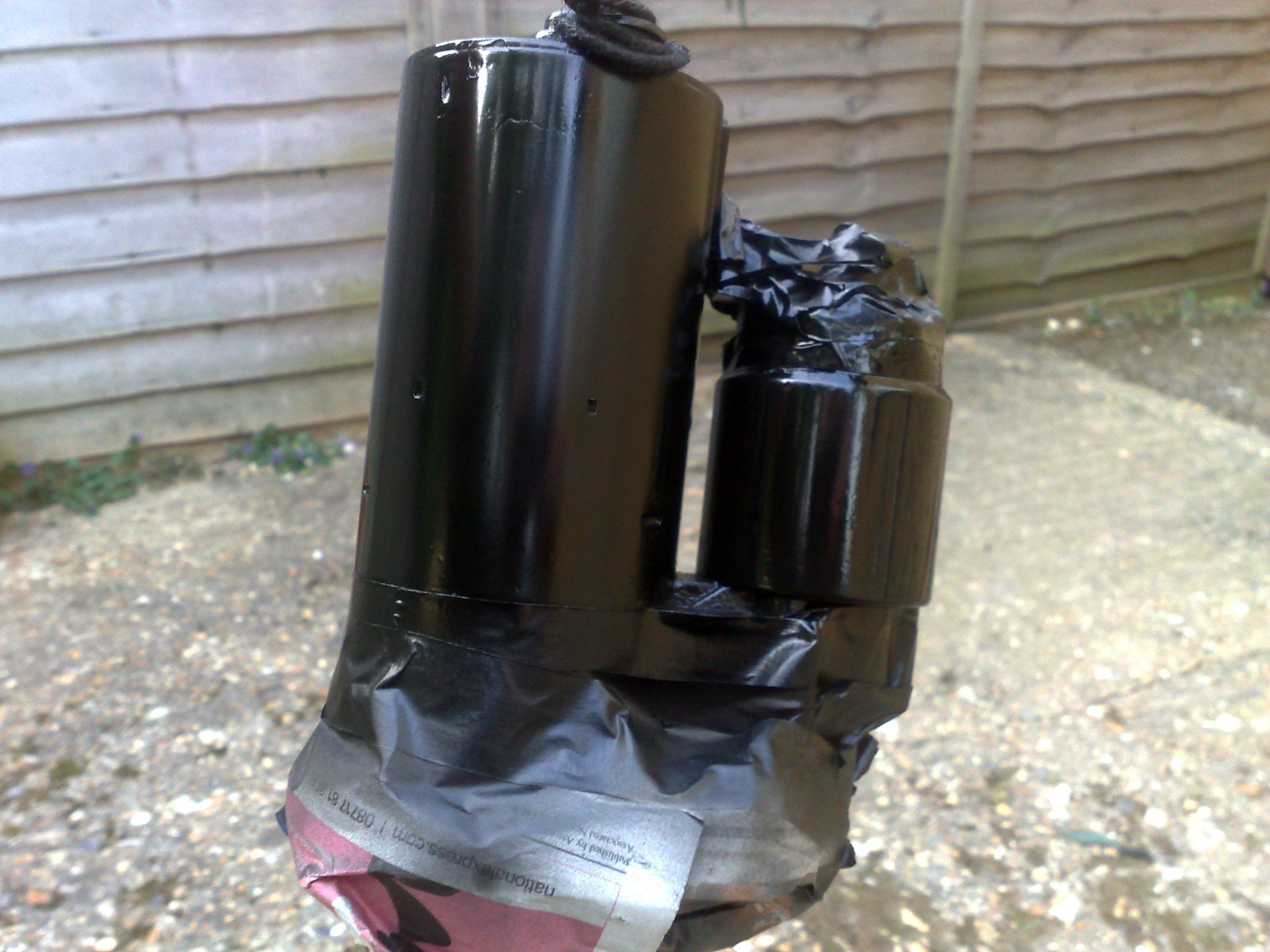

The body of the starter masked up and painted in satin black
https://images2.imgbox.com/90/e0/6XcITsrM_o.jpg
I then masked the part I painted in black and painted the remaining parts of the starter in aluminium silver, then let it dry, ét voila:
https://images2.imgbox.com/43/91/m1JQrzdh_o.jpg

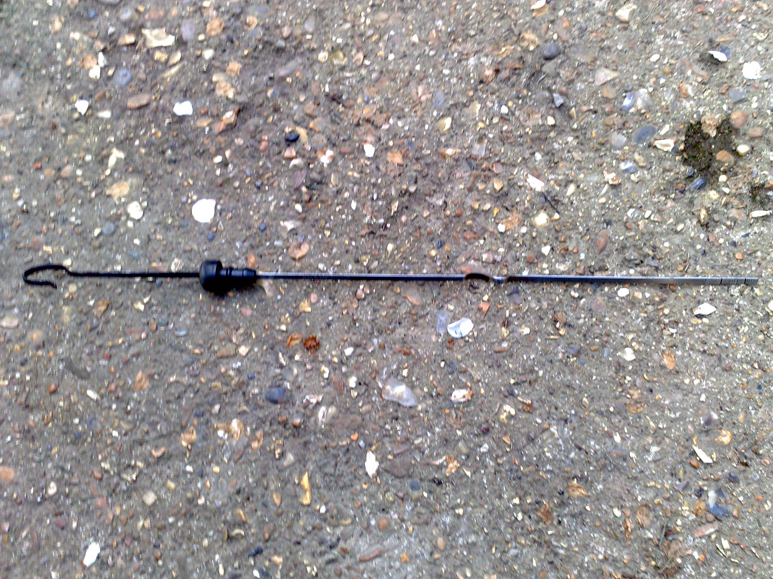

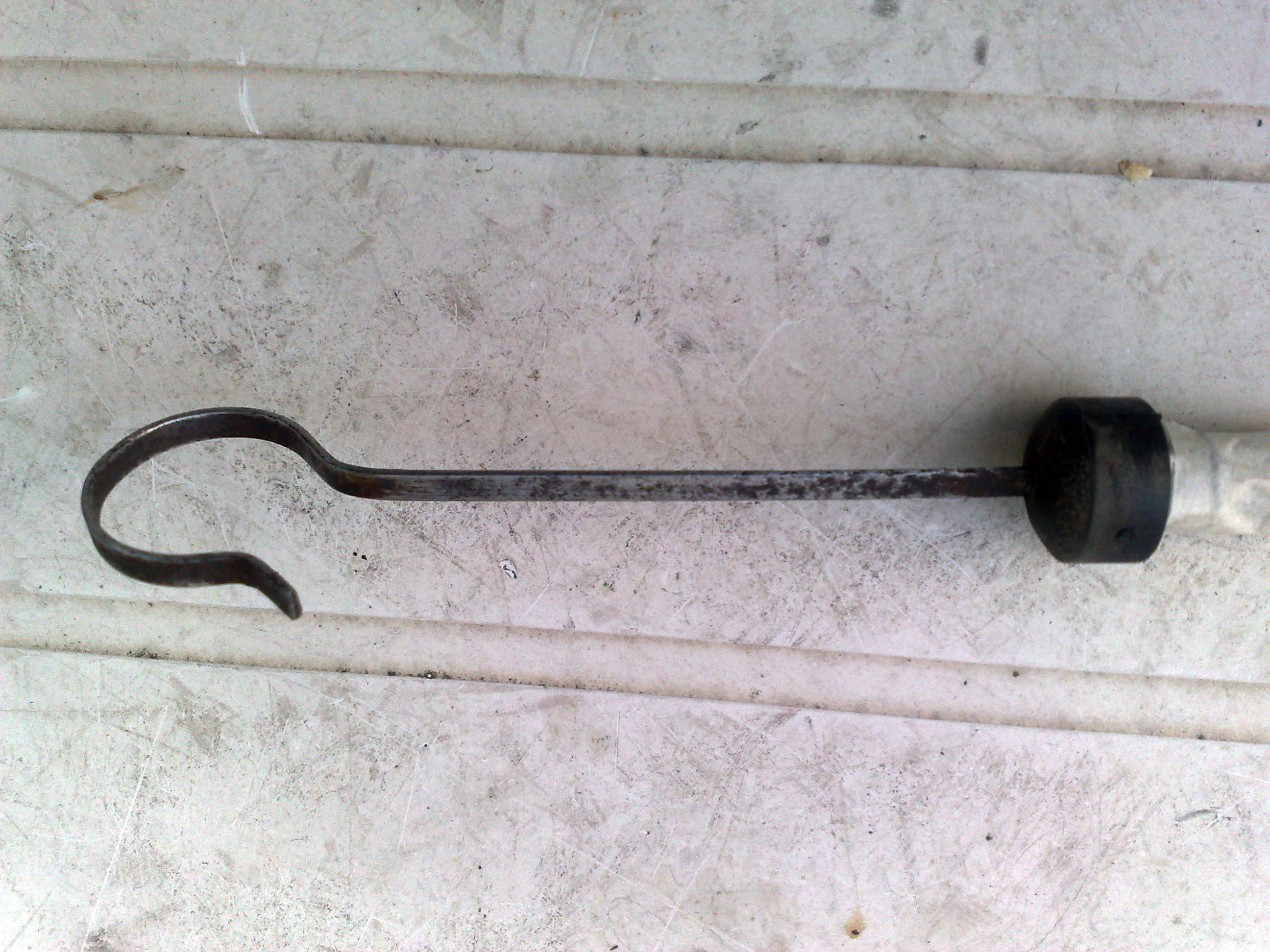

Saw the dipstick looking sorry for itself, all crusty and rubbish. Had to give that a clean too and then a clean and rub down getting the crust off
https://images2.imgbox.com/f9/72/eYYrALOB_o.jpg
https://images2.imgbox.com/1d/ae/KRaCCaCG_o.jpg
Then a good coat of satin black and let to dry

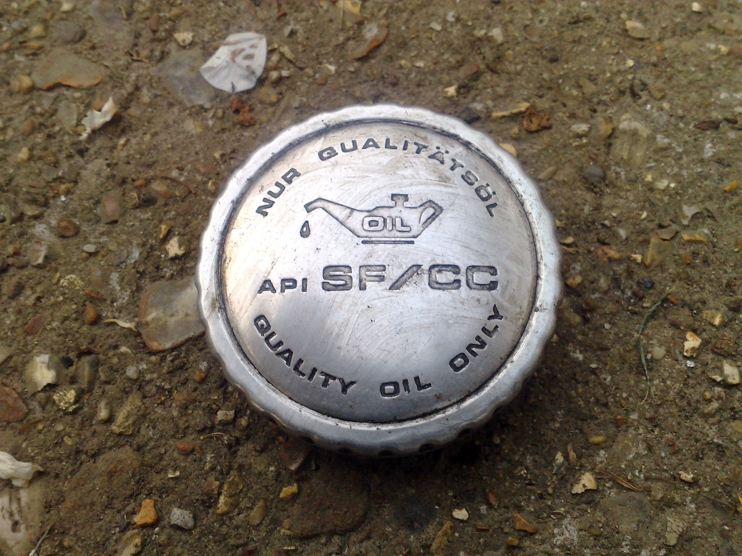

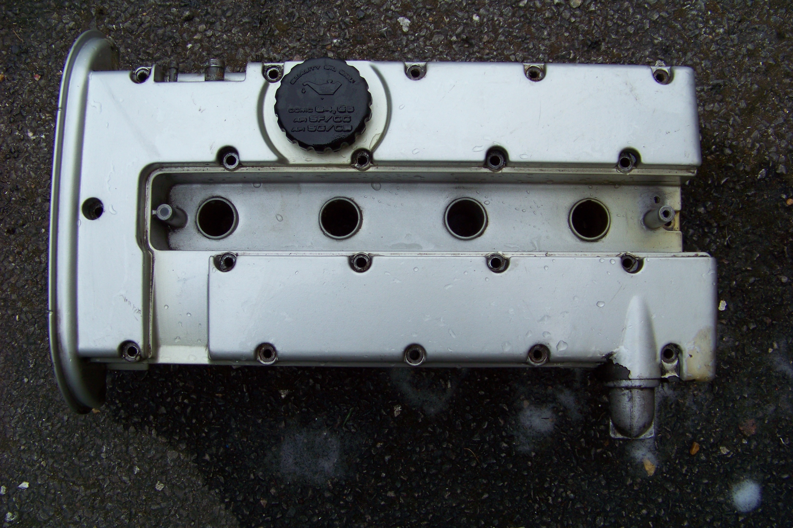

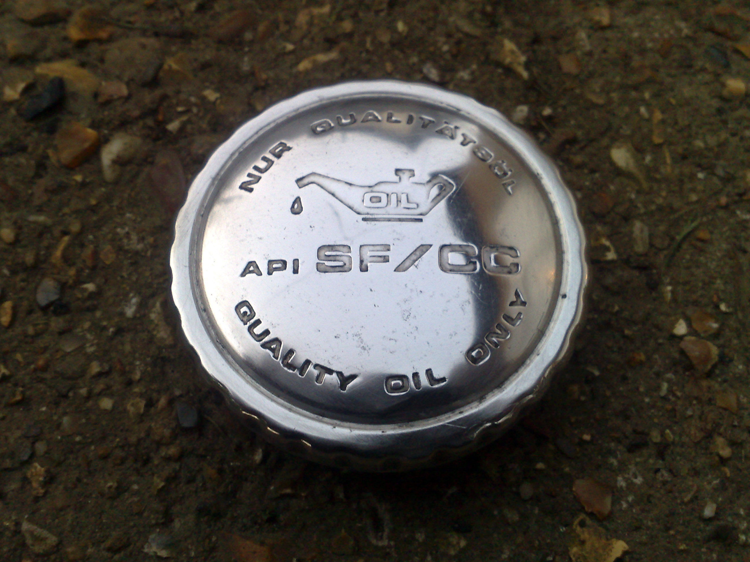

I then remembered the oil filler cap on the good old 1.2. I had to swap it for the one on the LET but here's how it looked before some elbow grease:
https://images2.imgbox.com/a0/f8/LF2x9ET1_o.jpg
And here it is after a good scrub with some detergent and sponge, a brillo pad, some 1200 & 1500 wet and dry and some paint renovator (couldn't find any T-Cut). Fairly pleased with the outcome miles better but it can be that bit shinier.
https://images2.imgbox.com/28/cb/z2crZbEG_o.jpg
Like I said, proper tedious and fairly boring stuff but I really want everything to look mint and be finished in a sense so I can just get the engine on the stand and put it all back together. That way I can concentrate on just one thing rather than many little jobs. I'll have to wait until Tuesday in order to pop down to Vaux and order the two turbo hoses. Still need to get some plugs, leads, sensors, cam belt and rollers, oil filter etc.

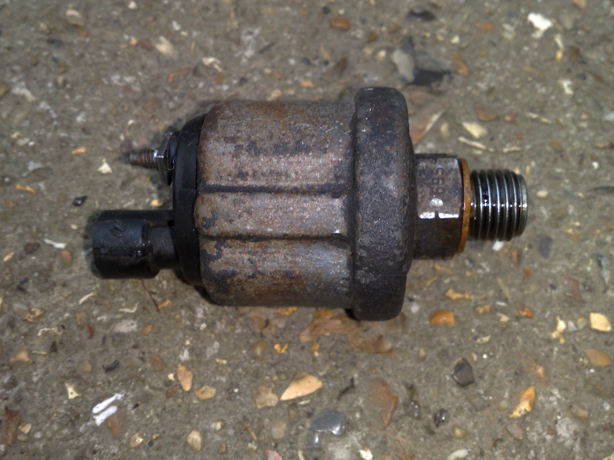

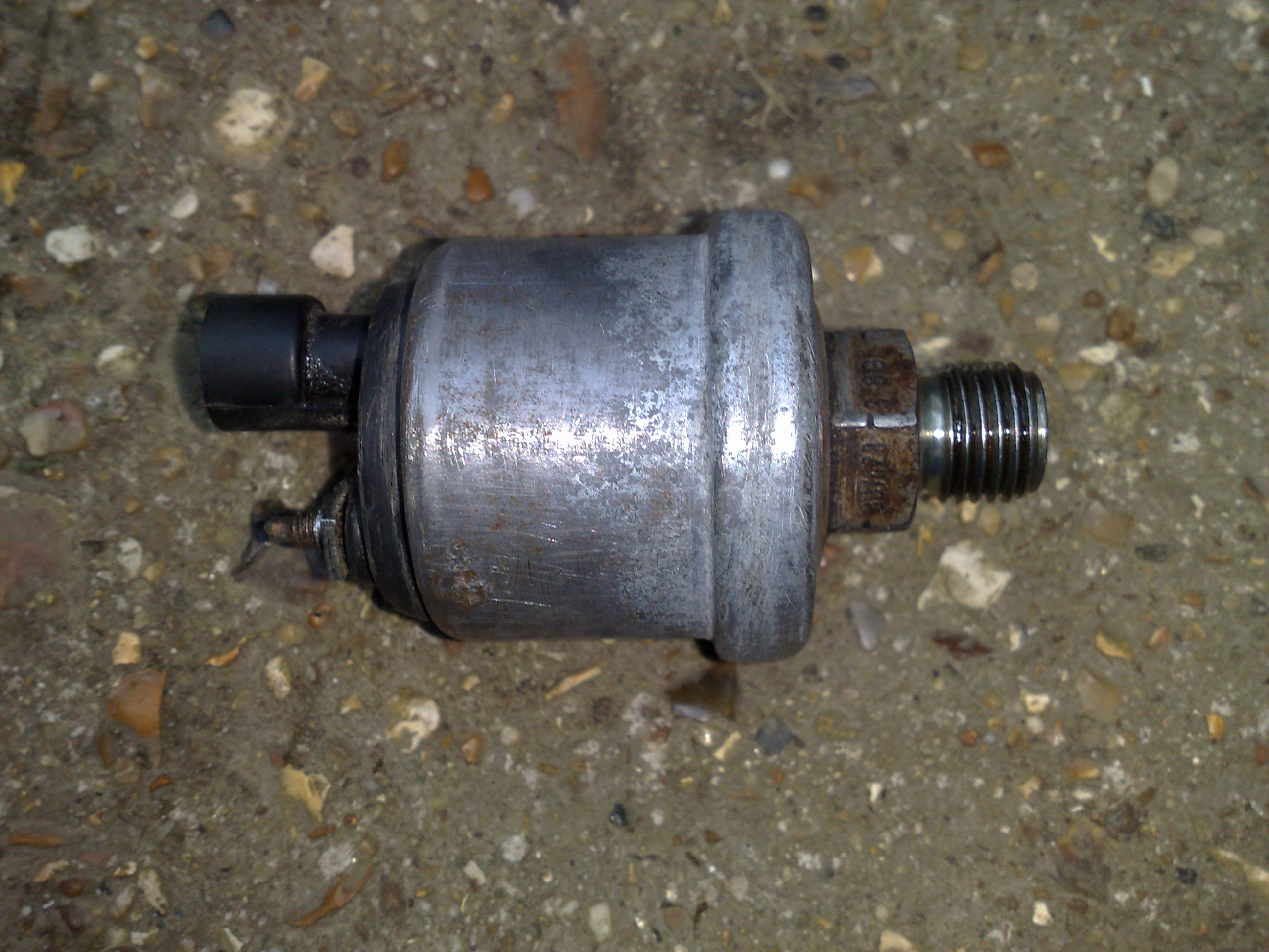

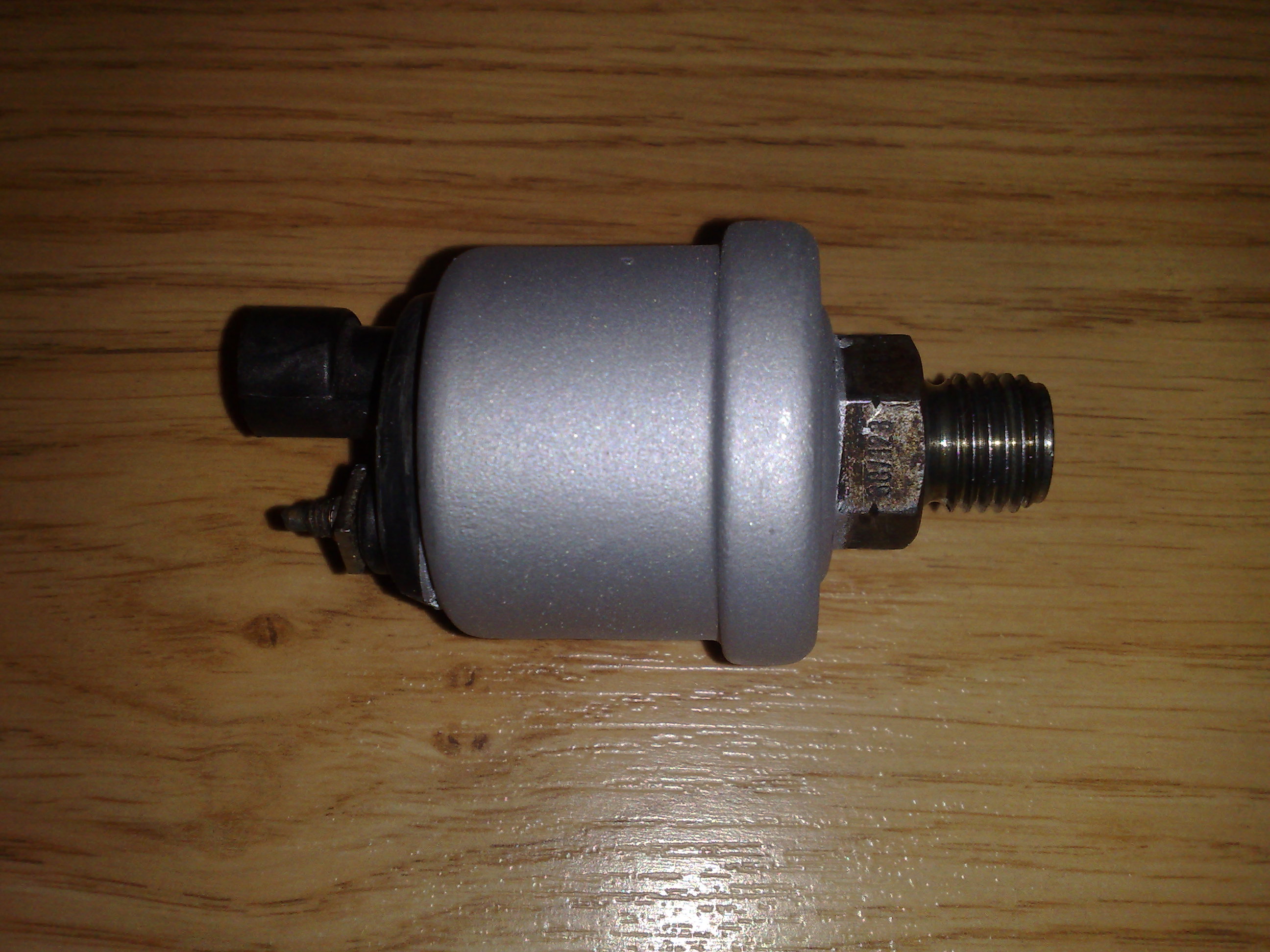

My eye caught the oil pressure sender looking brown and bit pooh-y (sp?). So I ran to Le Garage and got all the materials and started on it with the small amount of daylight left.
https://images2.imgbox.com/1f/29/4SbOCaNL_o.jpg
^ Looking like crap. Gave it a nice rub down with some hardcore emery cloth and some 600 wet and dry. Then gave it a wipe and it got to this state \/
https://images2.imgbox.com/5f/94/Jdfadl78_o.jpg
Then masked it up and gave it a few coats of my favourite VHT aluminium paint.
https://images2.imgbox.com/e3/04/XbbQ7GoI_o.jpg
Ahhh... feel better now, matches the rest of the engine bay.

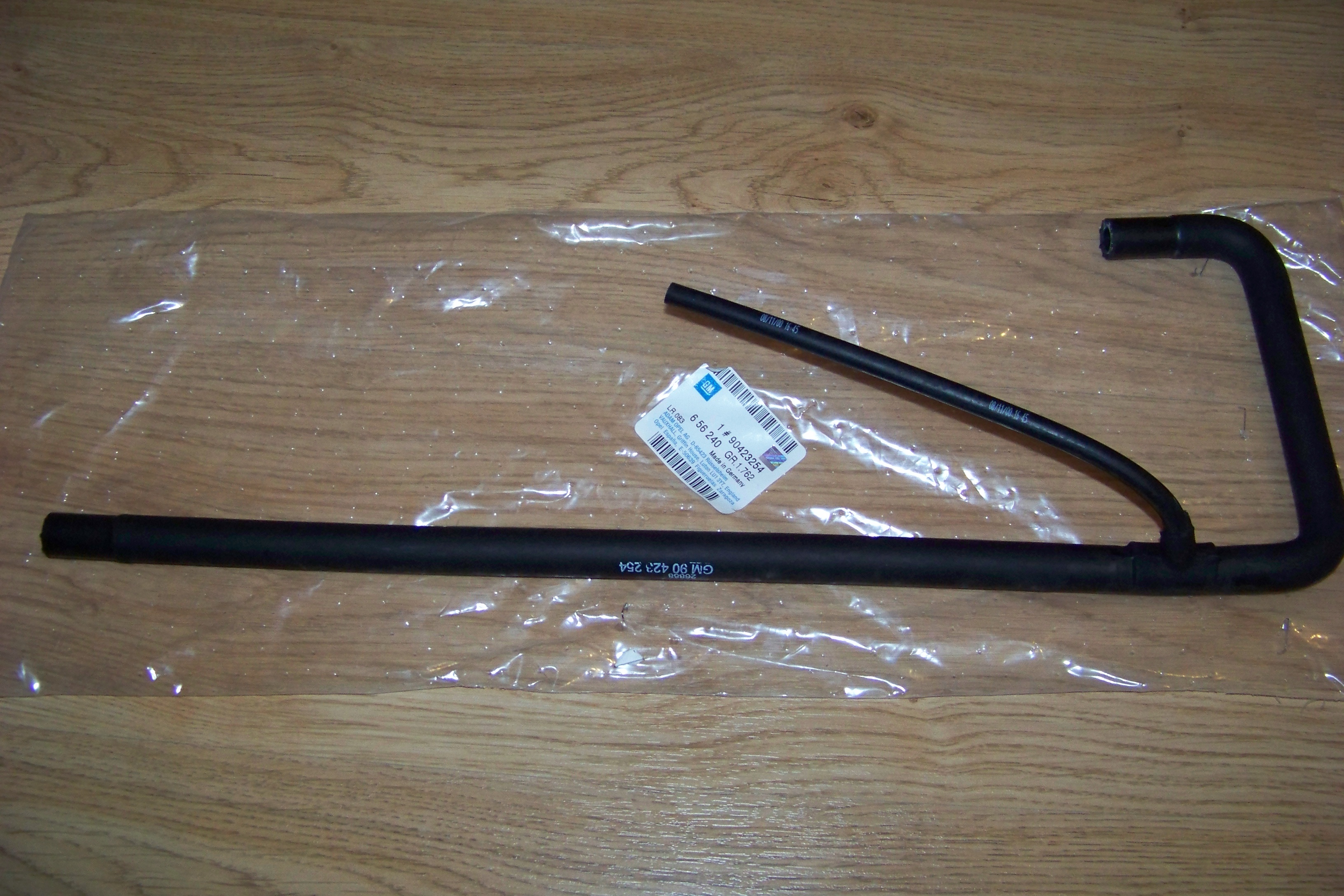

This morning, I made my way down to Vauxhall to ask a few bits. First up was one of the hoses for the turbo. The rest were nice and new but this had split so it had to go of course. Luckily Vaux still do them. I also asked for the exhaust/inlet manifold studs/bolts but they were NLS.

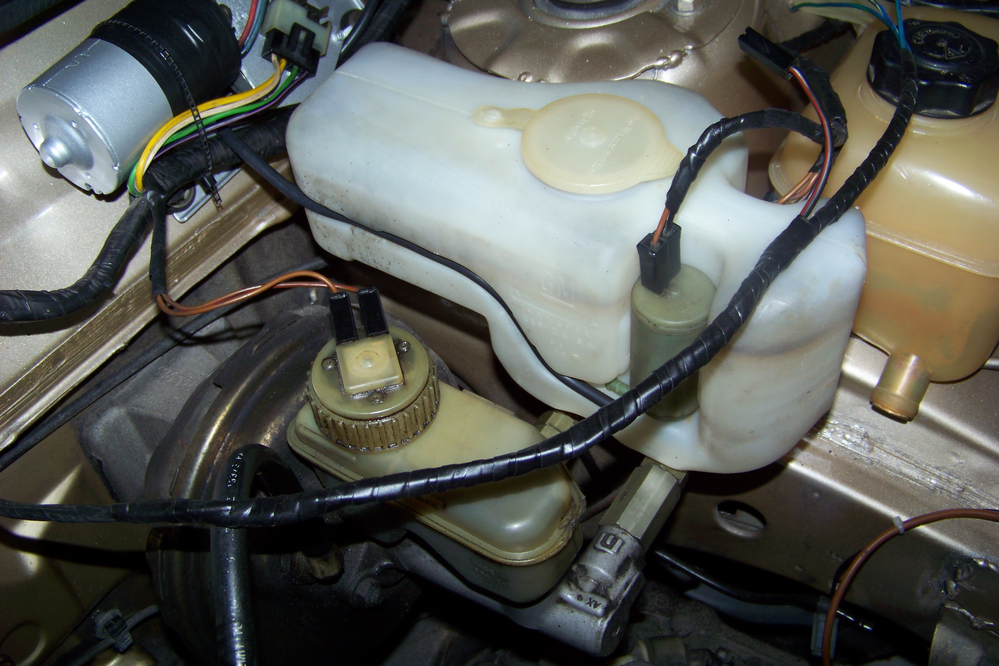

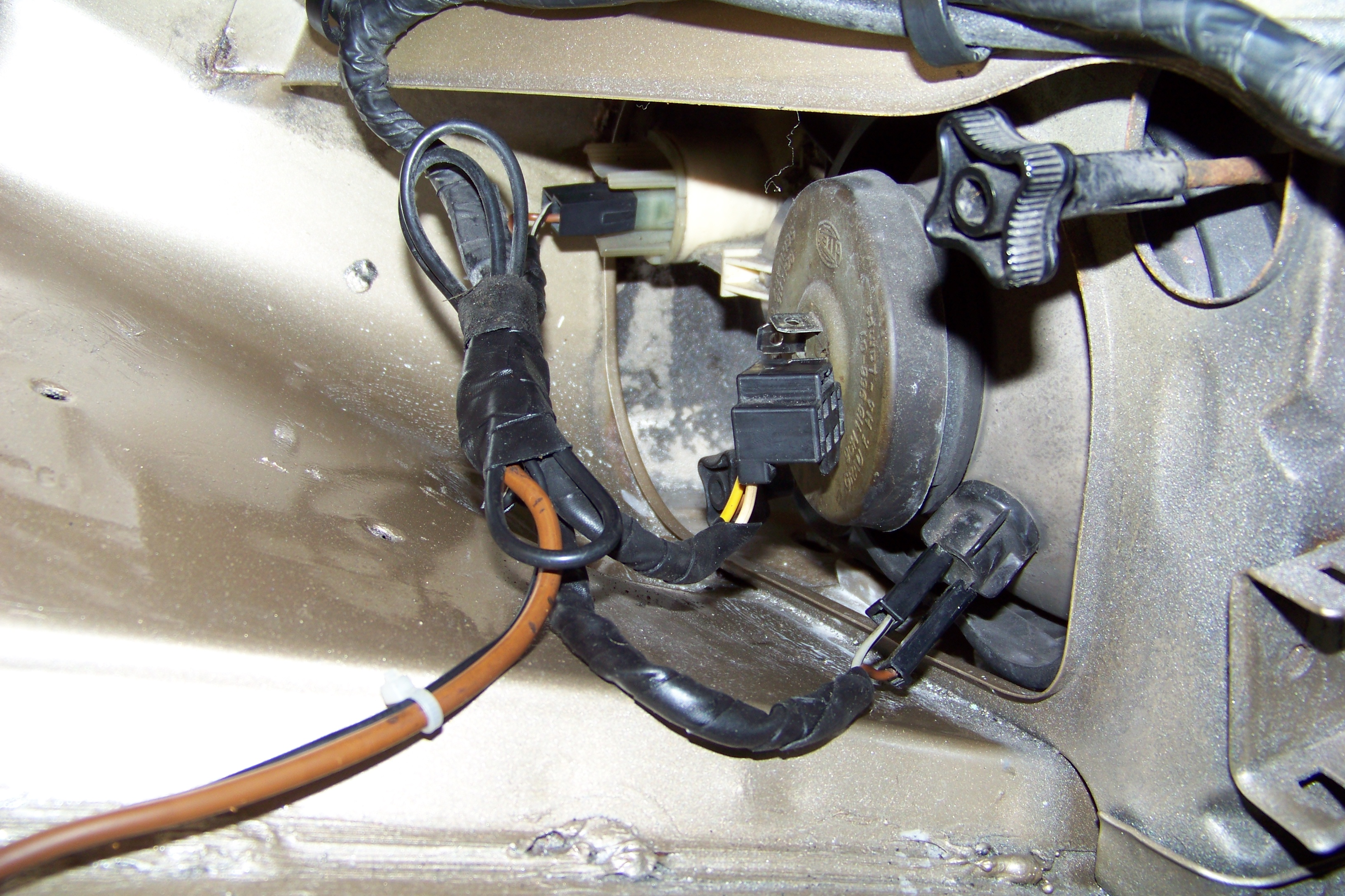

Managed to spend some time on the Nova yesterday. Made use of the good weather and fitted the rear GTE anti-roll bar and inspected the arches so I could apply some underseal. I also managed to rub down and coat the rear beam but due to a flat battery on the camera, I was unable to get some pics.

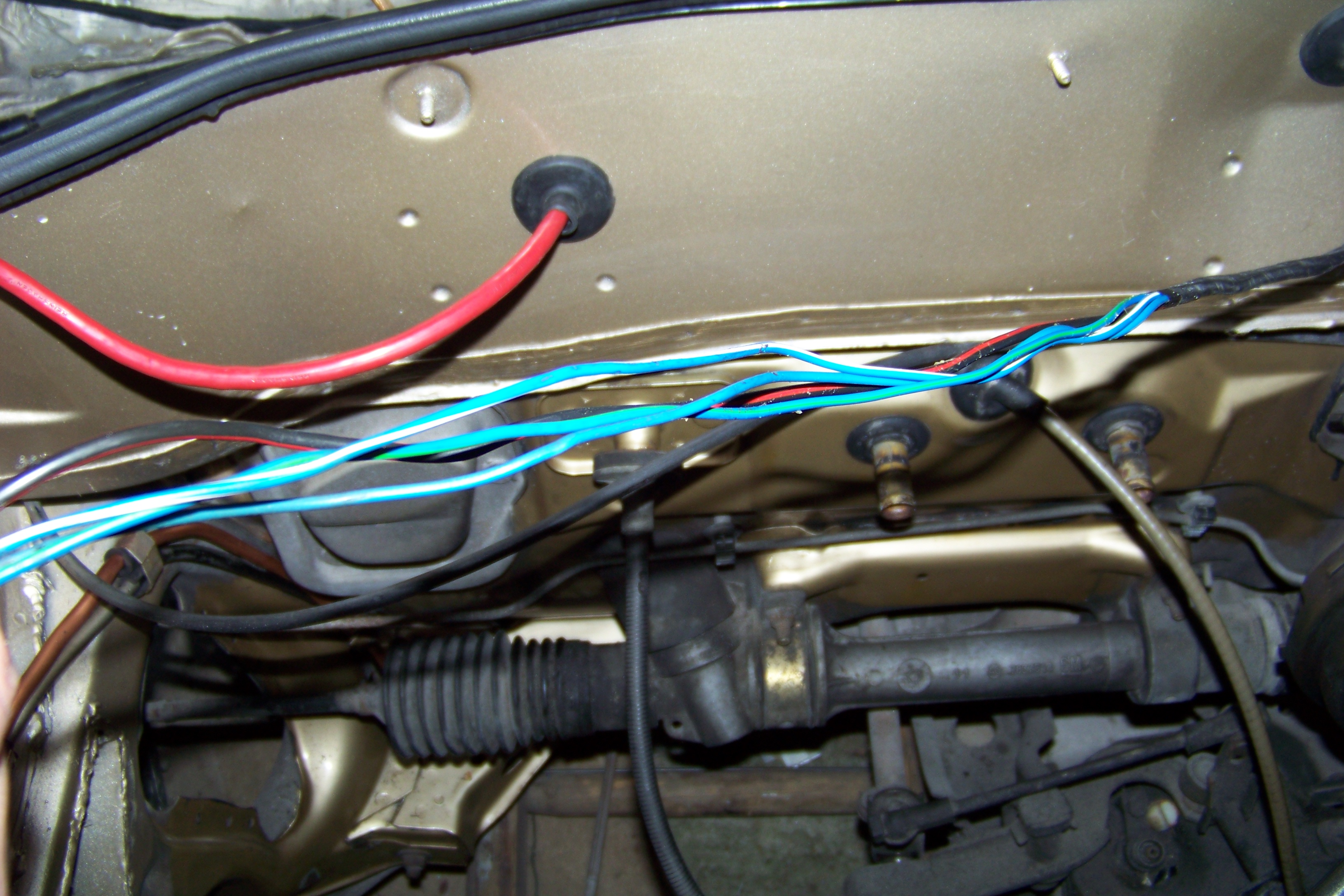

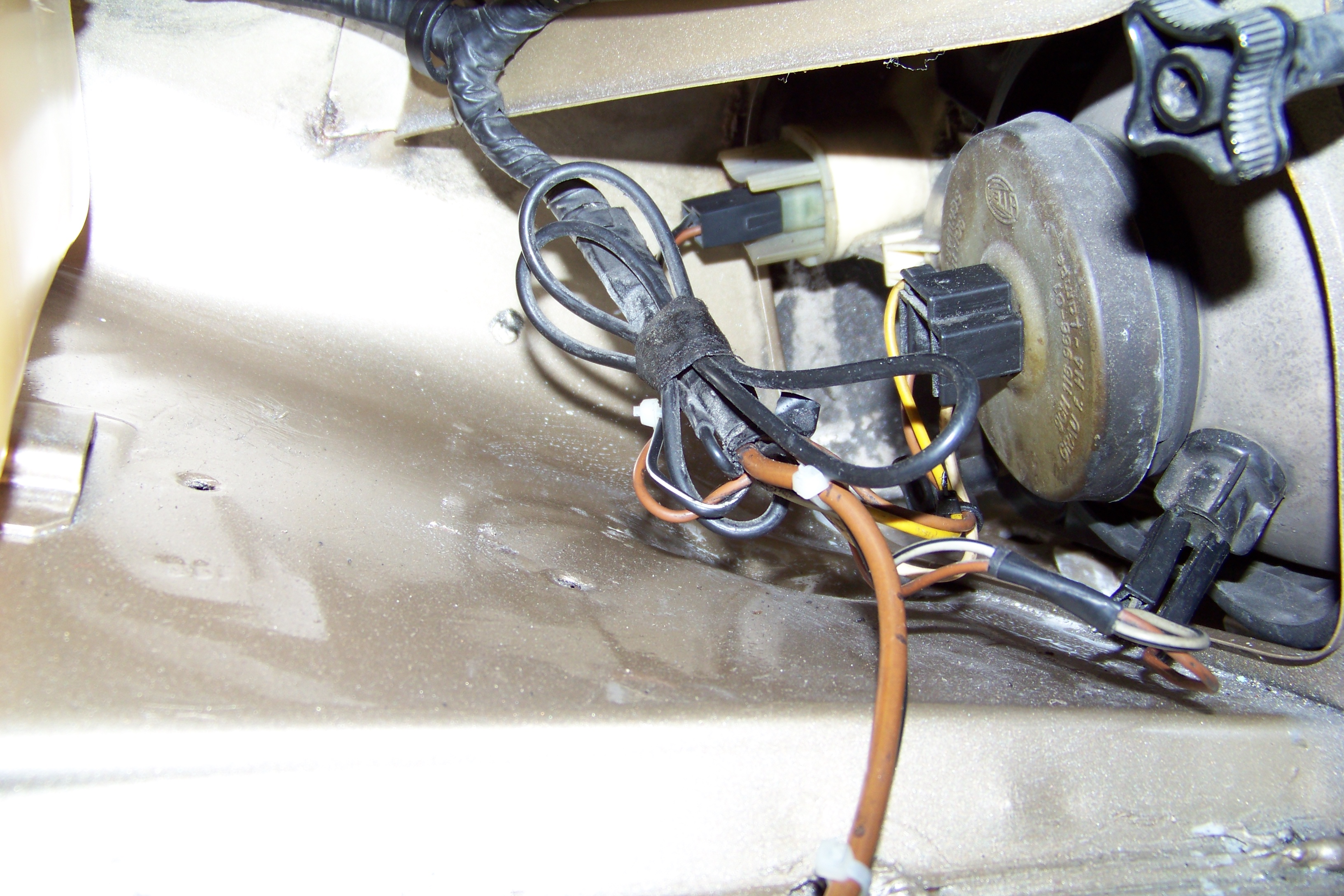

Early evening, I had some time to do some work on the loom in the engine bay. Some wires were exposed (not protected in anyway) so with the amount of self amalgamating loom tape left I went to work.
Not much describing needed so I'll let the pics do the talking (yeah I know... engine bay not looking too clean. Lots of dust, underseal overspray. Will be giving the bay a good going over with some polish when I've done all I need)

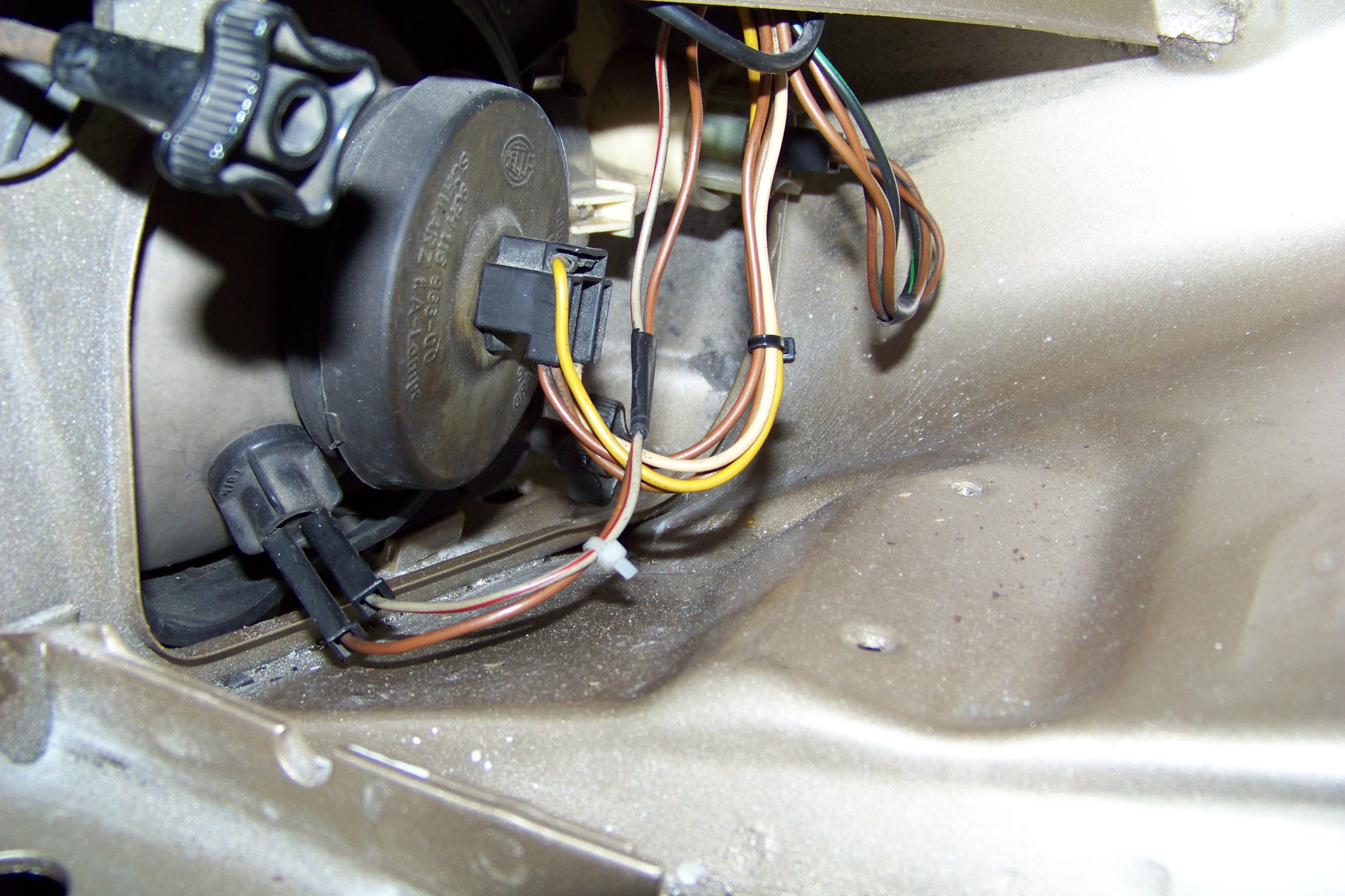

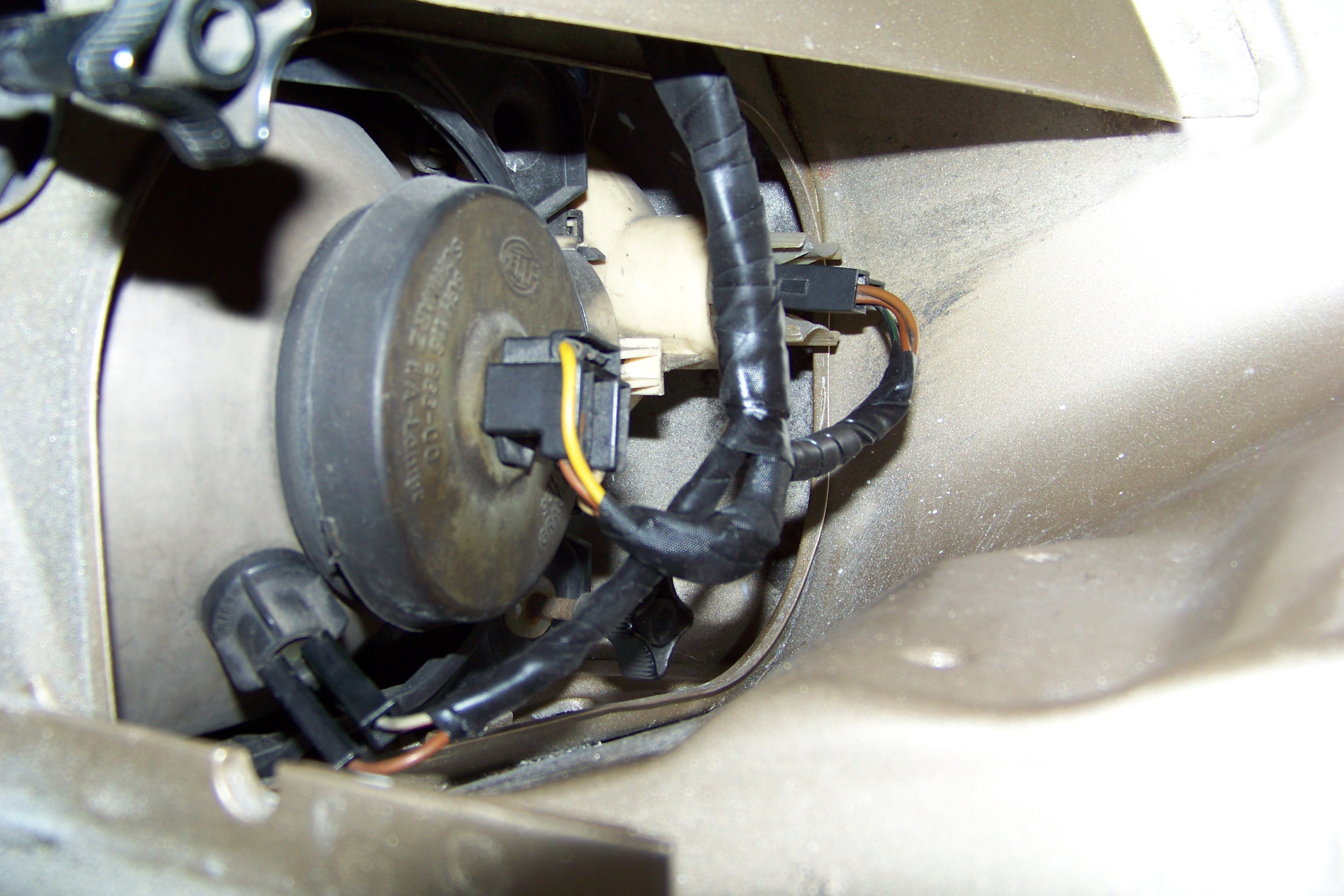

First up behind the headlamps, probably the first place at the front of the car that'll get wet so that got sorted:
Before
https://images2.imgbox.com/e0/83/Jt9YdqVY_o.jpg
https://images2.imgbox.com/f3/18/rXtYumvc_o.jpg
After
https://images2.imgbox.com/d2/9e/flOmwNI3_o.jpg
https://images2.imgbox.com/f0/51/hCoN5ROA_o.jpg

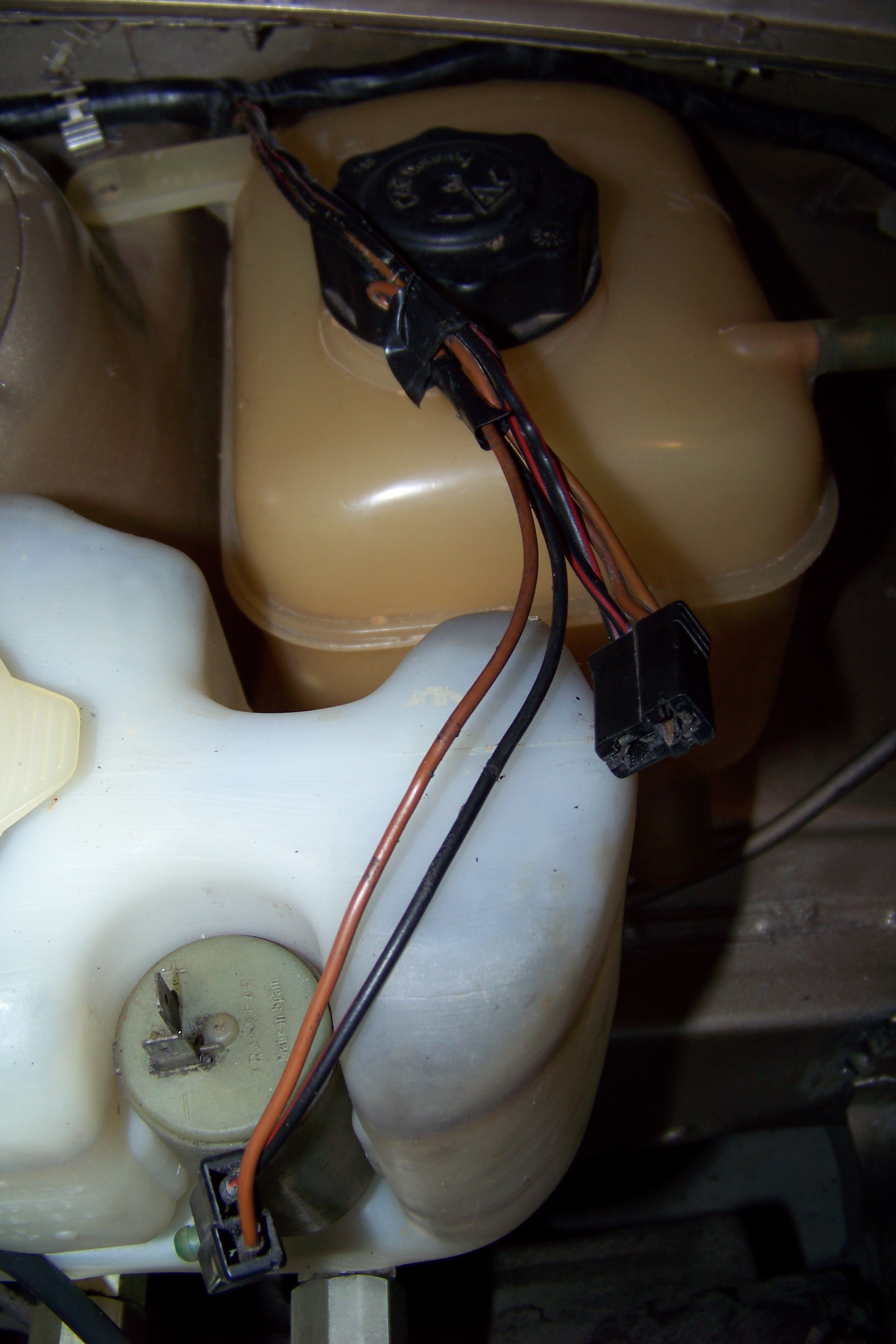

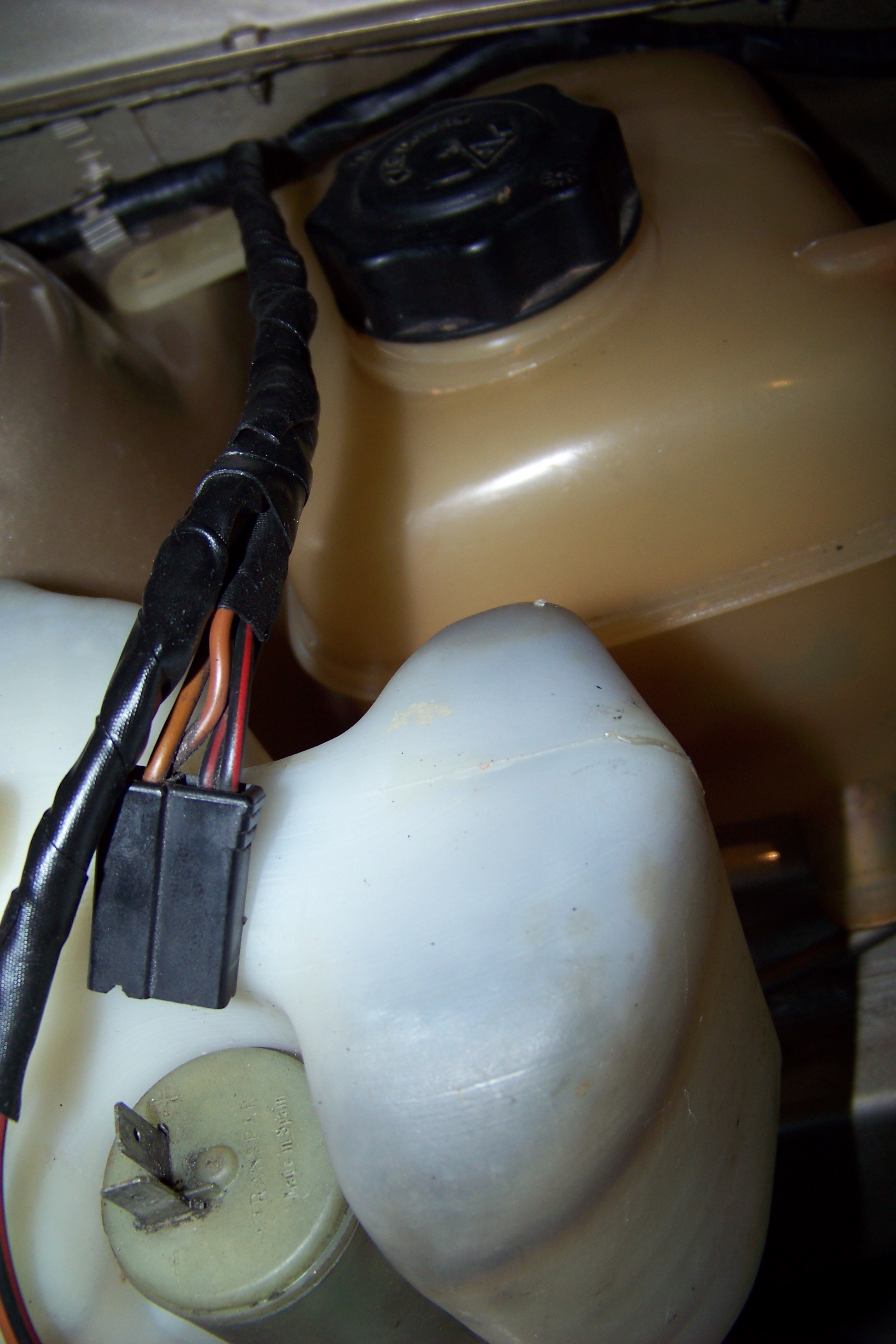

The washer bottle wires were looking sorry for themselves:
Before
https://images2.imgbox.com/07/2d/AJbWNxA2_o.jpg
After
https://images2.imgbox.com/f7/a1/cdNofHfy_o.jpg

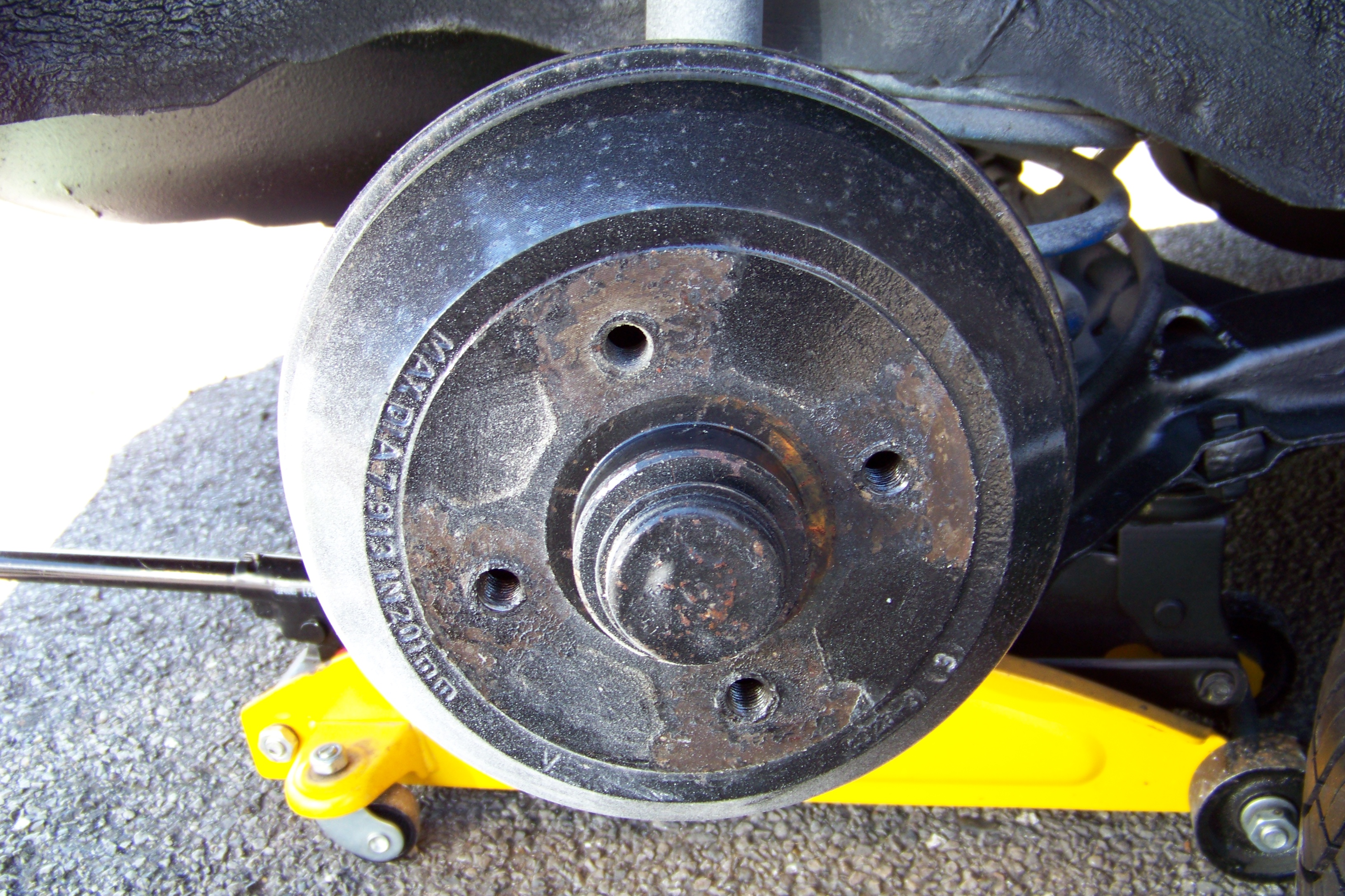

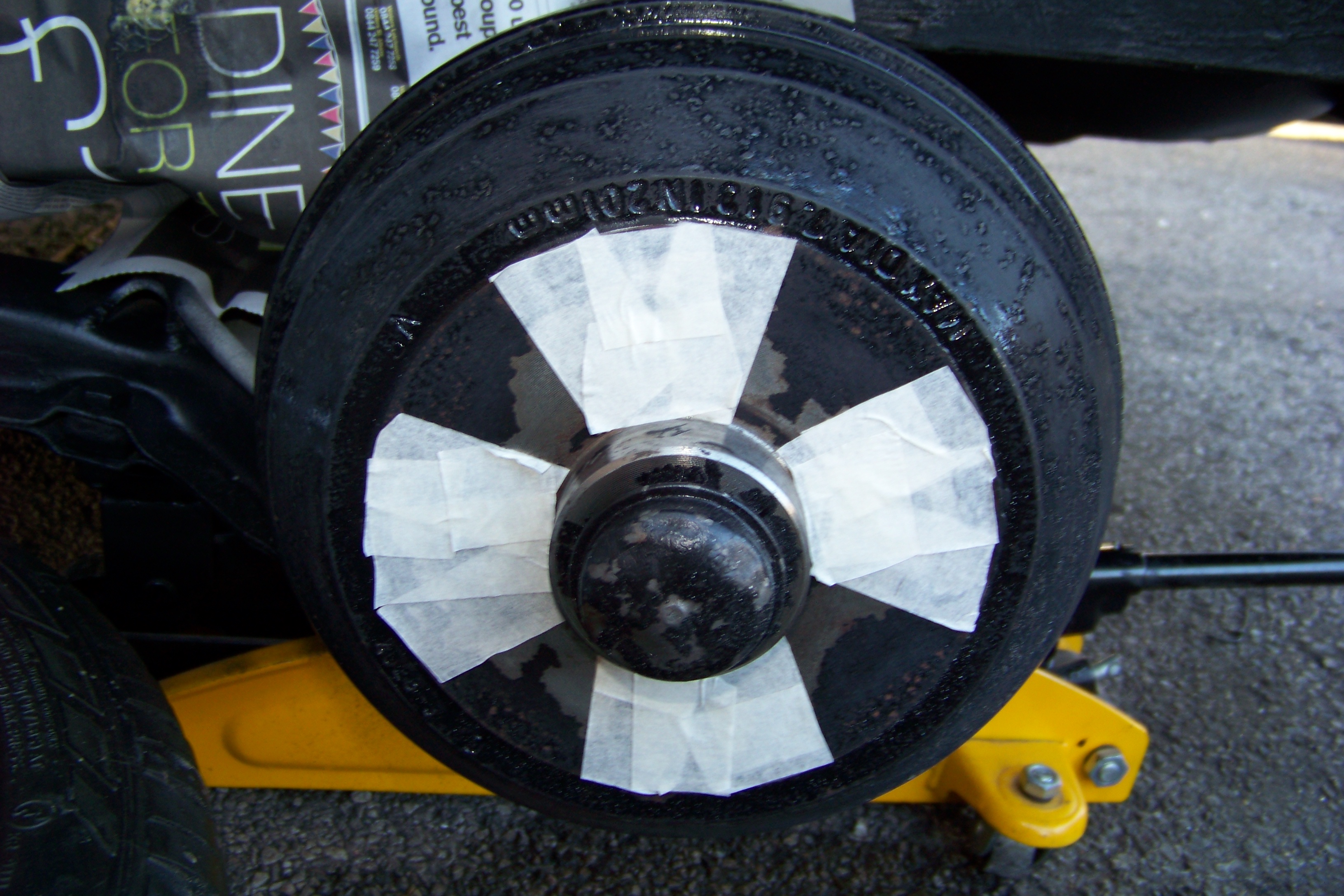

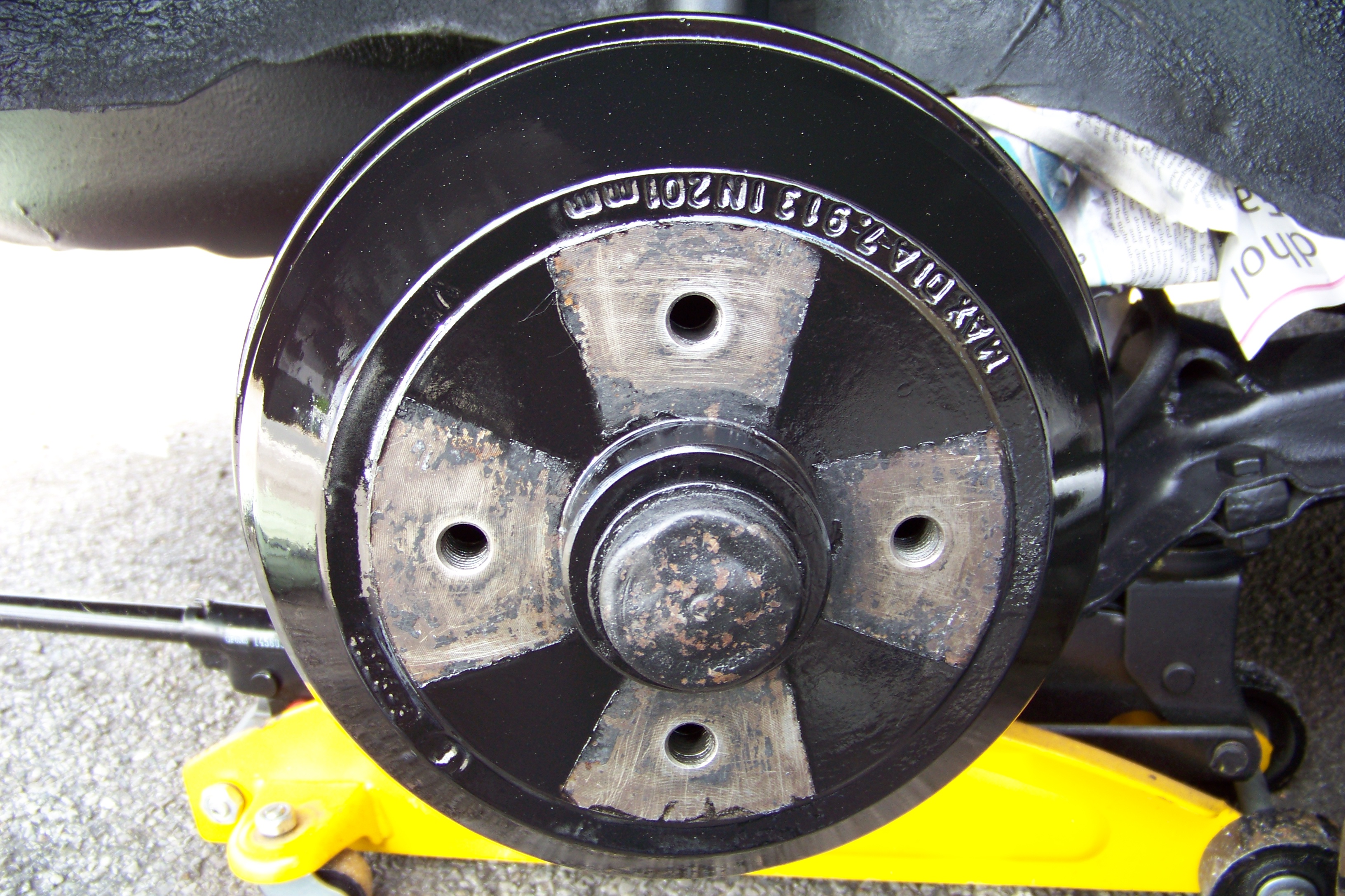

As the rear wheel was off, I saw the hideous site that was the rear drums. The had dirt, overspray and started peeling. Got to business sorting them out.
This is how they began
https://images2.imgbox.com/b6/a0/kQkBT8Qb_o.jpg
After a rub down and masked up
https://images2.imgbox.com/de/c0/1QZaQPUf_o.jpg
and after a couple coats of satin black and laquer
https://images2.imgbox.com/04/e5/fvC6OgPJ_o.jpg
I need to fit my calipers, discs and pads on the front. I tried getting the original calipers off but ended up bending the wrench. They're fused on Gonna try attack them again.

The turbo hose I ordered last week from Vaux actually arrived at my door today. A lady from the dealer turned up with the parts, what service!
Here's the hose:
https://images2.imgbox.com/38/68/w9NN7g1T_o.jpg
Then the postman left this, got it off Nick J from here (cheers pal) Sump pan oil level blanking plate:
https://images2.imgbox.com/09/5c/xF2QjUtm_o.jpg
I then went and picked this up from the Royal Mail local sorting office as they tried delivering it the other day when no one was at home.
https://images2.imgbox.com/60/f8/Bvh8eykj_o.jpg
8v sump baffle, got it off eBay for a good price. Have a few things to sort out, hoping to get some more stuff done later on.

For some reason I started tiding up the garage and came across a box of miscellaneous bits for the Nova. Went through a few things to see what was usable and what needed chucking.
Found a few coolant hoses together with fuel hoses and a whole load of nuts and bolts. So guess what... yeah I cleaned them!
These were the coolant hoses
https://images2.imgbox.com/6c/e3/pyAeXrPK_o.jpg
On the face of it they look like they need chucking but only one of them did and that's the rad to thermostat hose due to this
https://images2.imgbox.com/56/af/sNixMgBw_o.jpg
^that one is actually made by Pirelli!
The other's were fine and it was time to wash it... wash it with Fabreeze... only kidding! Here they are after a good scrub and rinse
https://images2.imgbox.com/a4/1a/Fvax4xKk_o.jpg
Cleaned up all the jubilee clips too so everything now is lovely and new looking.

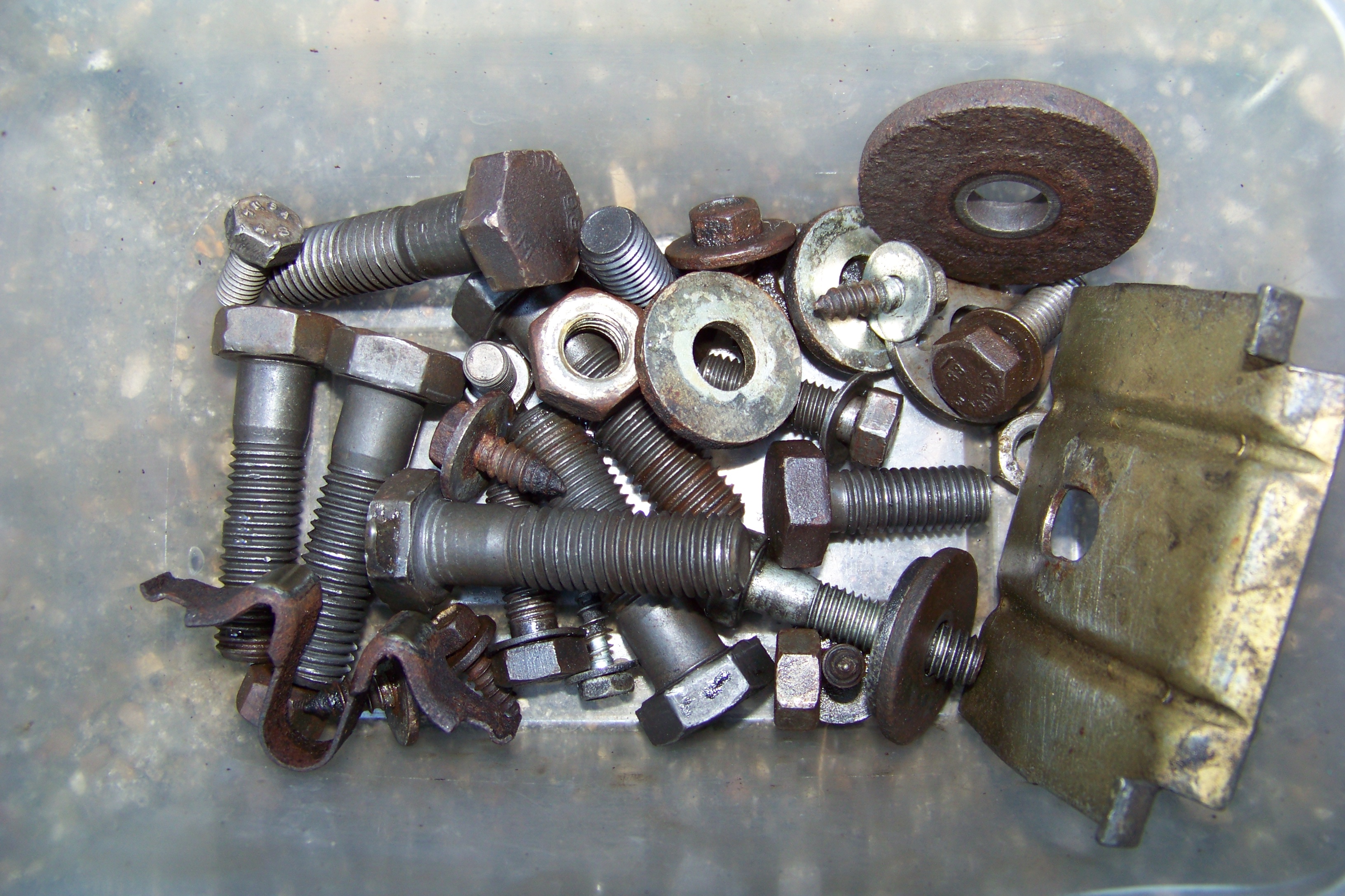

The box of nuts and bolts were in a right state, literally looked like someone took a dump on them. Left them to soak in detergent and then scrubbed them up. They look much better but I'm wondering what to do with them.
Here's how they stand
https://images2.imgbox.com/86/2b/14PgCmRj_o.jpg
Doesn't look super but trust me they're so much better than before.

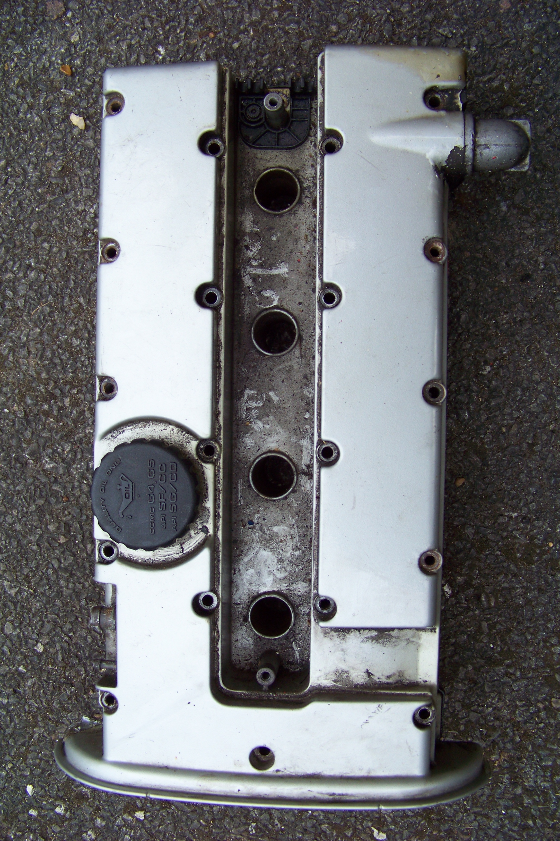

Made another trek to Vauxhall in the morning as I forgot a bit I needed. I was quoted £20 for a rubber hose from the crankcase breather to the Cam cover :eek: Asked about a crank sensor and that came up £93. Asked about the cam sensor and it wasn't listed.
Anywho, come home with the weather being crap and thought I'd work on something that was doable inside. Whipped off the rocker cover to
1) strip the paint and 2) to check see what the cams were like. Didn't know what to expect really, was kinda expecting a bit of surface rust on the cams as the engine wasn't used for a while by the last owner, and some old worn cams a, let's face it it's a 15 year old engine, but I was pleasantly surprised at the sight:
https://images2.imgbox.com/9a/7a/HFJoXX7g_o.jpg
Cams clean and smooth, no sign of any corrosion at all not even surface, everything looked fine. Compared to what I've seen with some engine before, I was quite pleased.
The cam cover is in ok condition with some peeling of paint where the rocker breather pipe is.
https://images2.imgbox.com/68/49/KD4E3npB_o.jpg
Firstly I gave it a scrub with detergent
https://images2.imgbox.com/c0/30/LLINowHO_o.jpg
I then thought about how I was gonna do it, lots of tight areas on the rocker which would be a royal pain to strip paint from. The area under the spark cover is clean and good so I decided that only the top part would need stripping. So I masked off the areas I wanted to strip
https://images2.imgbox.com/83/ad/bDwVEoR3_o.jpg
I applied some nitromoors and as I was using the wire brush attachment, I thought 'I've been here before'... trying to strip paint off the fanblades. It was so time consuming to get off that I stopped half way and thought 'f*ck it, I'm getting this sandblasted'
Gonna go drop off some bits tomorrow to a small place that does blasting, will gather a few other small bits together and get them done too. Just wondering if ABS plastic can be done too.
im pretty sure no plastics can be blastedQuote:
