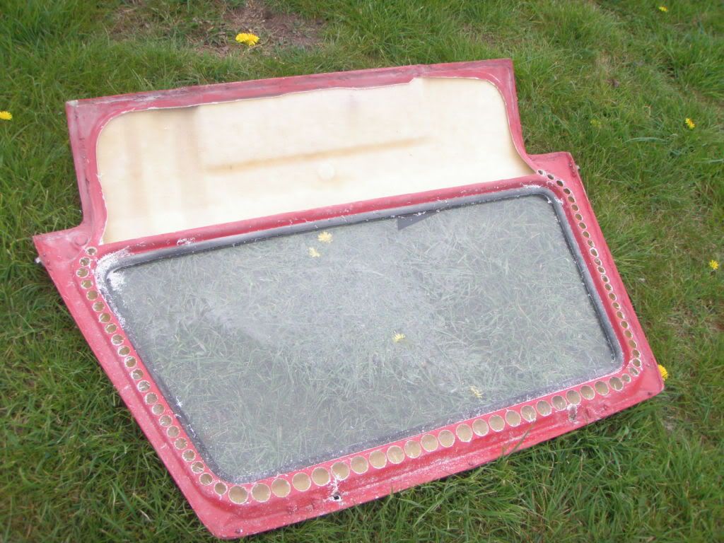

The doors are only skins, so probably only the passenger side will be of use, but it is really light. I'll have to sort something else out for the drivers side;
http://i285.photobucket.com/albums/l...ort/002-31.jpg
http://i285.photobucket.com/albums/l...ort/003-34.jpg
http://i285.photobucket.com/albums/l...ort/004-29.jpg
http://i285.photobucket.com/albums/l...ort/005-24.jpg
Hinged window and jump in dukes of hazard stylee lol
