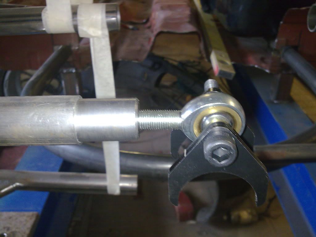

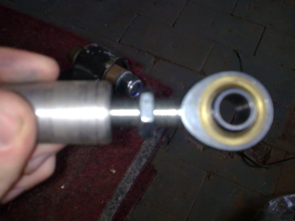

On the opposite side of the wishbone's there will be 4 M12 fine rose joints. In order to mount these rose joints i had to make 8 slugs with an M12 fine thread down the centre.
http://i227.photobucket.com/albums/d...fineinsert.jpg
These will be pushed down the CDS tube and puddle welded:
http://i227.photobucket.com/albums/d...sertpartin.jpg

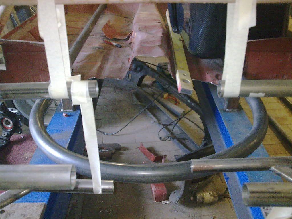

All the rose joints are going to be mounted on on 2 hoops that run in the centre of the car. Wev had 16 tabs cut that we will weld onto the hoops, these will hold the rose joints. More to come wth the hoop's hopefully will get them bent up this weekend.
My mates bent the hoop that runs the length of the car, these pick up at the front on the front wishbone mounts. The hoop is where the tank will sit. Very low and central.
