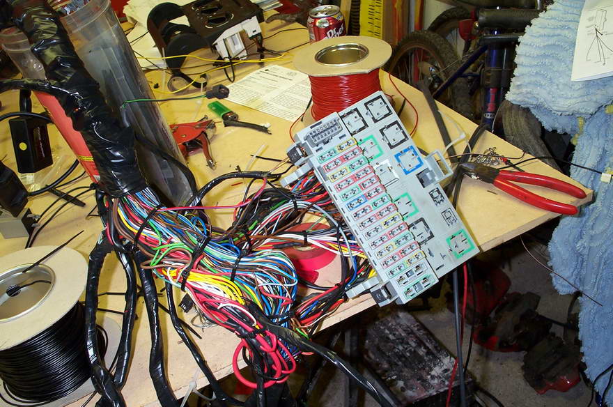

Not much really been happening here that you can see. I have now finished the loom and retaped it all up.
Its been a bit of a major job (like I haven;t had any of those with this rebuild!!) as I have :-
- installed a new corsa fuse box which has given me extra relay points and fuses
- put all the wiring in for the nos system and progressive controller
- re-routed the offside headlamp wiring round the back of the bulkhead
- wired in all the alarm , immobilser, total closure and carjack system
- wired up the ignition swich and starter through relays in the fuse box
- mated all the nova plugs up to the corsa equivalent so they fit straight on to the swiches
- wired in the EPAS power steering
these were the main jobs - also had to sort out some bodges I had made to the wiring loom about 10 years ago & removed the old alarm
http://www.elsamak.karoo.net/LOOM2A.JPG
Next job - sound proofing the floor and panels then wayoyl
Joff
