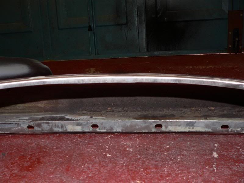

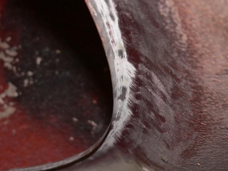

in preperation for respraying the front two wings and bonnet again tomorrow, i shaved the lip off the wings completely, so its left with a vertical edge, rather than a horizontal edge (| instead of L) so should my tyrewall touch (which it will) it will only rub up against the metal, rather than the metal digging in.
i took a few pics anyway despite not doing much lol
the side lip that needs to be removed
http://i136.photobucket.com/albums/q...ure/nc1060.jpg
front edge is most important due to how far forward the wheel sits
http://i136.photobucket.com/albums/q...ure/nc1061.jpg
gonna do the rear part anyway so it looks the same
http://i136.photobucket.com/albums/q...ure/nc1062.jpg

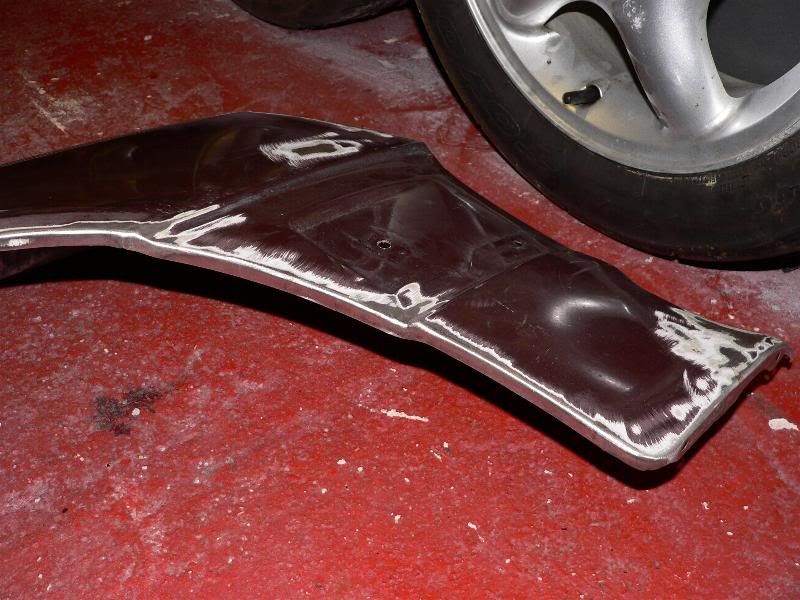

inside
http://i136.photobucket.com/albums/q...ure/nc1063.jpg

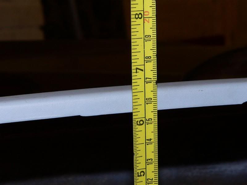

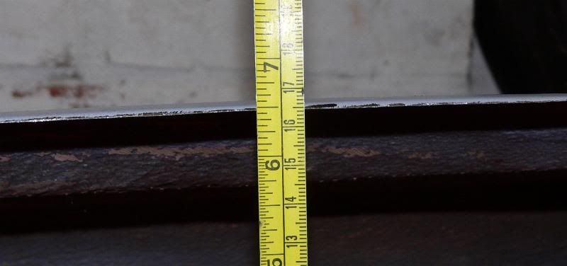

with the wing lying flat on the floor, the leading edge is 15.5cm from the floor, after the trimming i'd have like to gain the full 10mm as you can see thats where the outer edge is
http://i136.photobucket.com/albums/q...ure/nc1064.jpg

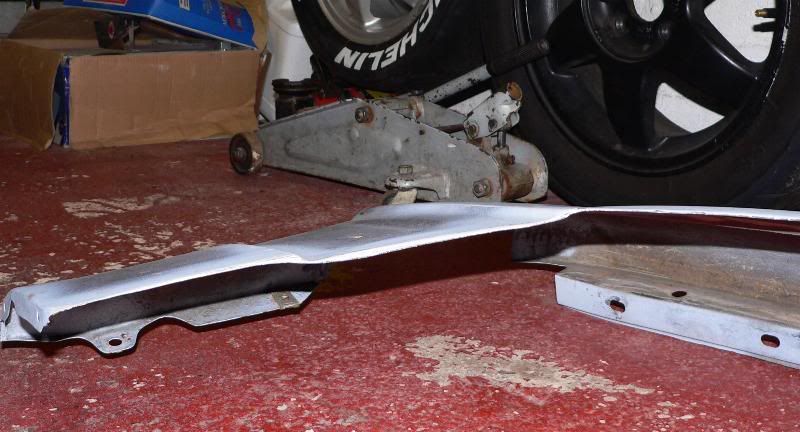

all done
http://i136.photobucket.com/albums/q...ure/nc1065.jpg
leading front edge
http://i136.photobucket.com/albums/q...ure/nc1066.jpg

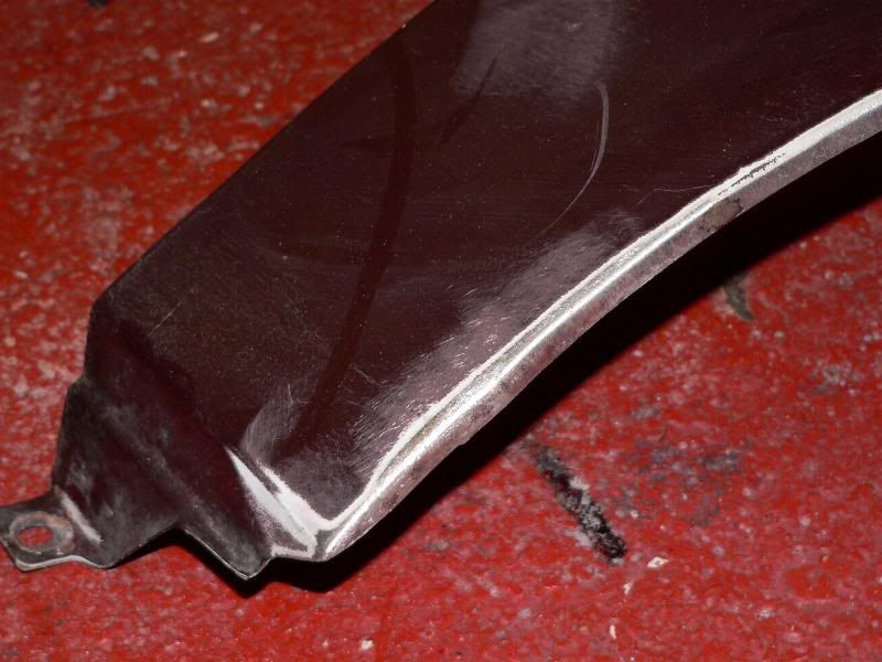

outside
http://i136.photobucket.com/albums/q...ure/nc1067.jpg
w000t, 16.5cm now, so another 10mm gained
http://i136.photobucket.com/albums/q...ure/nc1068.jpg

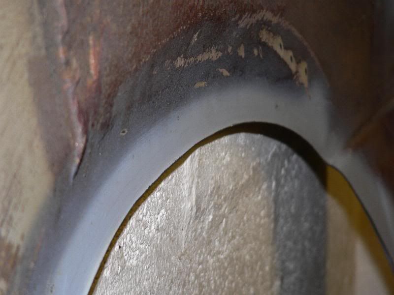

sprayed the insides gloss black, filed down all the edges so they're smooth
http://i136.photobucket.com/albums/q...ure/nc1069.jpg
mmmmmmzzz
http://i136.photobucket.com/albums/q...ure/nc1070.jpg
