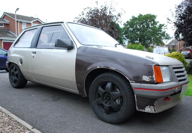

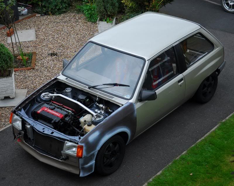

So tonight was the first step to my Novas new look, and also the beginning of me lowering the COG, I had sourced some saloon front wings, from no-one better, no other sexier brown saloon... James (Count Vaux Alot) - nice to meet you again chap.
So prior to James turning up, we had a pretty standard looking Nova

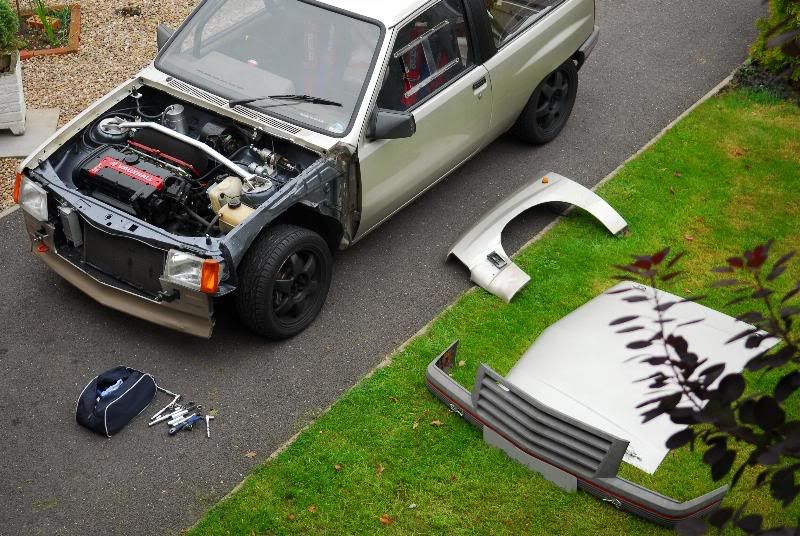

10mins late were half way there
http://i136.photobucket.com/albums/q...ure/nc1051.jpg

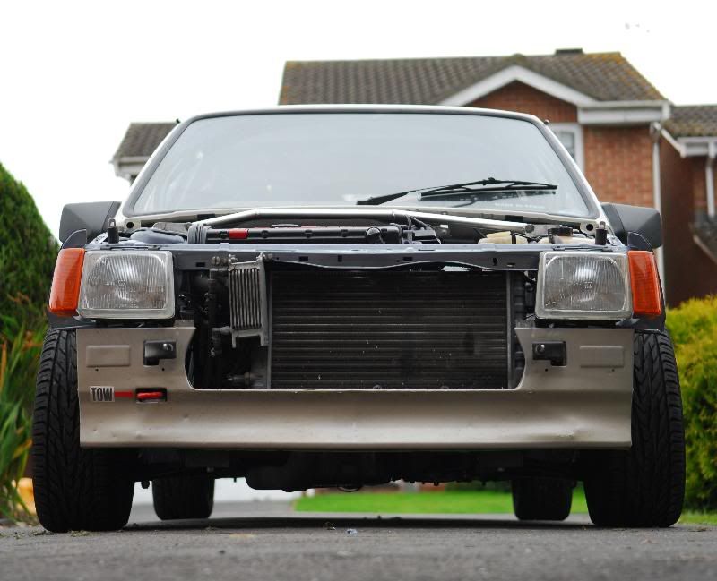

Off with the front wings, ready to trial fit my round ones, to give me extra clearence so I can drop it a little more... wingless wonder
http://i136.photobucket.com/albums/q...ure/nc1052.jpg

Then James arrived, no sooner than me getting the camera out
http://i136.photobucket.com/albums/q...ure/nc1056.jpg

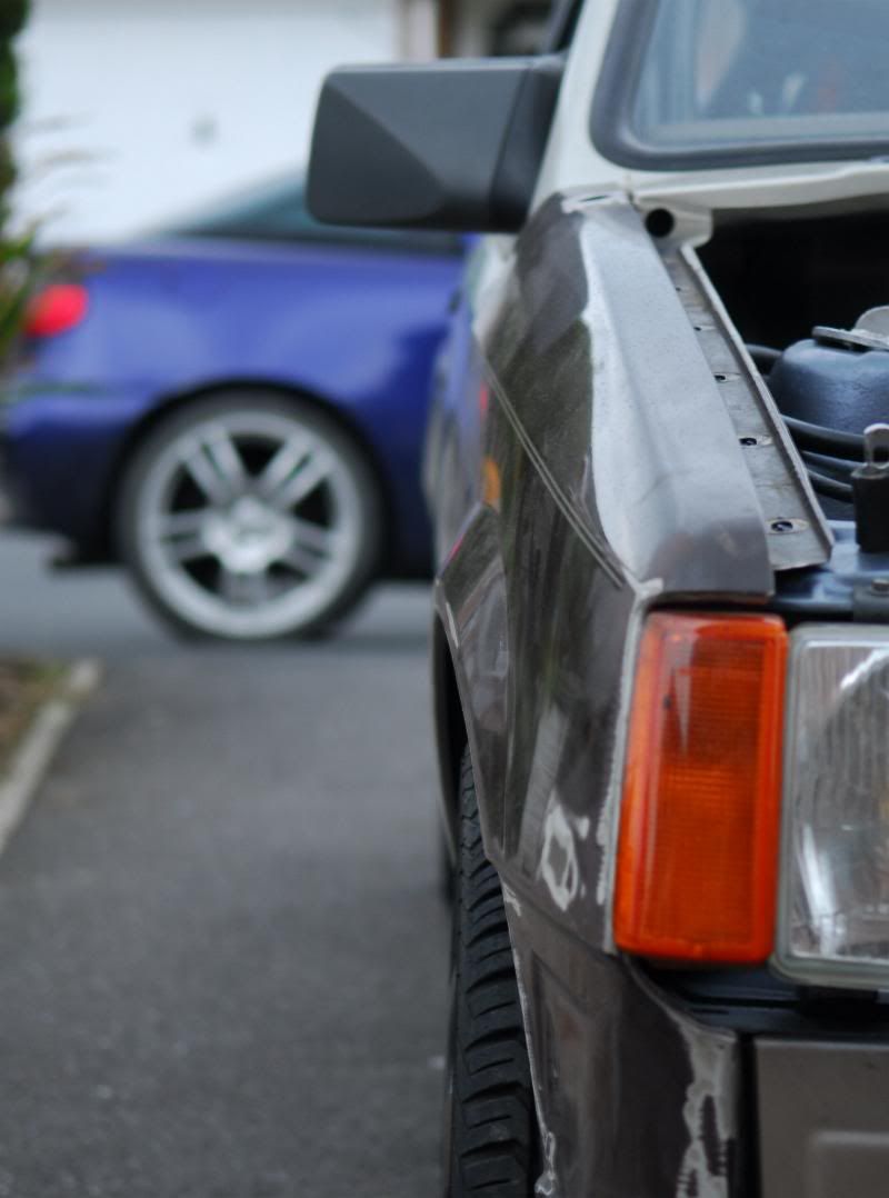

This front clearance should see me a further 2" drop I reckon, which is 50mm or there abouts

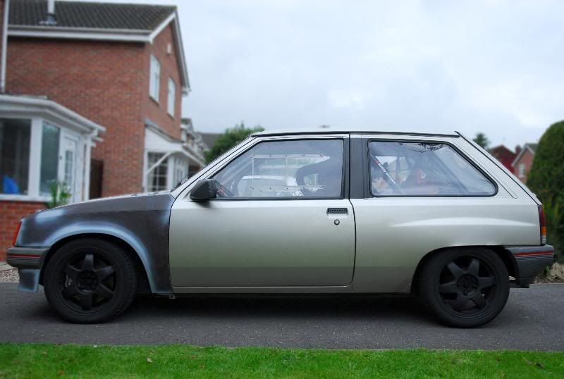

New look
http://i136.photobucket.com/albums/q...ure/nc1058.jpg
Side on
http://i136.photobucket.com/albums/q...ure/nc1059.jpg

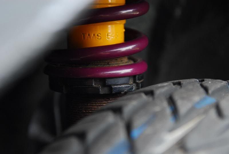

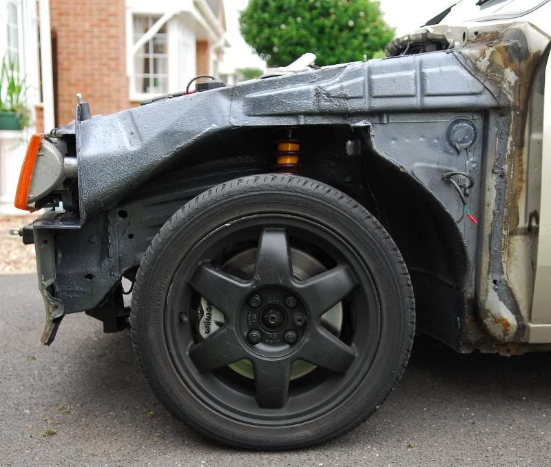

The problem I have, is that I am currently on 8", 313lb front springs, and they're right at the top of the thread on the height adjustment. Now I want to up the front poundage anyway, so no better time to do it.
Reason for this, is because of the bulgy sidewalls of the 888s, and the S9Bs the height adjuster has to remain above the tyre profile else it fouls, it is not a problem with the Rainsports as they clear.
As you can see in this pic, they're right at the top of the thread
http://i136.photobucket.com/albums/q...ure/nc1053.jpg
So my thinking is, with these new round front wings, I can now drop the car moreso, but in order for me to drop it enough, for the tyres (888s/S9Bs) not to catch, I'd have to drop it the complete profile of the tyre, which is the best part of 3 inches, or there abouts - too much.
So my thoughts are, to keep the adjusters where they currently are, and buy some 6" open length 350lb springs, which means my adjusters will stay where they are, but I have no upward adjustment... and my car will be lowered 2 inches (a further 50mm)
Alternatively, I can run slightly less camber, so the top of the tyre isn't so close to the spring.
Thirdly, I can run a 7mm spacer, instead of a 5mm to create that wee bit of clearence I am needing, then I'd order a 7" 350lb pair of springs.
For anyone that has come across these problems, or feel that they have had experience in this, and have some suggestions, please feel free to give me some pointers... not just finger in the air schnizzle!
I'm personally feeling the 7mm spacer, 7" 350lb springs to give me the adjustability up and down, should I want to/ need to change it.
But as always - would like your views.

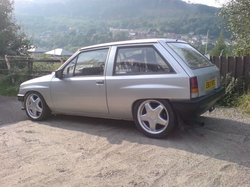

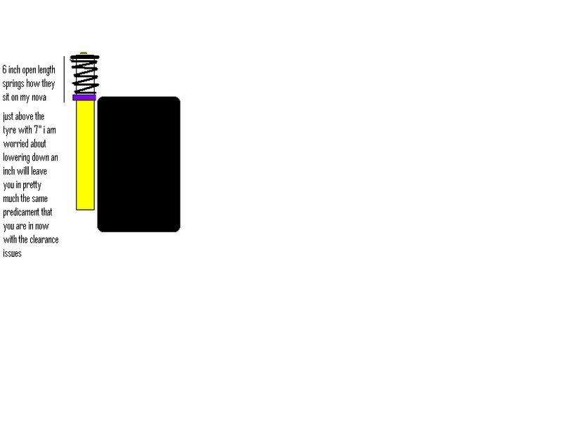

5 door arches look good imho loads more clerance! you know i am running my nova on same front shocks at max height adjustment with the 6" 350lb springs and mine is low the height you want i think!
this is how mine sit (took me ages on paint) just above the tyre and thats on 16's with 40 profile so with 15 inch and 50 profile 888's should be pretty much in same position
http://img.photobucket.com/albums/v2...nchsprings.jpg
i presume you would have to lower the 7" spring down to achieve you 2 " drop you want!
and i get no scrubbage on standard arches and on 16" wheels
http://img.photobucket.com/albums/v2...DSC00278-1.jpg
so with the bigger arches and on fatter tyres but on smaller alloys you shouldnt have a problem imho
7" springs could be an option but then isnt it goimg to be even closer to the sdie wall as its an inch lower and at the tyre wall is convex in shape so narrow at the tread and the seating line but wider and bulgier in the middle
adjusting your geometry personally i woulnt adjust it as you have got it at place where only fine adjustment are needed
just my opinion people will say different i am sure! hope the pics help back up what i have said
