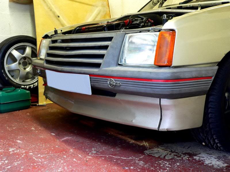

4 full sets and a spare lol
No air holes just yet, as with it being a skinny bumper, the air gets under it anyway... saying that, if i get bored tomorrow, i'll probably get the hole saw out lol

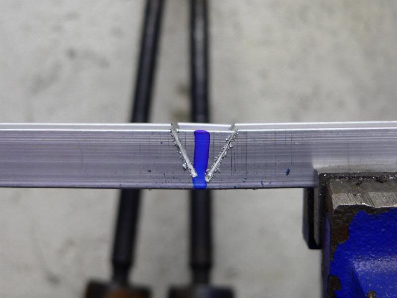

get a 1 metre length of 1mm wall alloy U from B&Q, weighed 90grams dagnabbit
http://i136.photobucket.com/albums/q...ure/nc1042.jpg

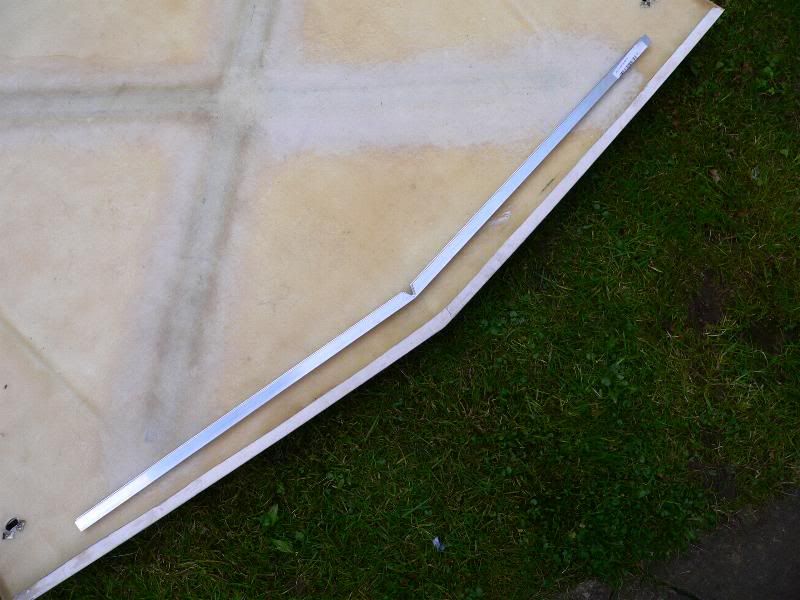

place across bonnet
http://i136.photobucket.com/albums/q...ure/nc1043.jpg
cut V out dead central
http://i136.photobucket.com/albums/q...ure/nc1044.jpg
bend to shape
http://i136.photobucket.com/albums/q...ure/nc1045.jpg
then realise that thats probably over kill, and fibreglass goes off pretty damn hard anyway, so scrap that

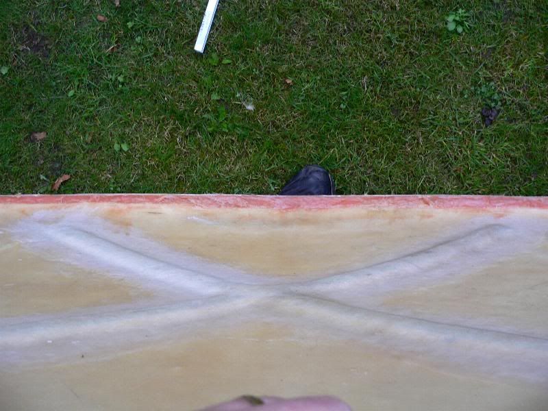

fill hollow leading edge with fibreglass resin, the complete width of the bonnet
http://i136.photobucket.com/albums/q...ure/nc1046.jpg
leave to dry (will be left a few days just to be sure, to be sure)
http://i136.photobucket.com/albums/q...ure/nc1047.jpg
lets hope that goes off dead hard and that alone should keep the bonnet from flexing in the middle now :thumb:

You scrapped the idea because you didn't want to add 90grams, go on admit it :p lol lol
Aye, the FG should be strong enough, its hard stuff when set :cool:
Mark - you git lol
Ad - lol well, not completely, altho that 90grams i didn't want to add, you're correct... but tbh, it didn't fit quite as snug as i'd have liked in the little hollowed out bit... so was a bit cumbersome...
We'll see how the rock hard fibreglass holds up, if it doesn't.. i'll either sell this one on and get a decent fibreglass bonnet... or add a 5th pin, which'll look cack, be more **** ache to get into etc
I bet something ligher, like a flat piece of plastic/perspex, then f/g over the top, would work in place of the alloy bar.
