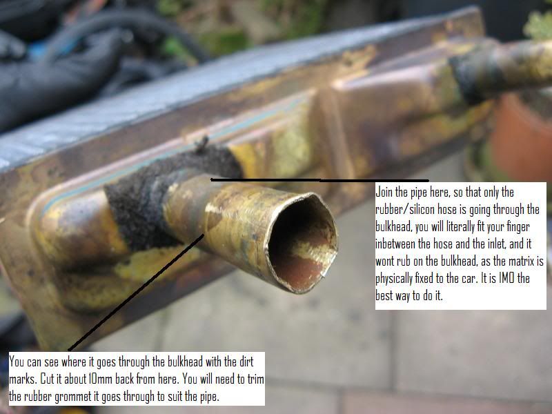

Well put my heater matrix in Friday night, and tightened up a jubilee so tight it creased the pipe in on itself. Wouldn't go back to being a circle:

Iain, the best way to do the matrix, seeing as you already have it out, is to cut the pipe further back, and put the hose on so it joins in the car, ill get you a pic:
http://img.photobucket.com/albums/v1...ednova/264.jpg
Good progress though!
Cheers for the tip Paul, I did try that initially but I wasn't happy with the coolant pipe going through the bulkhead with no grommet (was a tight fit).
The above pic with 3mm odd clearance is with a new matrix and unmodified pipes (achieved by mounting the matrix further back in the cabin) so I'm happy I can retain the flared ends to help stop the pipes coming off. :)
Dude the matrix pipes wont come off, there not under any real massive pressure etc, if i was you i would do it how Paul's said, as I'm sure you will still get enough movement to cause rubbing with it how it is now.
As for the induction pipe, I'm afraid thats how they are, if you if a brace it gets squashed in between the cover and turret, so unless you go TB's carb its something you'll live with.
I'll have to go ITBs then lol I'll leave the matrix for now tbh I feel like I'm making too much backwards progress at the mo :( Will keep an eye on it
