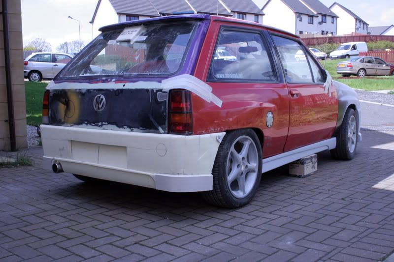

Today I are mostly be building a rear bumper...
The rear bumper will be made in a similar way to the front - a foam core overlayed with fibreglass the filler to get the exact shape. A mold will then be taken and a fibreglass bumper assembled.
As I'm smoothing my boot, the bumper will have a number plate recess and I wanted to do something to highlight the exhaust.
I started with the basic shape which is effectively one single peice of foam across the back . I had to stick a few bits on the end because the foam wasnt long enough (typical) and put a few strips behind it to build it out to get the right depth. Its about 20mm shallower than the standard bumper but is much deeper (closer to the floor).
After I'd build the basic "box" (effectively a panel across the back and sides), I cut out the plate recess and exhaust area -

I then needed to see what it looked like with my smoothed boot. So I took my standard one off and fitted the smoothed one. For reference I've decided to ditch this actual boot and will be making a proper welded one (this ones just too heavy). Did a bit of sanding and hey presto - basic bumper shape -

Atill need to tidy up angles and havent really started the sides but it's pretty much there...

Cut the whole skin off the bottom of the bootlid and weld/crimp a fresh flat sheet on, thats the best way to do it. Or cut it off and use one of them fibreglass flushing panels.

I'd only make the number-plate recess a bit deeper ?
mikey - I discovered the boot lid is actually slightly warped somehow?!? so doesnt actually close properly (hence tape at the corners)
Vaughan - plate recess is deeper than the pics show...
Ah the pics make it look shallow
Should be nice all in all once its done like :)

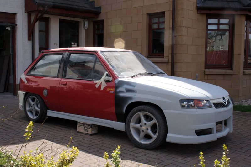

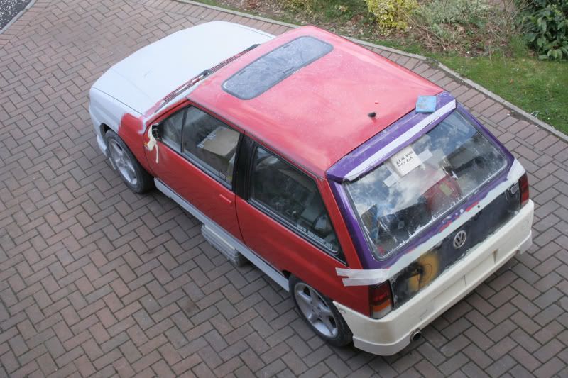

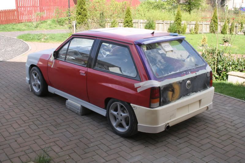

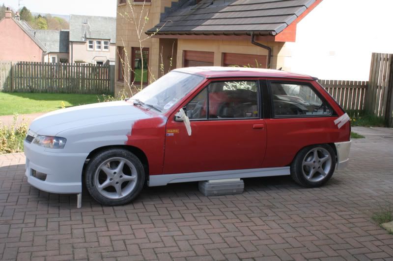

decent weather the last few days (for a change) so heres a few pics with the master parts of the kit in place. The rear bumper has now been fibreglassed and is waiting for finer detailing.
Once thats done the kit is ready for molds to be taken and then I can crack out the actual parts to be used on the car...

The main thing is the kit is all the same height so it flows around the car. That was the hardest to get right.

colour wise I'm seriously tempted by glacier white with anthracite trim... saw a clio 172 sport with a v nice body kit on way home tonight in white with black gloss trim - looked stunning (for a frenchy mobile)
The front is a work of art:thumb: . any decision on the final colour?
Was typing this as you were typing the above
Its like a baby calibra! :cool:
I think it definitly needs bigger wheels, something a bit differnt to theusual speedlines etc to go with the kit
Corsa C SRi items ;) very sqauresque, very angular :thumb:
i was just about to say something similar.....
with the car looking soo so differnet now............wheel choice will be vital wether the whole car works visually or not.:confused:
personally i'm not a fan of kitted cars.....but i doo like this......and all the effort thats went in is second to none imo.
it'll certainly need 16's or 17's on it.........but im not even sure if the old faithful speedlines would do the car justice.
i would be going through alot of photoshopped pictures of differnet wheels on the car ....before making any decisions ade:thumb:
great work though........i love this thread;)
I'd have some new style Vauxhall wheels on there - Astra SXi wheels or Tigra wheels, something like that :)

You have remembered the weight of the engine and gearbox will bring the front down arund 2 inches haven't you? lol
I dont think I've ever seen a nova without a twisted/warped boot lid, give it a bit of the old heave-ho, new hinge pins might help a bit too.
