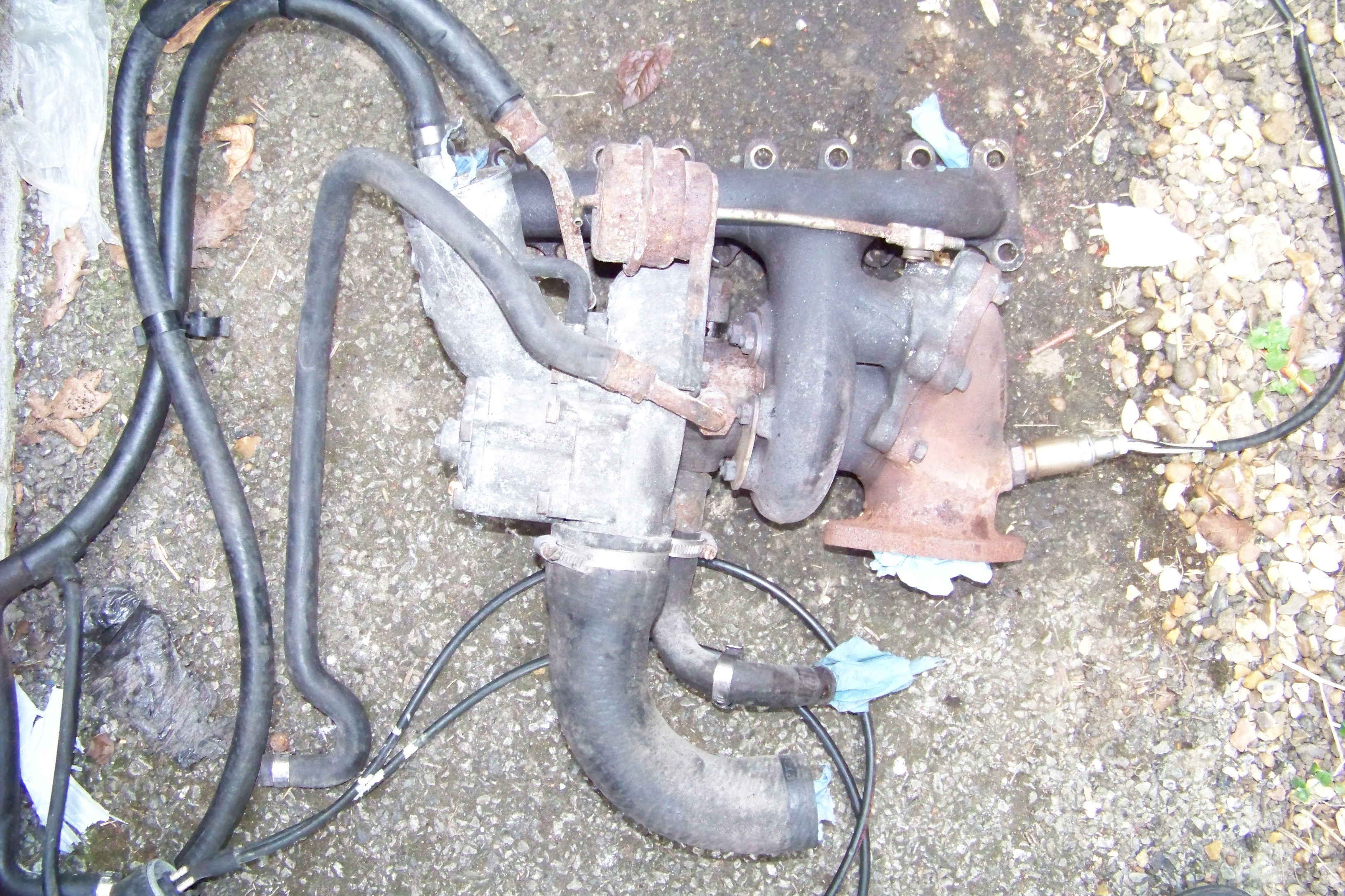

Turbo & manifold
https://images2.imgbox.com/25/63/F93Hcfj5_o.jpg
http://img4.imageshack.us/img4/113/1002093e.jpg
The turbo could do with a clean, considering if it's worth giving it a lick of VHT paint like the rest of the engine has had. I'll be inspecting all the hoses for their condition and probably will look for a new actuator.

Good to see some progress. The actuator looks like its seen its best - VHT paint wont last long so prob not worth doing.
yeah the actuator deffo looks a bit crusty and it's probably a lot worse. Will be on the look out for a replacement. Is it worth going for an 'uprated' one?
May just do the VHT so it looks clean. If it burns off then it burns off. Just hate seeing it look manky. I think I've got Benn-itis! lol

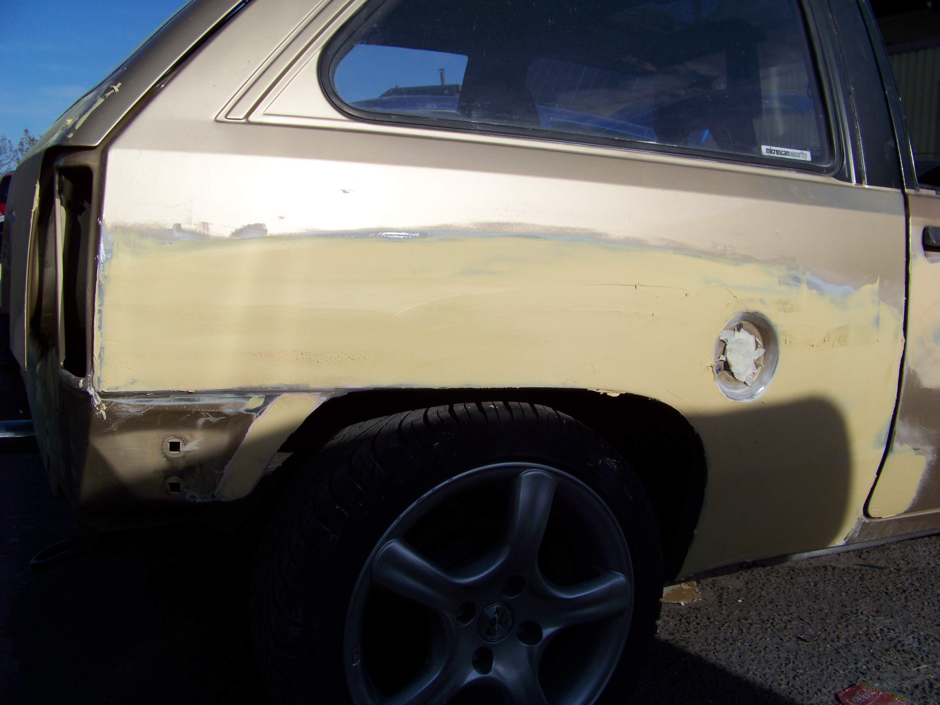

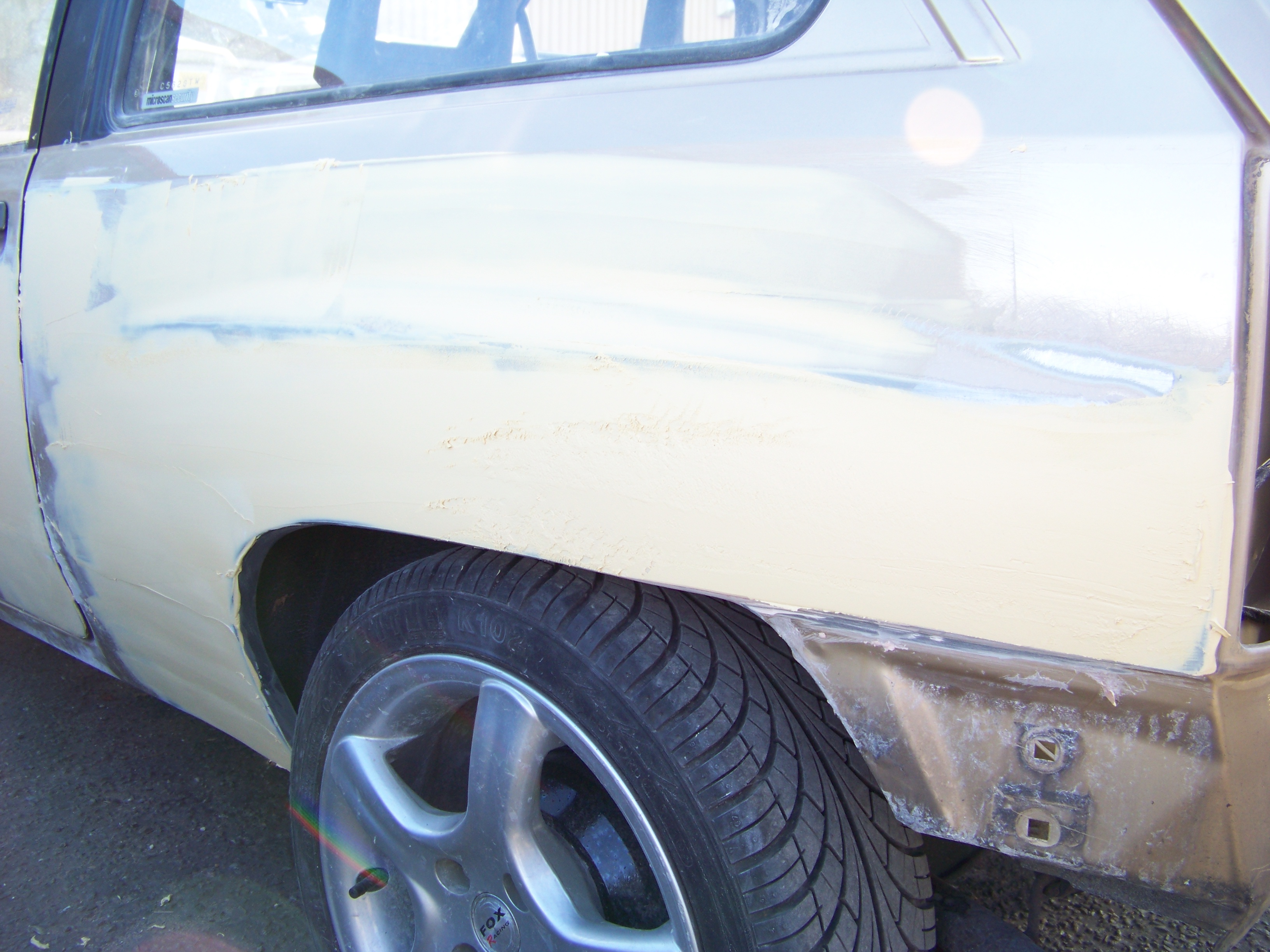

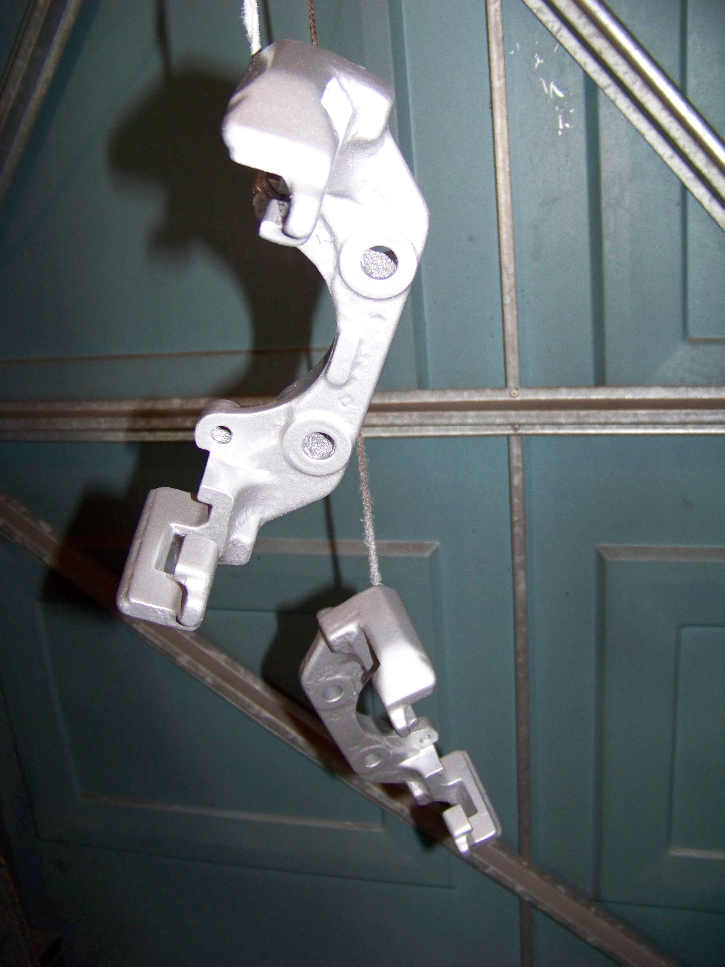

UPDATE
Day off today, so after many hours of running around tryna get stuff sorted I had a couple free hours to try get some work done. I thought I'd crack on with the boot lid ex-lock hole. It needed to be sorted to protect it against rust and as far as the boot goes everything is order so I can just get that out the way.
I removed the boot popper out the way (which works absolute wonders) and got to the offending bit. Here's what it looked like:
https://images2.imgbox.com/aa/b7/7paErnZg_o.jpg
Some rubbing down with emery cloth to get the flakey stuff off got it to this point (was tough rubbing down the bit in the middle, ended up with grazed fingers )

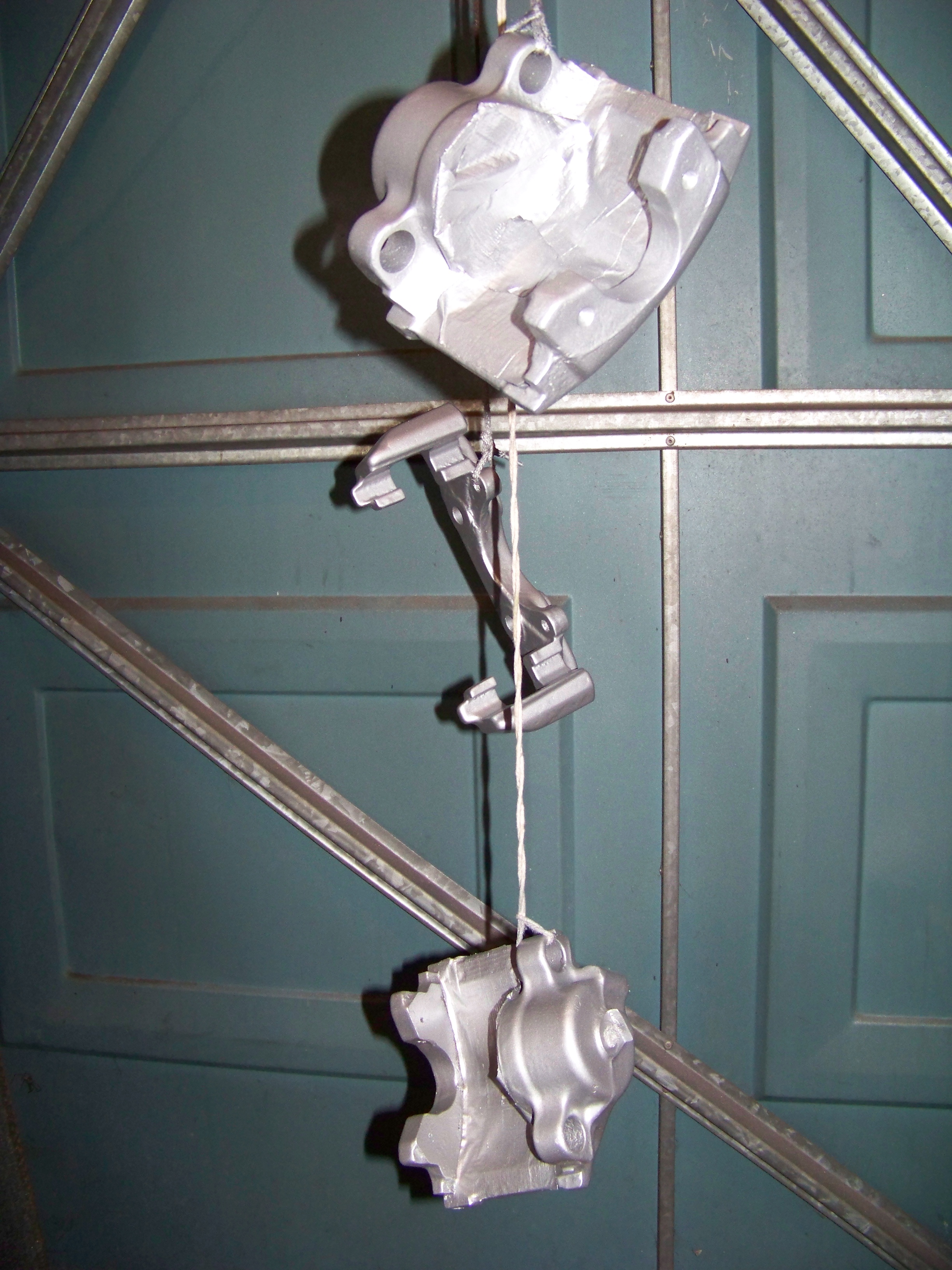

I then raided the paints cupboard and found some gold hammerite. I have no idea how long it's been there for but I thought I'd use it... wasn't the best idea as it looked a bit weird when spraying! Very runny, the colour wasn't very consistent. I shook the can for what seemed like ages but no change, the nozzle must have been semi-blocked as it was spitting a lot too. Could've been the fact that the garage was also cold or just all those things combining together to make a rubbish coat. Luckily it's in a position that will not be seen at all so I gave it a extra coat and left it to dry. Not the best finish I know but not too bothered about it tbh:
https://images2.imgbox.com/78/fa/lsWmmSdx_o.jpg
Whilst it was drying, I did a spot of tidying up in the garage and decided to start some stuff on the engine. First port of call was to whip off the cam cover to see what it was like under there and to prepare the cover for paint.

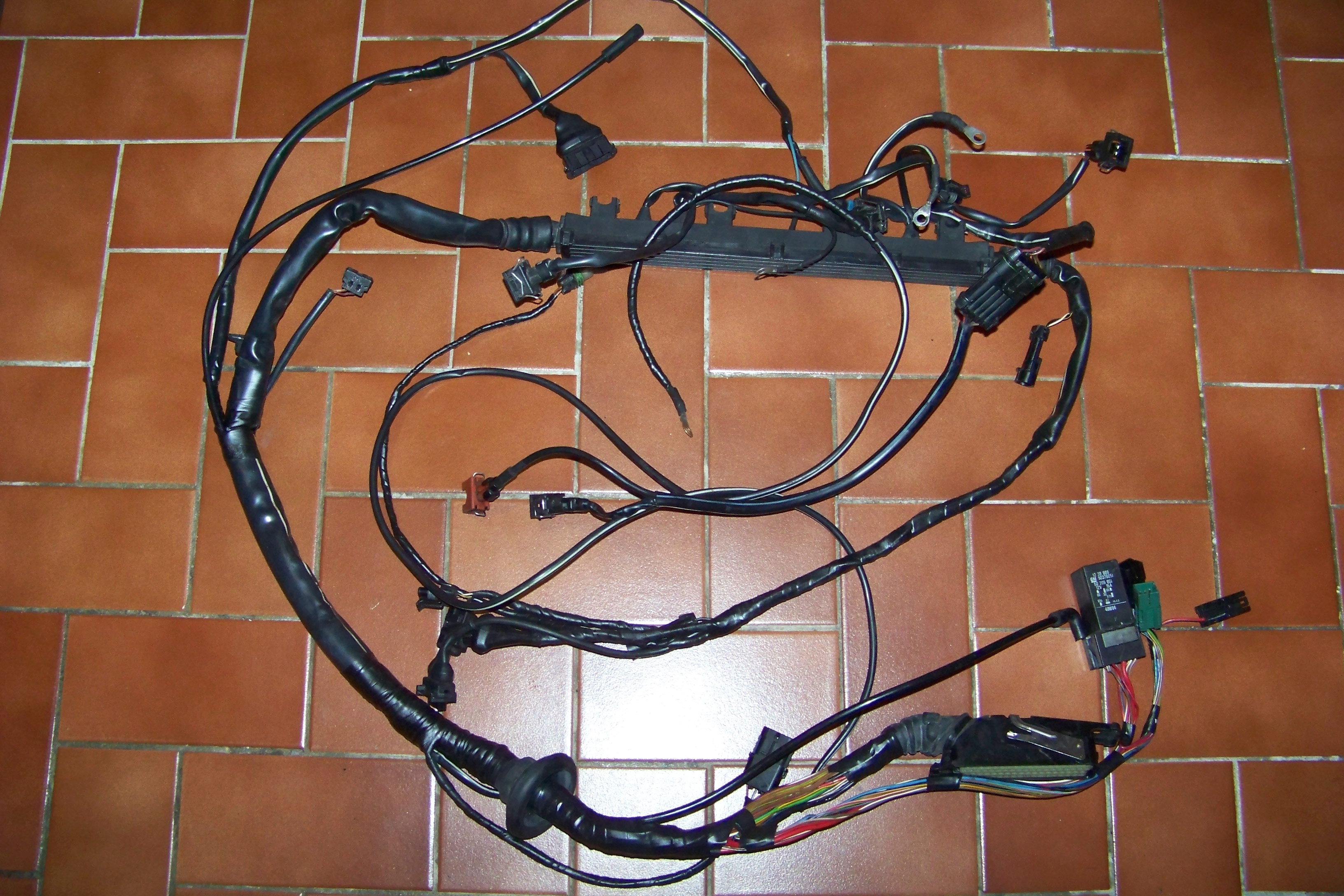

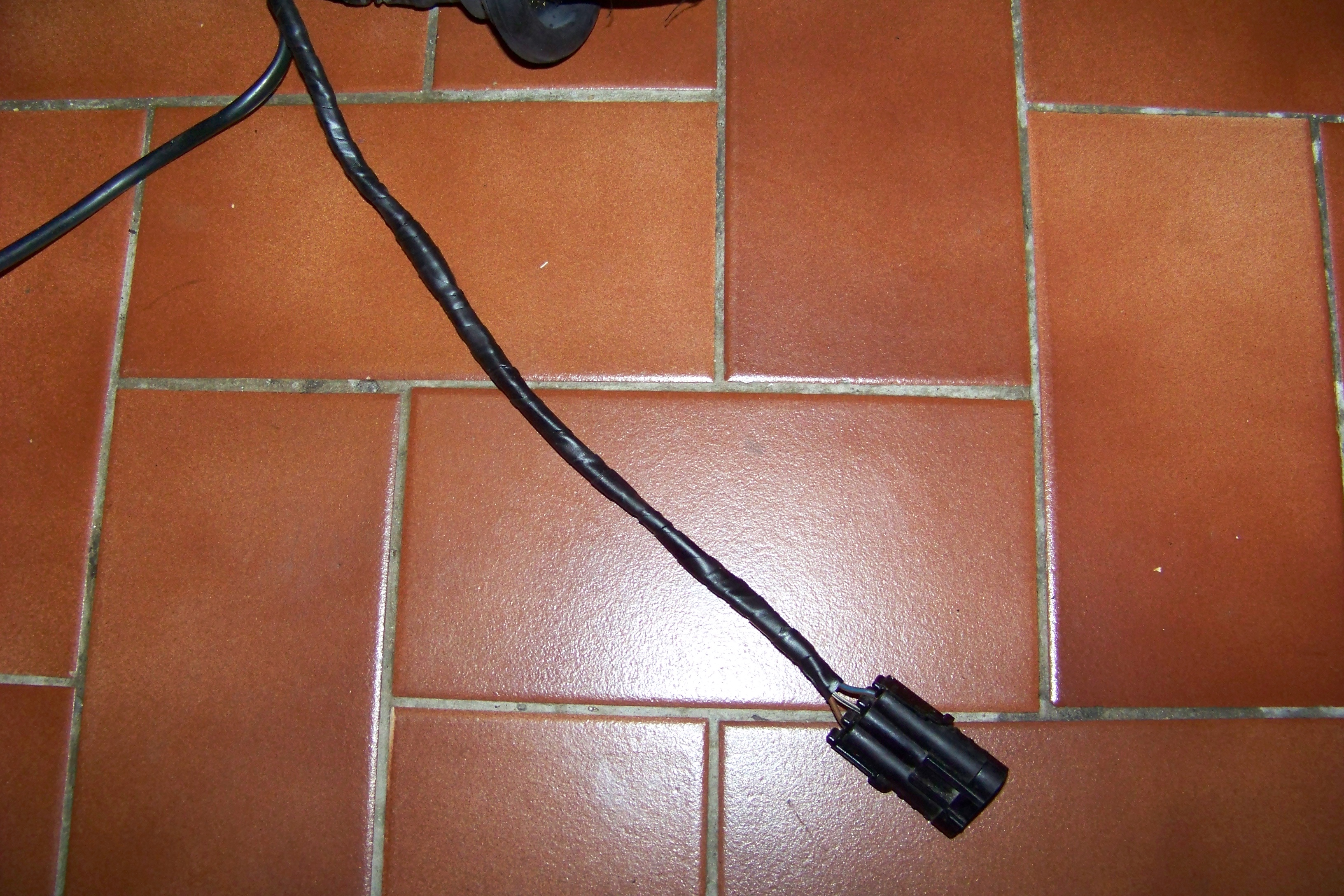

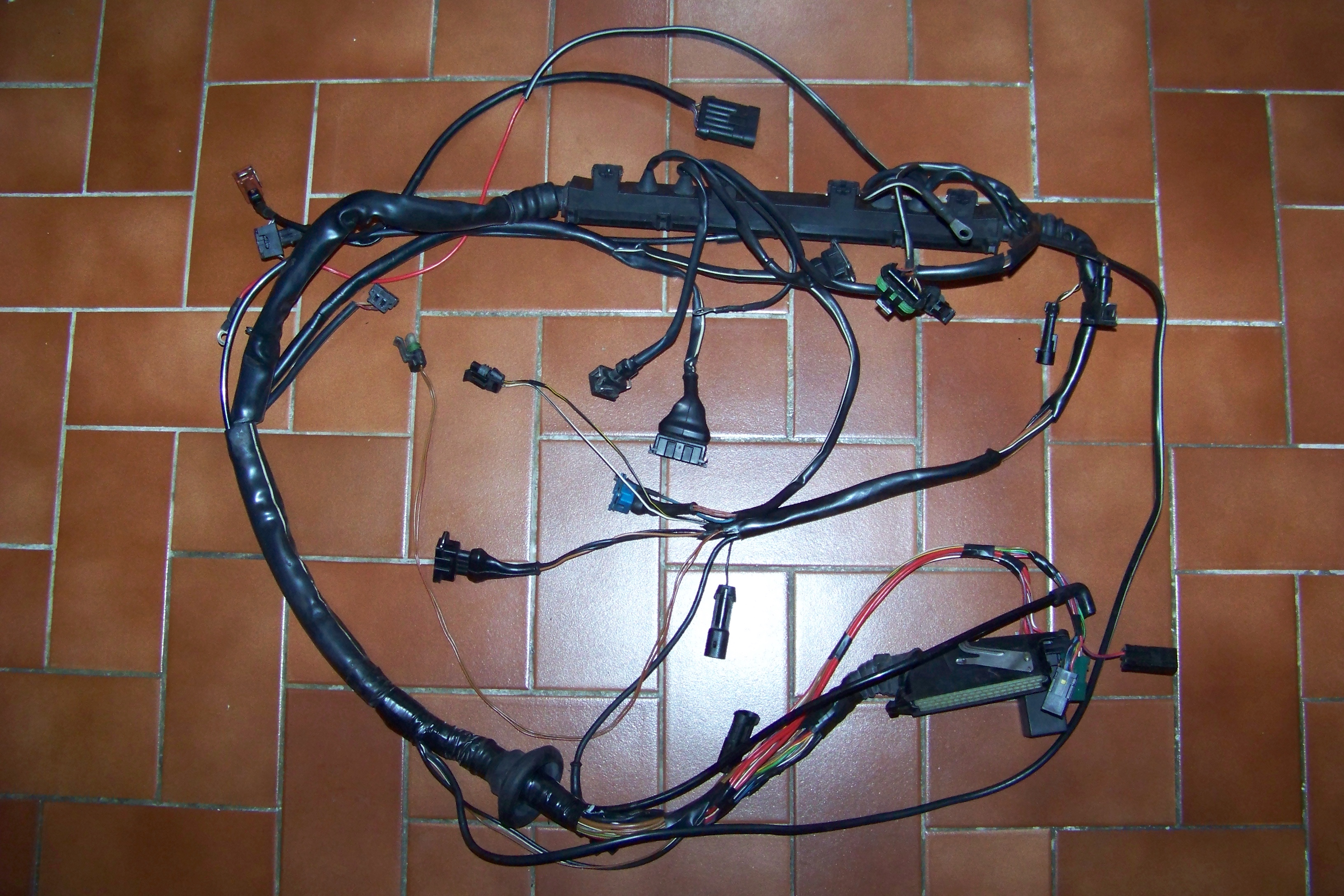

As the engine still needs to go in, I concentrated on the engine loom. This is how it looked when I first got it:
https://images2.imgbox.com/0c/86/ga5oMXZp_o.jpg
And this is how it looked after a damn good clean with some fairly liquid and foamed up sponge. I also made a start on taking off all the rubbish, sticky, worn out, peeling fabric loom tape and damaged and cracked plastic loom tubing. Boy did it make a mess of the floor!
https://images2.imgbox.com/5b/6f/XWUIzdzk_o.jpg
Here's the amount of crap removed
https://images2.imgbox.com/57/c0/mbMjhFBO_o.jpg
I then got down to business of re-taping up the loom but this time using self amalgamating tape. Real top stuff... sticks on to it self when wrapping and it becomes totally water proof. Before (with all the crappy tape removed and cleaned):
https://images2.imgbox.com/f9/94/ISpVqrZu_o.jpg
and after it's wrapped with self amalgamating
https://images2.imgbox.com/0e/a7/tI29TXup_o.jpg
The trick with the self amalgamating is to slightly stretch the tape whilst wrapping so it shrinks and seals on to the tape below. You really do need to have 3 hands to do this wrapping... unfortunately I only have 3 legs! And here's the end result after doing it all. Took a good 3 hours to clean, wipe, cut out the mess and re-wrap... I'm bushed!
https://images2.imgbox.com/00/4c/imQRjTiK_o.jpg
I've left the part of the loom that's in the cabin un-wrapped for now as I'll be wrapping that part in self extinguishing fabric loom tape (the same stuff I used for the rest of the interior wiring).

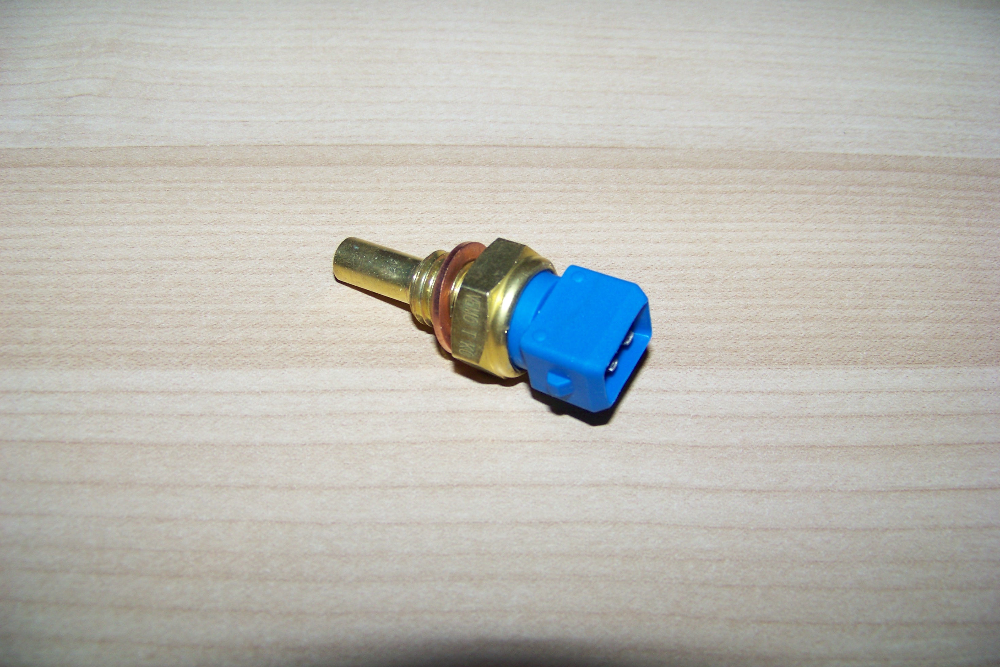

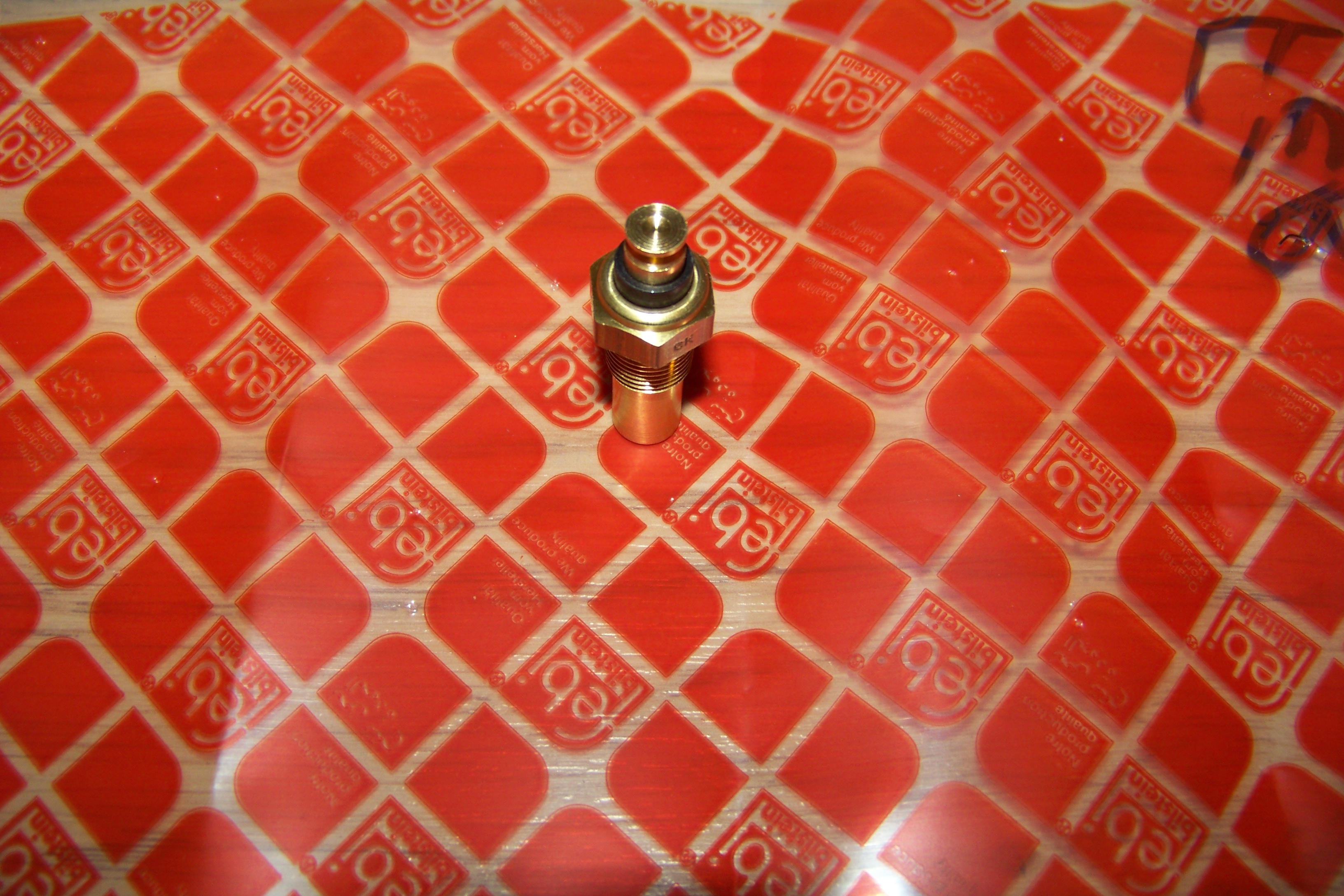

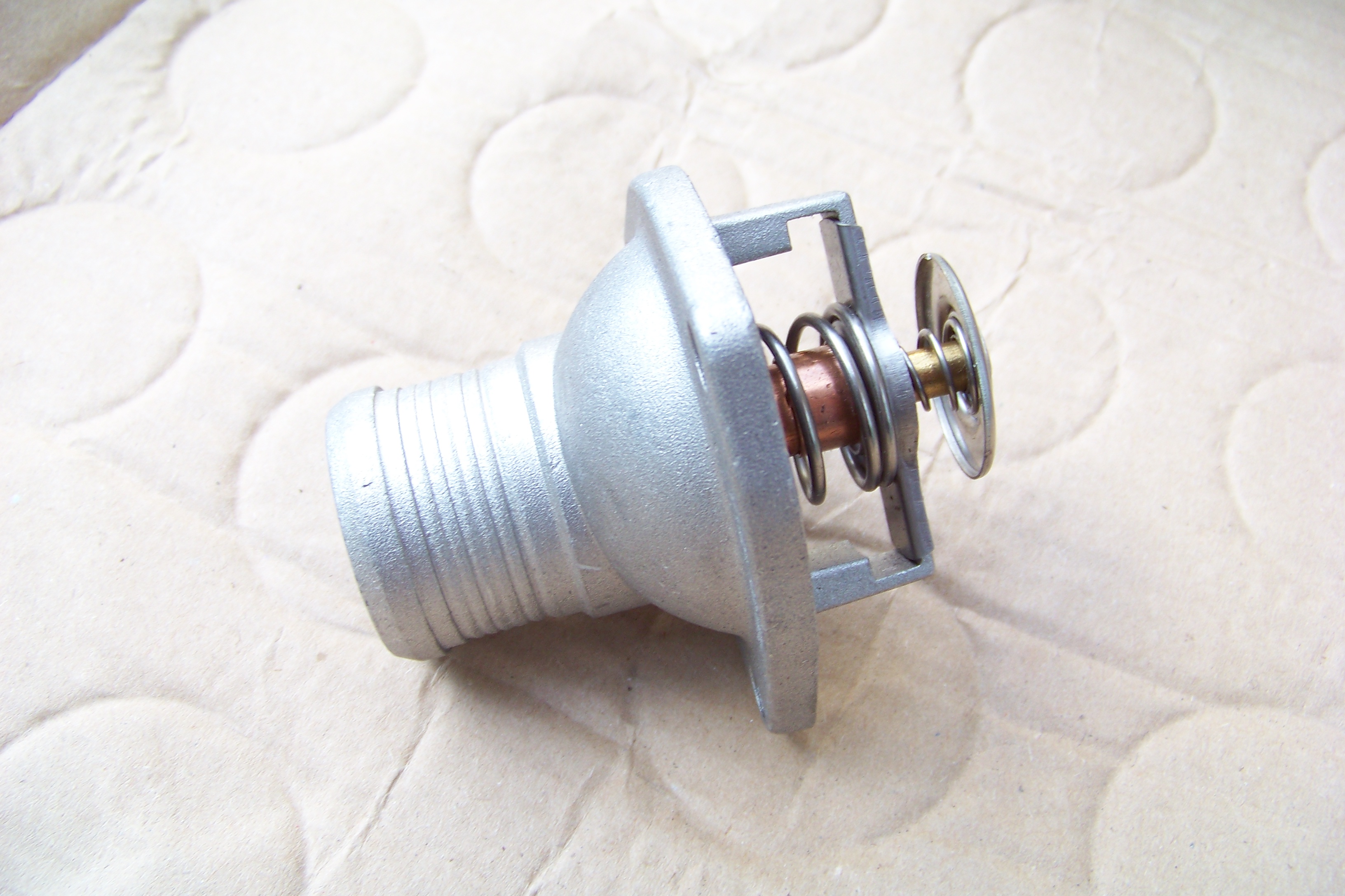

Popped into AllParts to get some essentials. Sourced coolant sensor (temp gauge), rotor arm, thermostat.
Prices were crazy cheap:
£4+ vat for the coolant sensor
https://images2.imgbox.com/ec/35/xUHkF9eC_o.jpg

£17 for the thermostat (92 Deg).
https://images2.imgbox.com/df/87/mrEz4ACH_o.jpg

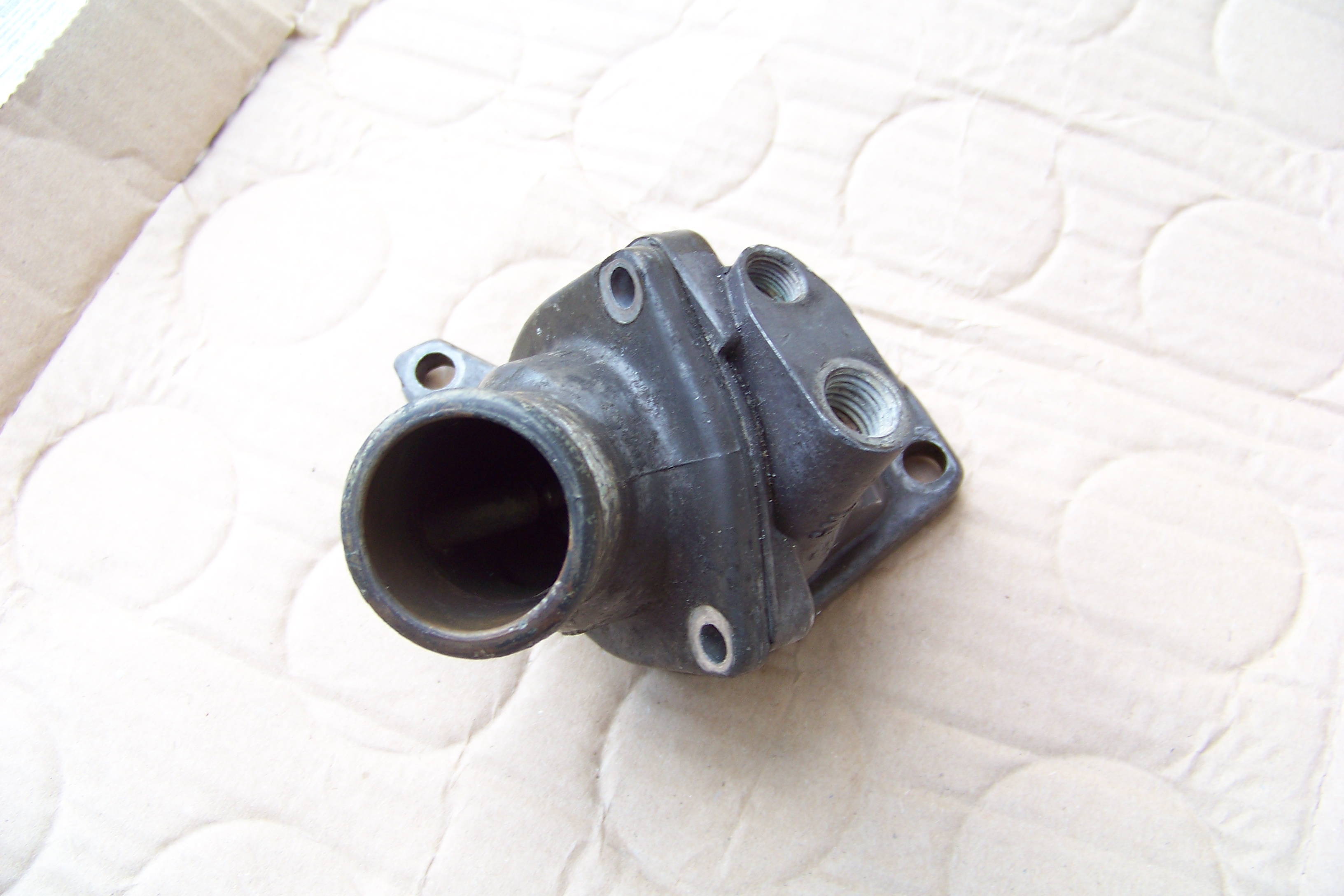

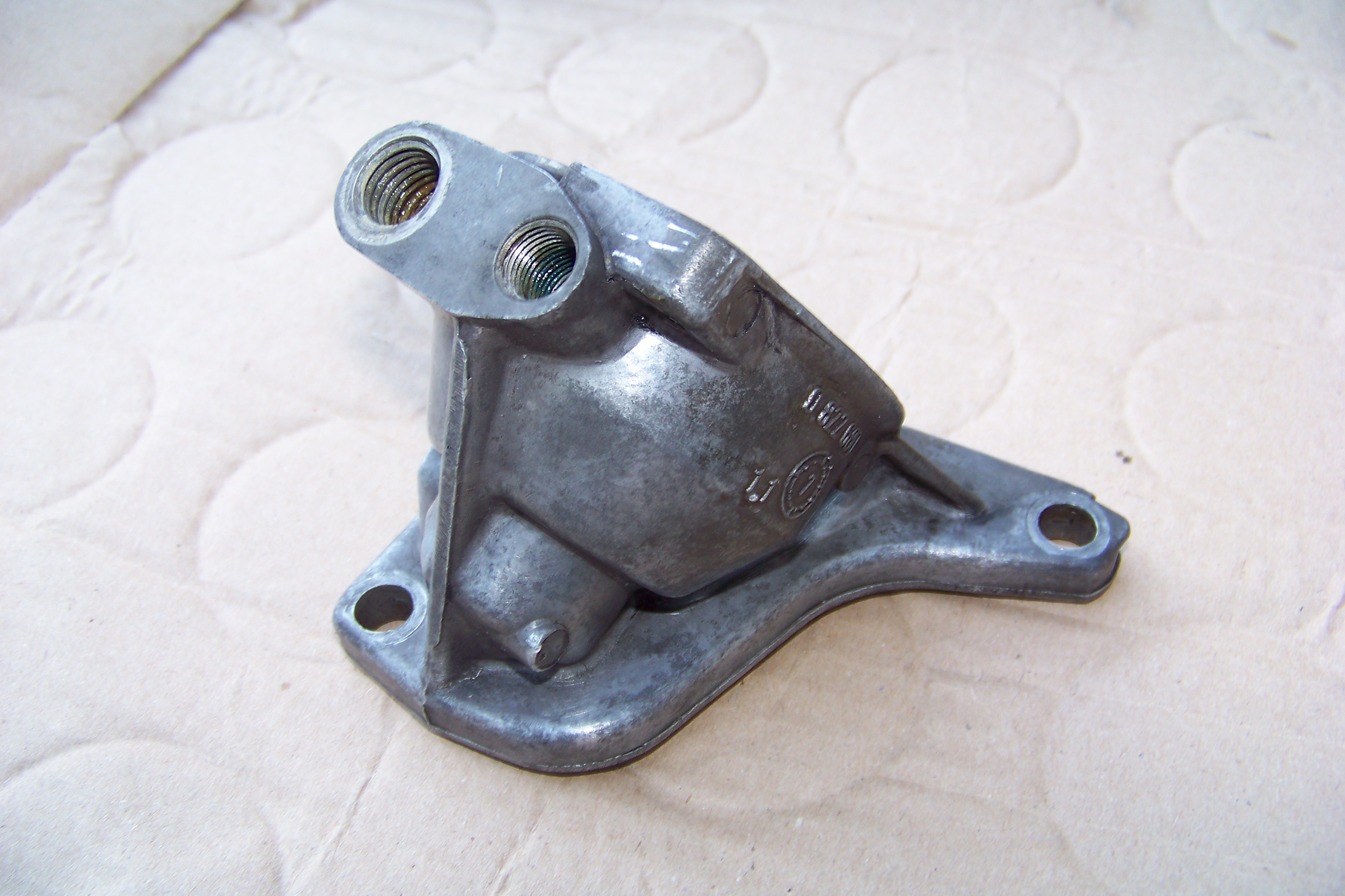

Started cleaning the main body of the housing, once dry, gave it a few coats of VHT aluminium paint. After a bit of a clean:
https://images2.imgbox.com/bb/7a/NPCGd2PQ_o.jpg
Then moved on to the actual stat housing. Removed most of the scaling around the opening and masked it up
and then gave that a couple coats too. Also did the bolts at the same time.
https://images2.imgbox.com/7c/00/gxdhB7jX_o.jpg
Here they are after they dried:
https://images2.imgbox.com/a4/a4/6GtSB4g7_o.jpg
I then tried to put the new stat into the original GM stat housing... oh dear... the new stat is slightly shorted so wont snap into place. No choice but to use the new stat with its own housing.
Quick question though... Where on the block is the actual Coolant Temp Sensor (ECU) (doesn't seem to be one on the block), where should the temp gauge sensor go? (can't find that either) and does the dizzy cap on the LET have a spacer or something bewteen it and the distributor housing?

Got myself the CTS for the ECU
https://images2.imgbox.com/25/e1/Bz1OXAl3_o.jpg

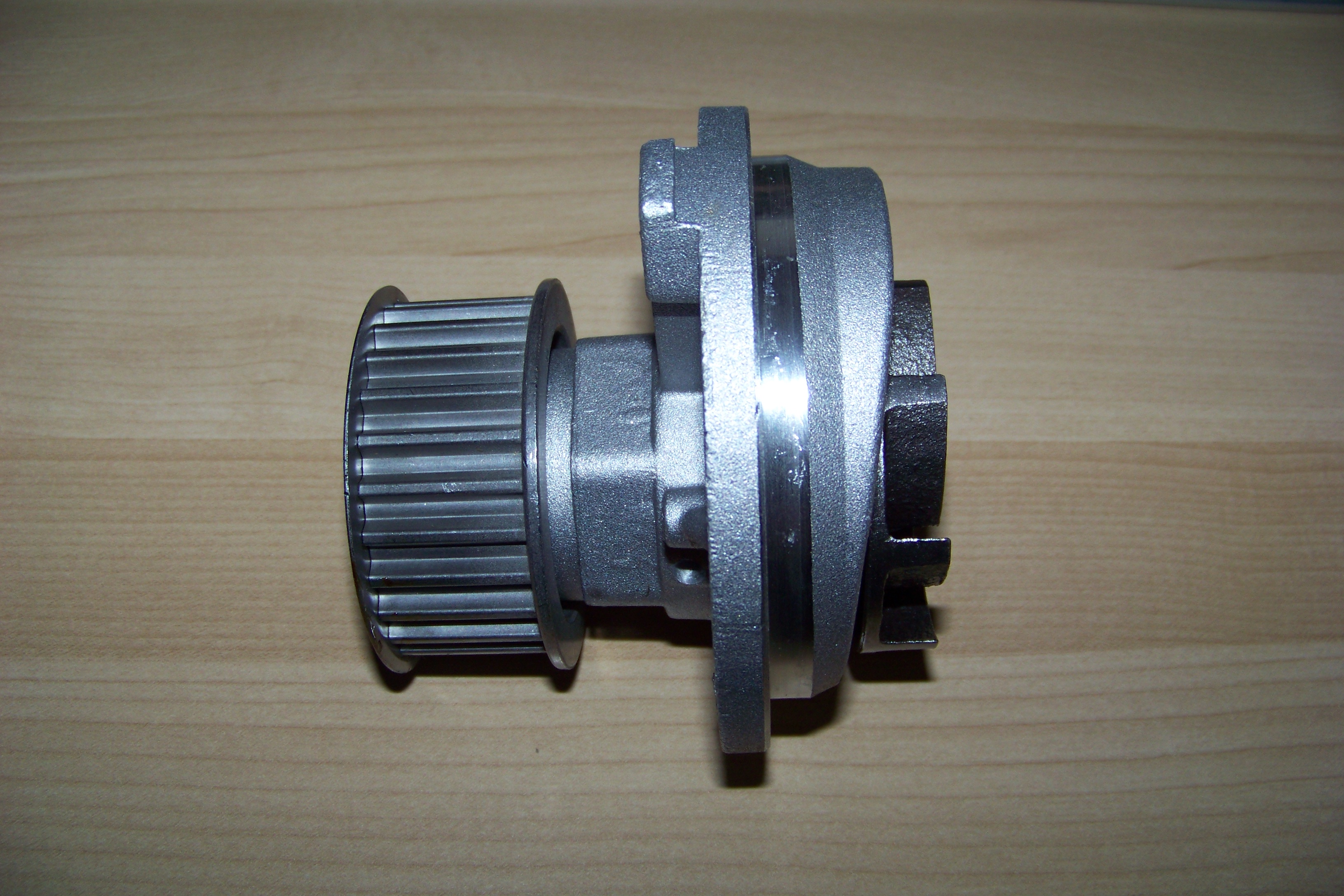

Water pump with a metal impellor (none of the plastic nonsense)
https://images2.imgbox.com/d4/da/COPmILtn_o.jpg

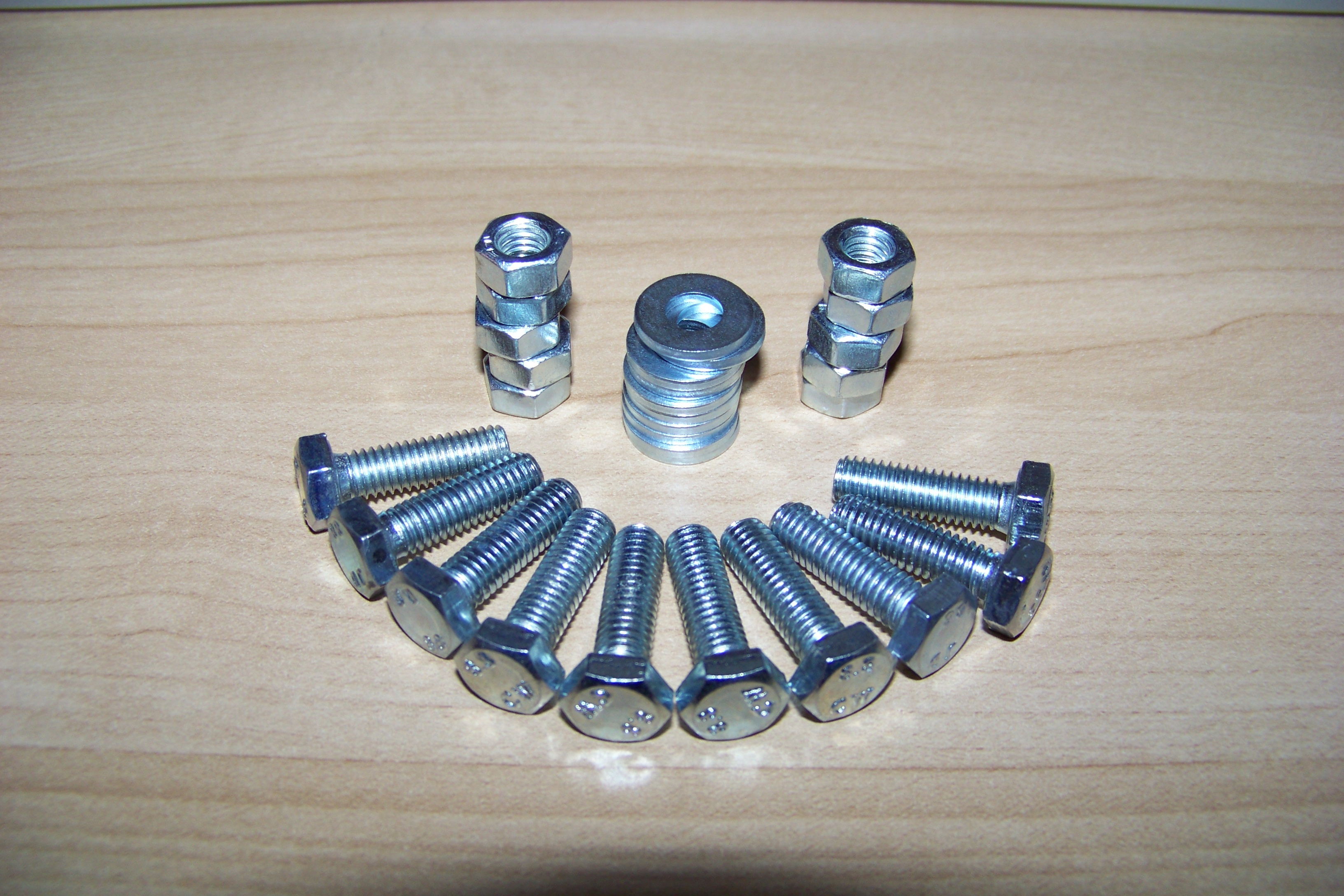

These also came in the post
10 x M6x20 - nuts, blots and washers.
https://images2.imgbox.com/0d/96/vpEg9K8r_o.jpg

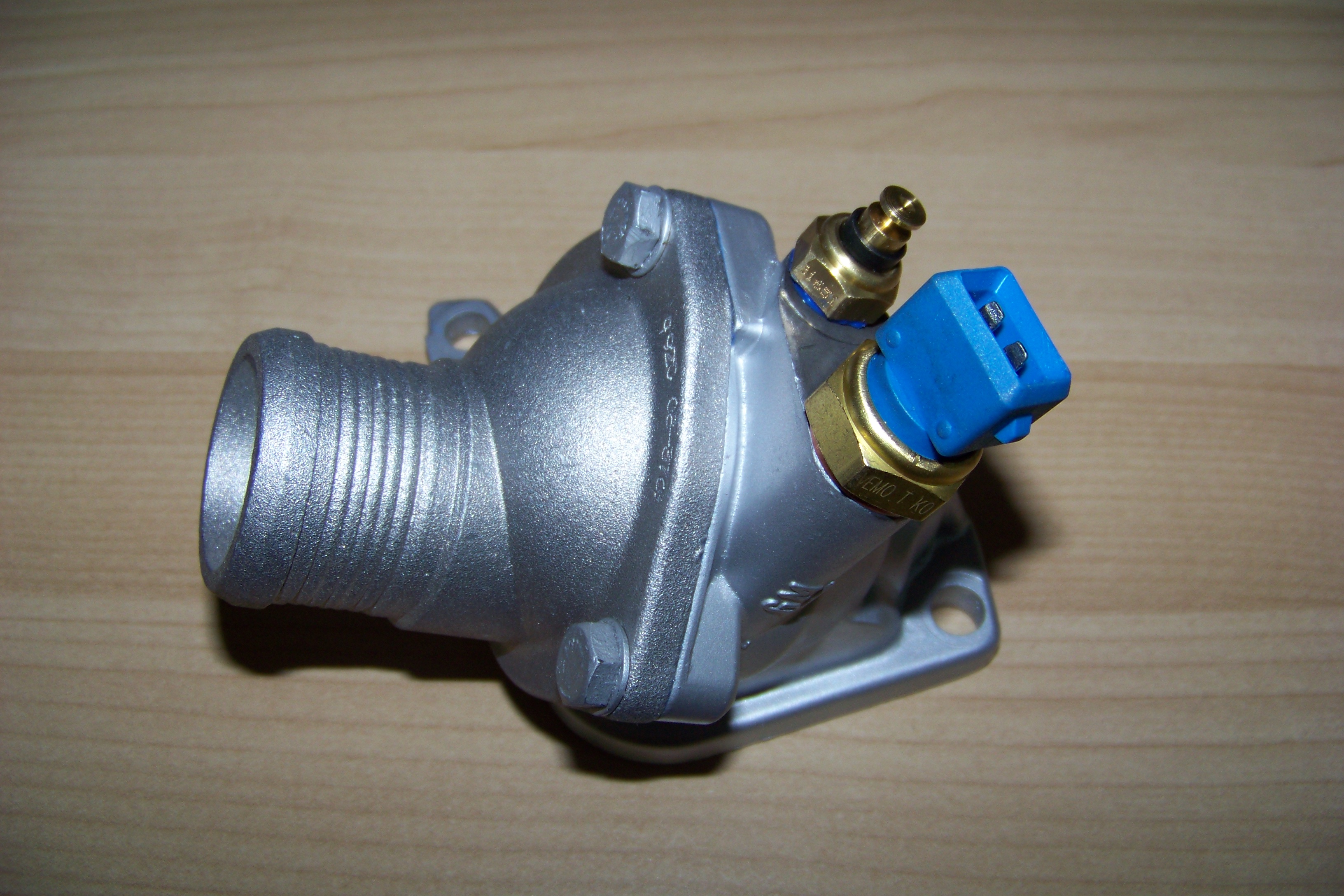

So... first thing was to finish off the thermostat. Now that I've sussed where the CTS's go I fitted those to the housing. Trial fitted them both to make sure they'd tighten properly as there was a bit of scale in the threads.

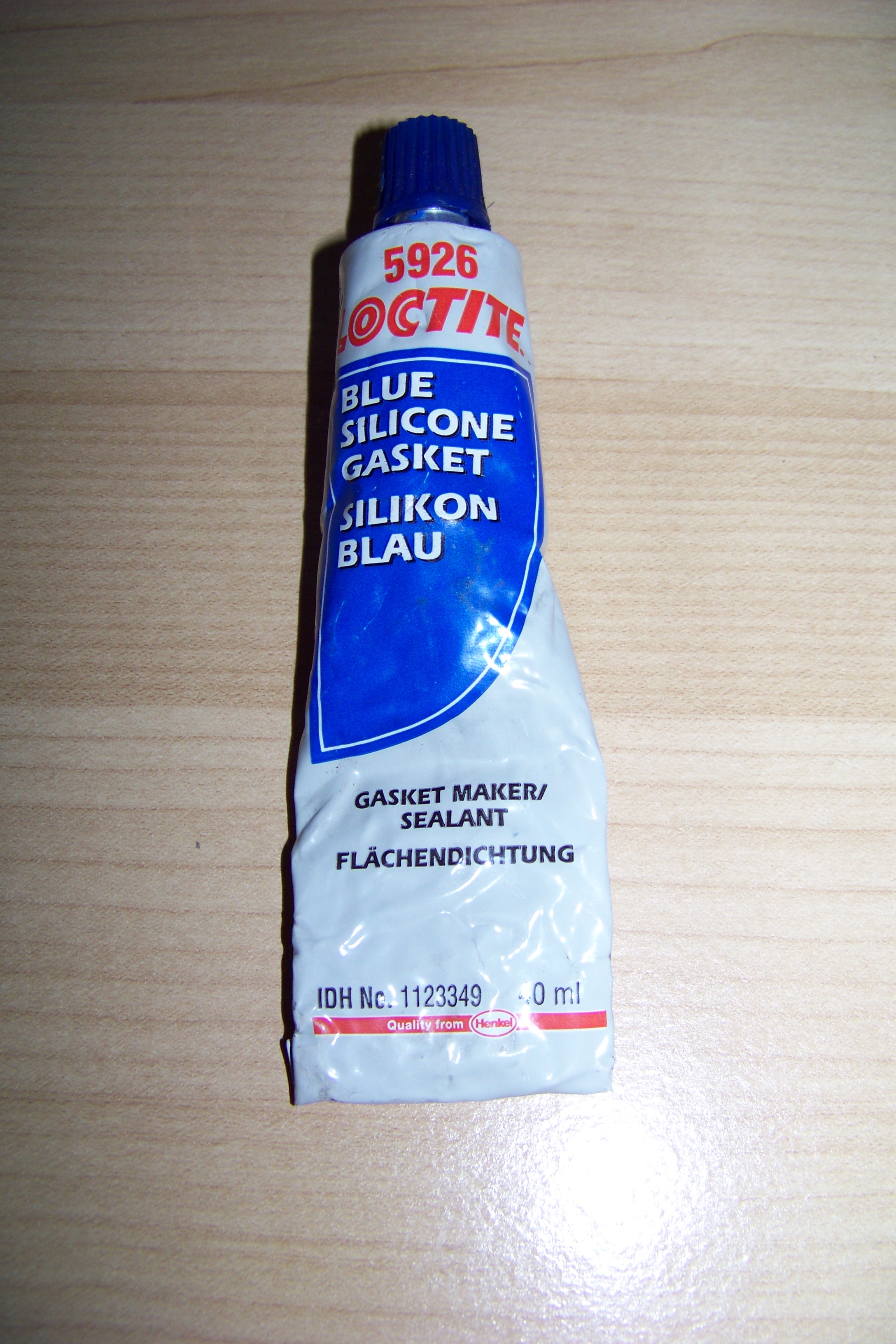

Took them off and applied a drop of liquid gasket, this stuff
https://images2.imgbox.com/e3/4f/QB0zSA3l_o.jpg
I started adding this gasket sealant a while back as reassurance to help seal things up and have used it ever since. Once both sensors were in, I applied some of the above sealant to the mating surface of the housing and then tightened down the thermostat. The finished article (god I love it when things look new )
https://images2.imgbox.com/5a/d9/Av73PBvK_o.jpg

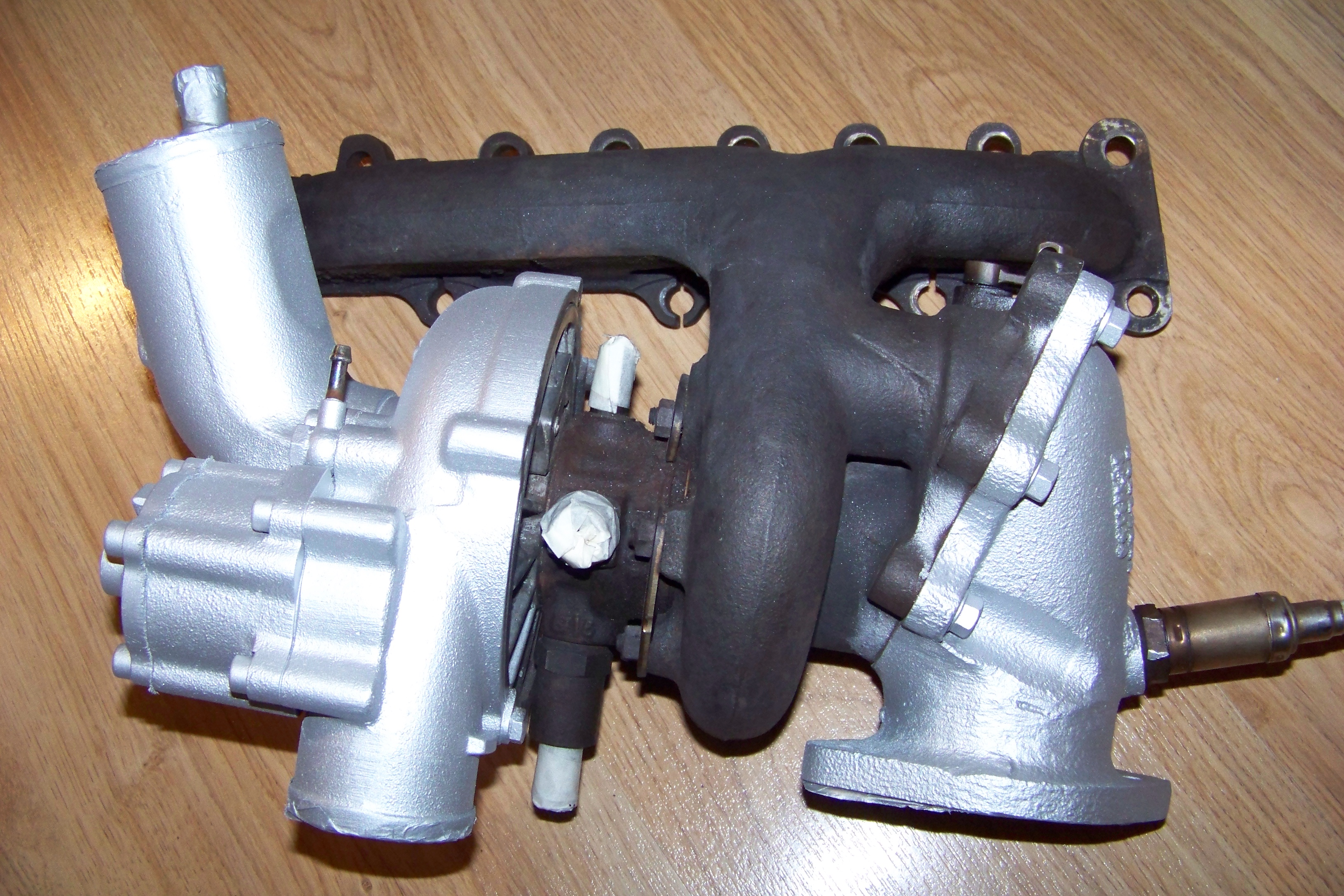

Next up was the turbo. This is how it looked when I got it
https://images2.imgbox.com/80/ec/1uDKIIFo_o.jpg

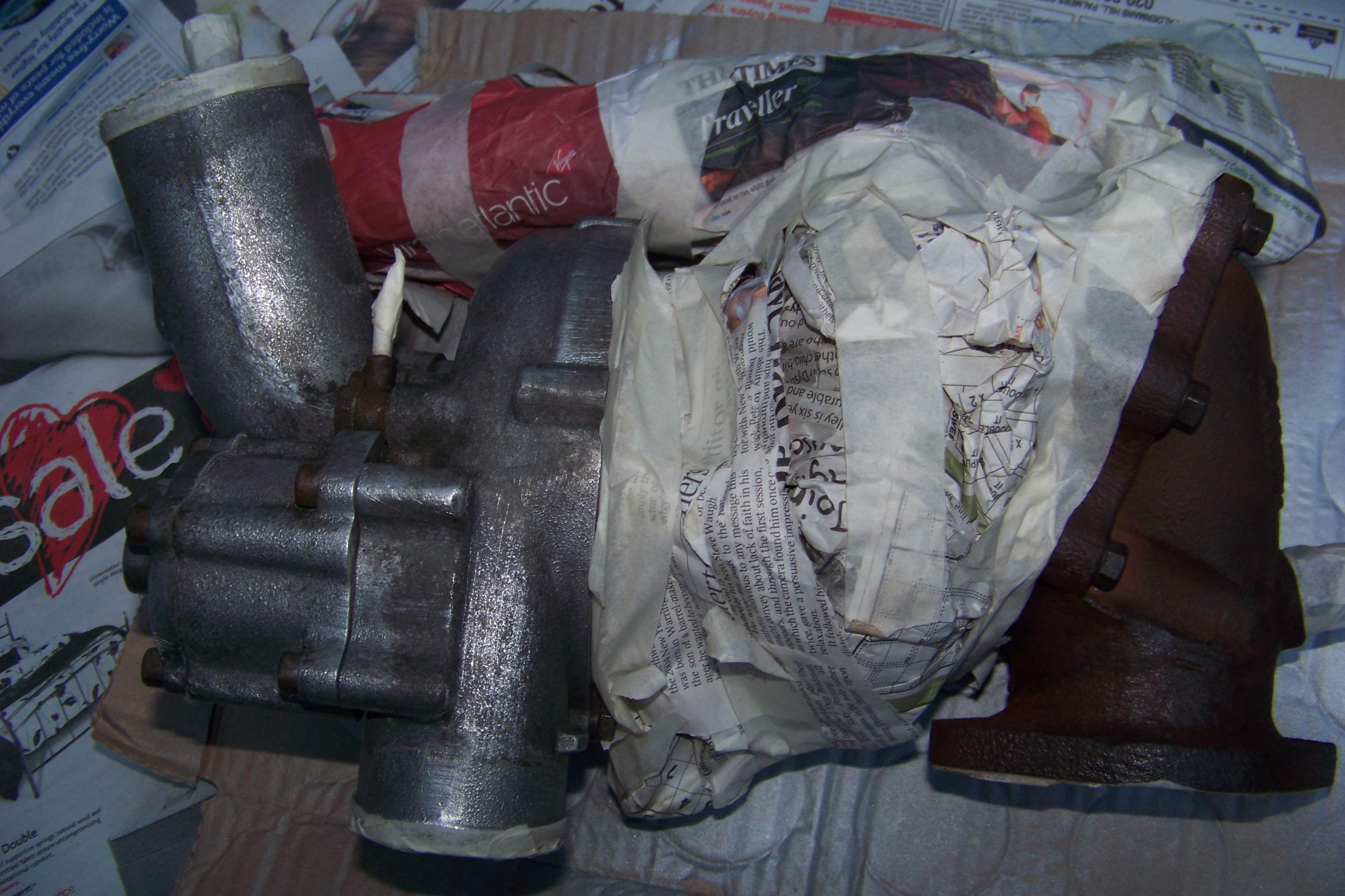

I couldn't have it looking like that when everything will look clean and new. So I removed all the hoses and the actuator which I'll be replacing as it's well crusty. Most of the hoses are in good condition but a couple have perished so new ones will be needed. I gave it a good going over with a wire bush, emery cloth and wire wool with a bit of detergent to remove grease and other residue.
I then tried my best to mask it made a bit of a hash of it but it done the trick
https://images2.imgbox.com/1b/7b/73nKPCfd_o.jpg
I then gave it a wipe with some thinners to remove any left over rubbish and applied a good few coats of VHT paint. Let it dry properly and removed the masking:
https://images2.imgbox.com/f8/2c/0AI6q1X2_o.jpg

theres no need for sealant on the sensors, thats what the copper washers are for lol

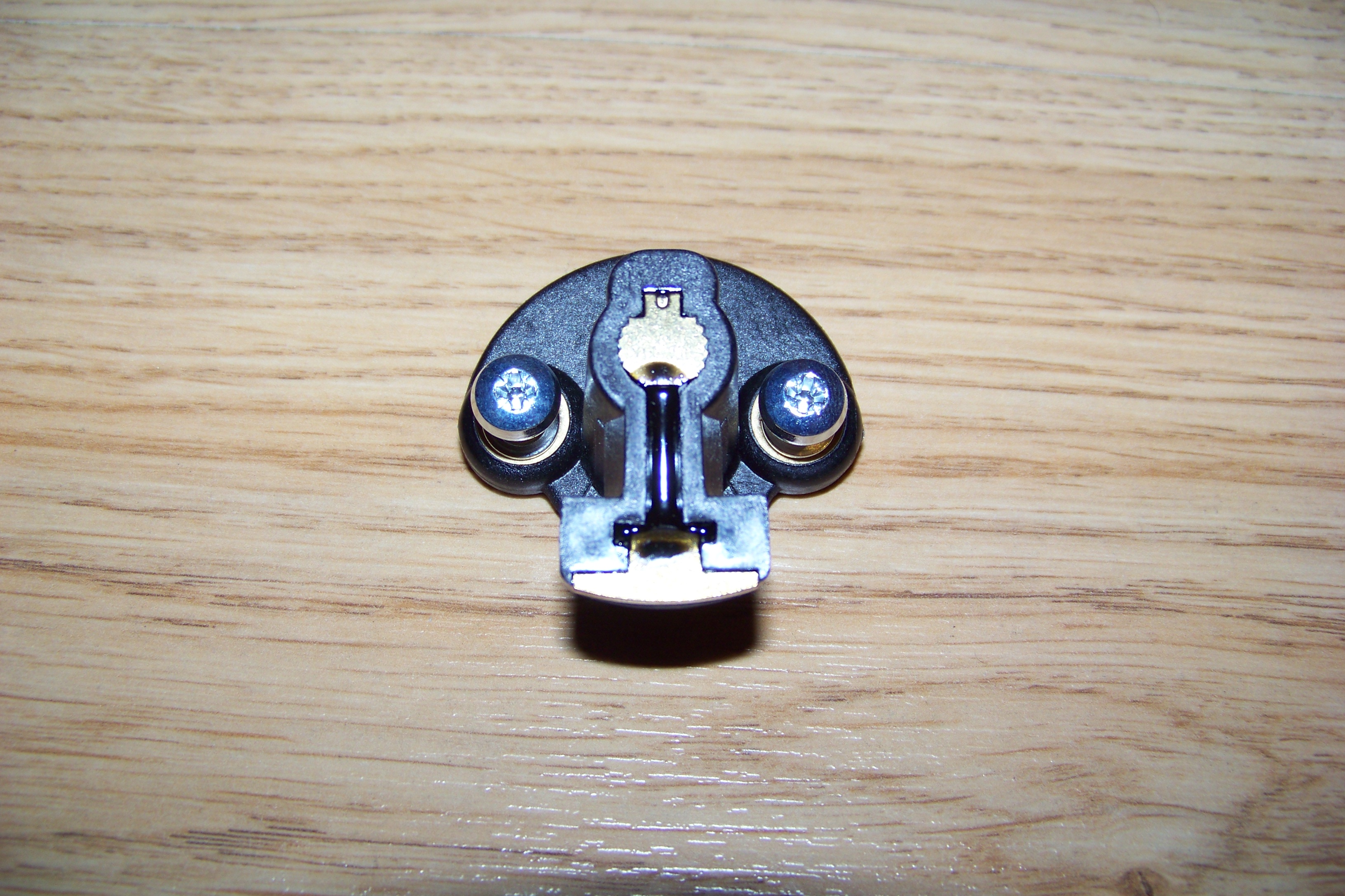

That looks like the wrong rotor arm, never seen one like that before with the two screws in, just slides on to the distributor normally.
Also good look with the motorfactors coolant temp sensor, I fitted one once and gave me no end of problems. Genuine GM ones are only £10.
http://www.max-boost.co.uk/max-boost...DizzyRotor.jpg
