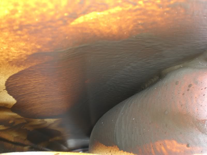

First of all I rustproofed it with 6 litres of Dinitrol which is a very expensive and better quality version of Waxoyl...
http://img.photobucket.com/albums/v3...t/CIMG0399.jpg
http://img.photobucket.com/albums/v3...t/CIMG0403.jpg
Love this pic, shows Ade's fantastic paintwork
http://img.photobucket.com/albums/v3...t/CIMG0430.jpg
Both rear arches very full....
http://img.photobucket.com/albums/v3...t/CIMG0405.jpg
http://img.photobucket.com/albums/v3...t/CIMG0404.jpg

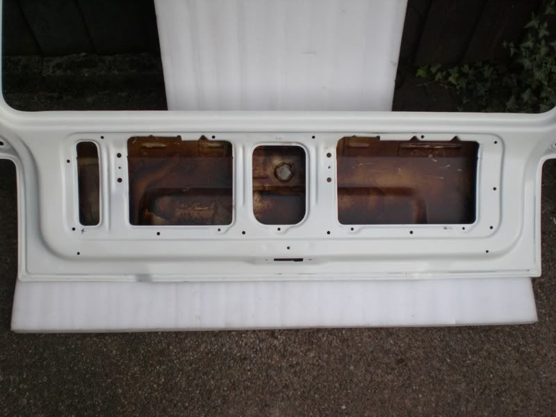

Tailgage filled top to bottom!!!
http://img.photobucket.com/albums/v3...t/CIMG0423.jpg

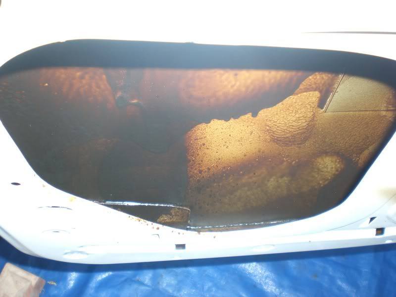

Both doors filled top to bottom. Cross member, bulkhead, sills, kick panel cavities & tunnel cover all filled aswell...
http://img.photobucket.com/albums/v3...t/CIMG0408.jpg
http://img.photobucket.com/albums/v3...t/CIMG0422.jpg

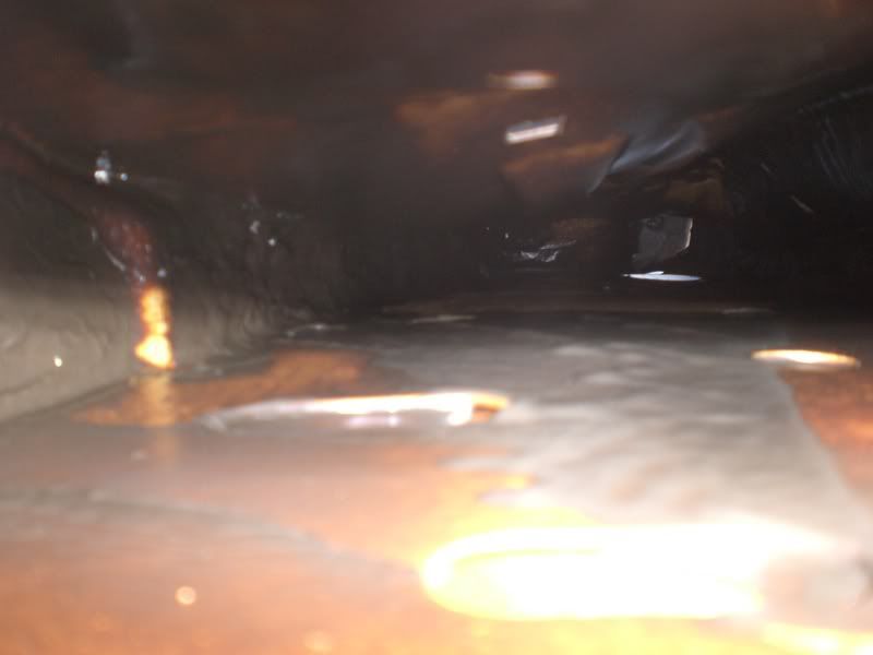

Chassis legs VERY full...
http://img.photobucket.com/albums/v3...t/CIMG0412.jpg
http://img.photobucket.com/albums/v3...t/CIMG0410.jpg
Hopefully won't rot in a hurry!

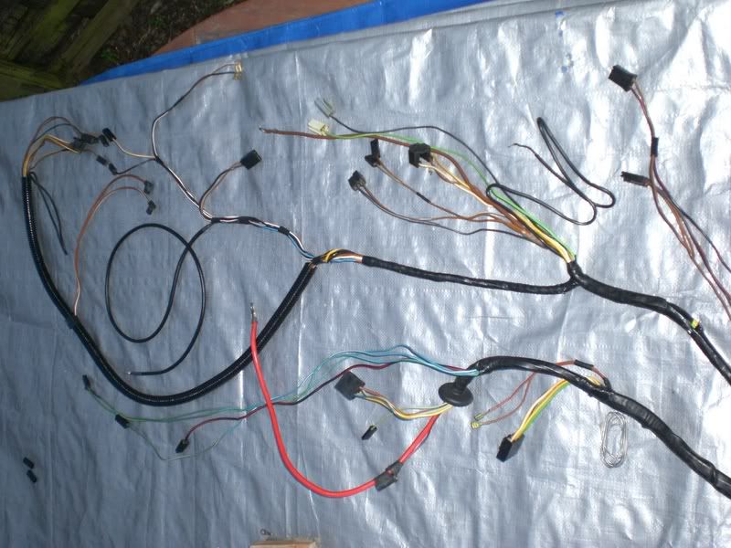

Then I made a start on the wiring loom...
http://img.photobucket.com/albums/v3...t/CIMG0477.jpg
I dug out my electrical first aid kit
http://img.photobucket.com/albums/v3...t/CIMG0476.jpg
Although it was in good condition I stripped the engine bay section, cleaned it up & carried out a couple of minor repairs. I fitted some new convolute tubing & got it ready to retape,
http://img.photobucket.com/albums/v3...t/CIMG0474.jpg
Retaped the loom for the idle control unit...
http://img.photobucket.com/albums/v3...t/CIMG0491.jpg

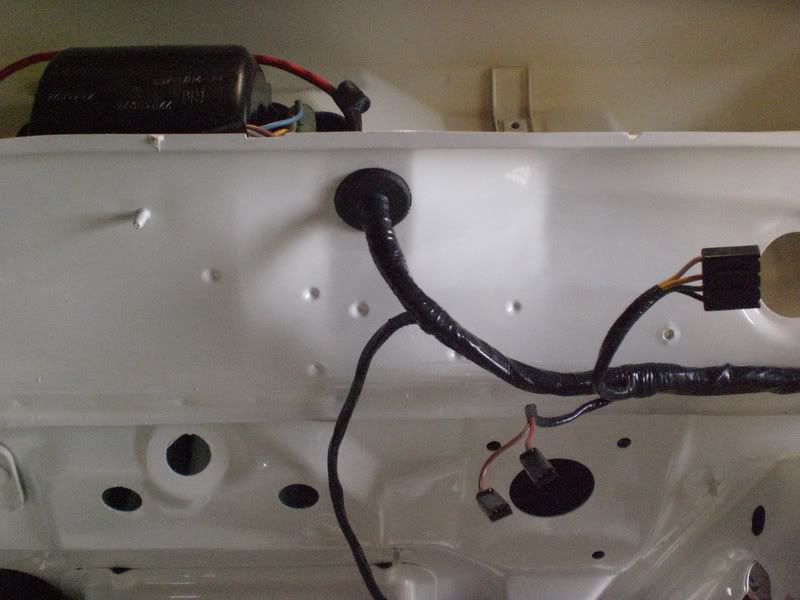

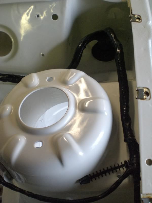

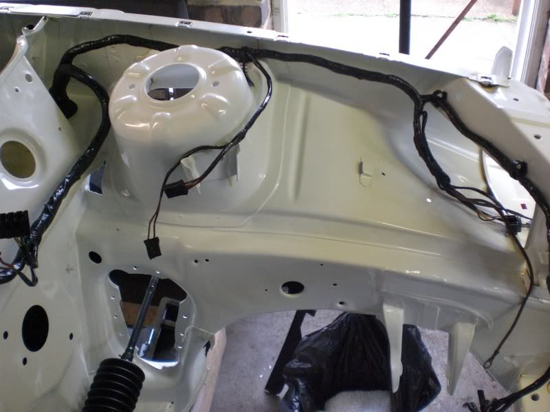

Then I had a little wiring loom issue!
It appears Vauxhall changed the sized of the hole in the bulkhead for the wiring loom at some point in the Mk1's life so when the loom was pulled through the grommet fell through with it http://www.justopelvauxhall.com/imag.../wacky/mad.gif
A bit gutting after spending a week cleaning & re-wrapping the loom!
The one on the left is the original and is 10mm smaller!!
http://img.photobucket.com/albums/v3...t/CIMG0504.jpg
I managed to butcher a couple of looms at the local scrappie and got 2 in the correct size but then I had the problem of getting all of the engine section of the loom through the tiny holehttp://www.justopelvauxhall.com/imag...es/MSN/032.gif
After a bit of head scratching I came up with a bright idea. I used a hoover extension tube and pushed it into the centre of the grommet to stretch it out to allow the loom to go through them pulled it out & cut it off when I had done. Worked really well!
Anyway, finally got the loom into the engine bay & grommet fits fine, thank f@@k!!
http://img.photobucket.com/albums/v3...t/CIMG0505.jpg
http://img.photobucket.com/albums/v3...t/CIMG0506.jpg
http://img.photobucket.com/albums/v3...t/CIMG0507.jpg

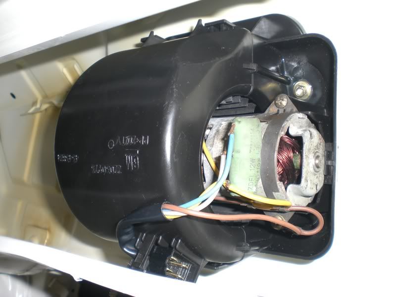

Started fitting some bits, a nice clean heater motor....
http://img.photobucket.com/albums/v3...t/CIMG0479.jpg

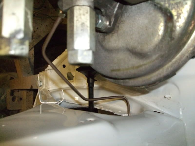

After a few attempts I have finally managed to form a decent LH front brake pipe(Ignore the dirty servo, this is being replaced). Decided to use Copper Nickel to get a better more factory finish as copper looks sh!te...
http://img.photobucket.com/albums/v3...t/DSCF1015.jpg
http://img.photobucket.com/albums/v3...t/DSCF1017.jpg
http://img.photobucket.com/albums/v3...t/DSCF1016.jpg
