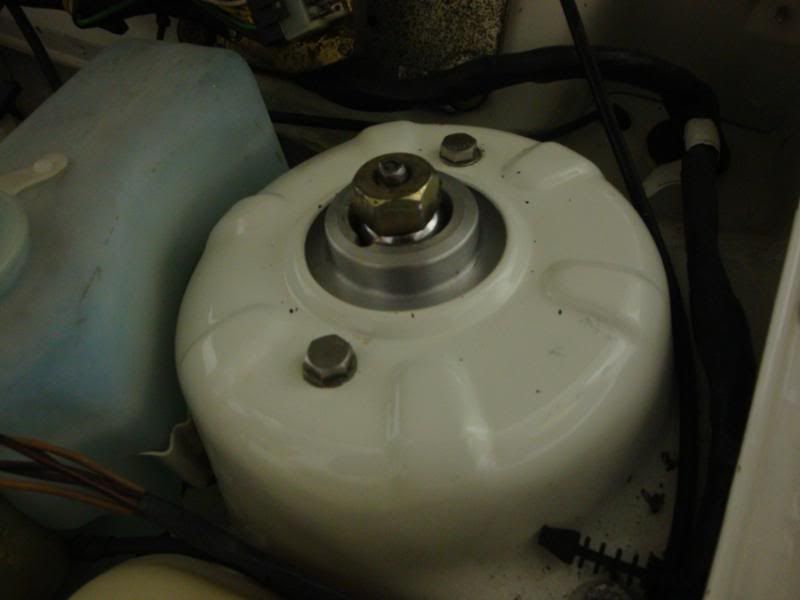

Funky topmounts on...
http://i242.photobucket.com/albums/f...t/7f78ab37.jpg

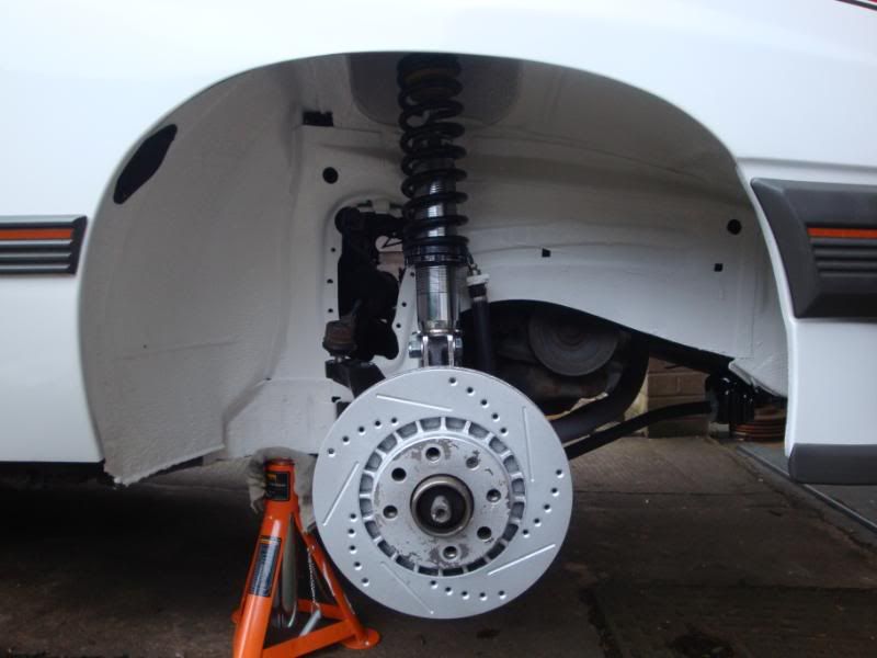

Bolted up again...
http://i242.photobucket.com/albums/f...t/a8ff34b9.jpg
Bosh...
http://i242.photobucket.com/albums/f...t/0d873b7d.jpg
Was gonna paint a few other bits and bobs and sort the calipers out but cba. Will get it all finished when I'm back again in a couple of weeks and then it'll be MOT time!
That top part of the damper doesn't seem to sticking out the top of the nut very far ? not as far as mine did ?
Maybe try them without those spacers ? Take the springs off then just bolt up the topmounts with the spring seat (black bit on top of the spring) and nip them up, if the black bit is clamped up then they'll be ok, if there still loose then you'll have to run with the spacers.
Mine where early GAZ shocks, later ones might be different ?
Aye, I did think about leaving the spacer off as they don't stick through far. Just stuck with them though. Will no doubt whip them off AGAIN next time and see what's what. Did the spacers slot over the slightly thicker part of the piston and sit on top of the spring seat on yours? They're not quite wide enough to do that mine and are just kinda loose before the weight of the car is put on them (seems dodgy).Quote:
Originally Posted by R1CH
Aye they sat on the wider part, were machined to fit perfectly, so if there not sitting right on yours then i'd take them.
Older ones are likely different to the newer ones.
Fairdoos, thought that would be the case.Quote:
