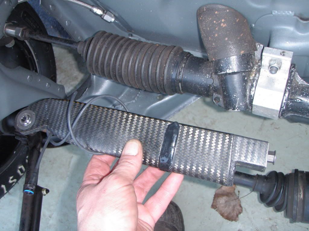

Not content with anything, I've started thinking about lighter steering arms, so picked up these from a 2008 Honda F1 car;
http://i285.photobucket.com/albums/l...ort/001-32.jpg
http://i285.photobucket.com/albums/l...ort/002-67.jpg
http://i285.photobucket.com/albums/l...ort/003-70.jpg
They weight in at 200g each, whereas the Nova steering arms are over 700g. If they were just 10mm shorter they would be perfect, but as it stands there's going to be miniscule adjustment available on the tracking.
There's no sensible way of shortening the steering arms, but we might be able to offset the joint on the steering knuckle somehow. This is one for future development, I don't think it will be done for this season with all the other stuff going on.
I've also got all the parts together for my carbon fibre steering column now, more details on that when there's something interesting to show.
Where did you find F1 car parts? :o :D
Iv been looking into using ex f1 carbon steering arms but didnt dare bite the bullet. I could prbably get away with using the ones you have there colin as the 10mm would be lost in the wide track.
Off to ebay i go lol
Going wide track on mine is a future option, especially as I intend to have custom titanium driveshafts for it eventually. It would only really need a longer track control arm to be fabricated, and maybe some modifying of the top mount.
