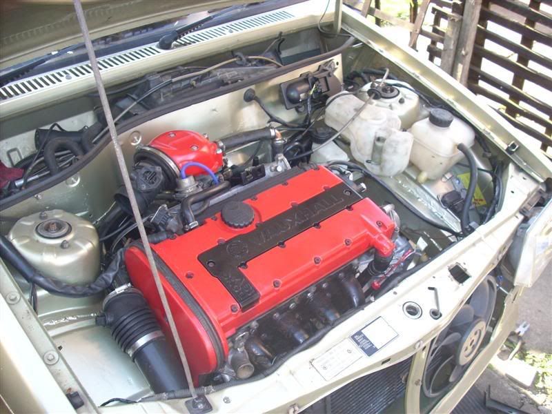

Had a few hours today, greeted with this:
http://img.photobucket.com/albums/v8...1409Medium.jpg
Pic of how i had to mod the rear mount
http://img.photobucket.com/albums/v8...1408Medium.jpg
As you can see ive had to make quite a bit slot..... But i think it'll be sound. Will keep an eye on it though.
Pic of the front mount/bolt
http://img.photobucket.com/albums/v8...1406Medium.jpg
Alternator chassis mod that was done by John, no ugly cutouts here, just a nice neat cut, press back and then reweld... Loads of clearence, and i even fitted the alt belt after fitting the engine..
BTW for anyone wanting a single v belt for a xe, Halfords 925A fits spot on... ;)
http://img.photobucket.com/albums/v8...1411Medium.jpg
Cracked on with the polybush-ness
http://img.photobucket.com/albums/v8...1413Medium.jpg
Fitted
http://img.photobucket.com/albums/v8...1414Medium.jpg
And on the car(along with "new" knuckles off Mikes nova...,cheers mate)
http://img.photobucket.com/albums/v8...1419Medium.jpg
Fuel tank painted in silver-green lol, and fitted
http://img.photobucket.com/albums/v8...1418Medium.jpg
Loom fitted
http://img.photobucket.com/albums/v8...1417Medium.jpg
Its getting there :cool:
http://img.photobucket.com/albums/v8...1416Medium.jpg
And how i left it for tonight
http://img.photobucket.com/albums/v8...1421Medium.jpg
Tomorrow if i get a chance to do anymore, im wanting the starter/alt wired up, driveshafts on and tie bars etc fully tightened.
Can then get the Avo's on the front, along with the brakes and get it back on the floor :cool:
