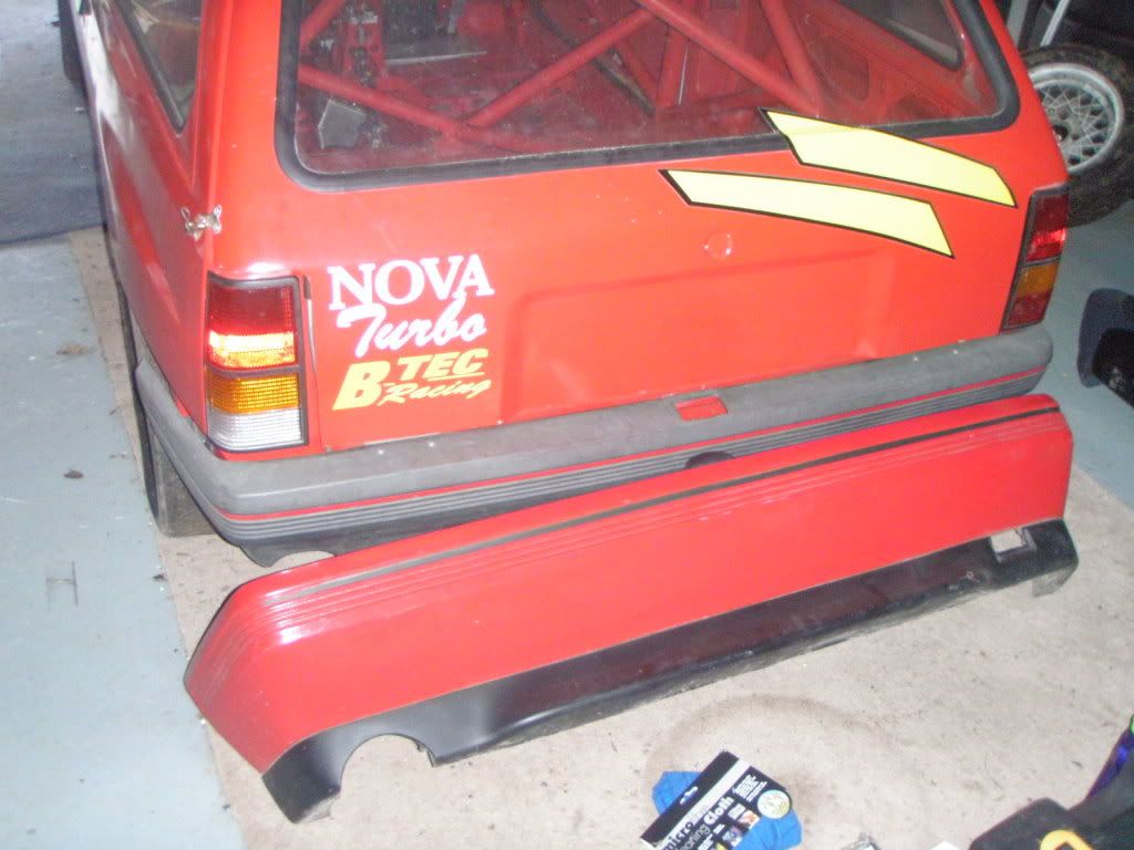

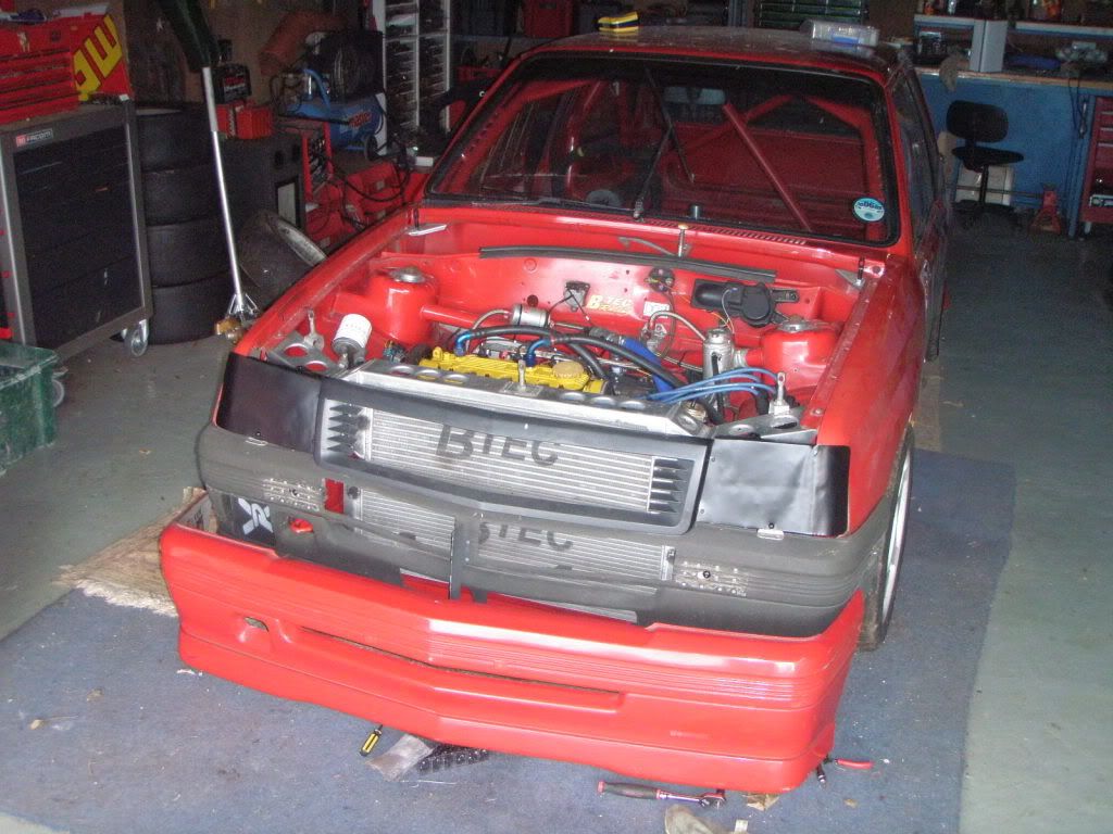

New front towing eye now fitted;
http://i285.photobucket.com/albums/l...ort/002-23.jpg
And rear one removed and replaced with the alloy version;
http://i285.photobucket.com/albums/l...ort/017-15.jpg
http://i285.photobucket.com/albums/l...ort/018-13.jpg
http://i285.photobucket.com/albums/l...ort/019-15.jpg
http://i285.photobucket.com/albums/l...cort/022-6.jpg
There's still a bit more material to be removed from the bumper to get it fitting better, and more metal to come off the chassis rail where it was mounted. But already I have a weight saving of 350g, a good result for a tow eye.

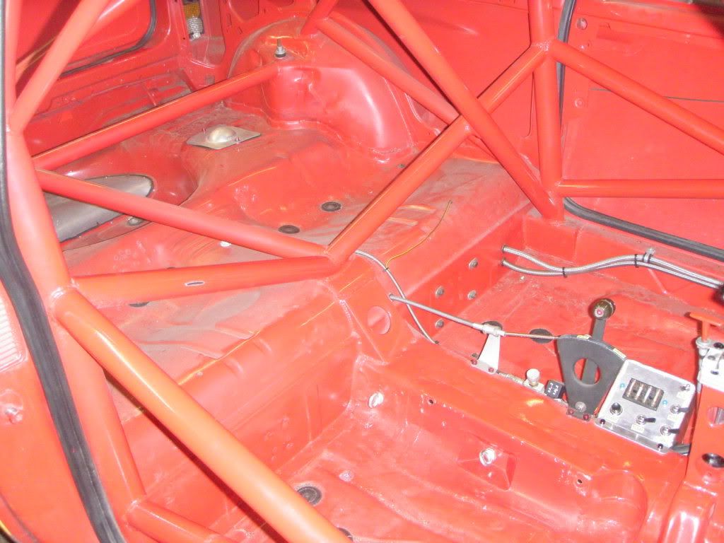

And now the pile of scrap from removing the double skinning on the tailgate aperture;
I got fed up with the spot weld drill, and resorted to the angle grinder, so there is a fair bit of tidying up to do;
http://i285.photobucket.com/albums/l...ort/020-12.jpg
http://i285.photobucket.com/albums/l...ort/021-10.jpg

Yesterday I welded some tubes into the sills to accept my sill stands. I've actually added a little weight with these!
But it will make working on the car so much more convenient, at least until the day I get my 2-post lift installed (which is a long way off).
Whilst I was busy with the grinder I also removed the extra metal plates that fix the rear towing eye to the chassis rail. An awful lot of work for almost no weight loss!
