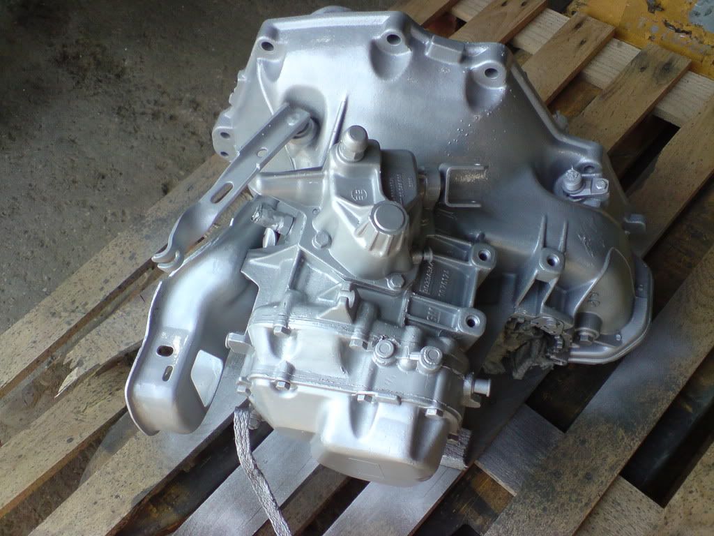

On a ghey note - I spent some time prepping and painting up my gear box only to find that cos it was an F10 it didn't fit. Doh! So that was a waste of time - I now need to sort an F13 casing:mad:
http://i205.photobucket.com/albums/b...dengine011.jpg
Check with Stu, but I seem to remember him telling me the casings were identical..... what gearbox setup do/did you run anyway CP?
F10 wont fit over his 1600 fly, thats the prob Ash.
F10 has a smaller bell housing.

spare f13 gearbox here, ill dig it out for you.
At one point there were three highly skilled technicians trying to get the box on, then some smart **** casually pointed out that it wasn't clearing the starter motor. Don't you just hate people like that!

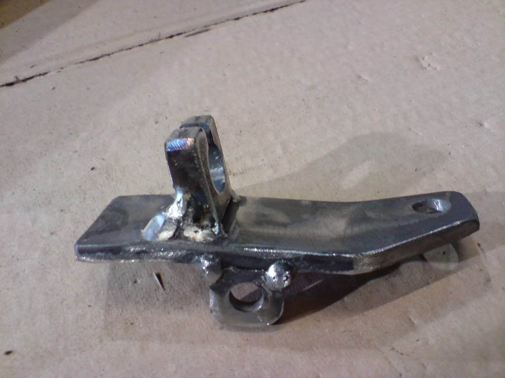

I decided today that there was only one thing to be done and that was to convert my SCCR cluster and quaiffe diff into an F13 box that was handy. Only trouble was that it was out of an Astra with a hydraulic clutch so this meant making a bracket for a std manual clutch:
http://i205.photobucket.com/albums/b...dengine015.jpg

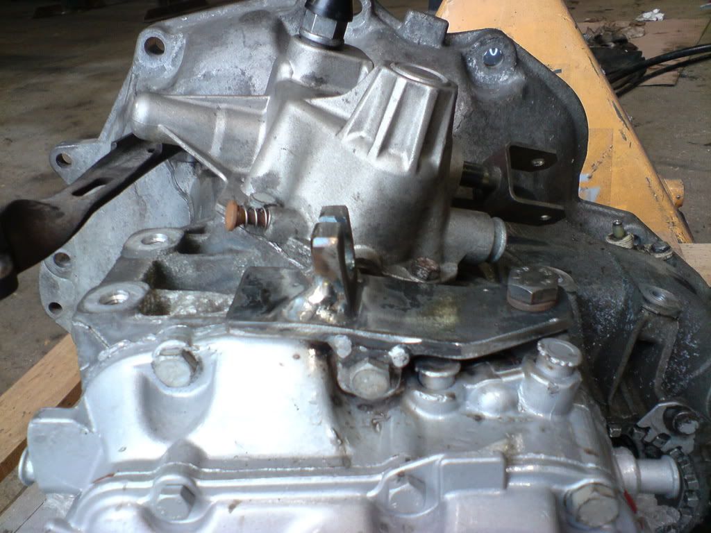

which was bolted on like so
http://i205.photobucket.com/albums/b...dengine014.jpg
with the cable fitting like so
http://i205.photobucket.com/albums/b...dengine017.jpg

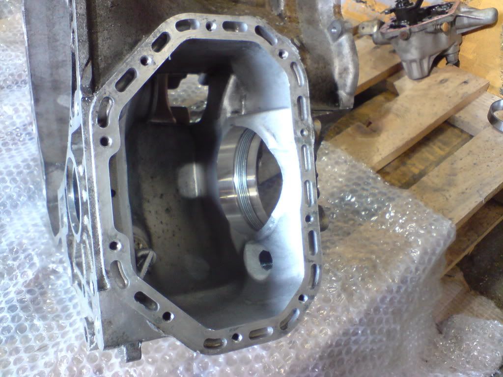

and in order to fit the diff I had to do the usual grind out of the FD casing like so
http://i205.photobucket.com/albums/b...dengine012.jpg
