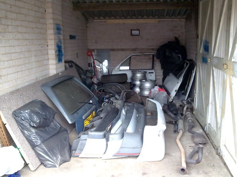

Went down to the stores today and wondered how I got the car in there! Think I need a tidy up!

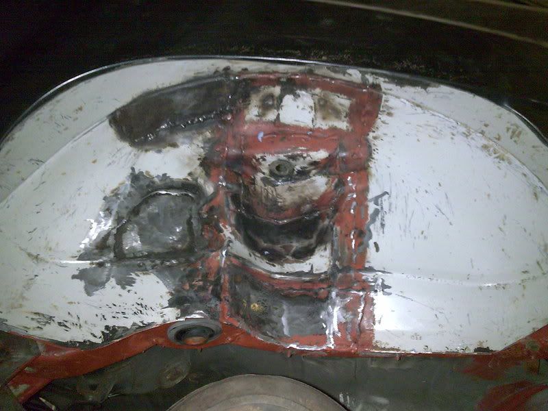

Update time

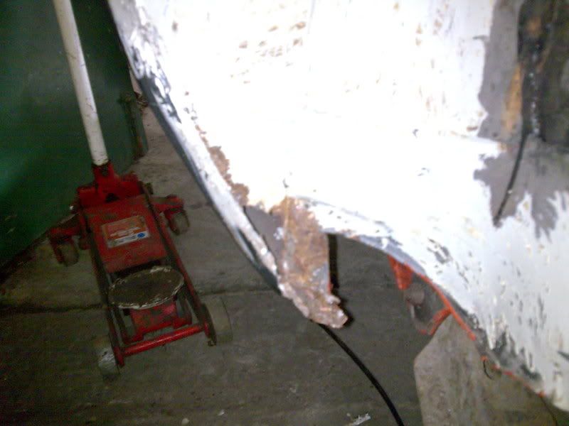

Last arch cleaned up, to uncover someone had bodged up two rotten holes with a load of seam sealer... :roll: :wtf:
When the rear quarters were fitted rather than tell me the end of the sill was rotten and say its going to cost a little more the guy obviously thought he was doing me a favour by filling the hole with a plate and seam sealer:tard:
So now need to get the rot cut out and replate it up. Not really what I wanted but hey, good job I found it I suppose.

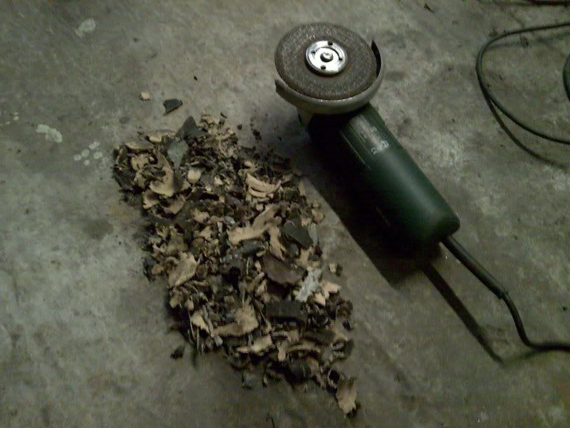

Nasty horrible underseal gone
http://img.photobucket.com/albums/v3...a/Image031.jpg
How much came off with a grinder for scale!
http://img.photobucket.com/albums/v3...a/Image030.jpg
The hole...
http://img.photobucket.com/albums/v3...a/Image024.jpg

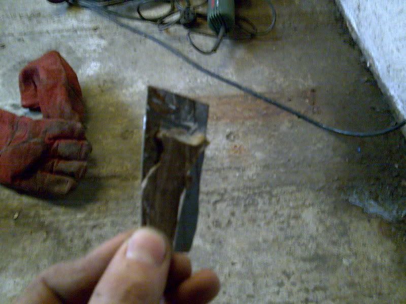

... The piece of metal that was bodged in
http://img.photobucket.com/albums/v3...a/Image027.jpg

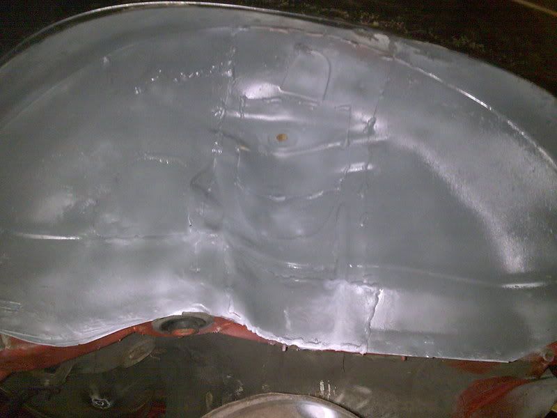

And finally, etch primed and zinc primed to protect the bare metal
http://img.photobucket.com/albums/v3...a/Image032.jpg
looking good Yan :thumb:
bit of a crapper about the rot! but as you say - at least you've spotted it early enough before paint etc

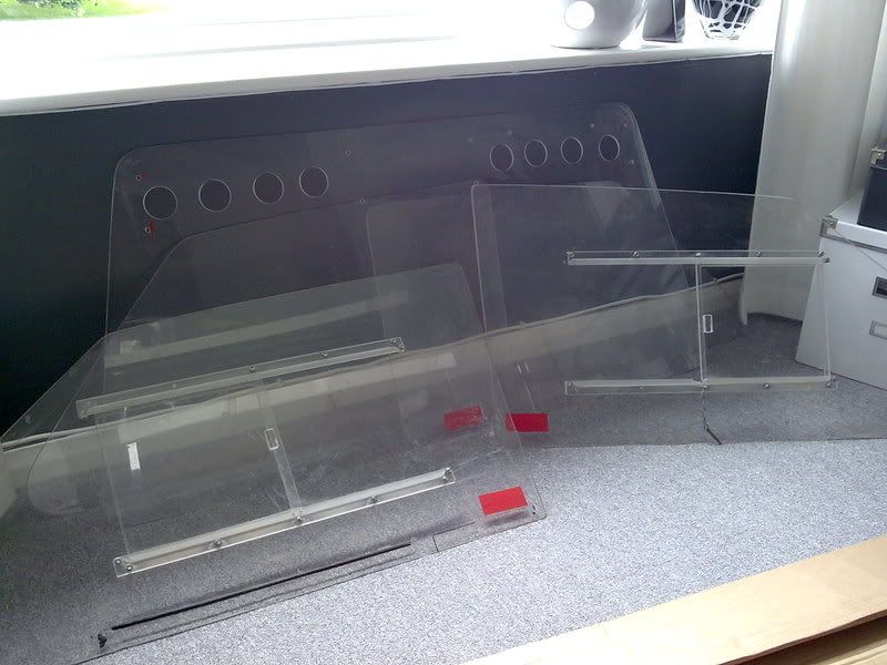

Bit of an update, mr postman delivered some more goodies for the car:D
Full set of polycarb windows with sliders
http://img.photobucket.com/albums/v3...a/Image002.jpg
Cheers Olly for spotting these on the bay and letting me know, good man:thumb:
Nice rear window ports :) They help a lot. Might let a bit of water in without cowels over them though :( Or do i spy holes for some cowels?
