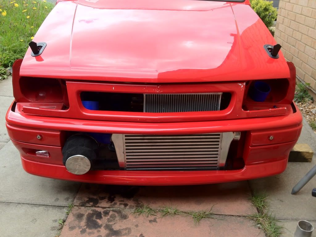

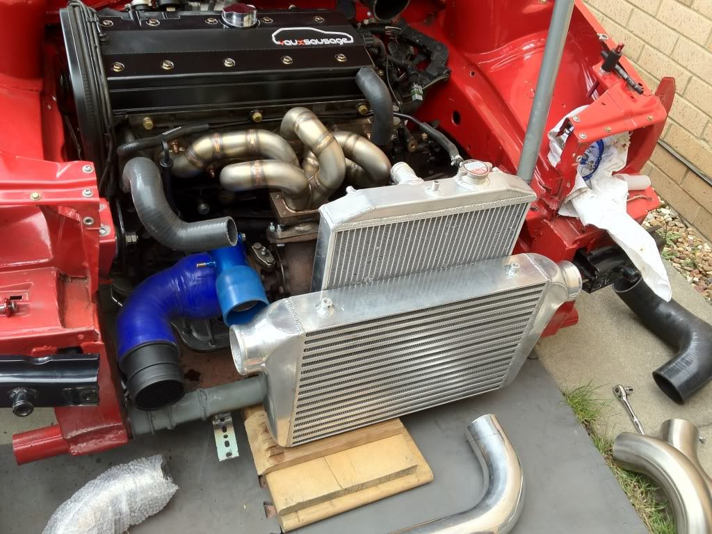

been playing around with the front end, i was trying to keep the boost pipes as short as possible and have the turbo joining straight onto the intercooler, i was going to get the end tanks on the cooler modified to suit, but this setup would mean an off centre intercooler which i just didnt like the look of
http://i1127.photobucket.com/albums/.../IMG_16101.jpg
http://i1127.photobucket.com/albums/.../IMG_16131.jpg

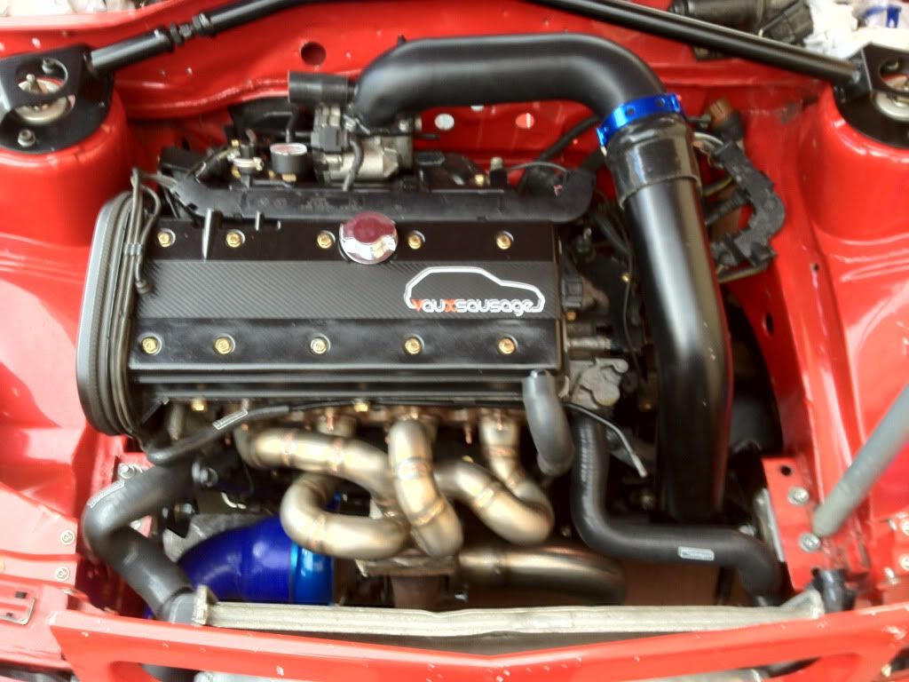

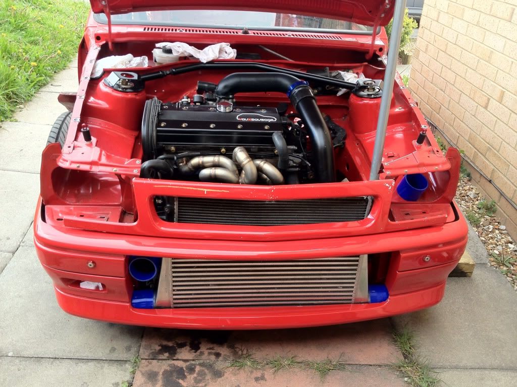

so had to go the traditional route and take the pipes around the legs which im not too happy with but will do for now.

Very interesting location for the air filter. Hope it doesn't suffer from water and dirt issues.
Like the colour scheme too :thumb:
You wanna make up a proper inlet manifold if you're aiming for some high horse power; the standard inlet won't flow right.
a new inlet is on the cards but the standard one will surprise most
