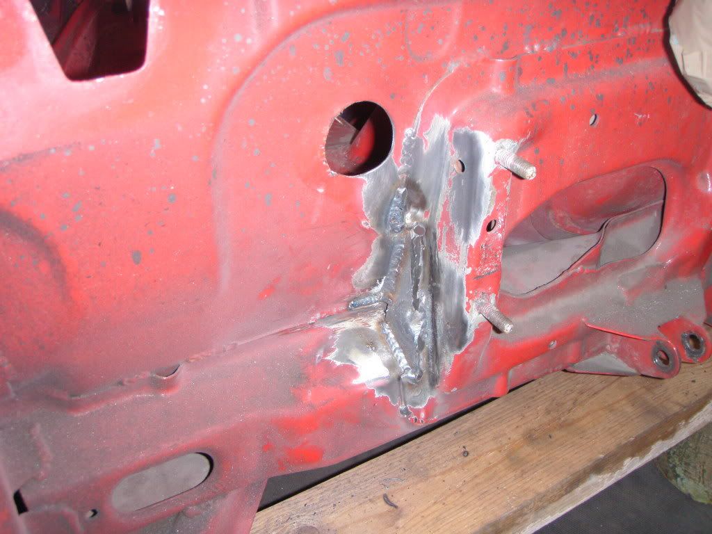

First bit of extra plating to stop the steering rack flexing the bulkhead;
http://i285.photobucket.com/albums/l...ort/004-56.jpg

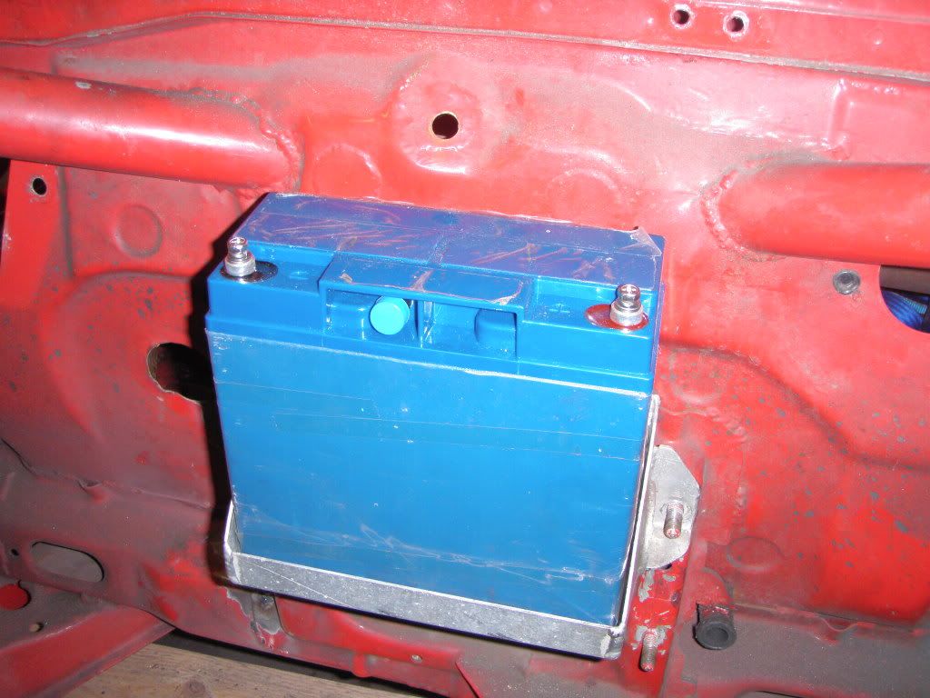

New lightweight battery has arrived (VAMOS - 2.1kg, 12 Amp/Hour), so experimenting with the location of that;
http://i285.photobucket.com/albums/l...ort/005-46.jpg

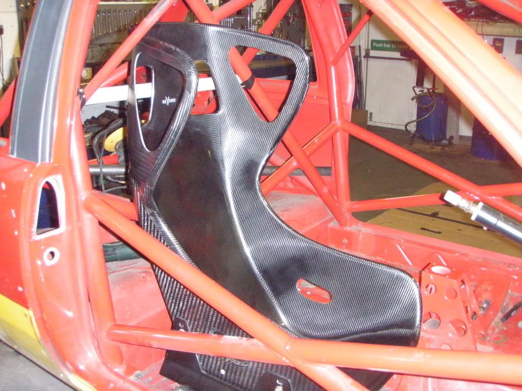

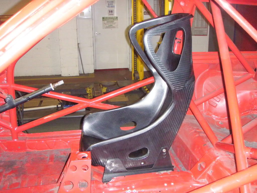

And the lovely carbon fibre seat now in place on its new rails;
http://i285.photobucket.com/albums/l...ort/006-48.jpg
http://i285.photobucket.com/albums/l...ort/007-41.jpg
